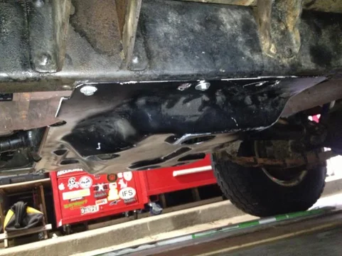

Wire wheeled my jump seat frames & got em in primer form, got around to getting my skid plate to fit w/ the header & exhaust Lil grinding never hurts:)
