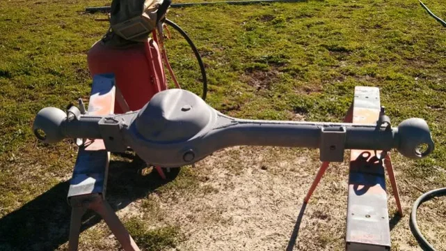

Got front axle torn down, parts cleaned, and started media blasting.

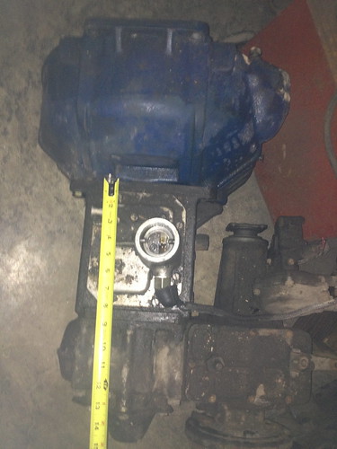

I took the Transmission transfer case out...
I looked at it

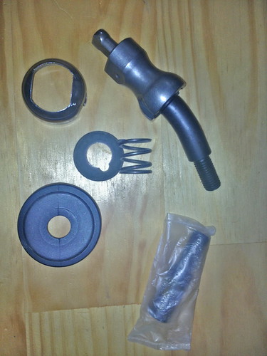

I bought a NV4500 shifter
I measured the NV4500
Then I measured my J30 3-Speed
Then I drank a few beers...

What engine are you mating to that?
For now I have convinced my father to donate a SBC 305 High Output, it is still fully assembled so I can save a little cash and throw it in. Once I decided to go with a SBC I wanted to do a 350, but I can bank a little cash over time and slowly assemble an engine on the stand. Who knows, with a 305 and this NV4500 maybe I can manage to get a little mileage out of it, but honestly I am just looking for a little reliability at this point!
It is sitting in the garage. It lost compression and had a horrible lower end knock. After a few miles I dropped a few of the main caps and plasti-gauged the bearings, they had enough meat left on them, but they didn't look pretty... The oil pump went out on it pretty quick and I had to put a new one on, and a new pan b/c it was leaking so much. Then finally a month or two later it dropped compression on a cylinder. fully disassemble the head, everything looked fine, it could have used a valve guide or two, but the manifolds were wrapped and cracked. The pistons seemed to have a little slack in them, as if it was assembled with oversized rings and std pistons? I dunno but there was no visible sign of the loss of compression and blow-by, but I knew the lower end would need rebuilt anyway b/c of the knock...
I added up the prices and figured I would go with a free V8 and spend the money getting rid of the 3-speed....
