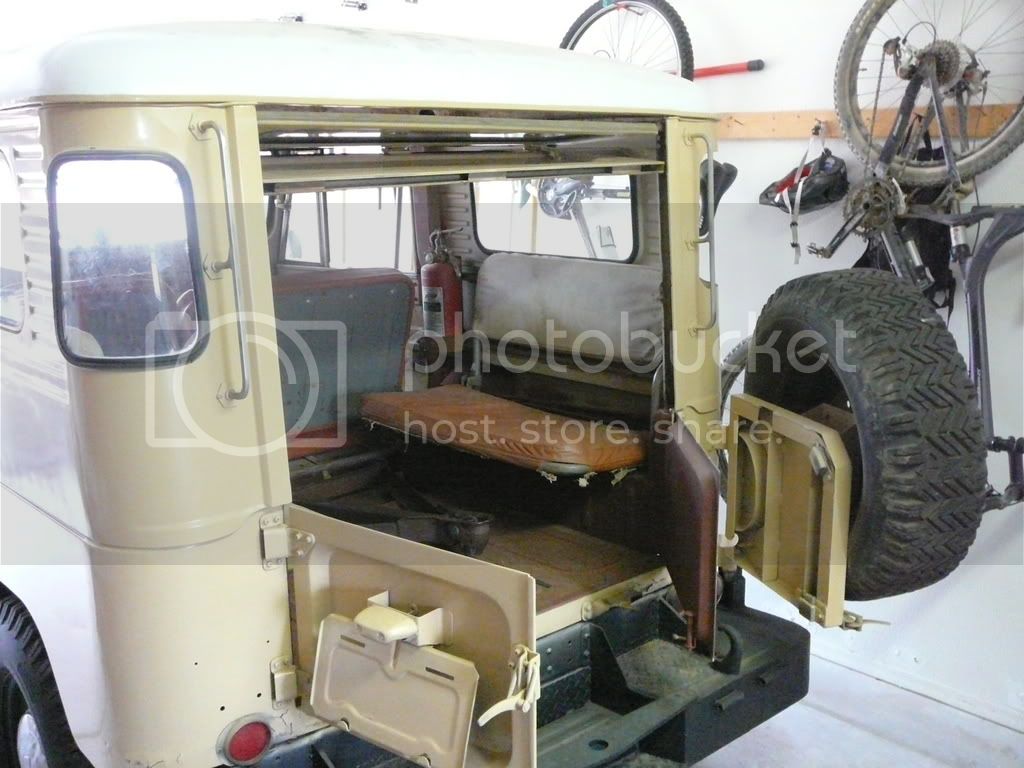

The bumpers on this thing are ridiculous. They are thick iron and they stick out way far. The rear one takes any departure angle this thing ever had. It was used as a standing platform for hunting in TX I think judging from the handles on the old top I took off. I'm likely going to have it cut off and have the front one modded a bit so it doesn't get hung up on the rocks.

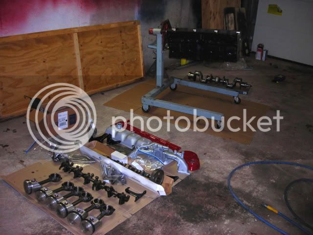

Finally got everything laid out cleaned, and started putting the 2F back together. Crank, pistons, and cam are in. Hopefully I'll finish assembling it this week and try to get the driveline back in the truck this weekend. I still need to get an oil pan so I won't be able to start it, but I need to continue forward progress.
