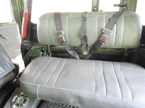

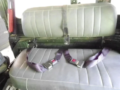

rear seat belts
Installed 4 seat belts in the rear.
The belts
Installed
When not in use
Rudi

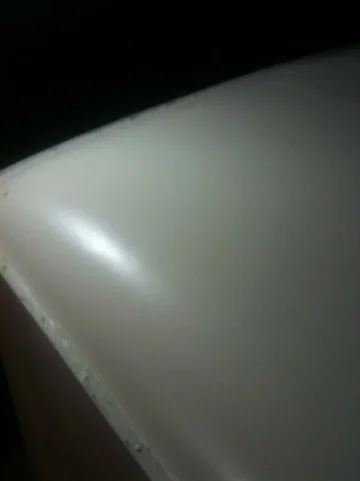

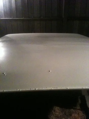

Well, I got her sanded with 100,220 and 500 and laid down rattle can primer and paint. Wimbledon white by duplicolor(their cans suck by the way) drip and nozzle clogs. I am happy but as many people say, a rattle can can't keep a "wetline" on a surface that big. This should work for now until I can shoot it with a real paint gun.
You need to use 1000 grit and wet sand. It will shine. That is what I am using on my cowl. The clear coat is coming off.
I don't have any clearcoat on it. I have never wet sanded. Quick explanation would be awesome!! Will I need to paint it again?
Thank you!

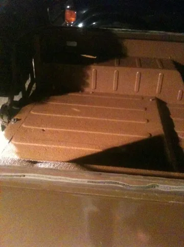

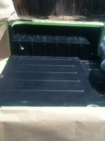

I started working on this project in July. I am not looking to restore by any means but I wanted stop rust and keep the bed looking good. I did the rear half this summer and maybe the front half in the winter if I can find a garage to store her in. First I wire wheeled and sanded the rear tub and painted Chassis Saver from Magnet Paints.
Before
After/scuffed in prep for liner.
Because of finances I had to wait for a month and a half to get the Monstaliner. I ended up going with the jeep spice because I didn't want black and it was the closest to olive 653. I scuffed the chassis saver with 220 grit sandpaper and sprayed with a schutz gun I purchased from magnetman. The rear tub took 2 quarts by spraying, I messed up on the first coat and was lightly spraying instead of laying down a good first coat. My suggestion, take your time and lay down a solid first coat. I very happy with the outcome and help from magnetman with all my questions and mixing up quarts for me.
You buy the wet sand paper and get the hose and turn it on at a heavy trickle. Then you just go at it sanding away while the water is running. 1000 grit will feel like rubbing paper on it and will seem that nothing is happening but it is actually sanding. The water keeps the paper clean and kills the heat caused by friction.
Then go to the 2000 grit. I am not a fan of clear coat.

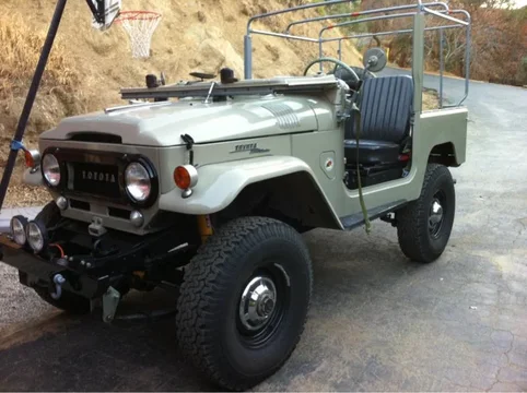

I'm not sure how to post a pic so I stuck this pic from my album on there. finally put on my new used rims and tires on my 79. I know that it's sacrilegious to put some rims on that aren't stock steelies, but I couldn't pass up the deal. 2" offset and the tires don't hit anything.
