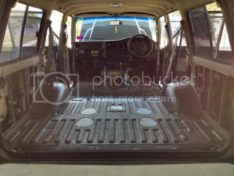

Today I decided to dig in and have a good look at the body to see if it was in fact as good as it looked.
Started by gutting the interior and cleaning that out

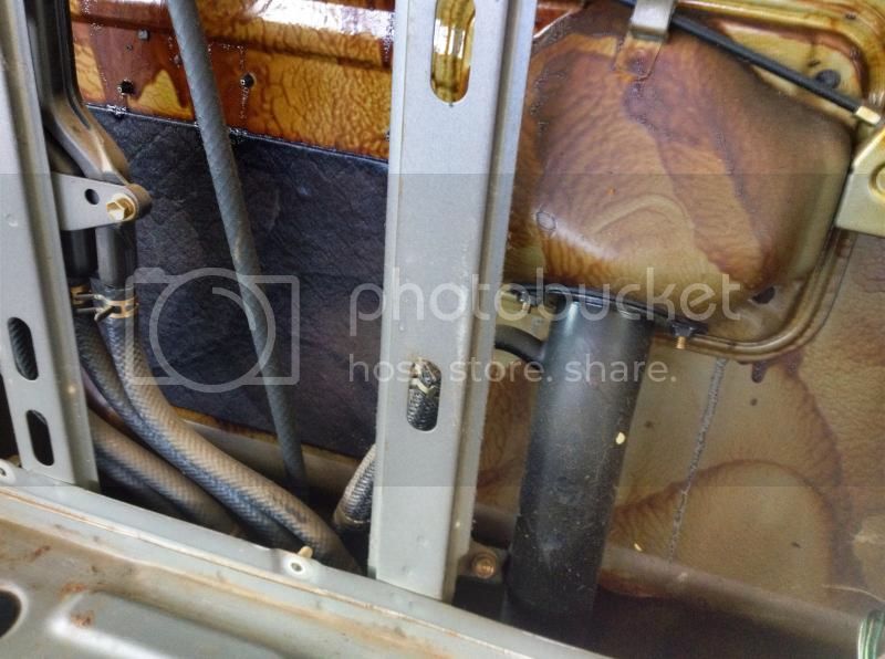

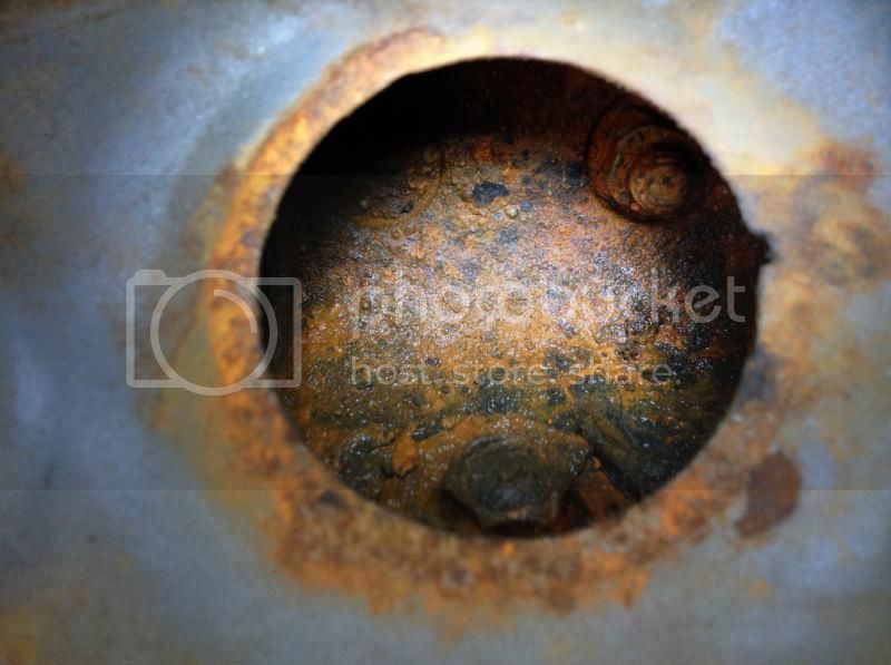

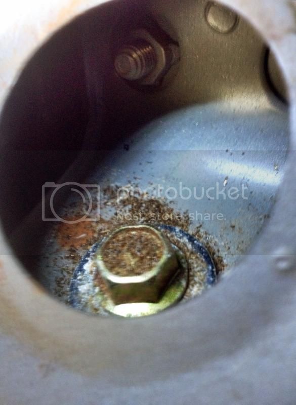

Only rust I could see was in the Passenger side body mount
The other side was fine
Everywhere was coated with rust proofing by the previous owner (except for the above)
I started laying sound deadener down. Didn't get very far as the local Jaycar only have 5 sheets left in stock - only covered from the firewall to just behind the front seats. I'll finish it when more stock arrives.

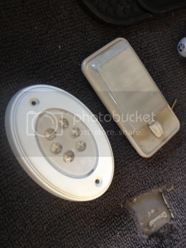

I also found someone wrecking a HJ61 Sahara locally. I managed to secure the interior lights (the PO installed ridiculously bright LEDs), an Airtec snorkel and the front seats from the Sahara as well. I pick them up tomorrow morning :D

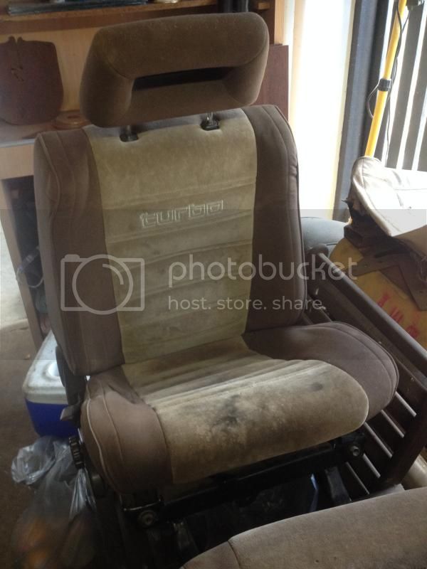

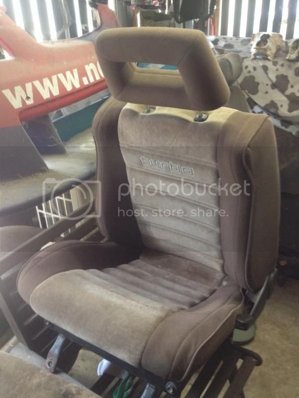

So today I went and picked up the 'new' front seats. They need a good clean but are solid. The drivers seat has electrics!
I also bought the original roof lamp. The PO put this awful LED light in there. Waaaay too directional. It didn't spread any light at all. I'll still replace the old bulb with LED but hopefully the lens will diffuse the light properly.

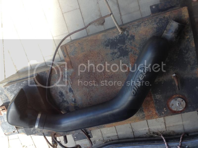

Here is the Airtec snorkel that I'll be installing as soon as I find the courage to cut the guard.

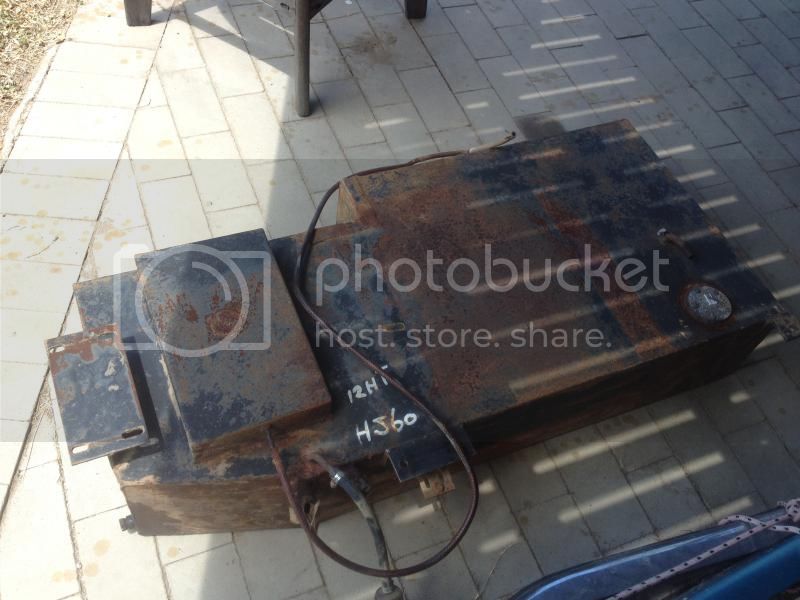

If anyone can recognize the long range fuel tank and give me tips on how to mount it, that would be great.

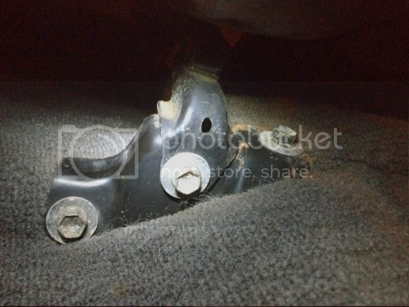

Do you mind taking a couple photos of the front of the seat mounts, where they bolt to the floor, looks like you might have them handy. Pm me of you don't wanna brag about them here.

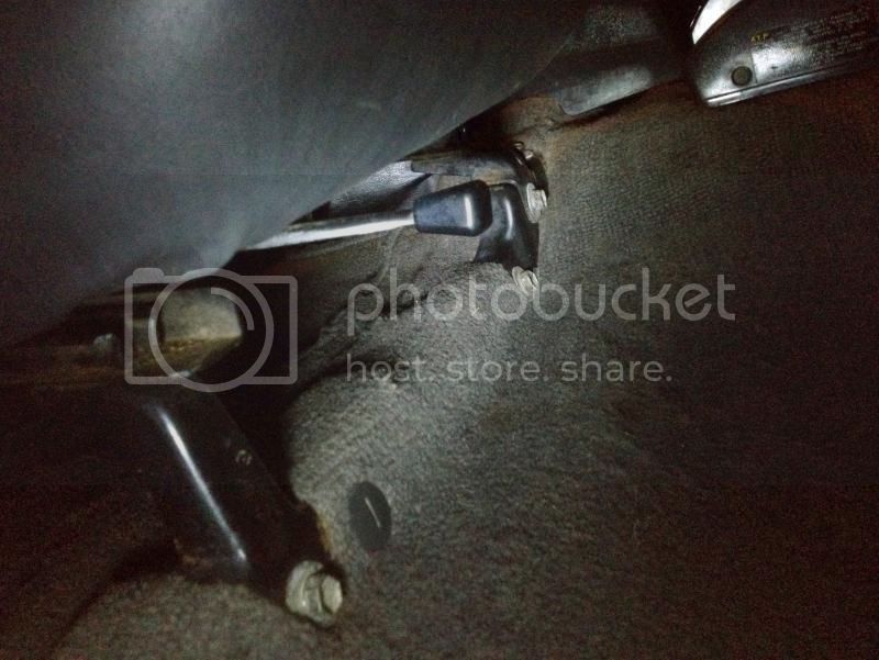

Here's the pics you requested. I suspect you are missing the inner most mount for the seats.
Aah, thank you soo much...
And you're right,that's the one I'm missing. The whole slide, i think, or is the rear end of the inner slide similar to the outer slide rear end?

Three of the four mounts look the same. It's just the front, inner side that has the extra piece.
That tank basically fits under the central rear passengers feet/arse... inside the frame rail, ahead of the rear axle and beside the tailshaft obviously..... I have one in a 2h powered 60.... there should also be a couple of other brackets... I'd have to have a look to be more specific..... the PO on mine cut a hole through the left rear guard and added another fuel cap there, but it's as ugly as a hat ful of arseholes with the good ones picked out... just a round generic cap sticking well proud of the guard. If you're any good at panel work maybe a second original cap/flap etc in the left rear quarter or a dual throat thing under the existing cap.... I do believe it makes for a fairly slow fill on the LR tank though if you're coming from the factory filler position.....
