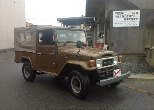

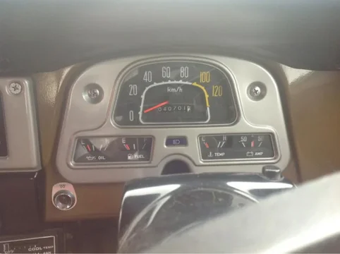

I picked it up for the drive back home.
It is as good as i had hoped!
