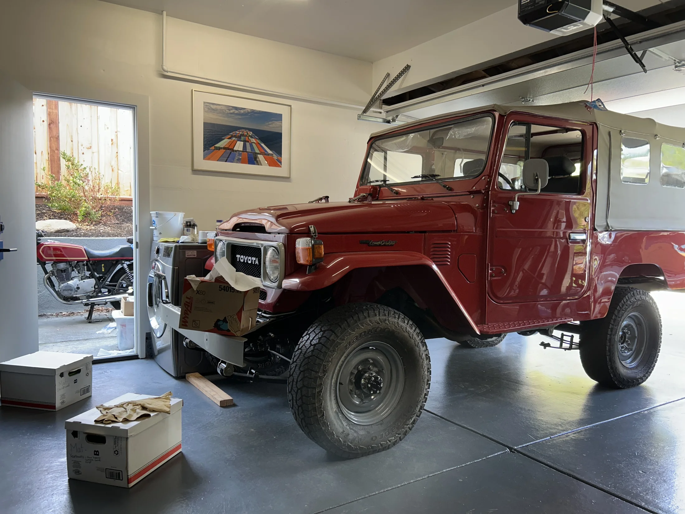

Need some advice, new tires is happening this week. Need to choose between these two. Already decided on 235/85r16.
KO3s or Geolander MT G003s.
Nolen’s patina builds look fantastic with the geolanders…but the KO3 seem like a classic 80s choice.
Any strong opinions one way or another? Mostly road. Summer camping dirt.
Pic is with 31 10.5 15 that belong to another rig.

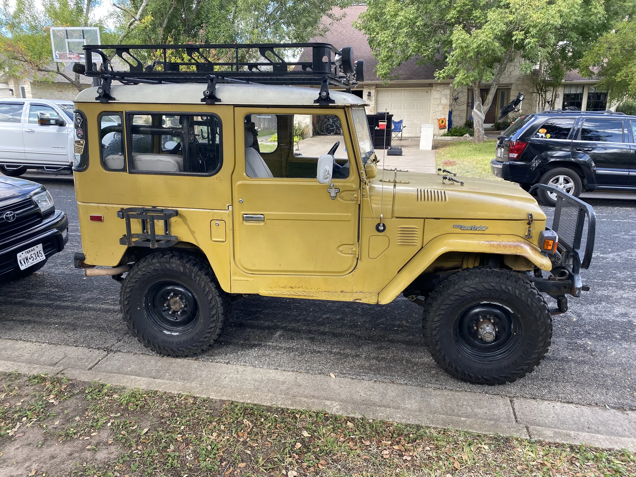

I have 2 sets of Geolanders 31" and 33", love them both. Aesthetically I think they emulate the old bias ply tires that would have been period correct but with modern technology.

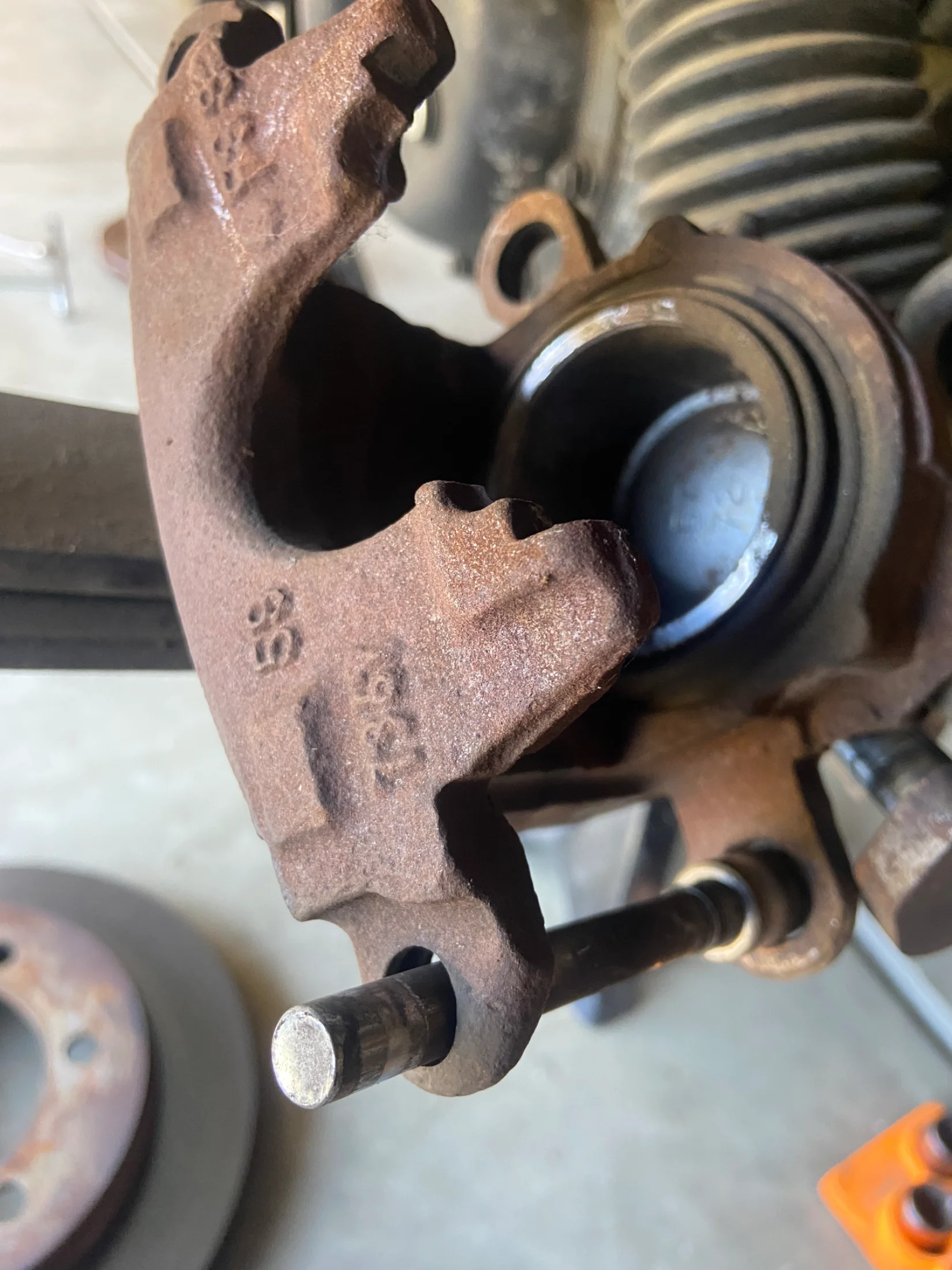

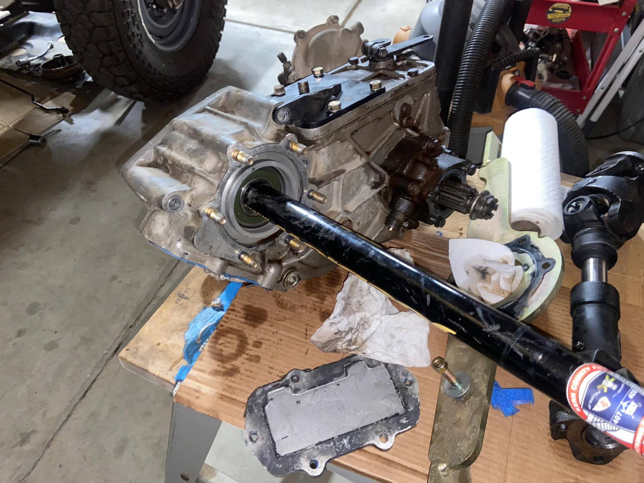

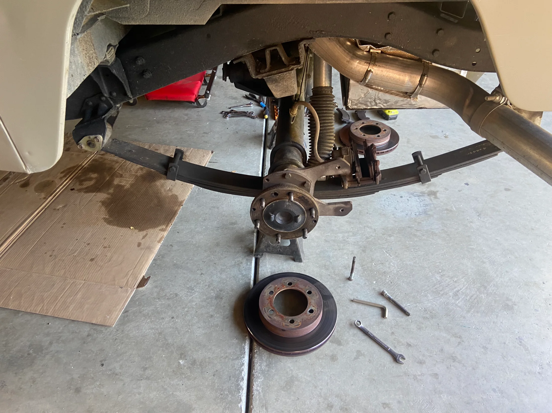

Pulled the transfer case off to replace the input seal. Was transferring ATF from the 4L60e into the TC. Also thought I would do the rear disc brakes since everything was apart.
I did the Poser 4 wheel disc swap almost 20 years ago and have had very few problems. I rebuilt the leaking Wildwood MC last year when I did the LS swap but never the rotors or brake pads. The kit uses Chevy C10 rotors from the mid 70’s and ‘84 Monte Carlo calipers as well as Poser’s brackets. Simple to get parts for and very reliable.
One caliper had quite a bit of play on the mounting pins so that was replaced too.
Resurfaced the rotors.
Just waiting on the transfer case seals and I will get it all reassembled. Can’t wait to wrestle that thing back into place.
A little short cut I learned last time I had the TCase off was to use a piece of old bicycle pump tube (1 1/4” diameter) to hold the transfer gear and spacer in place as you slide it onto the shaft. As it goes on it pushes the tube out the back. I’ll cut it down to about 12” to make it easier to handle. I’m sure the pros have a better solution but this works.

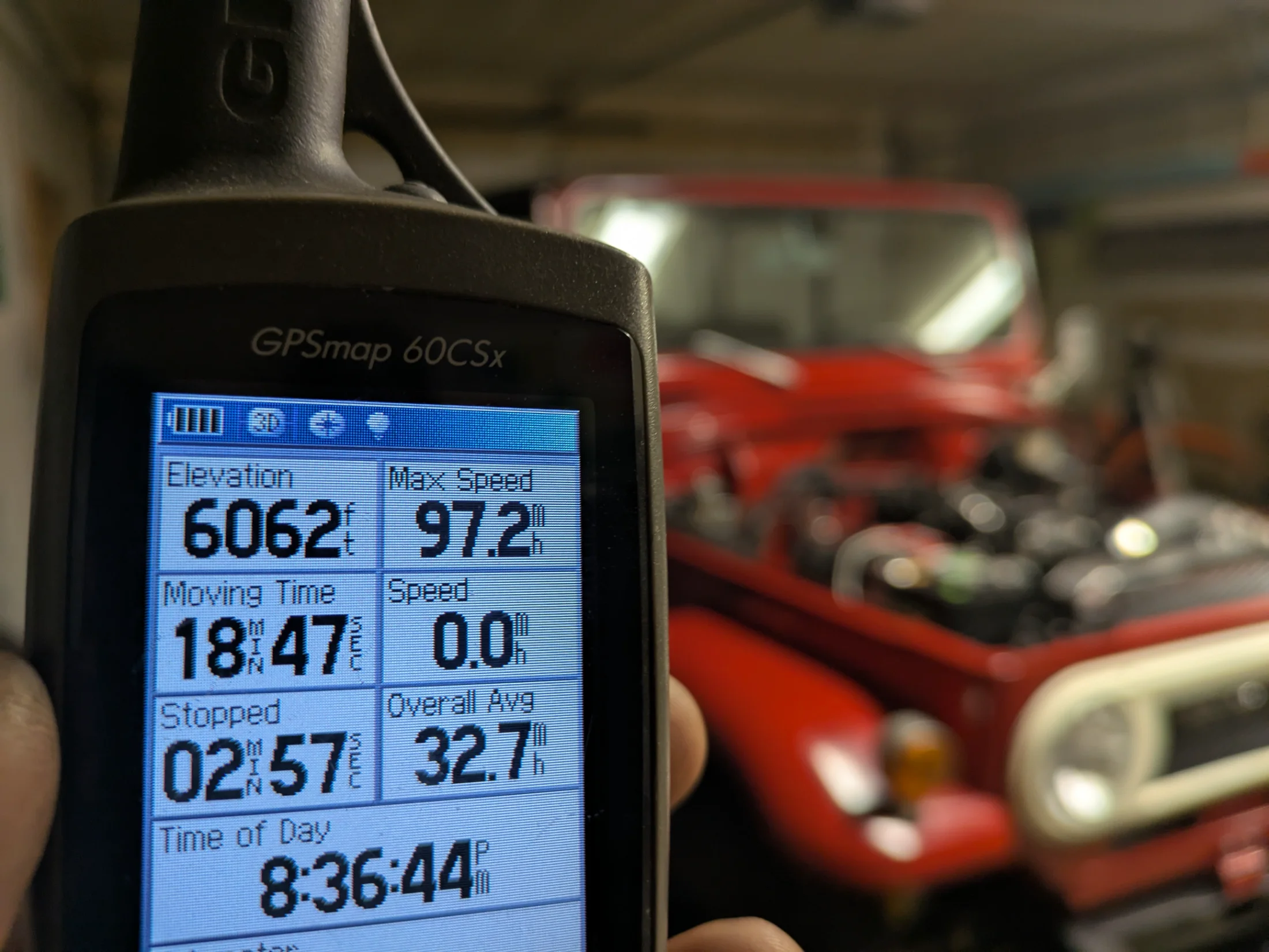

Closed course professional driver first test of the LS 5.3 swap and 4 speed.
I don't think a 5 speed was needed lol.
Driveline definitely had more to go (my balls maybe not so much)
I had the speedo buried at 100 for fun for a few seconds but was disappointed to see the GPS under triple digits when I got home.
May have to find the actual top speed.
Yeah yeah, not what a 40 was made for....
but it was made for fun, and being able to travel at highway speed is fun.
This was just a test to feel out stability and gearing I'm not condoning speeding.

Man, I hope your brakes, suspension, tires, steering and alignment are dialed in. I don't think my paint and rust would even handle that speed.
The truck is completely rebuilt.
Every nut and bolt gone through.
I'm thorough, and not crazy
