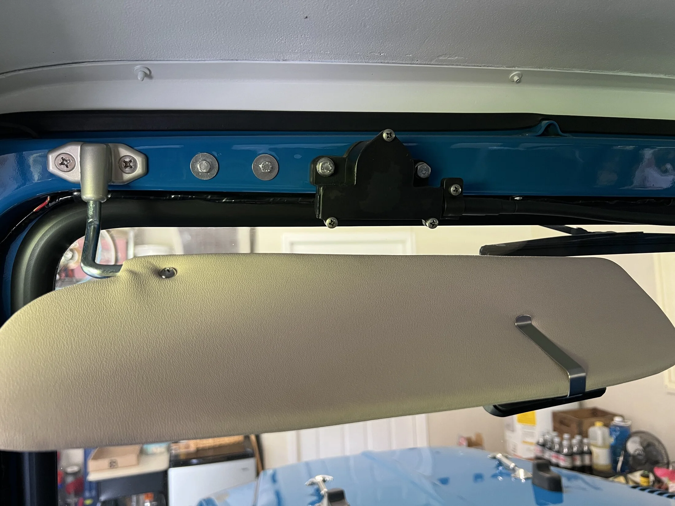

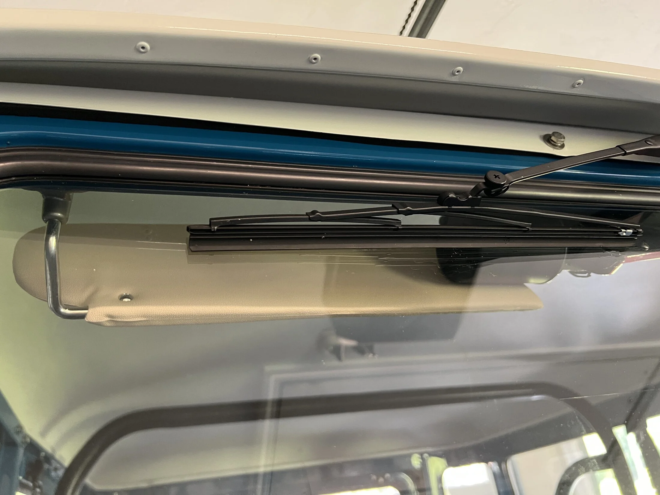

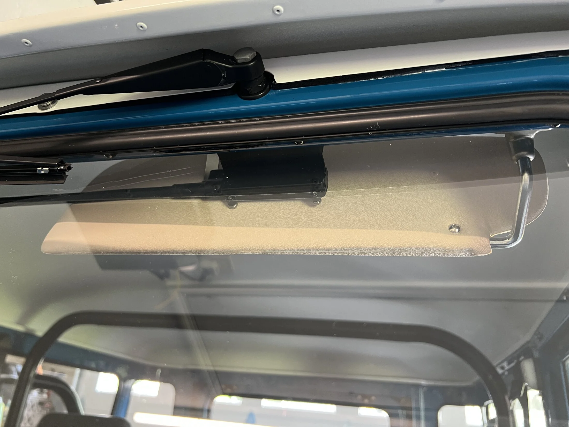

Does anyone have a picture of sun visors that also has the top mount windshield wiper motors? Thinking about ordering the visors but wanting to see if they would work.
No pictures but the difference is the offset of the visor arms. Deeper offset for top mount. Short for later style bottom mount.

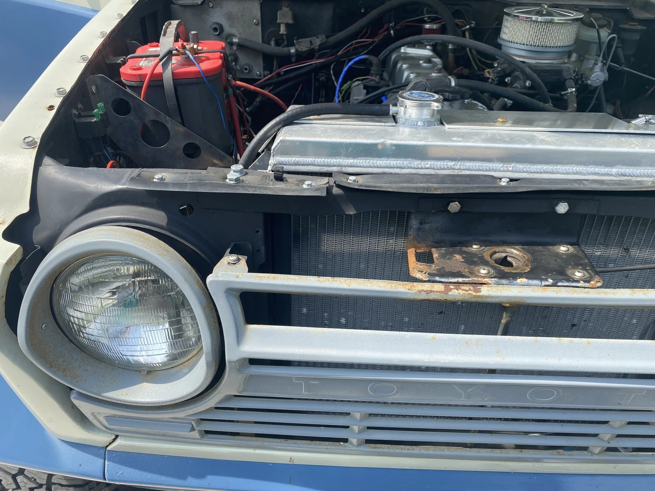

Installed the Koito harness for the Koito headlights I bought from @CruiserTrash
Also put in the fuse and relay mounts for it from @cruisermatt…works great.
Took longer than I thought, but I did end up cleaning up the wiring bc I have an entire wiring harness from another 40 and needed to make the ends of the wires on my 40 the same color/stripe…so now I can see exactly the colors on the wiring diagram…and I needed to solder the wires and put shrink around them to clean it all up.
Also, my HBI turns on and I’ve read that isn’t always the case, but I do have an LED in mine and @CruiserTrash and I were waiting to see if mine was going to work.

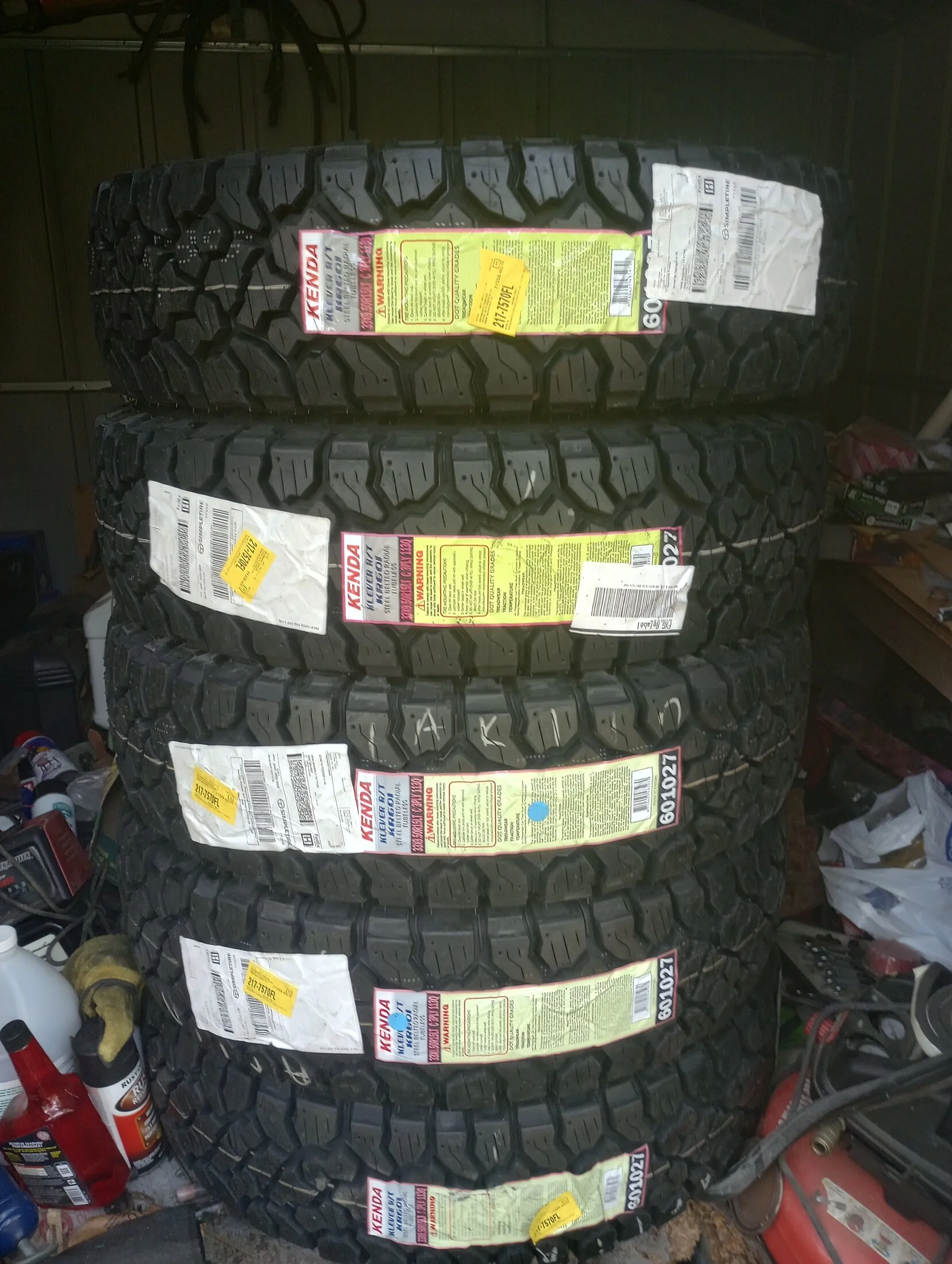

You know how FedEx has started taking a picture of the completed delivery? That is cool I think. Especially when the driver lets you get in on the pic. I was home when my Kenda Klever 33x9.50-R15s were delivered:
Now they are stacked in my other shed and once I finish all my fence chores, I'll do some rim painting and then get this show on the road.

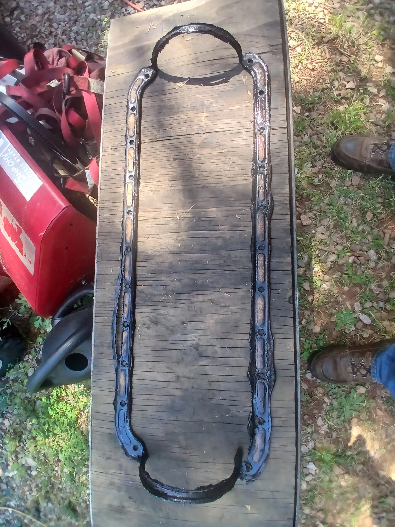

Research indicates that my Pig may be leaking oil. I suspicion that it might be the old cork pan gasket which has been fine for 21 years but is sorta bulging out the sides from being snugged up occasionally over the years. So I dropped the pan. Incredibly, it came right off with a gentle nudge. No bottle jack needed.
No real surprises in the pan, small patch of unidentifiable trash, half ferrous half old gasket and FIPG. I'm probably not going to drop everything and rebuild the engine over it.

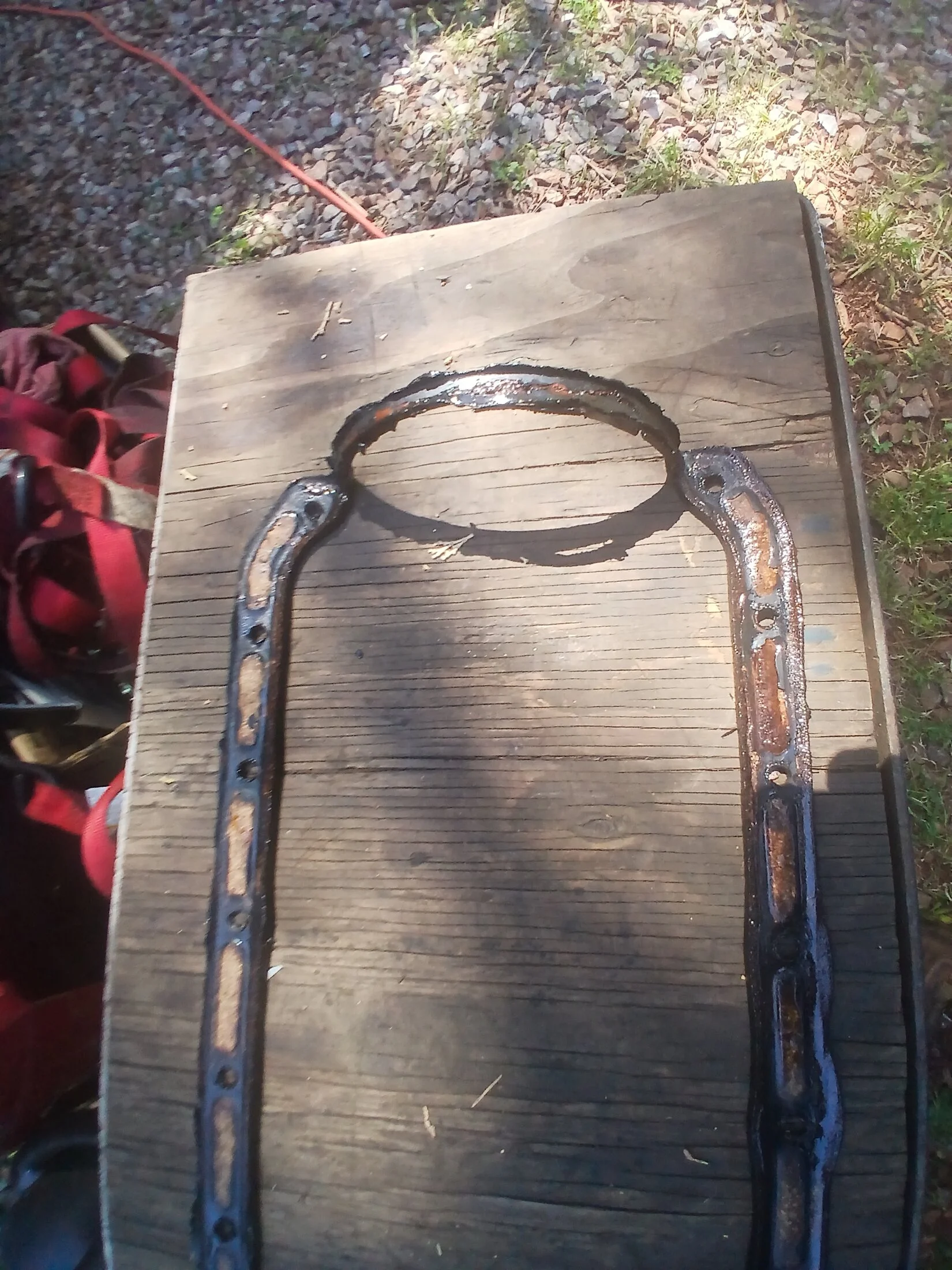

Got the oilpan gasket off in one piece, probably because some idiot decided to see what would happen without any gasket maker. So here's what a used, leaky, oilpan gasket looks like.
Think I got my money's worth out of this one, think I might have found my leak too.

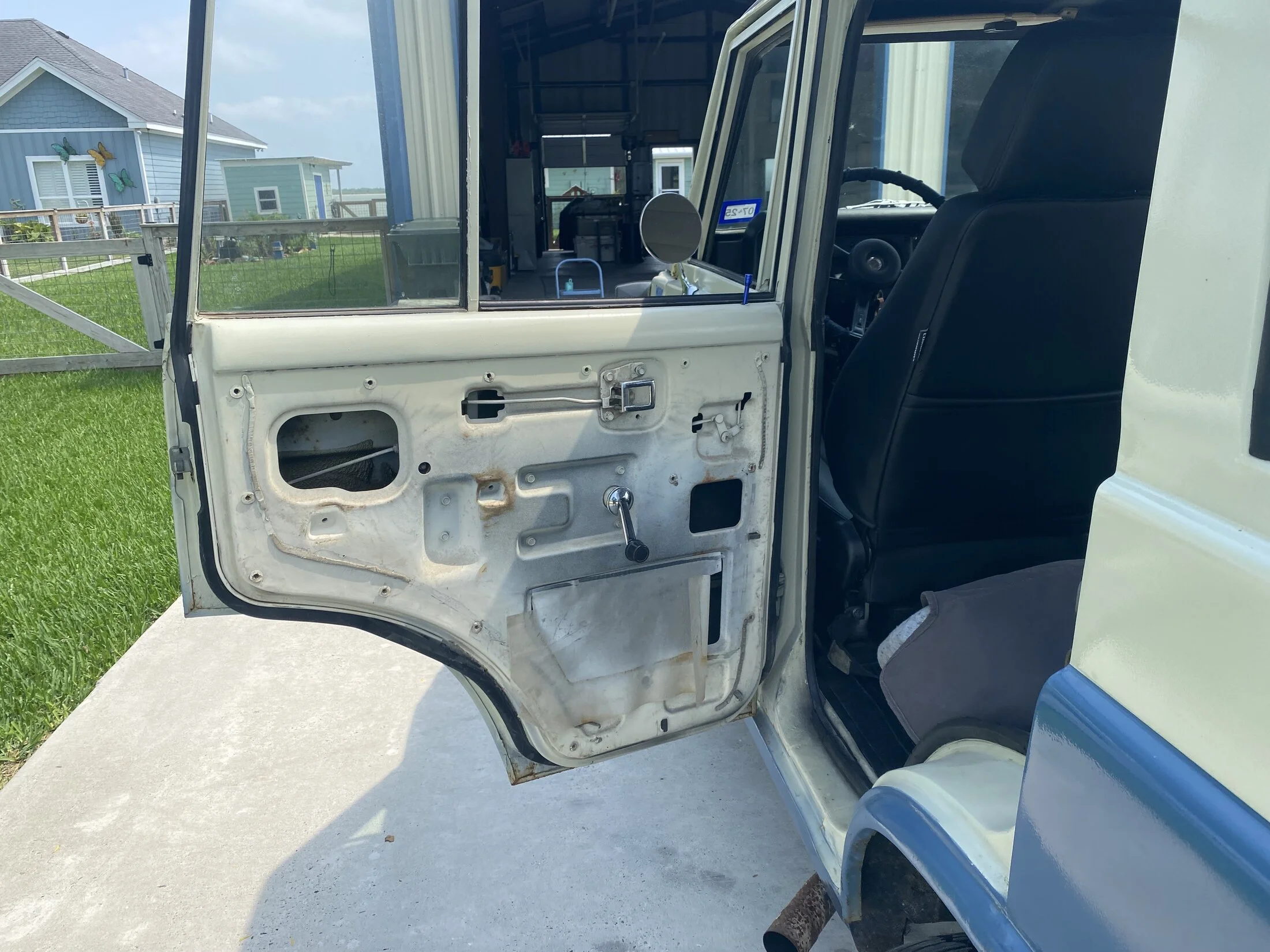

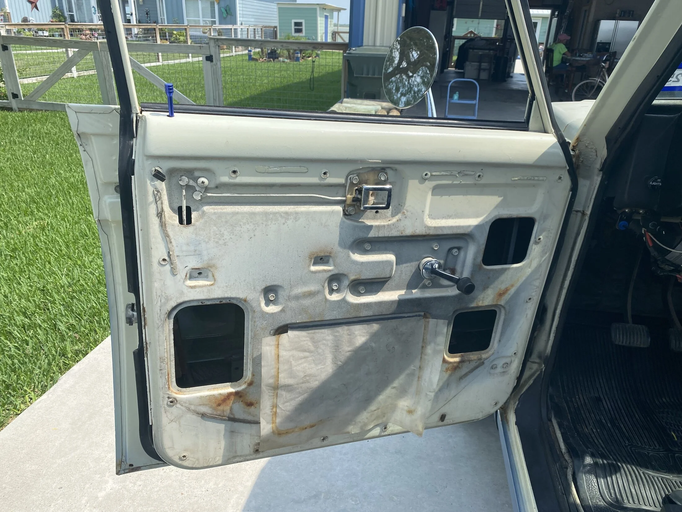

I've not tried Kydex for door skins. When I redid mine I used mahogany door skins I bought at the lumber yard. To do it over I'd probably use 1/8" Baltic birch plywood. The door skins worked great, but I believe baltic birch would be even stronger. The one thing I learned is that staples were needed... I tried only using contact cement. In the summer it gets hot enough inside a 40 in the summer to soften contact cement and the vinyl then came off.
