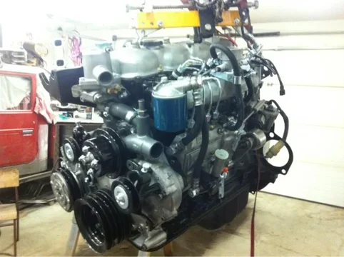

3fe Transplant
Completed assembly of the 3FE/H55f/TC, ready to go in the truck as soon as the 4spd drive flanges are available (Kurt).

Very nice work! I'm doing the same thing with my 3B/H55/toybox/splitcase

Bit difficult to tell (because your image is blurry Awl_TEQ) but is your bleeder on your filter inlet?
If so, I believe the consensus on the diesel forum is that it should always be on the outlet.

PS. I've always dreamt of finding a perfect/unused 3B or 13BT crate engine and your engine looks just like that. :clap:

Yup, you are correct. It is currently on the inlet. Not through any purposeful action but because I was just too excited when I was assembling to think it through. Thank you for your eagle eyed observation.

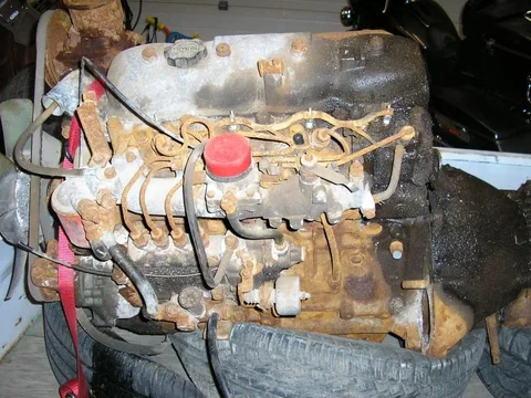

This is what I started with...
