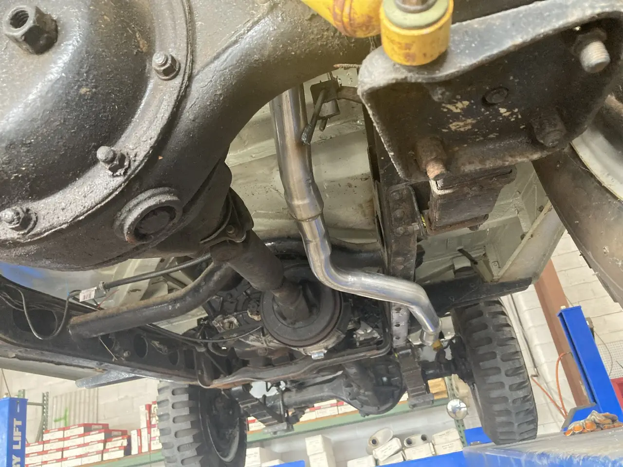

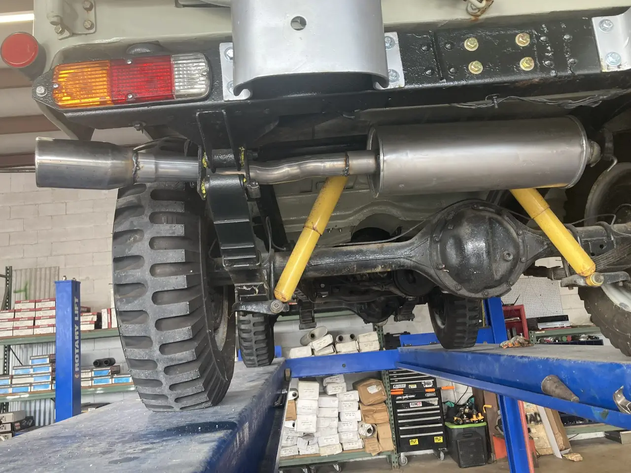

I'm living in Brazil, I was looking for some other tanks, but there is not so much avail. There is a Aux-Tank which will be installed underneath the car, but I already have a Inox-Exhaust-System there.
