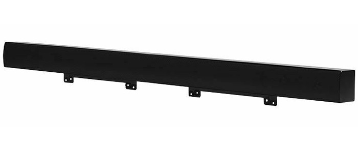

Continuing the radio conversation, I have been looking as well but don't want to go with a roll cage bar. I was looking for some kind of thin sound bar that could sit on the dash pad basically facing you. Something like:
or even
Amazon product ASIN B09QRQCWCG
Have you guys seen anything similar out there or considered anything similar? Maybe I'll just kick a thread off...

That’s an interesting idea.
I have the metal shelf (con ferr?) above my windshield and have driven around with the speaker up there. Works well and the shelf and top help amplify it with a bit of bass boost to boot.
I think I'll kick off a thread this afternoon and see if anyone has done it.
