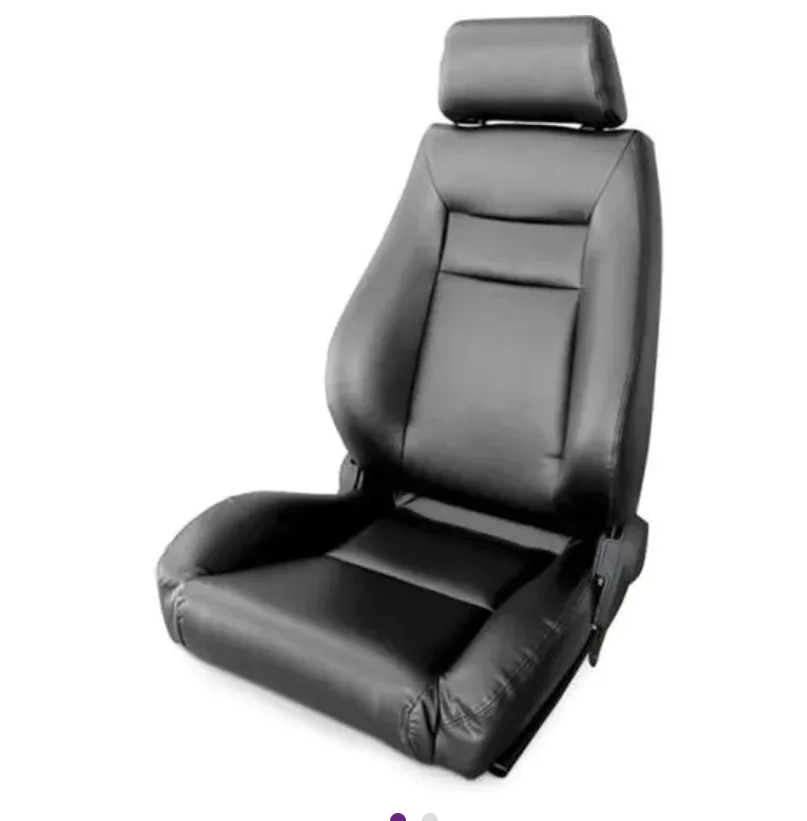

Yes, recently installed. (passenger seatbelt not even bolted in yet)
I like them a lot. Previous seats had more side bolstering, but these hold me just fine with lap belt.
What were your previous seats?

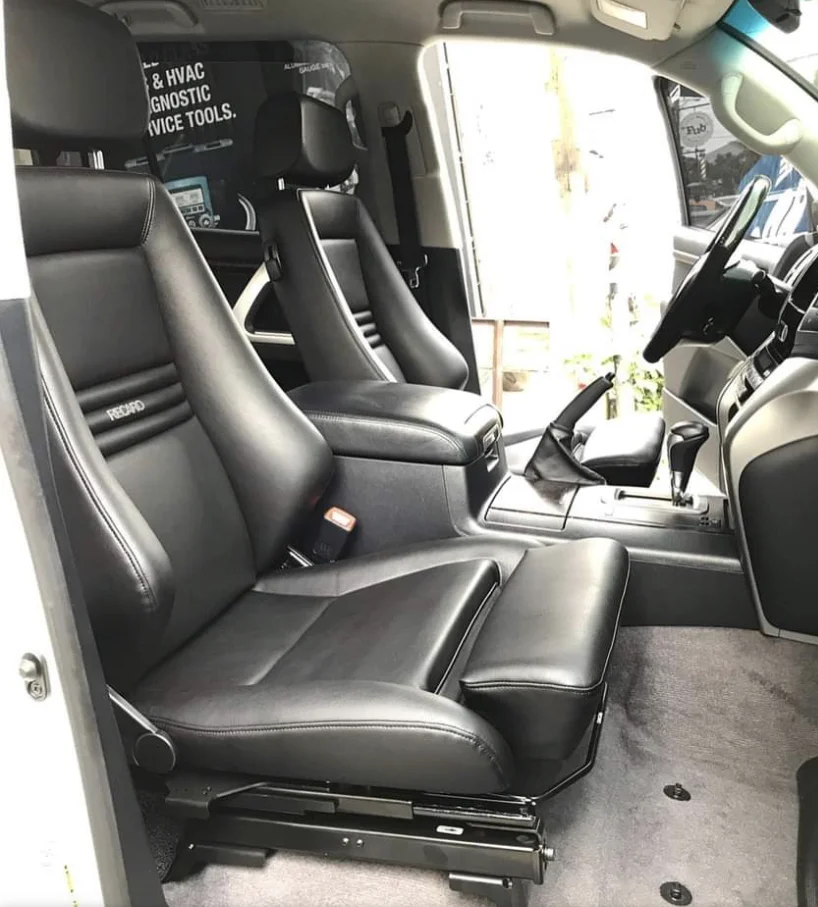

Some old version of “Scat” by Procar seats that doesn’t exist anymore. They looked just like these Recaro’s but vinyl. Everything had fine adjustment knobs and even the front forward edge of the seat bottom was adjustable in and out for thigh support like these Recaros:
They were worn and ratty and I like the stock appearance of the Procar 90s.

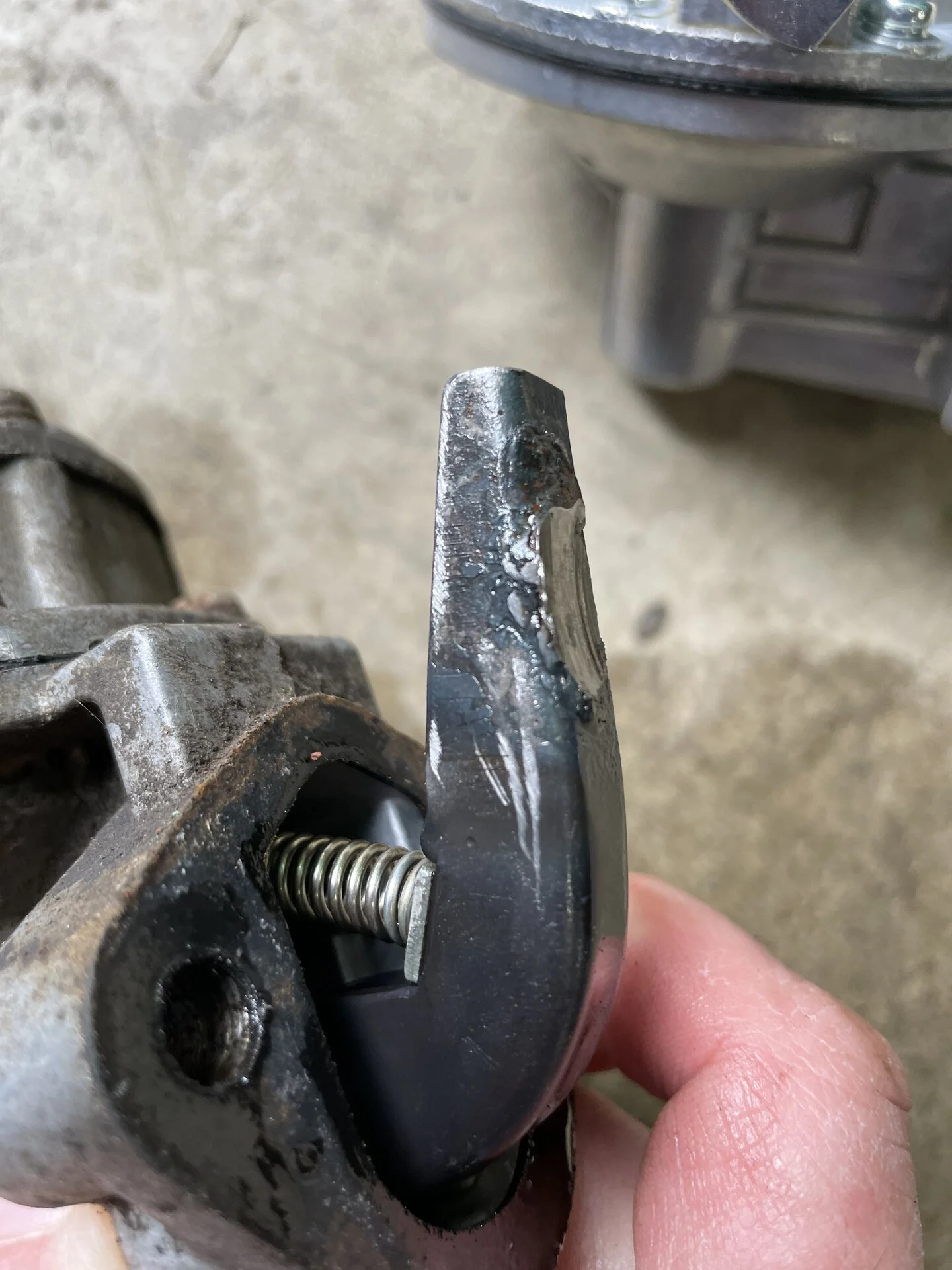

After pulling the 32/36 Weber and swapping back to the 75’ carb I rebuilt, I was still having a stumbling issue under a load. I had a brand new fuel pump from City Racer, so I swapped them out.
If you look close, it appears the pump arm on the presumed Chinese replacement was too short, so someone thought it would be a good idea to weld a pad on the arm to reach the cam. The hardened cam core obviously wore out the mild steel as referenced by the photos. Hoping to drive the truck tomorrow after I wrap up a few more things.View attachment 3245755View attachment 3245756View attachment 3245757
This belongs in the wall of shame thread!

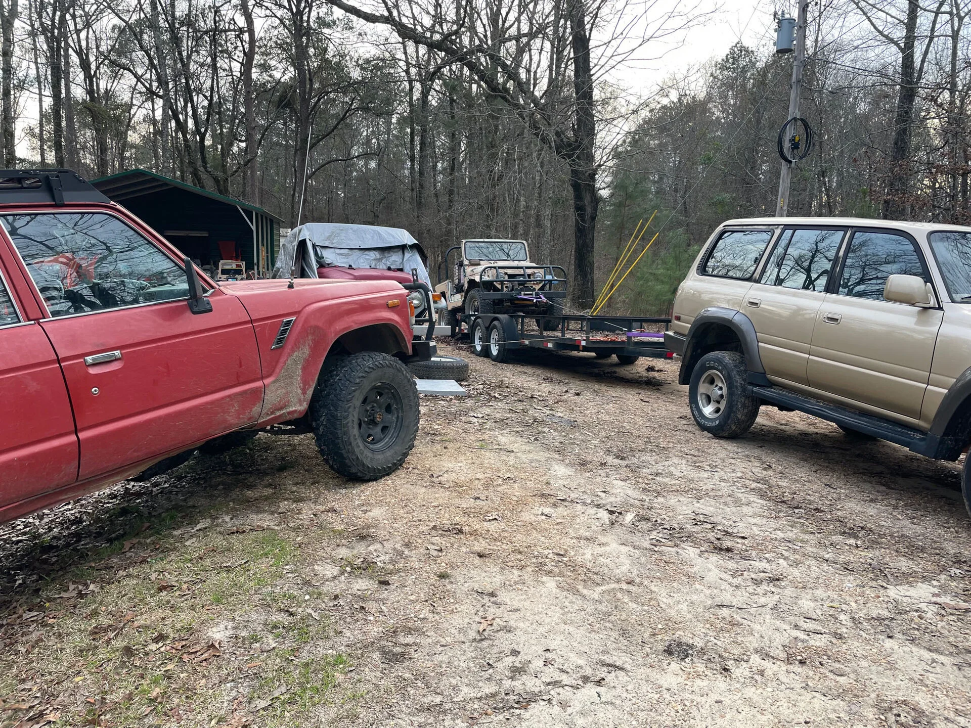

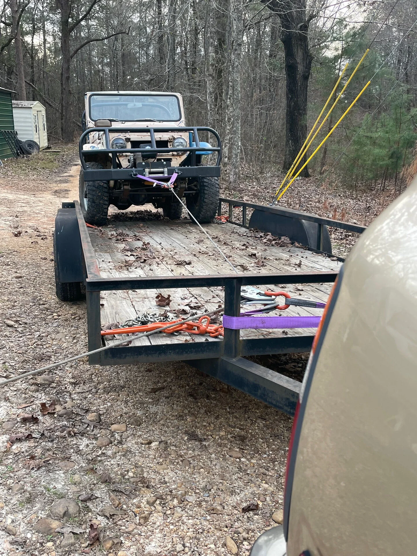

Loaded the 40 on trailer for some shop work tomorrow. We'll be towing it with the 80 but needed the 60 for winch duties to get it on trailer.
