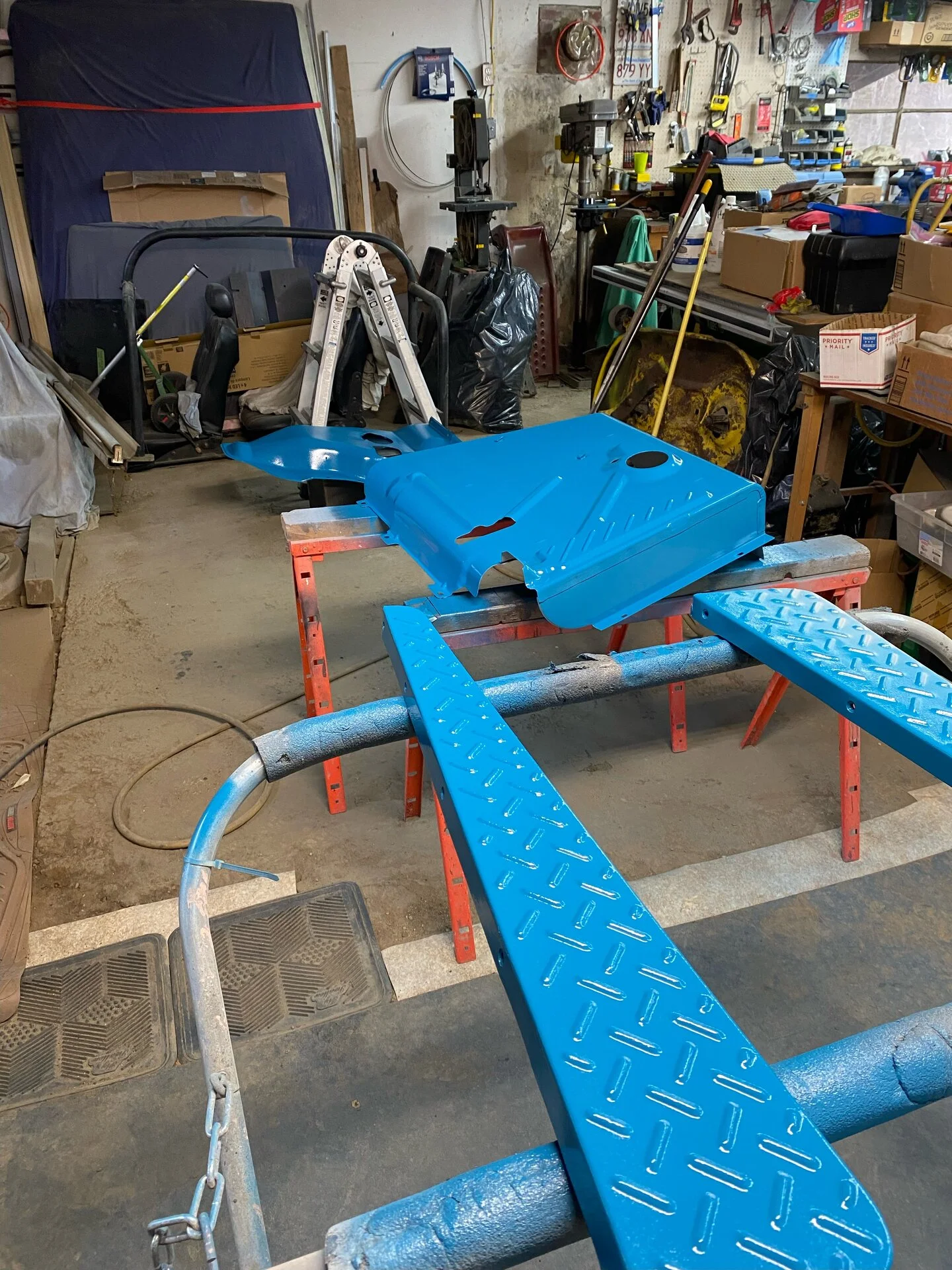

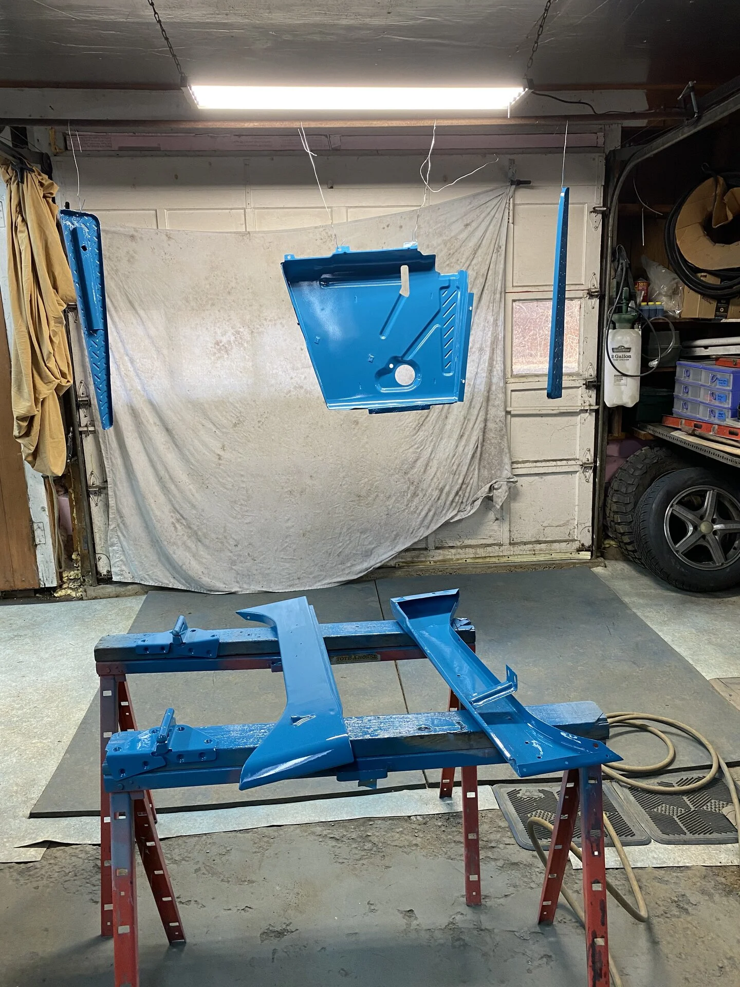

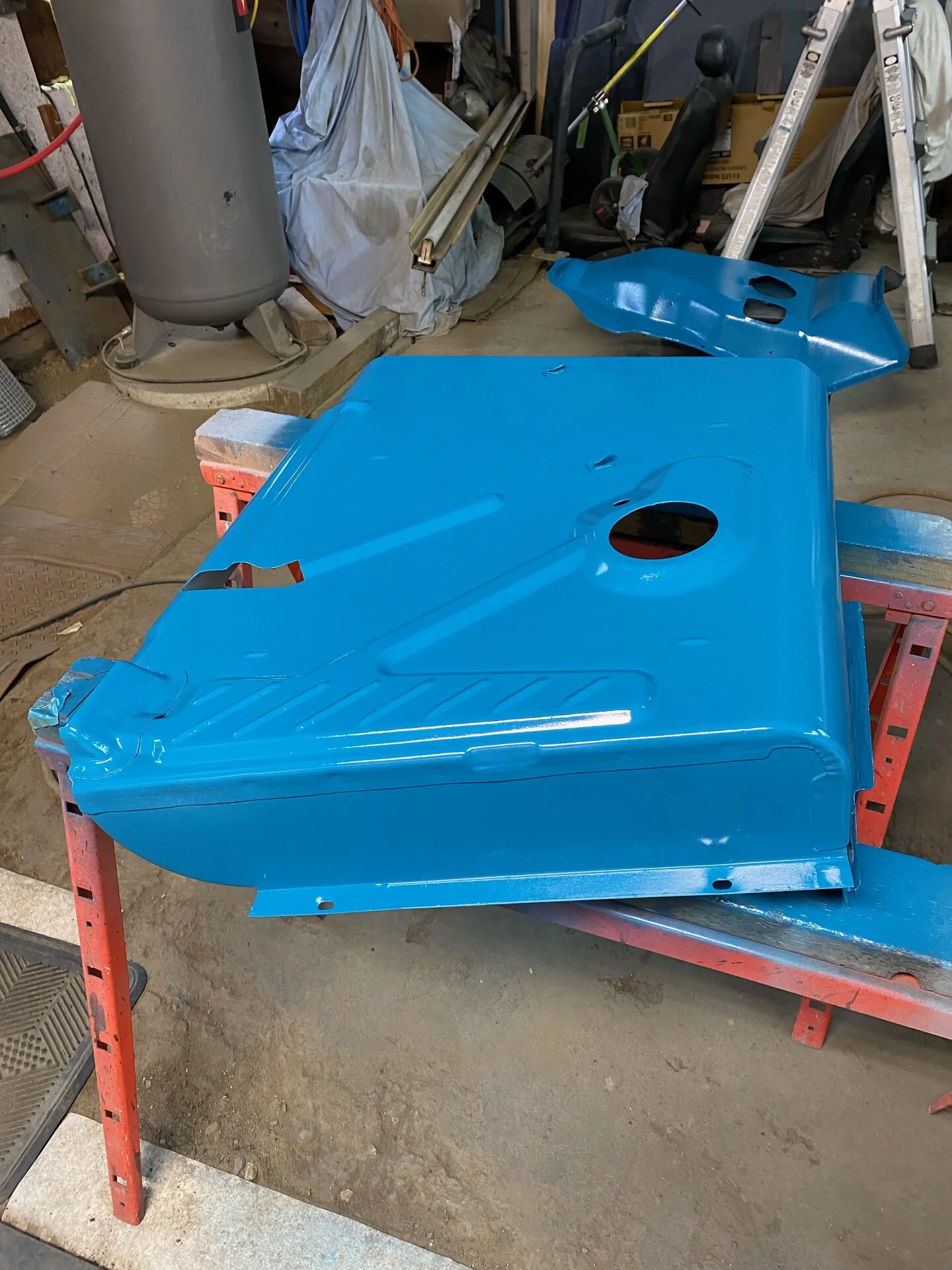

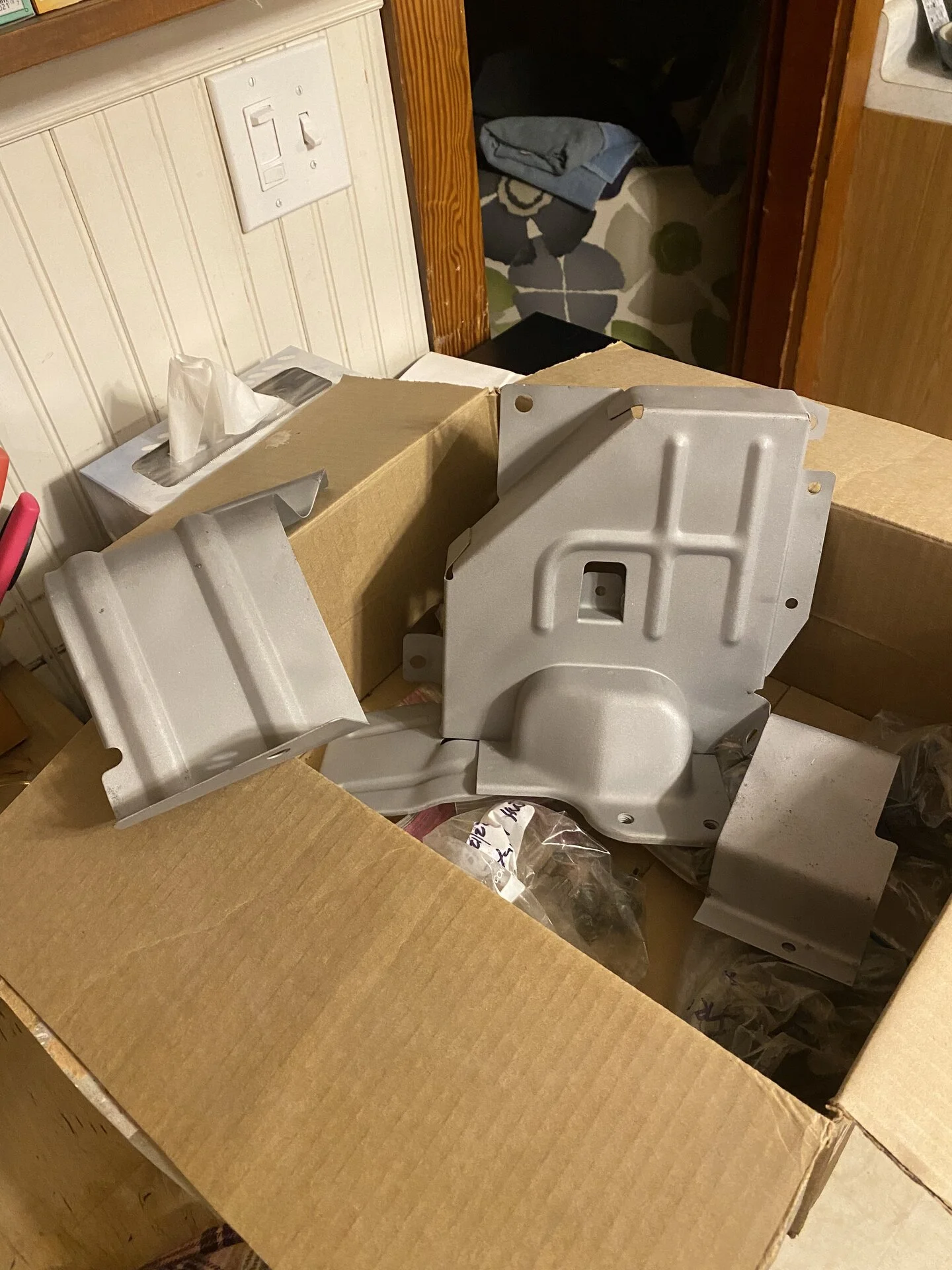

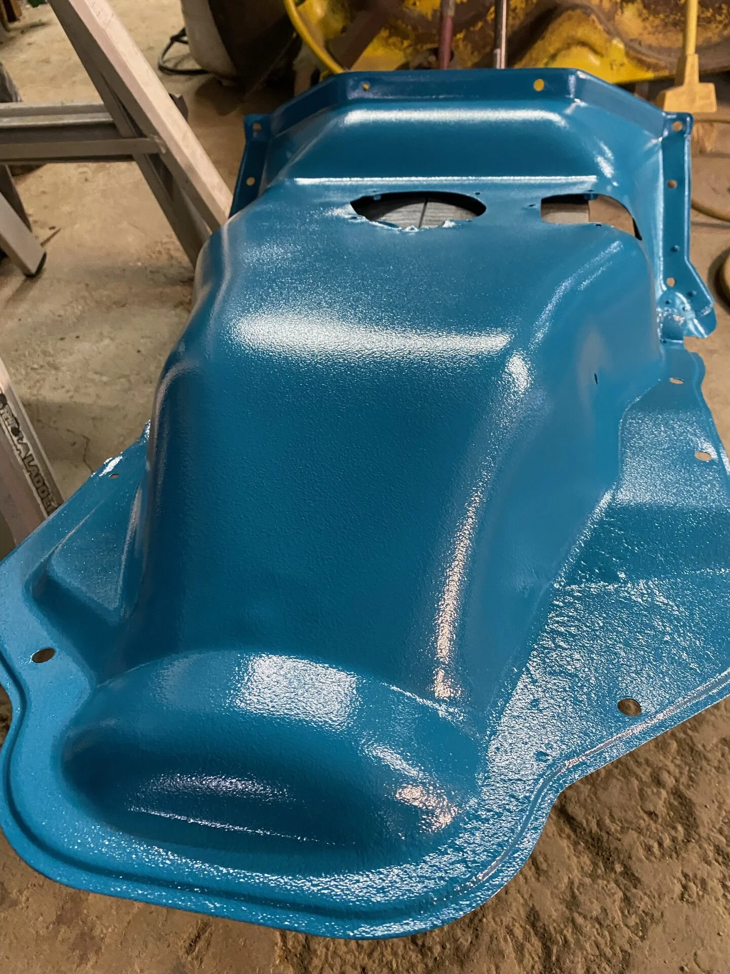

I took advantage of some milder temperatures to shoot some paint (Toyota 854). Got the gas tank cover, transmission tunnel, running boards and some hinges painted up. Should be able to install the tunnel & gas tank cover later this week, and get at least the driver's seat back in.

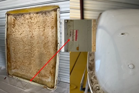

I tried to combine the photos so there are fewer but get the gist - it didn't happen if no pictures.

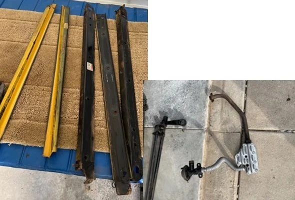

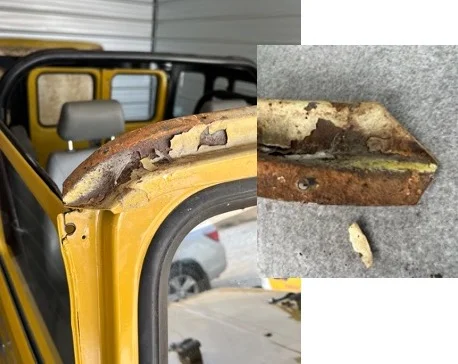

Doors rattle and also no bushing with the pins so ordered some hinge pins - but need roof off, ok - few broken bolts (3) (and I used Kroil well before) later and an assist, roof off. I Like the OEM part sticker (same in the 3rd picture)- not bad rust on drip rail but something missing in that first photo on the left.
Second photo - there you are - even though I had 6 of the 7 larger rivets looking from the top, none were actually connected inside (I would feel a breeze on my head on the highway and thought that's different). And Crusty Rusty there! Need to clean that, find a good replacement for those 7 rivets and reunite the two (it is Valentines day after all). Saw a thread for refinishing your roof and have watched @zerotreedelta clips too. Will pop off the rivets on rain drip and go from there - might be a summer project and just drive topless for a while.
Took the center link apart for rebuilding - parts soaking for cleaning as I type - will paint - do the drag link too - then put the steering back, sometime.

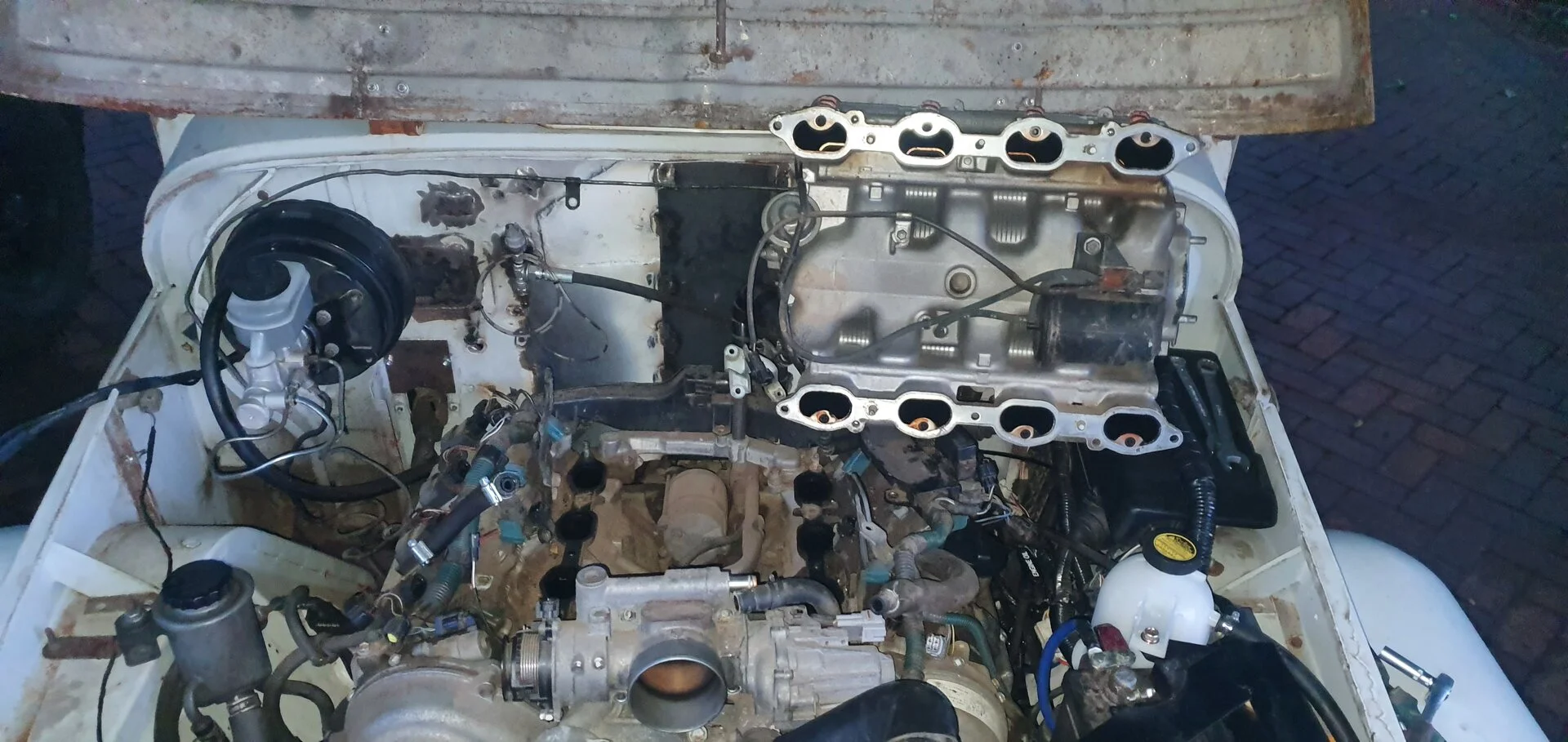

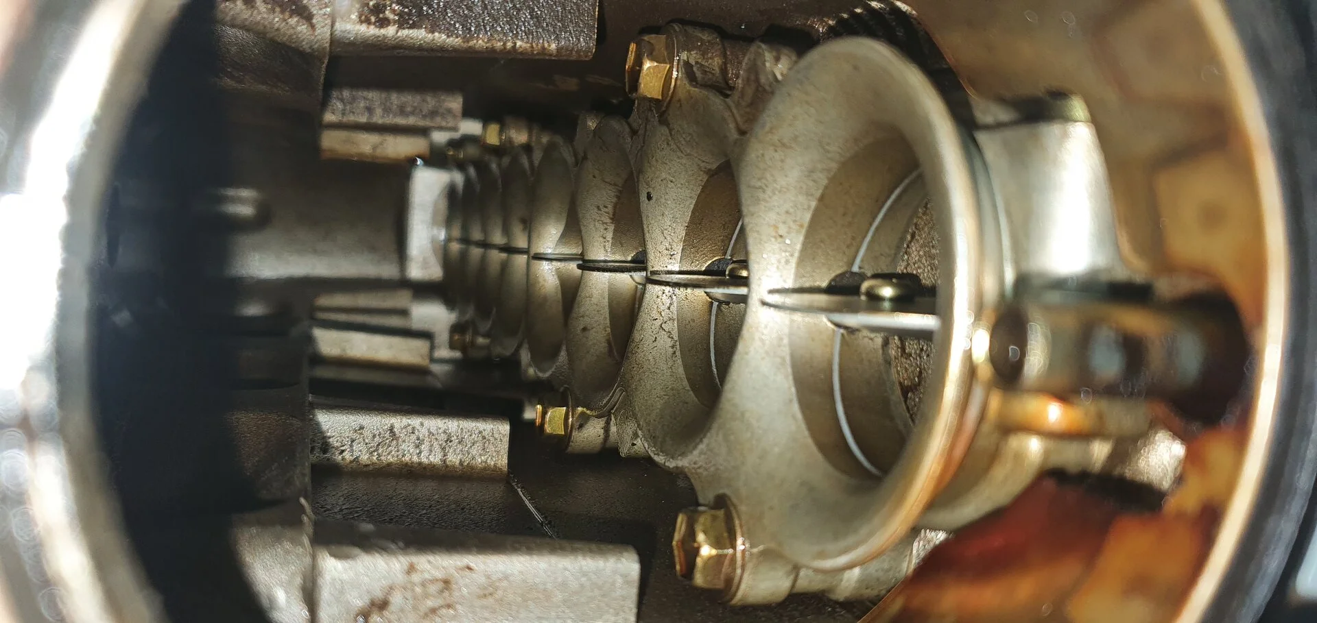

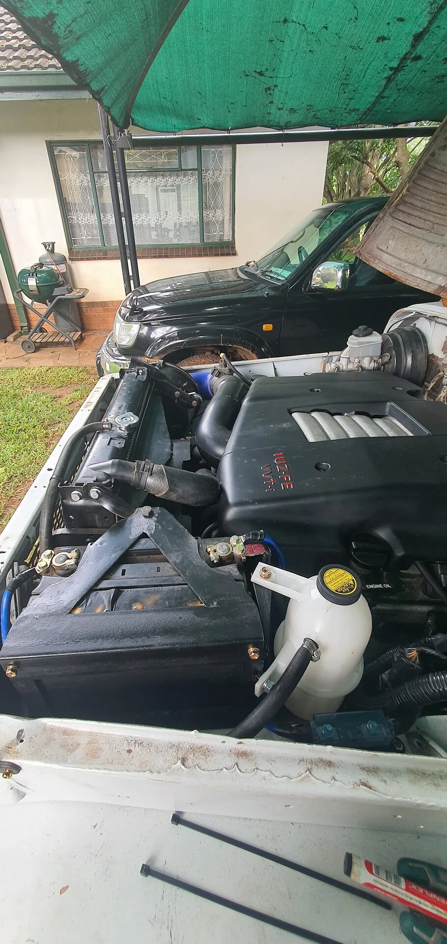

Starter motor was starting to die and I don't want to be stranded high and dry when does eventually go.
Anyone who has ever had to get at the starter on a 1 or 2uz knows what this entailed....
Intake manifold off
At least a good chance to clean up...
and inspect the intake manifold itself. Looks nice and golden
Put new contacts in the starter and put it all back together.
Now she starts on the first touch of the button

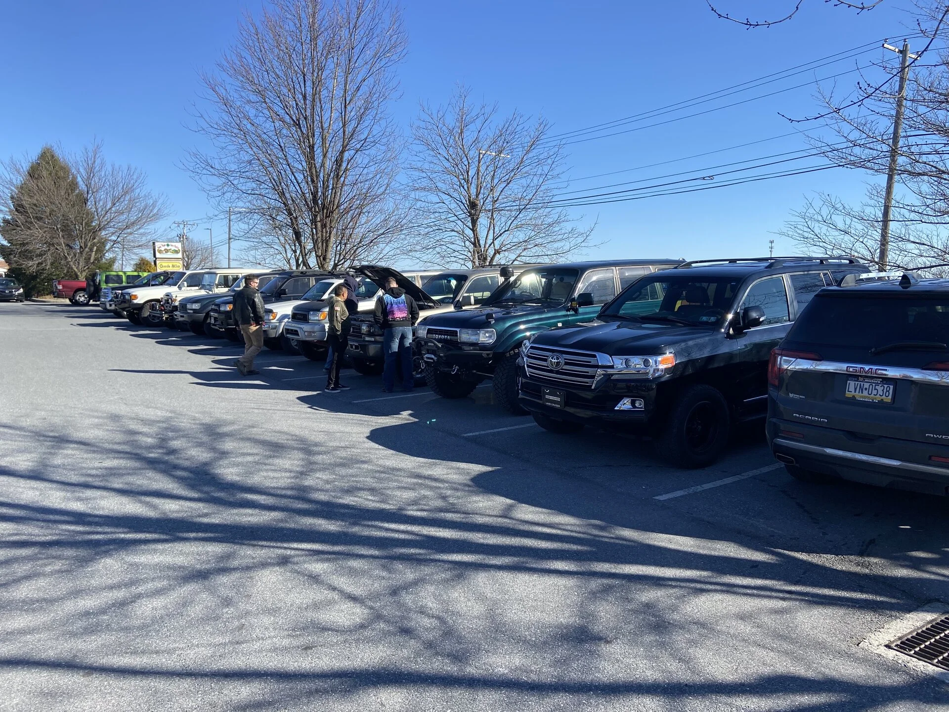

It has been a while since I posted, and even longer since I worked on the 40, but it is still trucking along.
I had it out for the annual Keystone Cruisers breakfast up in Lancaster, PA a couple weeks ago. Good times, and always good to see everyone.
The Clustertruck was the only 40-series represented this year - but the newer, fancy-pants rigs were out in full force. 😉
