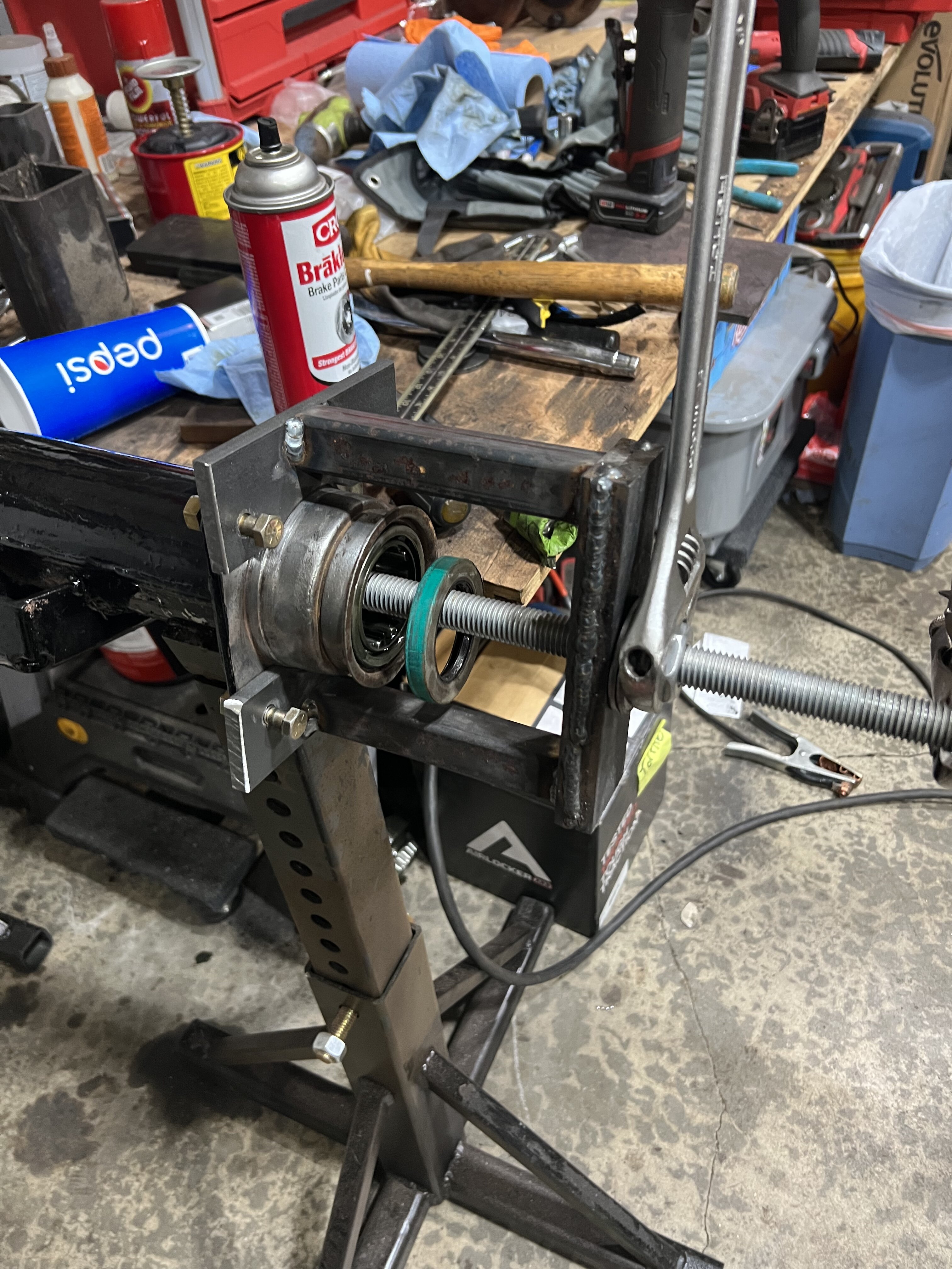

Need to replace the rear wheel bearings. Thought it'd be easy with the horrible freight bearing puller, but it wouldn't open large enough to catch the bearing. So I went to the local auto parts store and asked if they had the rental bearing puller. They did, and I thought I was lucky since it was brand new. Still no luck. I found that the spacers wouldn't fit and I need to hold a nut behind the puller deep in my axle housing.
So I decided to build one:
Used some strap iron and drilled 3/8th inch holes to secure to the caliber mounts. Doubled up couple more strap iron pieces, welded them together and drilled a 3/4 inch hole in the middle. Ran some all thread through the "right size" punch I had and threaded it through the 3/4 in hole. Tighten it down on two 1" tube legs and welded it together. Got the bearings loose, I just don't know if there are races and/or if I can get them out.
I'm hoping to use it to push them back in as well.

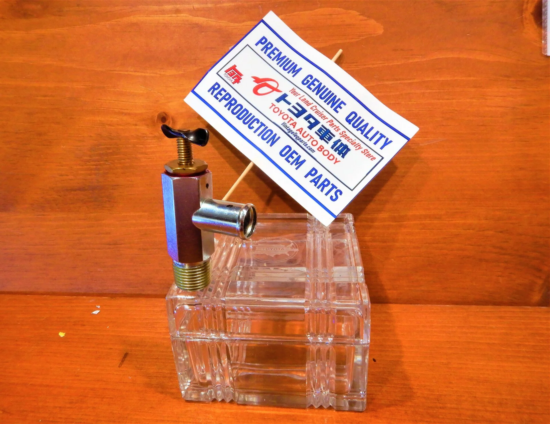

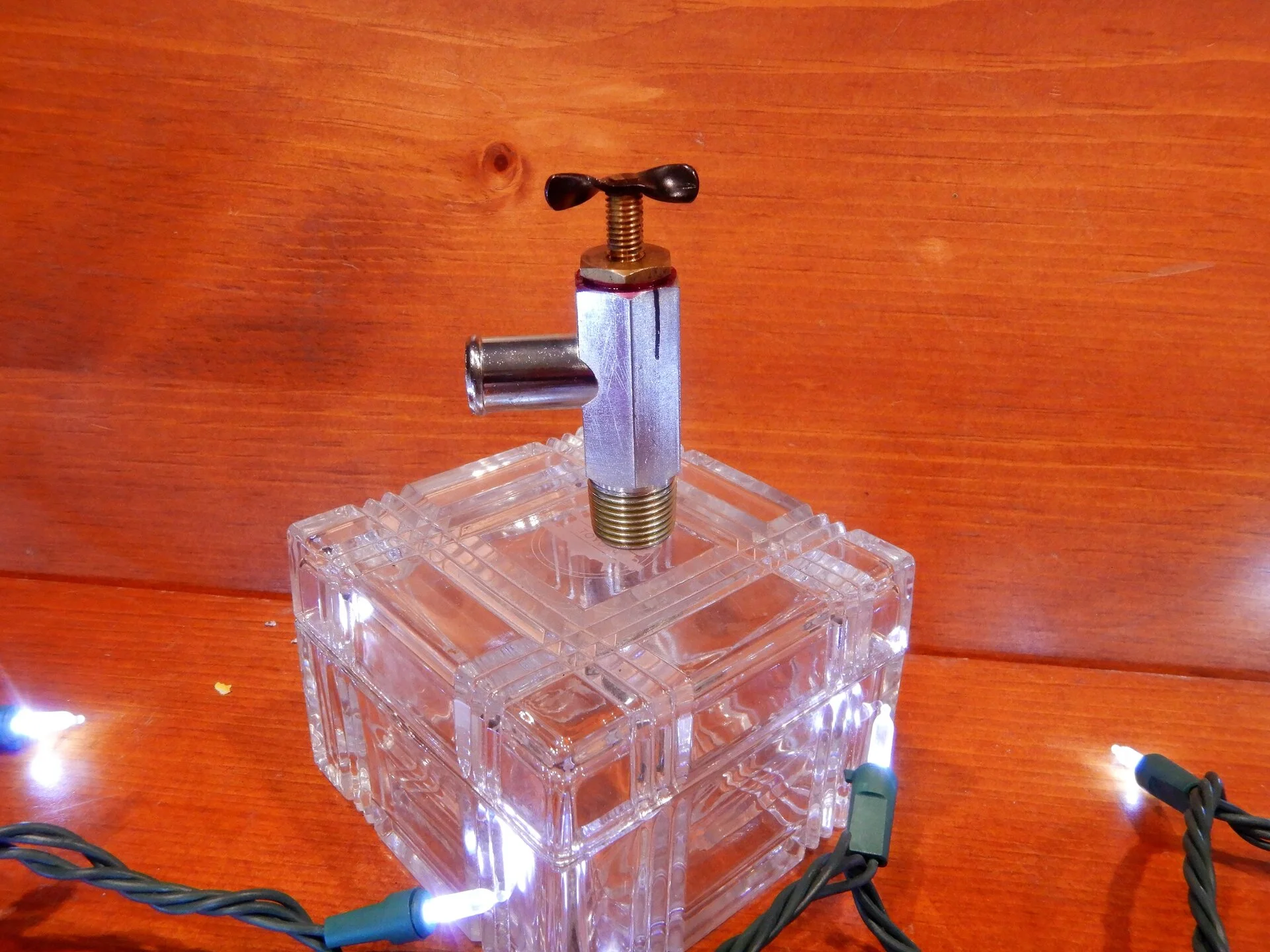

Matt: For completeness sake Vintage TEQ should also bring back from the dead the corresponding union that this valve screws into (I believe it is PN#90404-16164). That way folks could source from you the complete new shiny assembly for a true Plug 'n Play. What do you think?
This is the Newly Designed Valve Mark ,
It requires NO adapter , or additional Fitting for plug and play
The valve threads directly into a Cylinder Head or your Water Pump in fact too …
This is NOT the smaller FJ60 oil cooler system shut off valve that you remember from a few years ago ……🙂
It’s much larger in size then then it’s little oil cooler system brother
this valve WILL directly install and thread into ANY Land Cruiser Cylinder head in the F series platform : Siamese F , F1.5 , 2F , 3F Carb.
