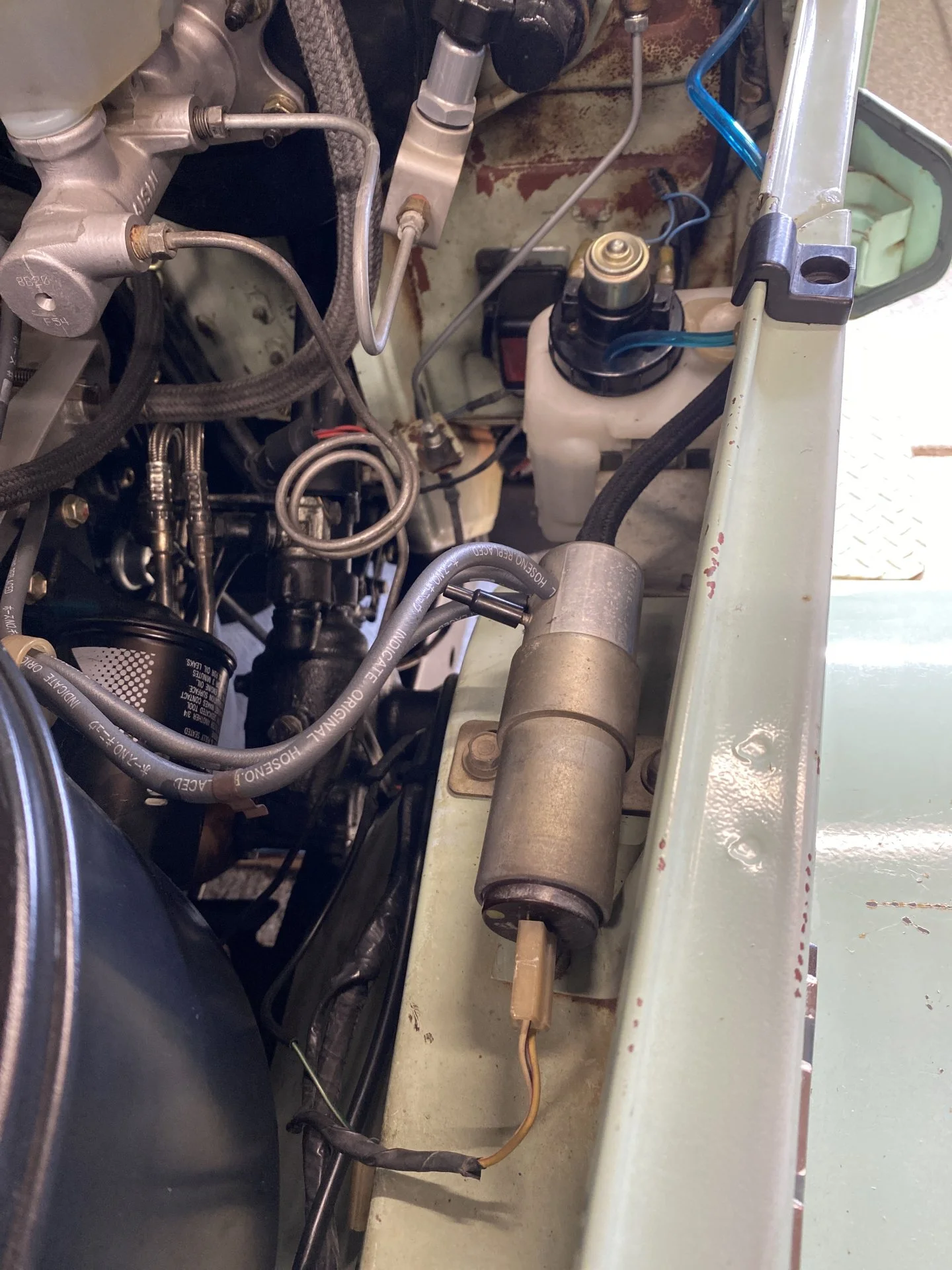

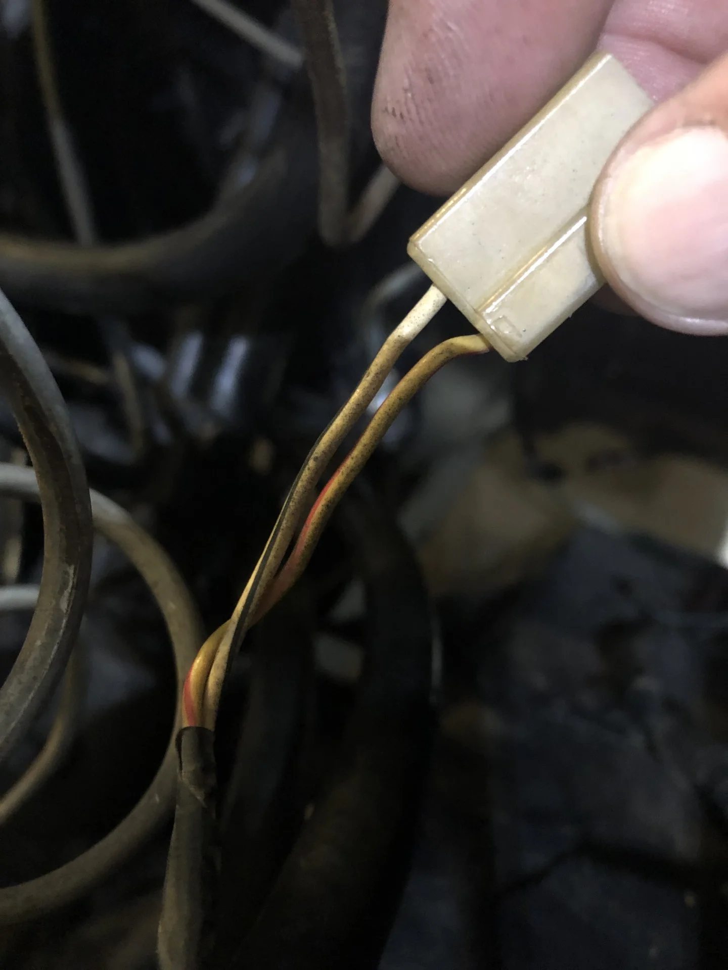

The above pic is a connector that exits the wiring harness just midway on the front driver fender. It isn’t plugged to anything and I haven’t been able to identify it with the wiring schematic. Does anyone recognize it? I feel like it should be obvious but I can’t identify it
Is this a CA cruiser? It could be for the carb cooling fan.
I'm assuming you have a 1970 by your Handle (@70fj40). It goes to the VSV (fed emissions for 1970)
Yes, 1970. Not a California model to my knowledge. Firemanj92 I think you are correct. Same wire colors and plug. Never have seen that part before.

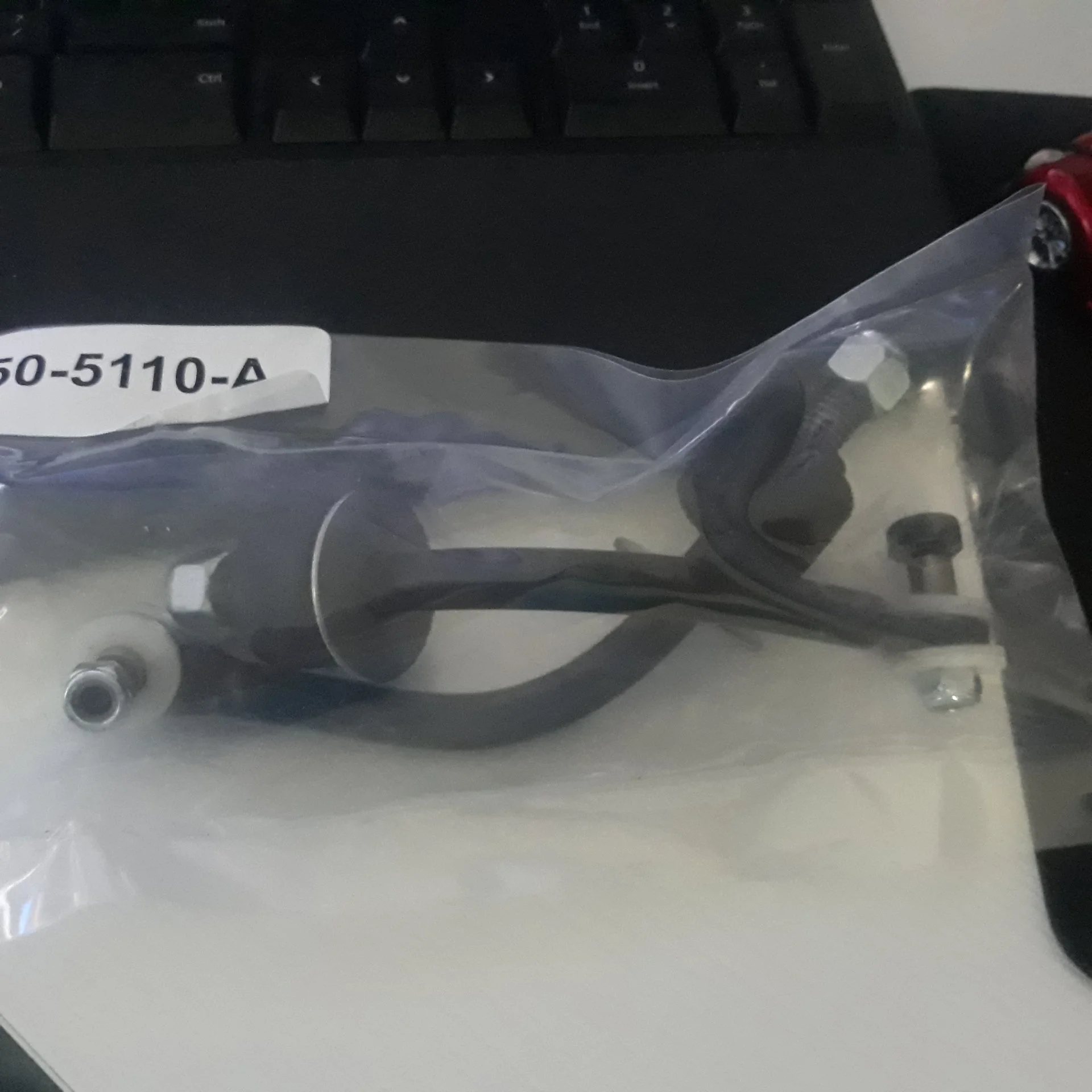

Just got these bad boys in today! Can't wait to install them, gonna have to wait a little bit as I'm going out of town for a few weeks. Any one know what these are?
Believe a lot people know what they are. Anyone who has a FJ40 up to 1/75 their cruiser had them when it was sold in the US. Depending on what model could be a little different.
Door stopper kit

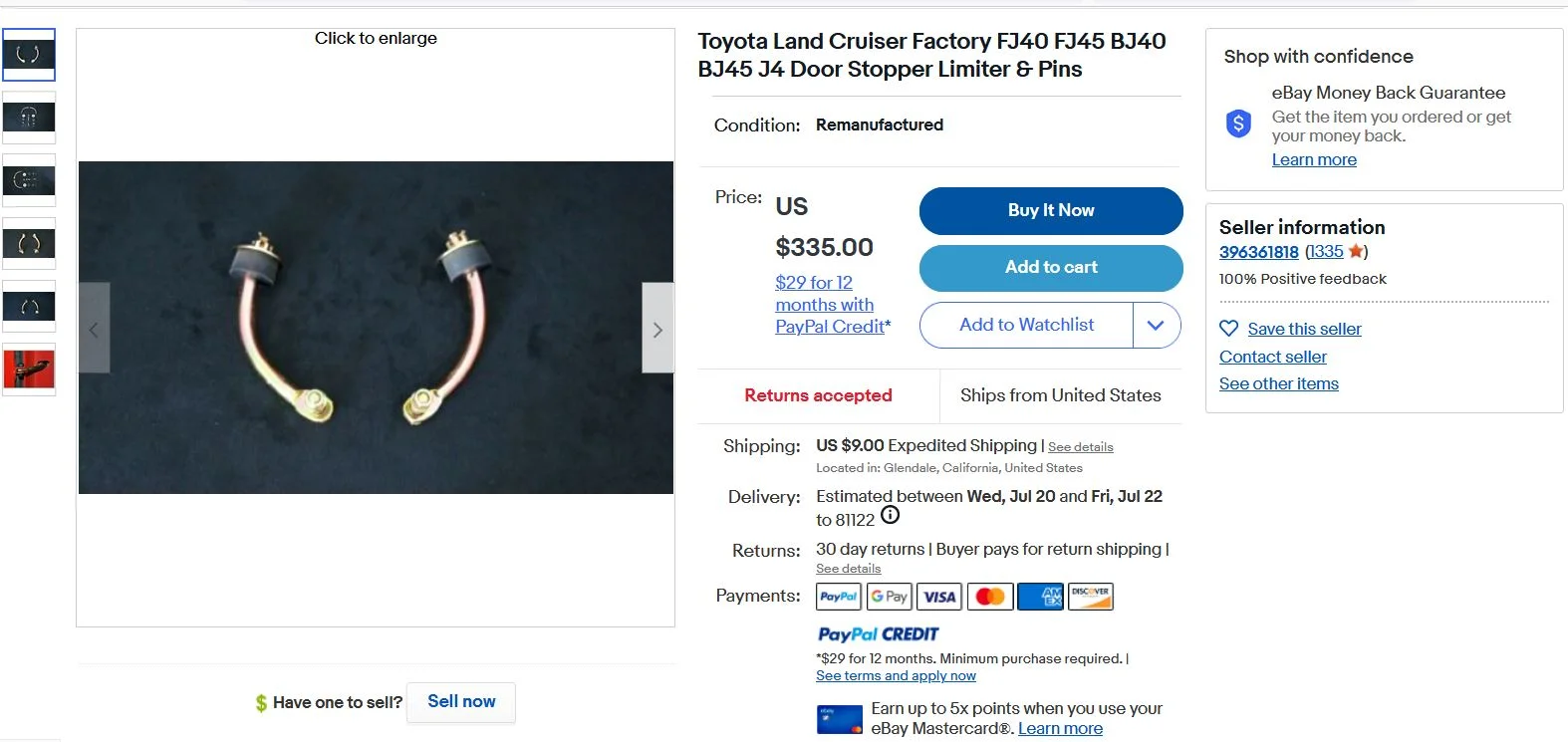

Some sellers on ebay think those are some sort of unicorn farts. I saw a set of rusty ones for $275.
Edit: My memory failed me. $335.
Last time I was at EBI Cruisers, Steve had a bin of those.

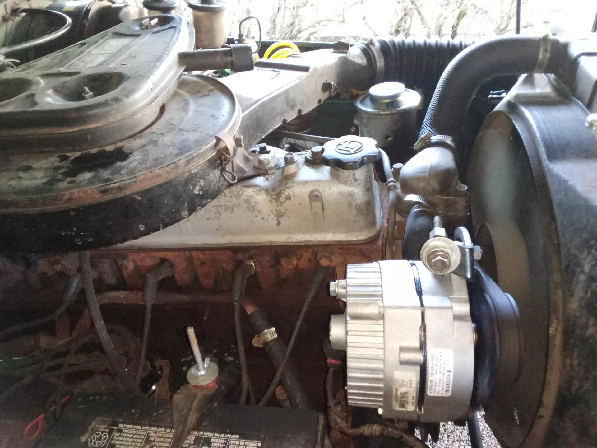

Alternator bearing was squealing like a pig this morning, I may have over tightened it a couple months back. Only 5 years old and still charged fine. Put Duralasts lifetime warranty to the test and got another for free. It's too shiny for my grubby engine bay. 🙂
