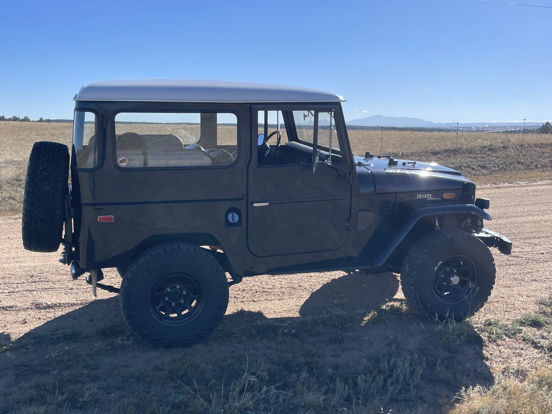

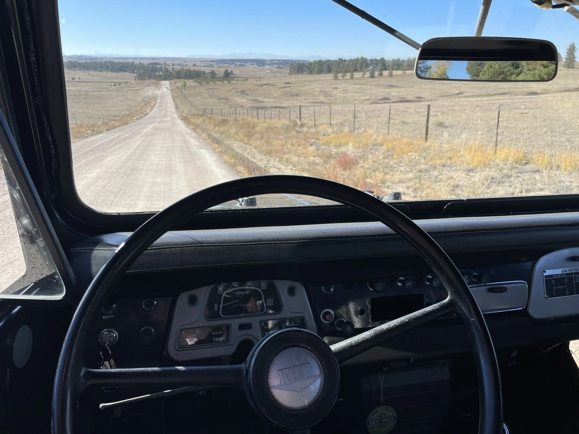

I drove mine around and took some pics. Loved every minute of it!

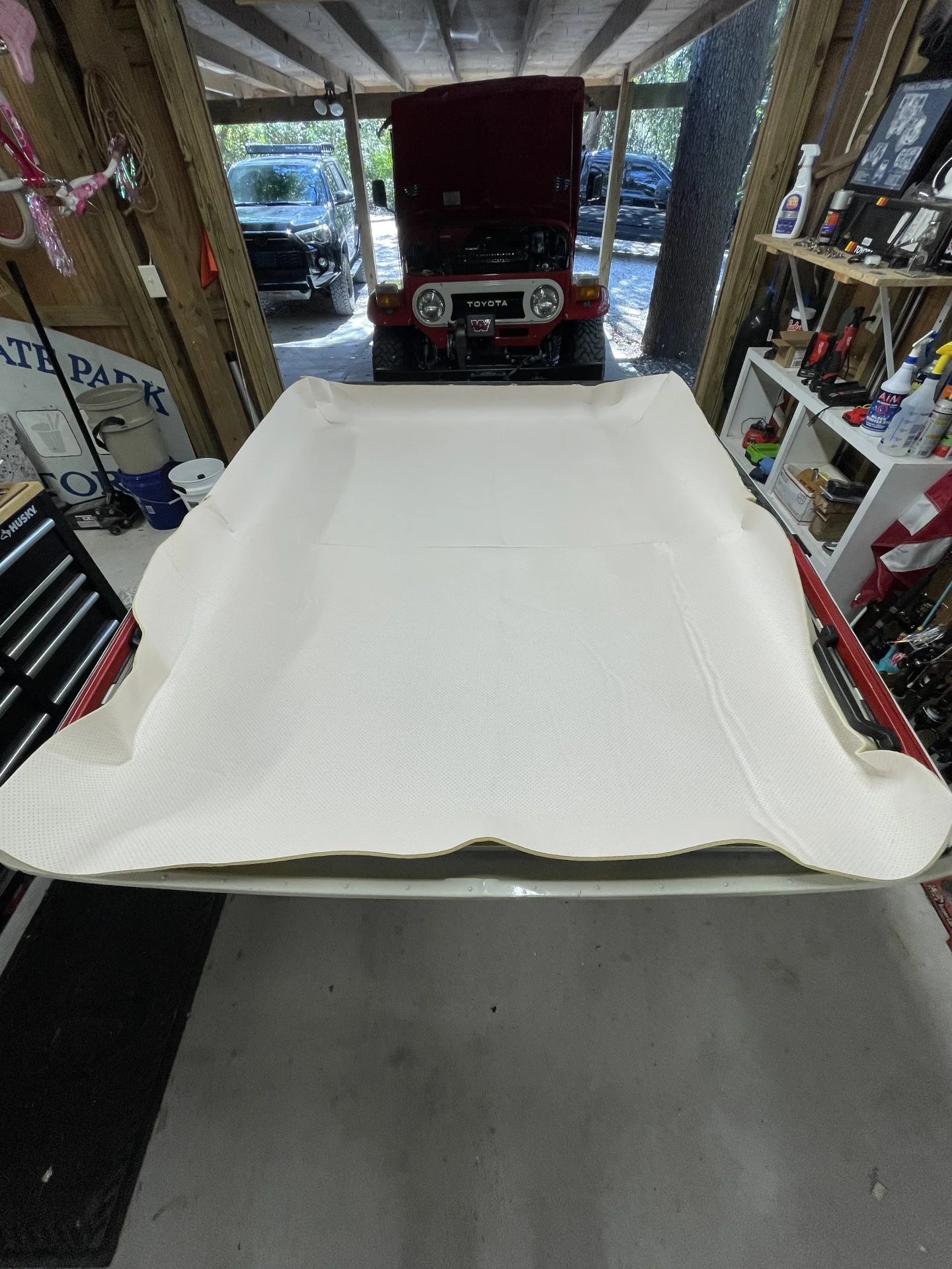

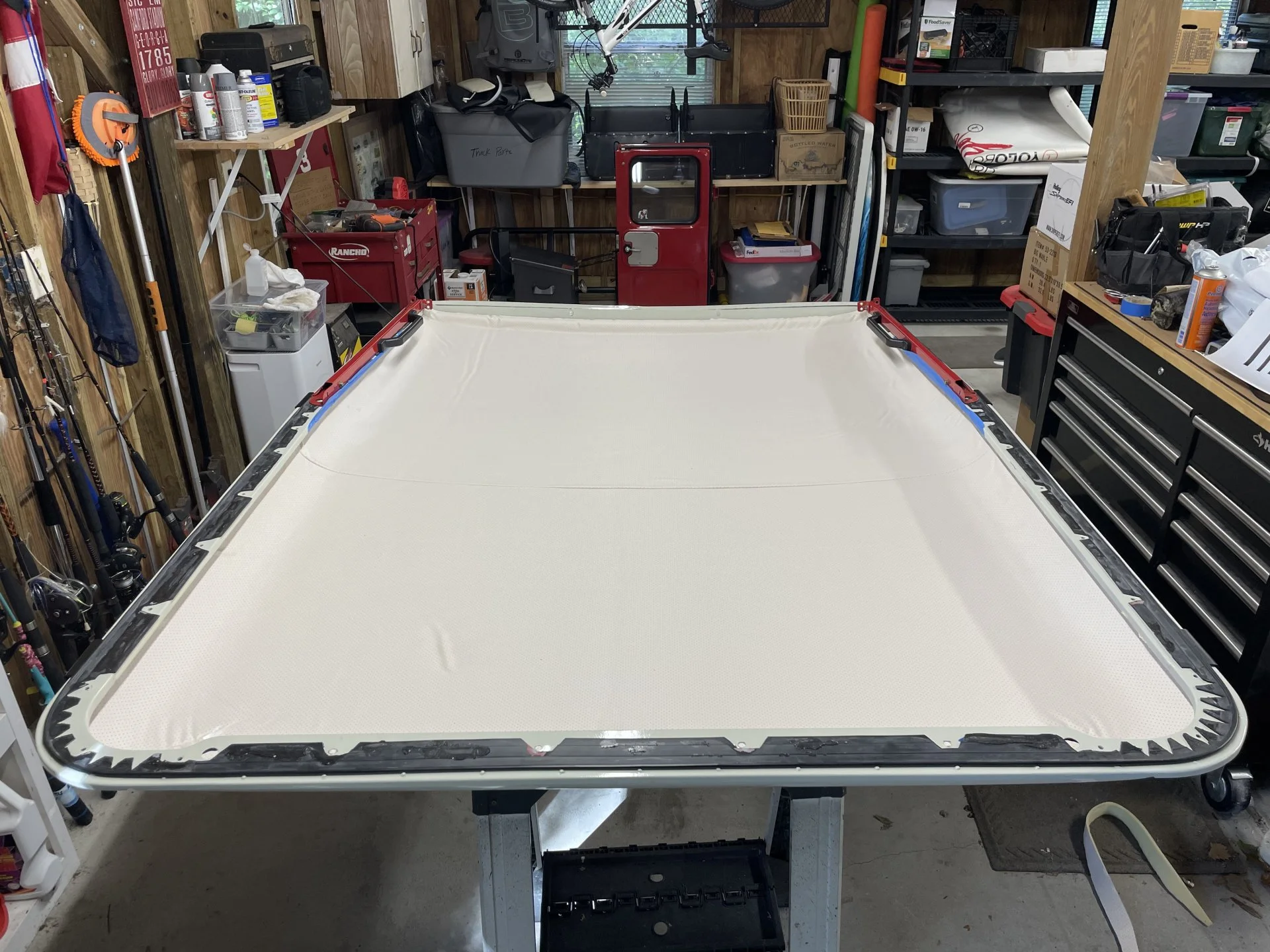

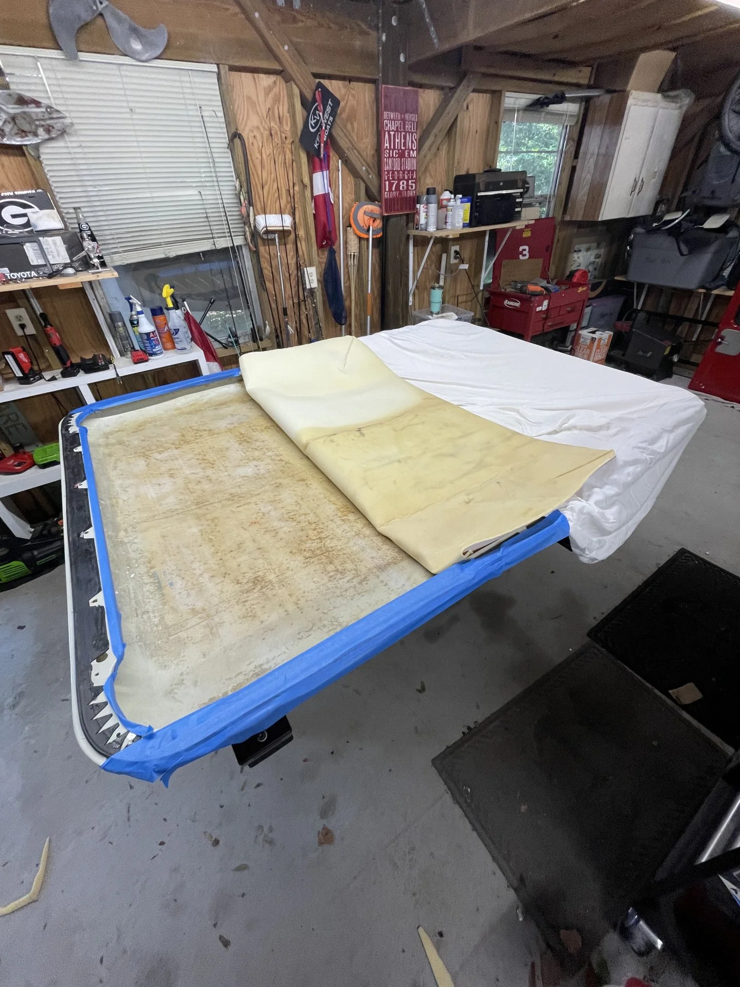

Tackled the headliner yesterday. First time doing one. Watched a couple vids and read some posts. A little help from a few members as well. Not perfect but ok for my liking. Definitely better than before.

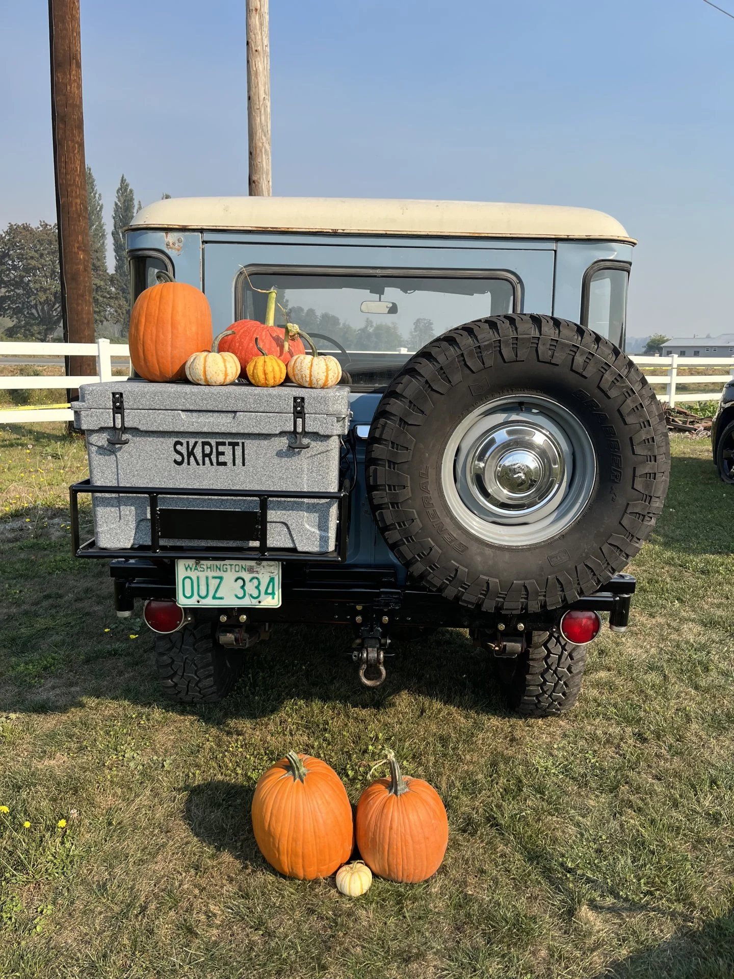

Went to the pumpkin patch. Crazy year, would normally be happy to have a day in mid October with light rain and upper 50’s. Today was 80 and so smokey you can’t see half a mile.
Yap, same mess up here.
Looks like you still had a good day out though 👍🏻
How do you like those Generals?

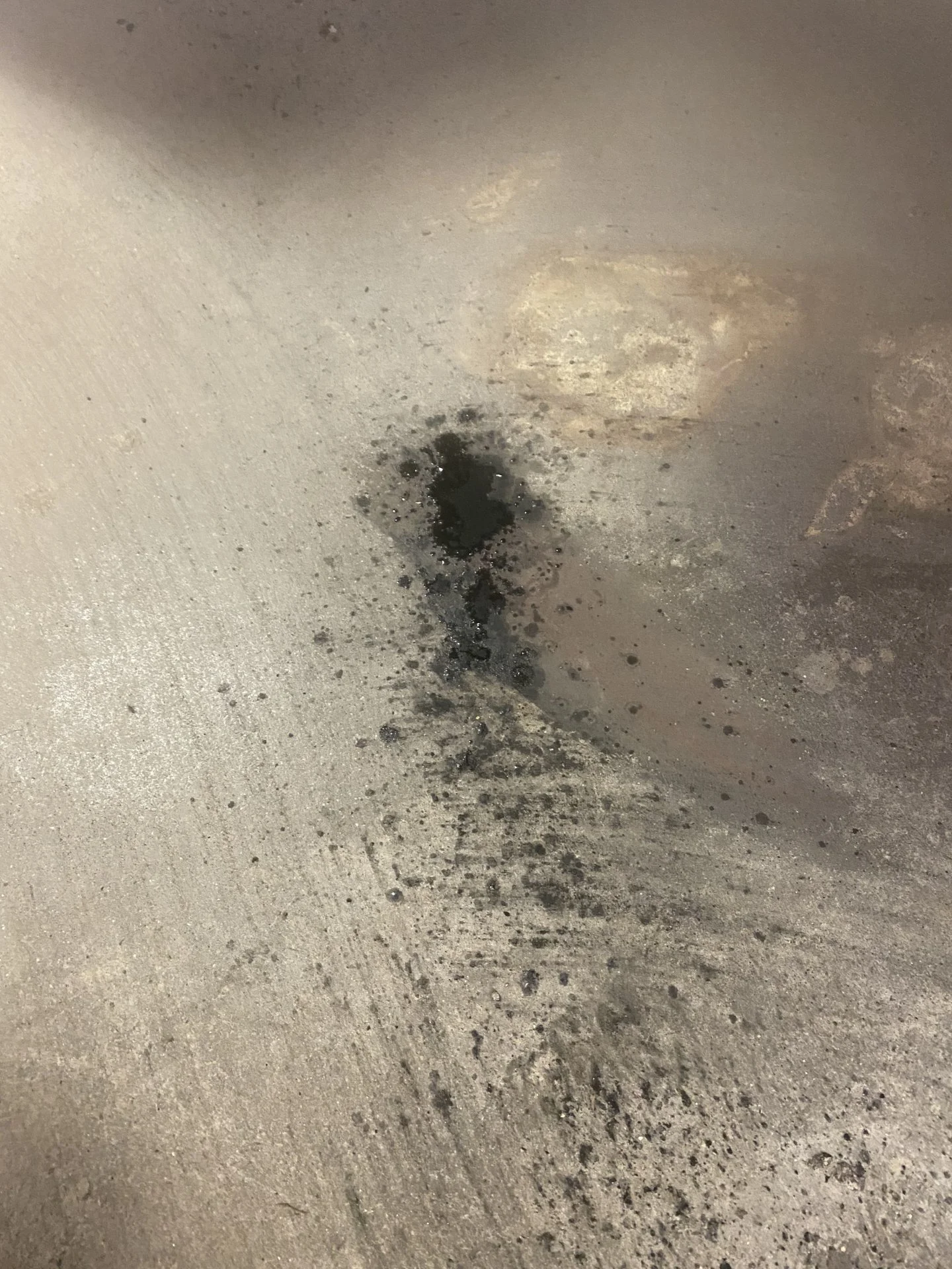

Well, today was eventful...
The first start in 22 years, got the timing set, the first oil change in 22 years, and the last flushed the coolant. It's running great now. All I need to do I run my PCV valve line to my intake and my valve cover breather to my air cleaner.
But then I blew a line going to my slave cylinder somehow?...
So after running the engine for a bit, I'm questioning two things.
1 - Is it normal to have white smoke coming out of the valve cover
2 - what is this black substance coming out of the exhaust? It doesn't feel like oil.
Smoke coming out of the valve cover could be excessive blow-by which will also show as carbon/water mix in exhaust.
What's a fix for that?
Well after sitting for 22 years I would just drive it for a while and watch it. It could be stuck rings that may free up. You could pour ATF into the cylinders and let it sit for a few days to maybe help free them up.

Did you park it 22yrs ago or did you just get it? How did it run 22yrs ago? I think it's to early to tell what's going on. Drive it a bit and see if it clears up. The white smoke is probaly moisture, it could be condensation from sitting so long. The blk is carbon, it maybe running rich. Sitting for that long it may need a rebuild. Again Drive it a bit, and baseline it. Adjust valves and such.

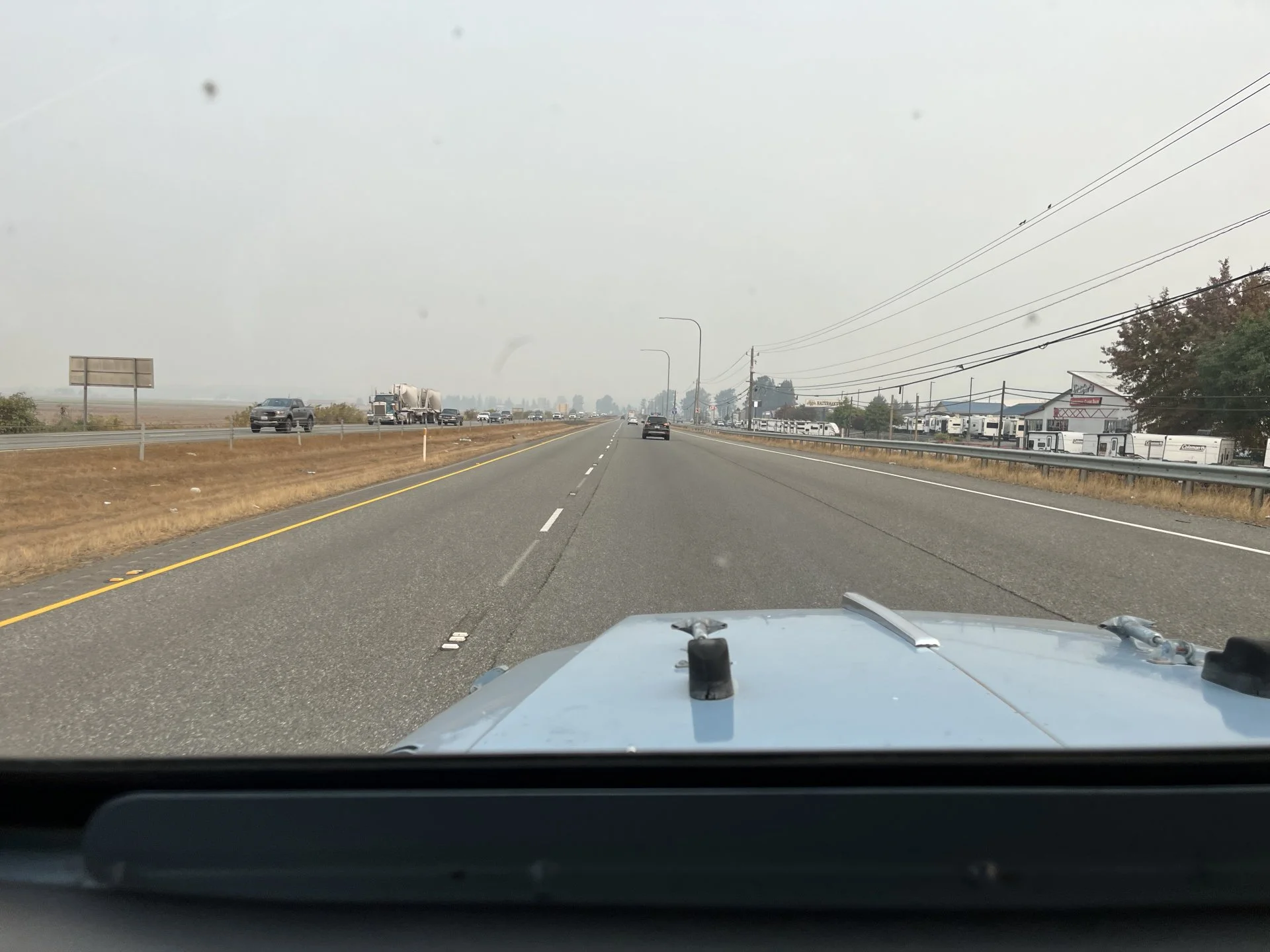

Took a pic of the smoke, doesn’t look as bad as in person. Rain Friday….
I took my 3 year old for a cruise today to kill some time. Ended up at my dads house about an hour away. Was coming back down the long steep hill he lives up and was in first gear letting the engine keep the speed down when BANG! and the speed picked up and the engine just free revved in any gear. Stopped at the bottom and nothing obvious. Ugh, maybe 4wd can get us home? The t-case had popped into neutral. Forgot the 3 year old was playing with switches and levers, must’ve got it half out of gear.
Took a pic of the smoke, doesn’t look as bad as in person. Rain Friday….View attachment 3144405
Blah, hopefully you get some of the weather coming this way over the weekend to douse those fires. We still have a few burning here but they benefited from some rain a couple of weeks ago.

The PO had put it in a barn 21-22 years ago. Have only had the cruiser for about 6 months.
I agree I need to get this thing on the road and drive it to figure out what's wrong/if anything is amiss.
The water could just be condensation.
I just woke up my sbc sfter sitting 15yrs this spring. Keep an eye on the oil and other fluids. Motor oils have detergents in them, so Increase oil change intervals. I changed mine after about 1k miles. Get some heat in the engine, try to make longer trips. Moisture maybe coming from the engine and collecting in the exhaust and needs to evaporate. Moisture in the air will contribute too. If your concerned do a compression test.
