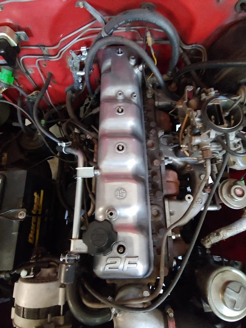

Scotch brite green, simple green, and steel wool (most effective) treatment on the valve cover.
A little bummed I have to cover most of it with the air cleaner assembly :meh:

Finish it off with some AUTOSOL and you’ll be finding a new air filter so that you can use it as a mirror when needed.
I’d recommend coating it with a good automotive wax regularly to preserve your hard work. The other thing I’d mention is if there’s any paint or clear coat (on covers), paint stripper saves a ton of work.
Edit: on second look, your’s looks painted… so polishing it to a mirror finish would require stripping it first. If the paint is still good, I’d not go down that very tempting, shiny, road.

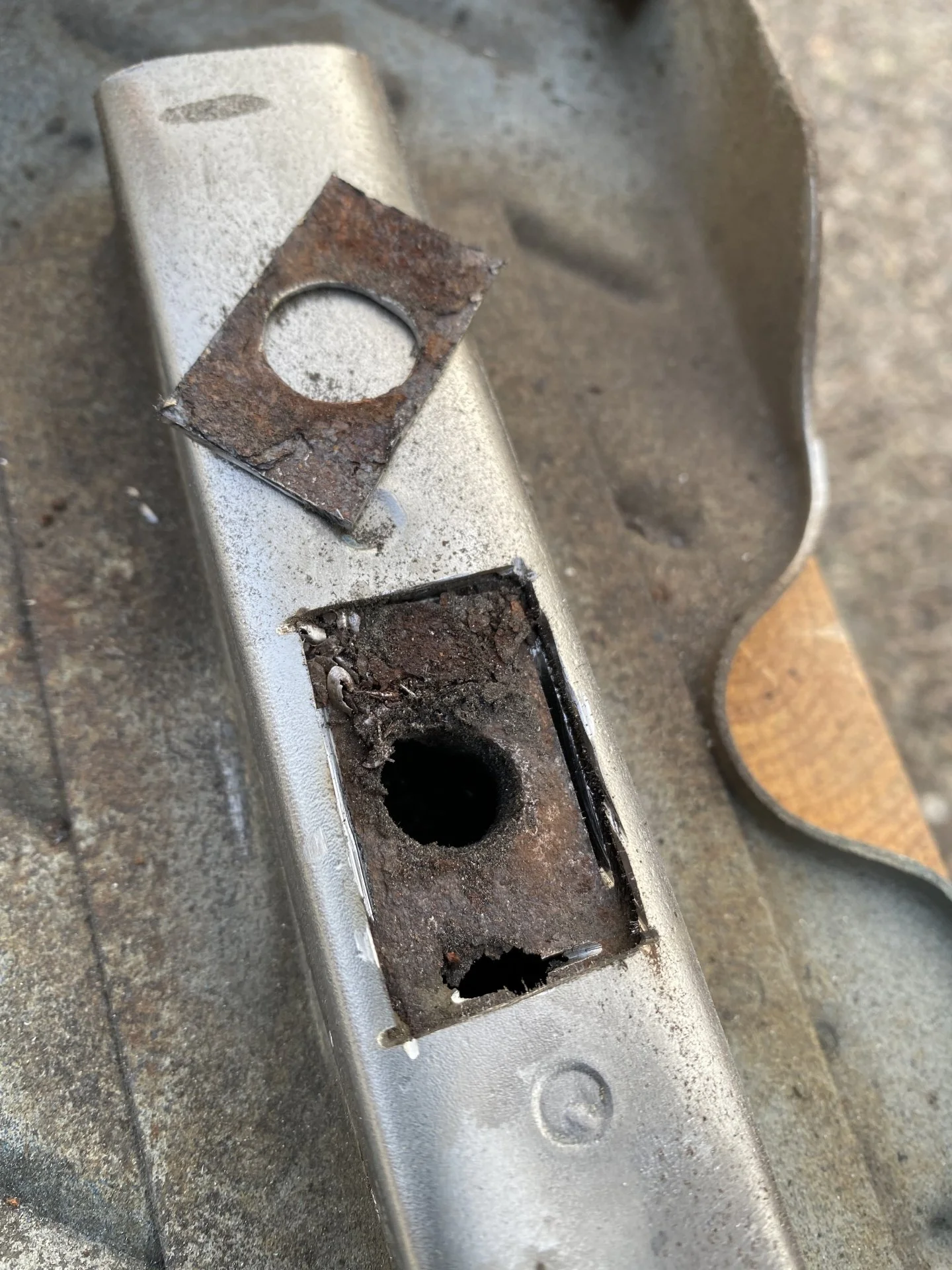

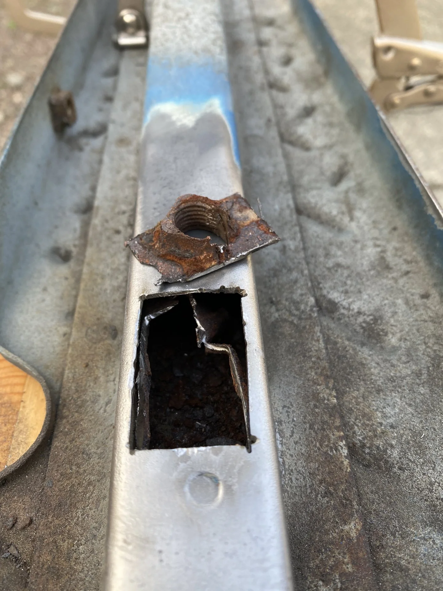

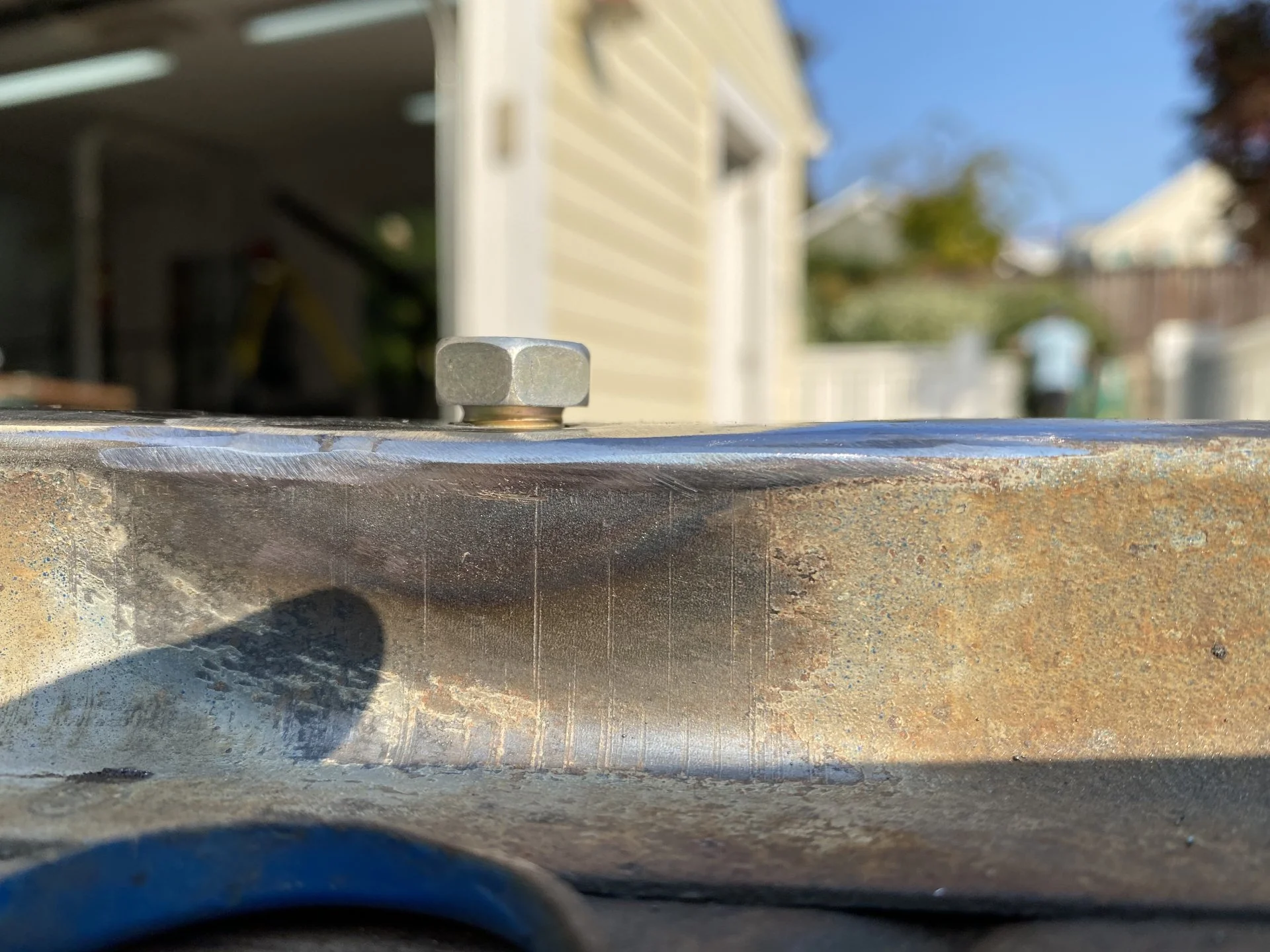

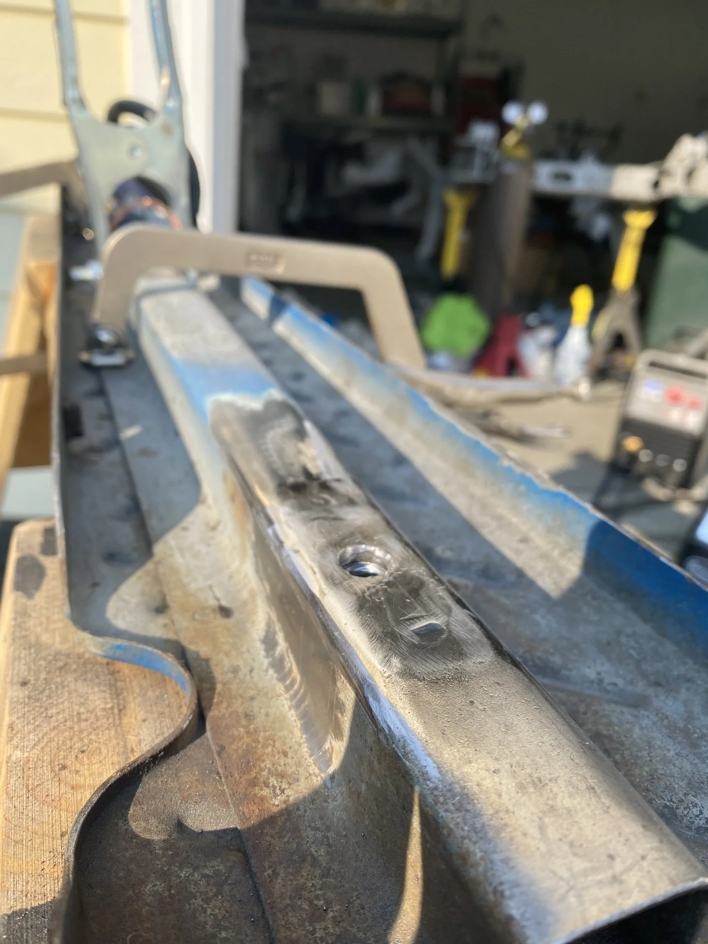

When replacing one captive nut takes half a day. Locating it the same as the opposite side is important so the running boards line up.

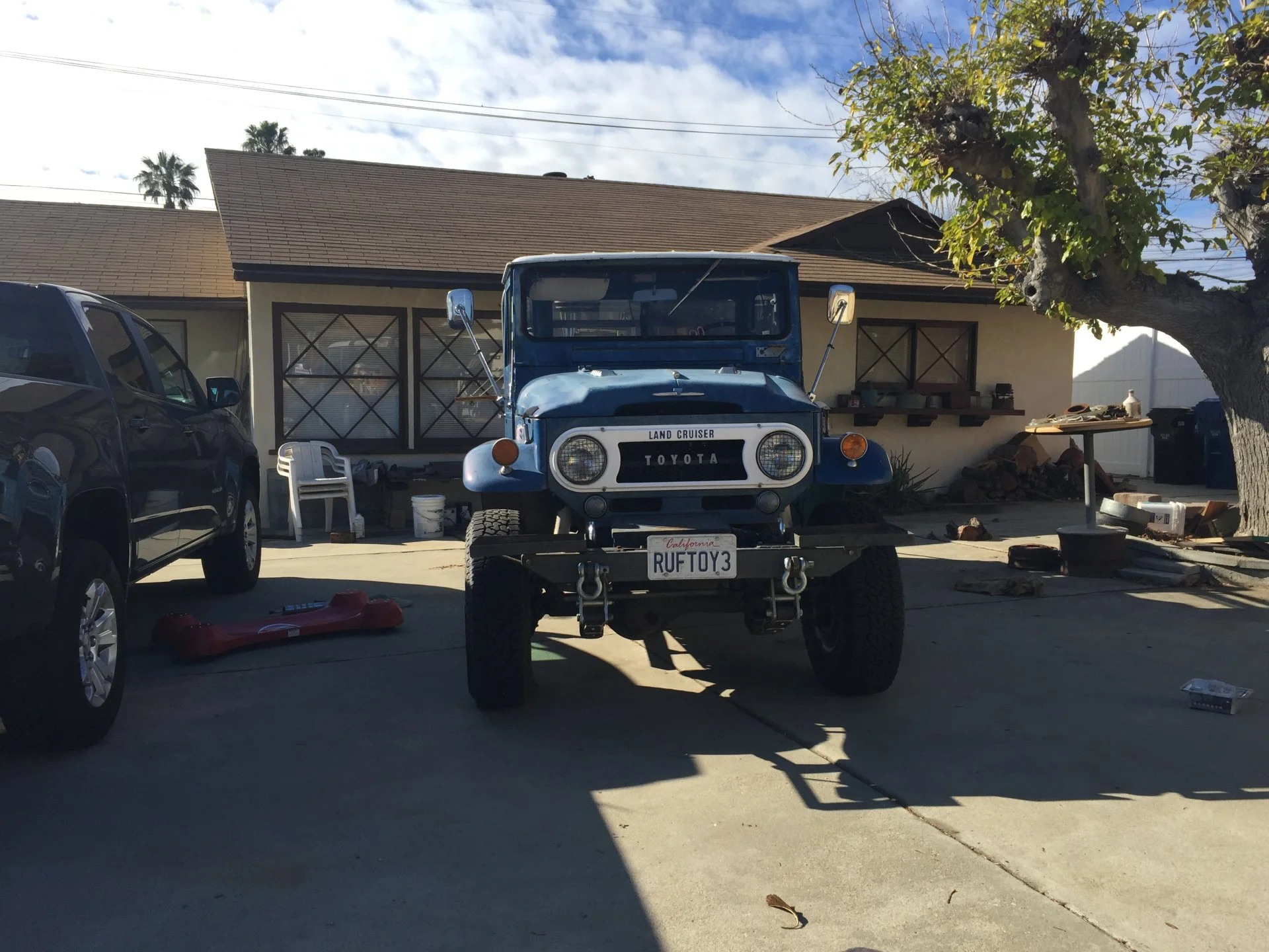

Second mirror is fairly common. Had many pre 68 40 series that had them as not. When I bought my 45 back in January 1997 the PO had mounted two non stock mirrors on each door. Have some actual pictures from Lincoln, California the day I picked it up. Didn't have a
FJ25 chrome emblem on the hood like yours but PO did drill a hole in the chrome ornament and put part of a trophy of a quarterback throwing a football mounted.
Took a while but about forty years ago found a LAND CRUISER stamped bezel.
Wasn't until this century found out the grill did not have the Land Cruiser emblem. Took awhile but found a grill prior to Toyota emblem. That was probably fifteen years ago. It's still in the unopened box it came in. Maybe my next birthday I'll open it. Not the only unopened box I have. I possibly may have some type of disorder. My wife bought me this coffee cup.
