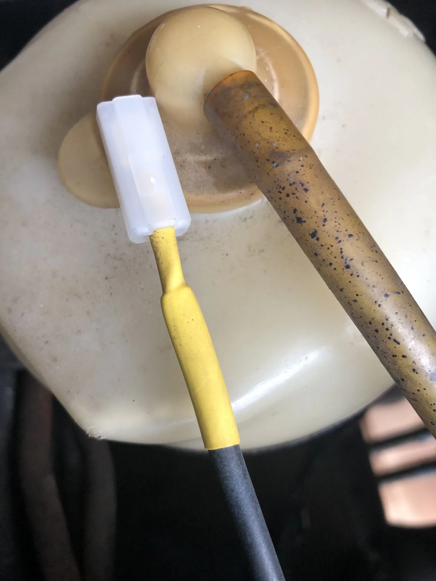

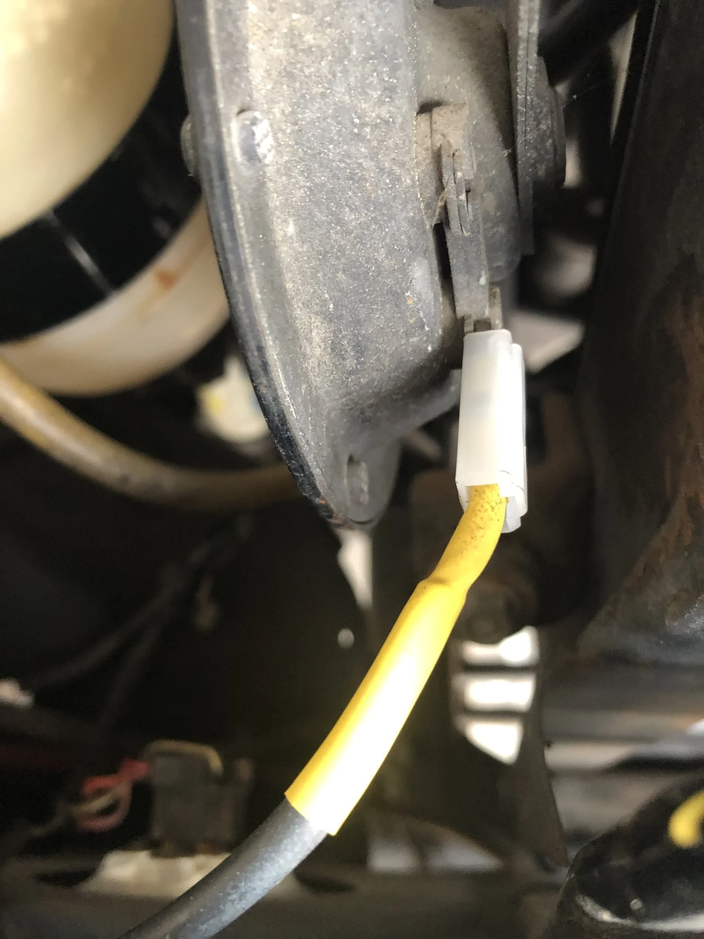

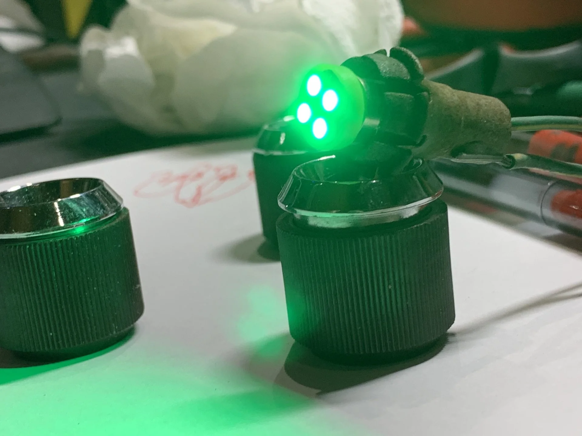

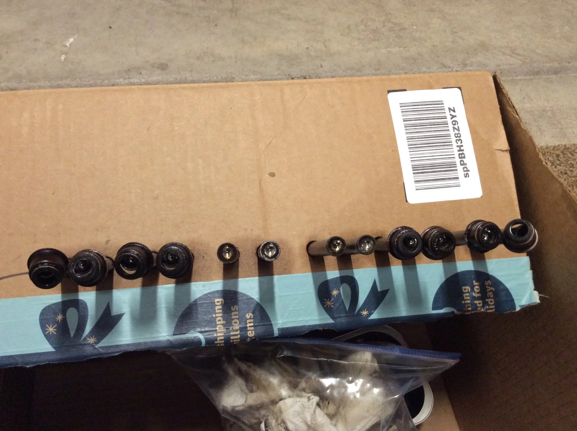

Some of my connectors are getting to the point of being unserviceable. Doing some replacement therapy.

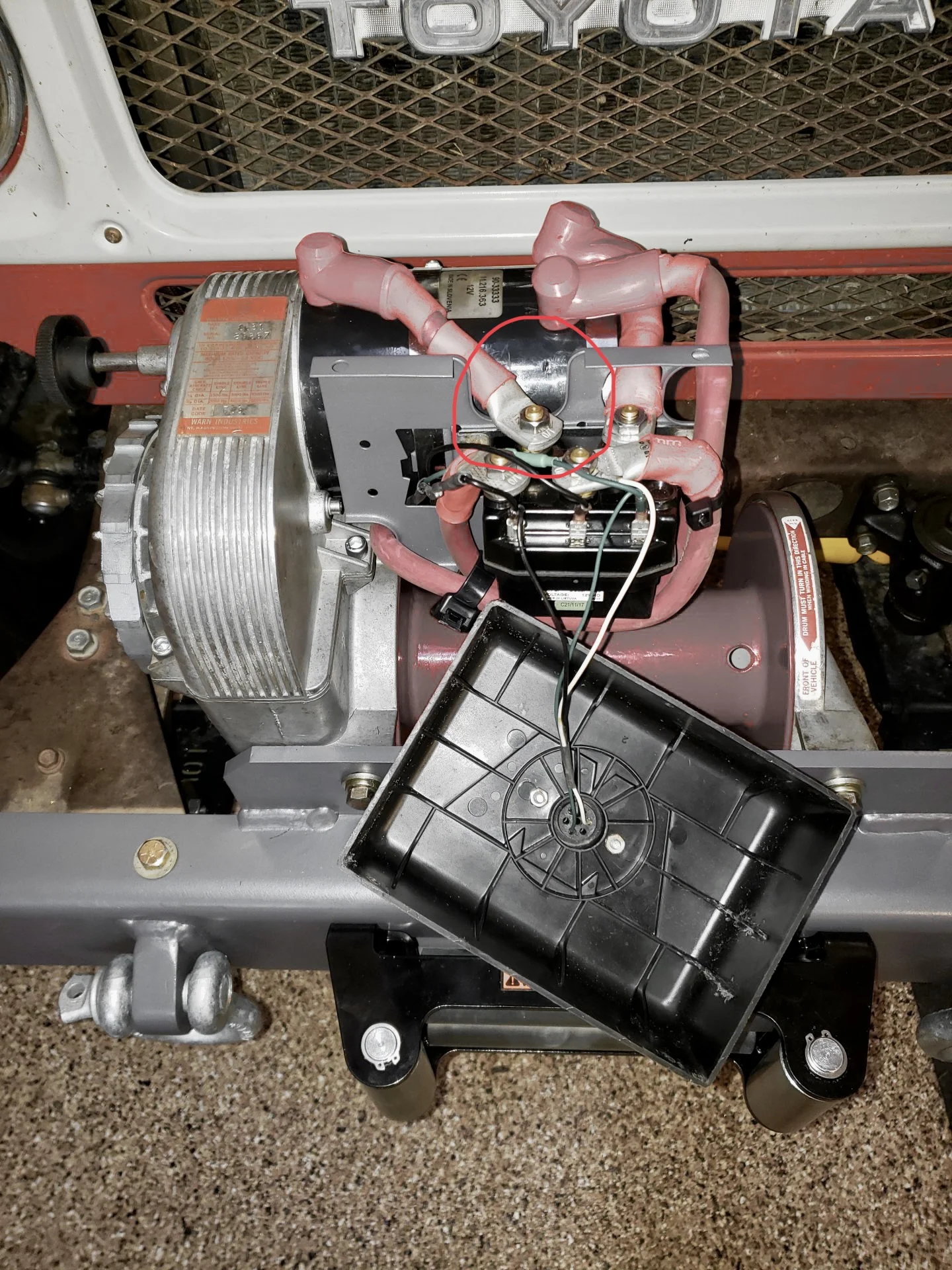

Hey, thanks JDNs78FJ40! Here you go... it was a tight squeeze and I had to modify the backing plate, but I got it together! View attachment 2954931
and I highly recommend a couple extra wraps of electrical tape (or shrink wrap insulation) on the wire end of the connectors at the solenoid. The connector that runs from the left side of the solenoid to the motor bent down a little on mine to where it was arc’ing on the metal solenoid cover. (Arc’ing probably an understatement… it was more like a fireball when I pushed the button to retrieve the rope. I thought I had fried the entire motor and solenoid! 😳)

Oh, OK... you mean the controller (little) wires, right? I was thinking I should probably heat shrink those like I did the ones that go to the cab controller. I still need to take it apart to put gear oil in it, so will do that... super easy.

No the red heavy gauge wires where they run thru that grey metal plate between the solenoid and the motor. Especially the wire on the left.

Thanks for the arc’ing advice.

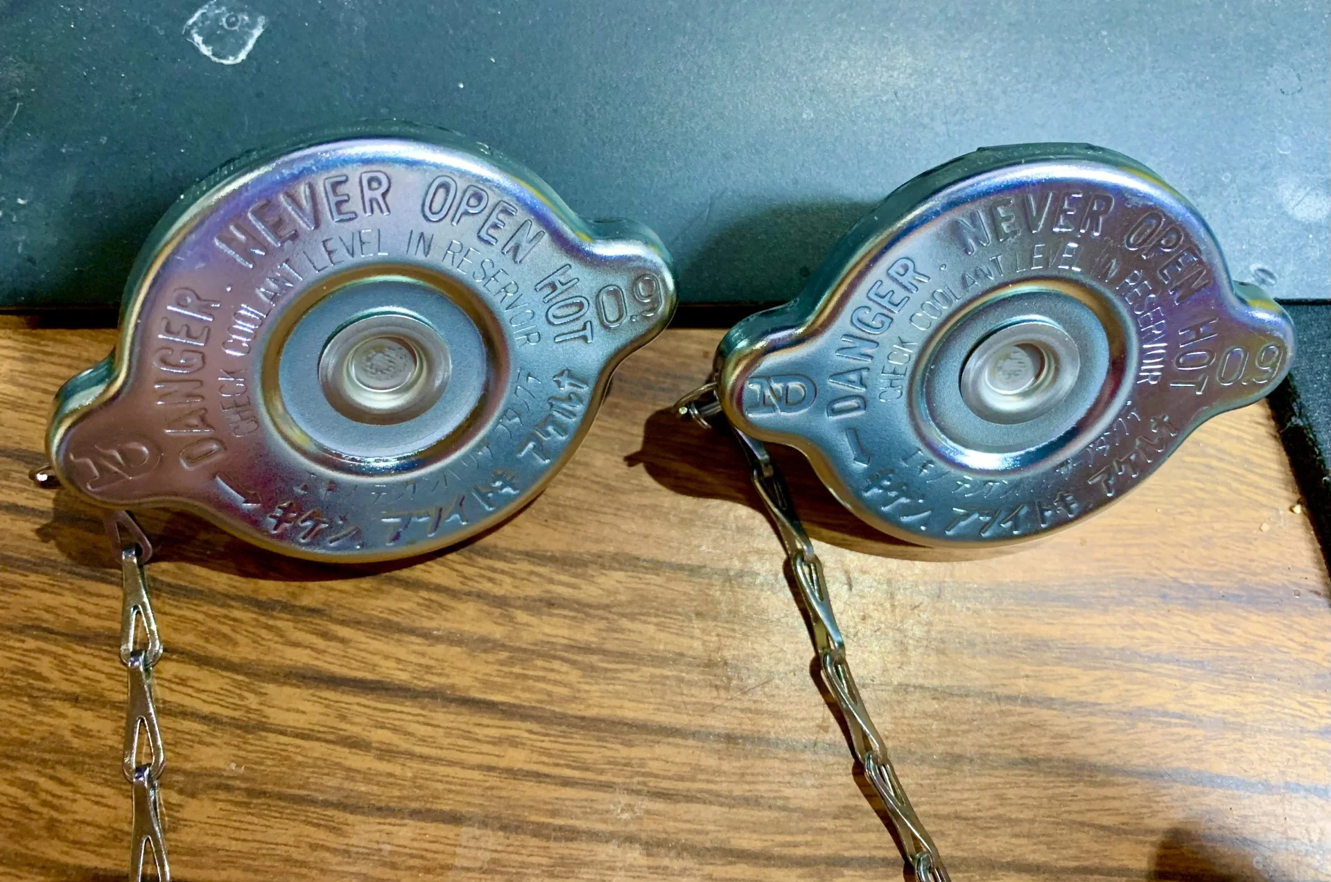

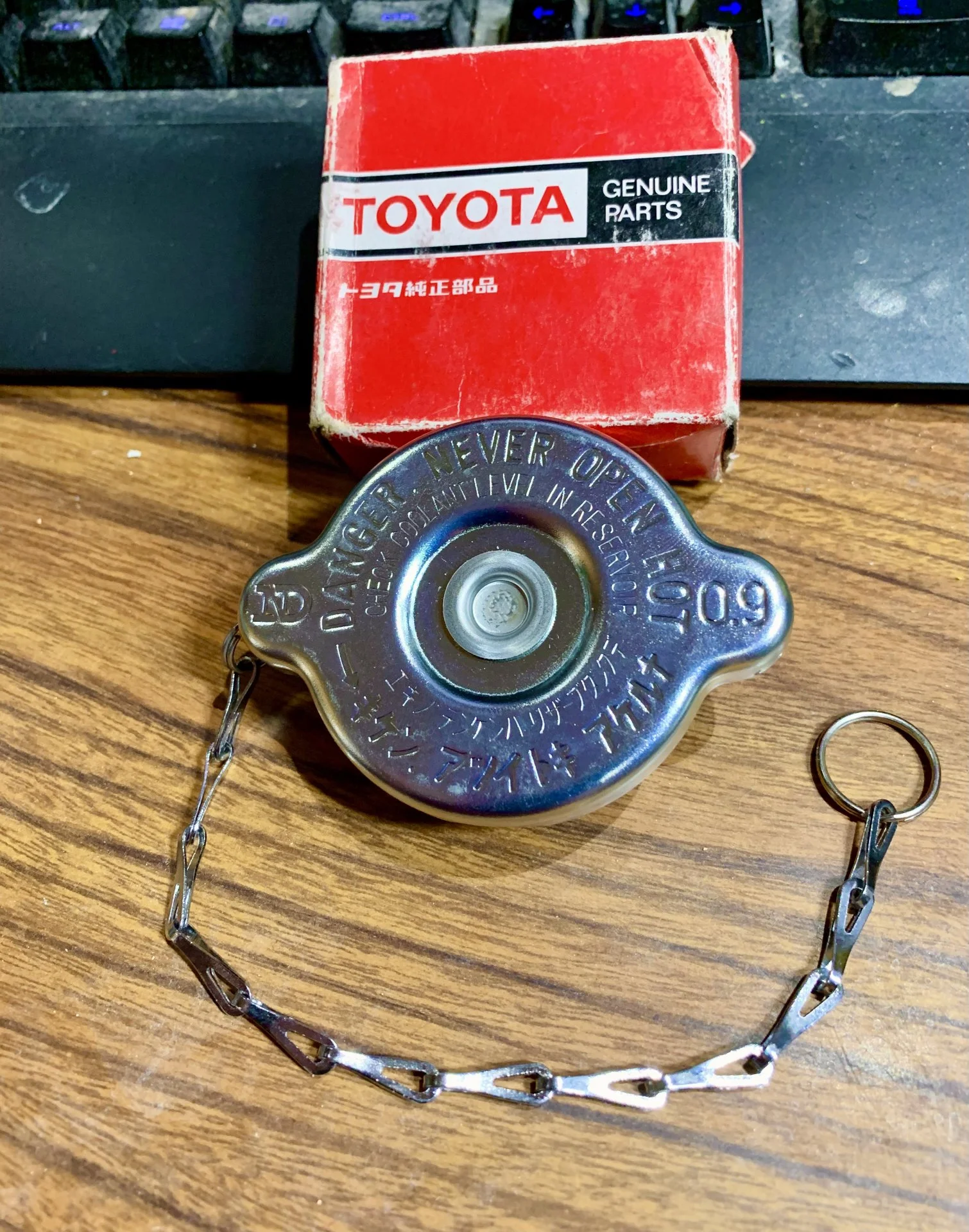

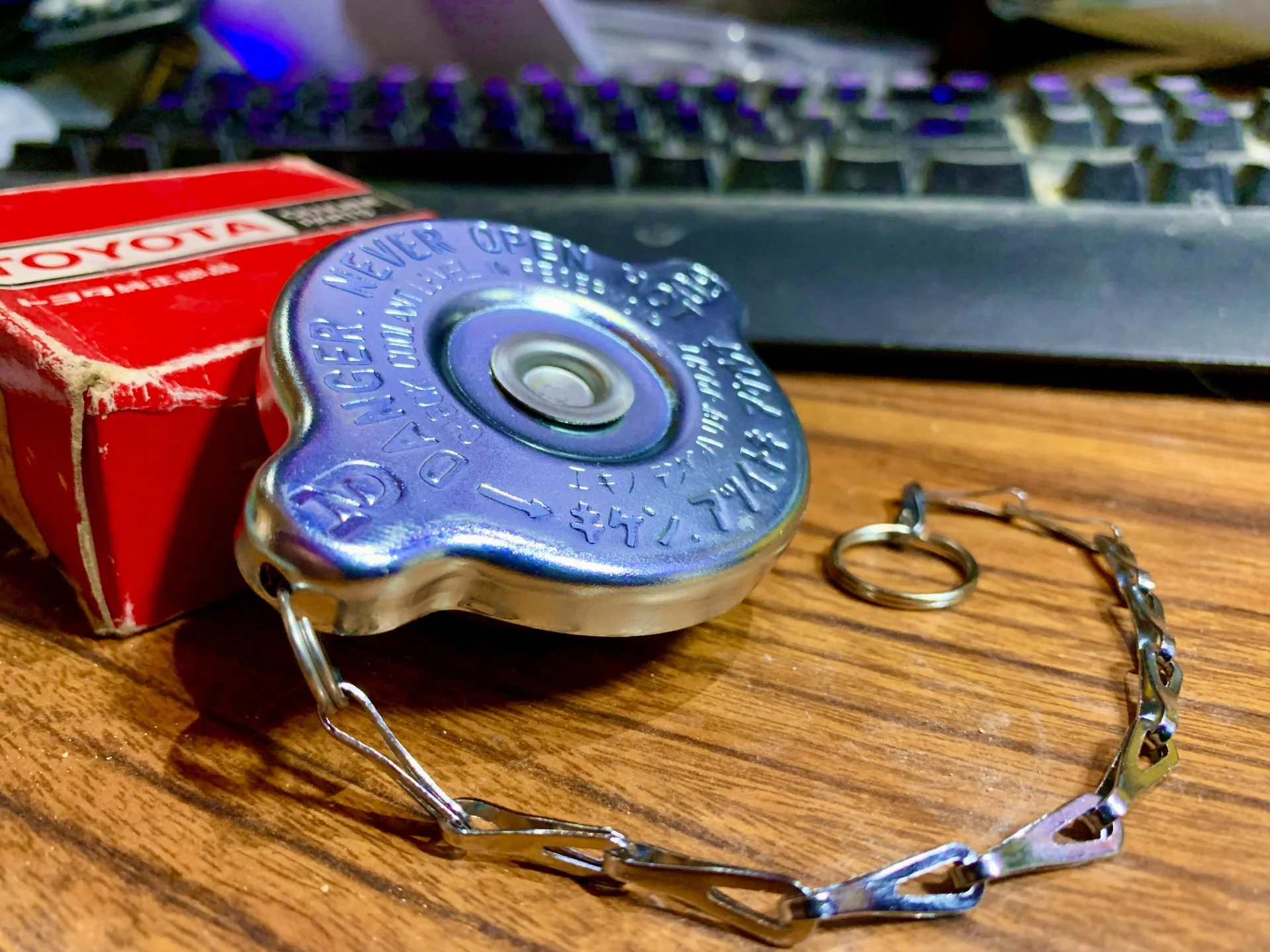

There is a new BAR and Benchmark set here this evening …
Good Bye cheezy and lame 16401-50010. Mystery OEM parts maker
No secondary rubber seal …......... please :rolleyes:
good by ...... :D
There is a new oem NON-USA Genuine NipponDenso Radiator cap in town !
- fits 1962 - 4/86 FJ40 FJ55 FJ60
TAKE NOTE the 2nd MODERN black rubber seal gasket , ..........
Bougie......
good by ...... :D
View attachment 2955482View attachment 2955483View attachment 2955484

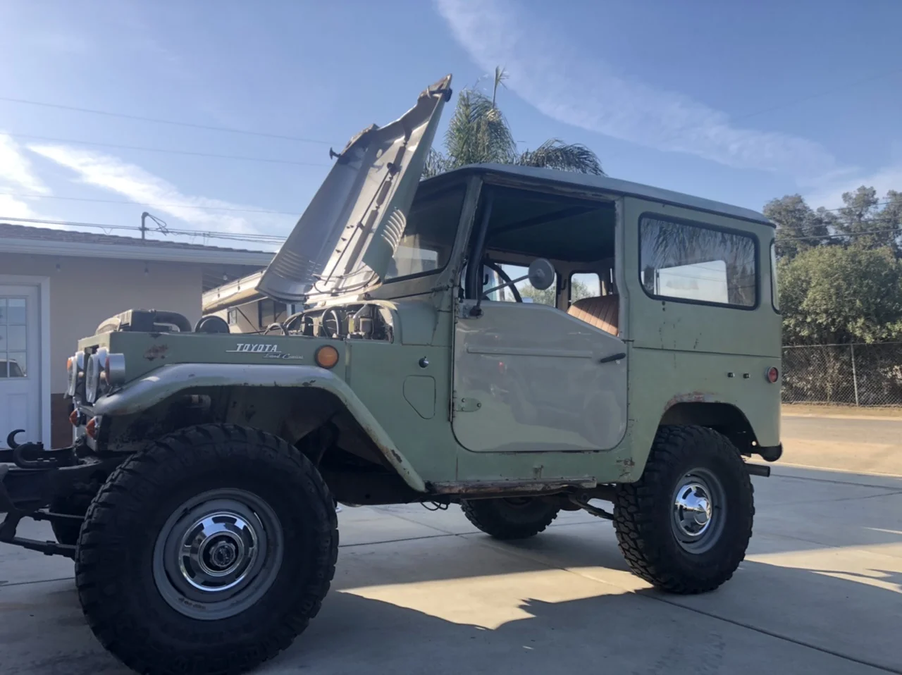

Ugly truck tried on some new clothes thanks to @navydivedoc (half doors). Put 40 miles on her tonight had a huge smile the whole time.
