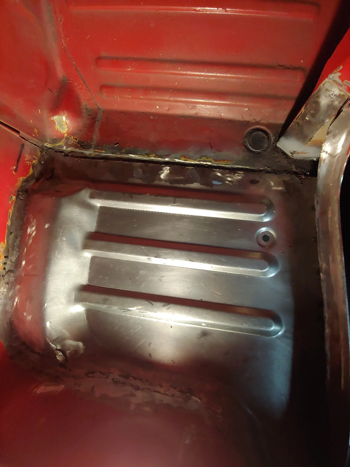

Floor board replacement progress

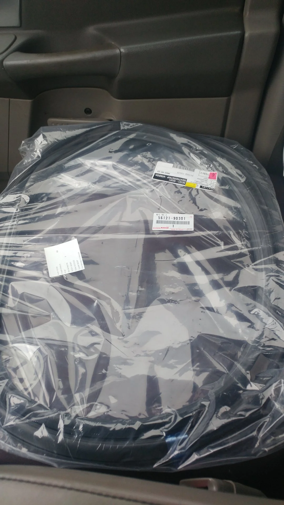

This week on Tuesday I placed an order for 56121-90301, OEM Windshield gasket. They must have plenty of those in stock, because yesterday at noon I went and picked it up. Man I LOVE buying brand new factory parts for my 44 year old ride!! 😍 I finally priced glass from a local shop and it was around $220, which I found reasonable, so I am moving a new windshield up my priority list. I just hate to lose the original one with the TEQ stamp in the corner. But between the delamination around the spider cracks on the passenger side, and the repaired chip right in my line of sight, it is time.
My thoughts exactly! Very surprised I could still get OEM windshield gasket at that price, added one to the parts stash recently.
Put OEM cigarette lighter and side marker lights on that list as well.

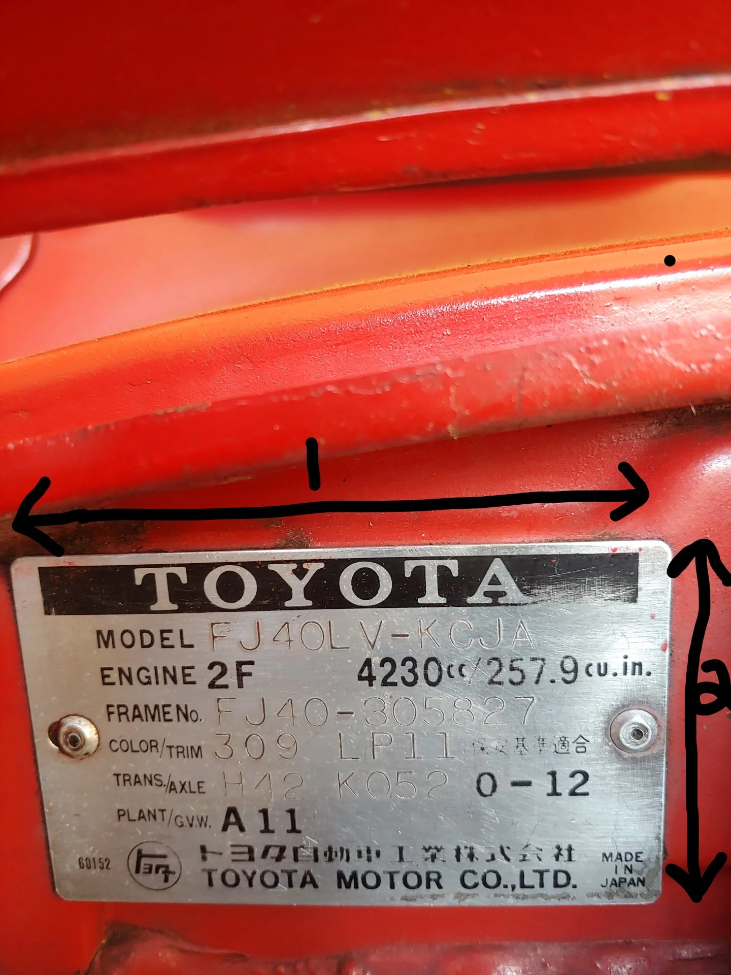

Does anyone happen to have measurements of their VIN plate for the fender or firewall on a 1976 or later FJ40?
1) 3.5 inches 2) 2 1/16 inches (between 1/16 and 1/8 to be technical)
1979 40 series firewall VIN not measured by a professional ;)

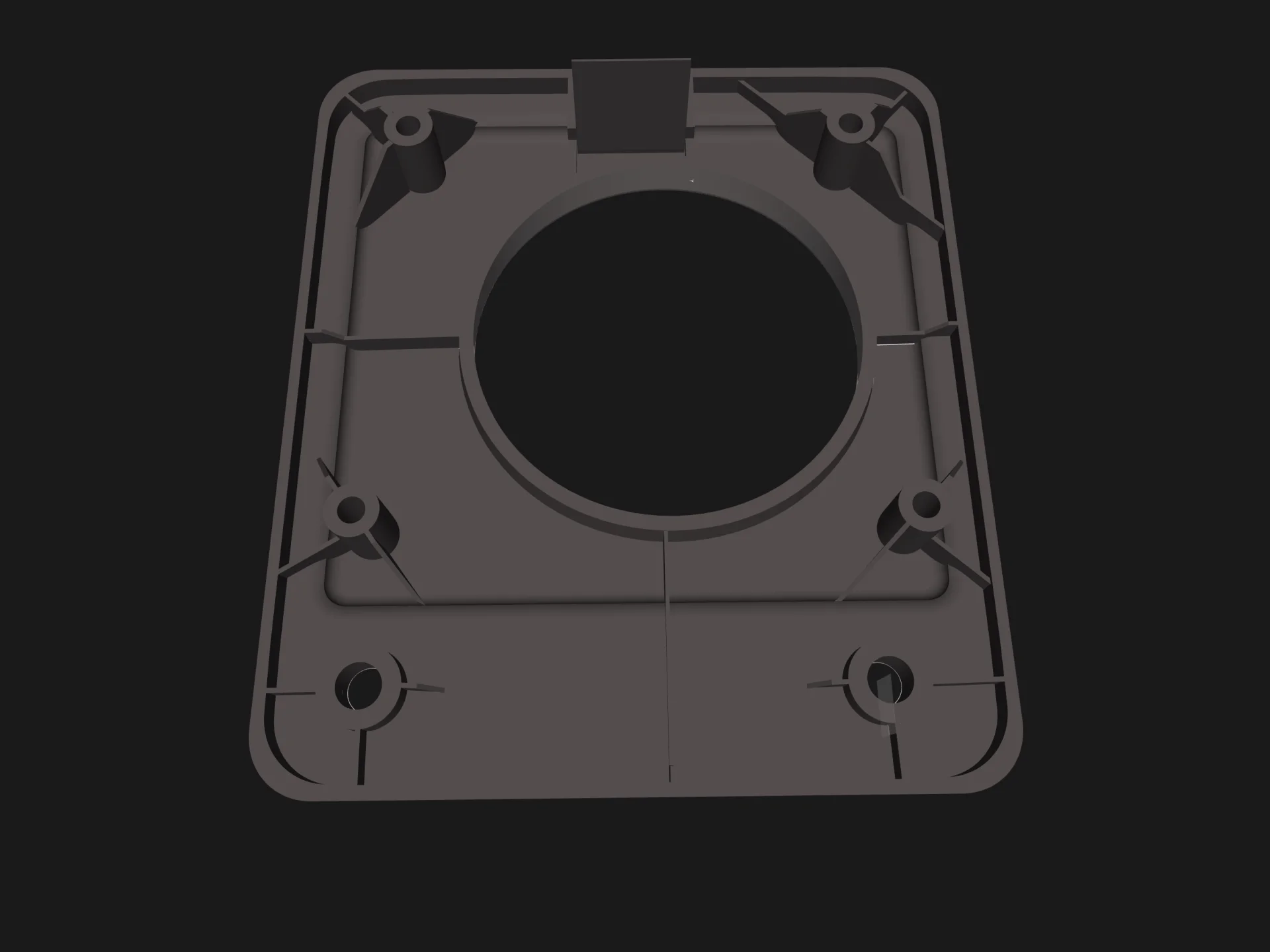

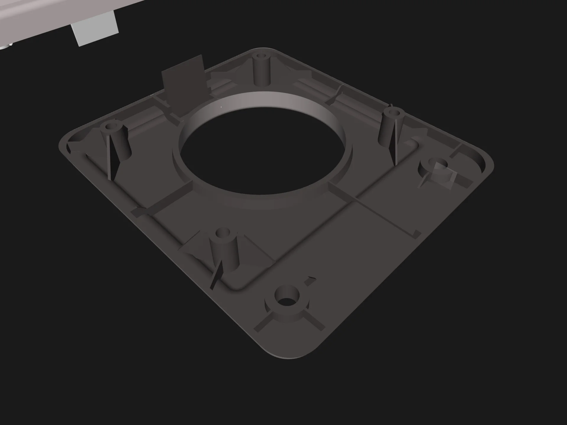

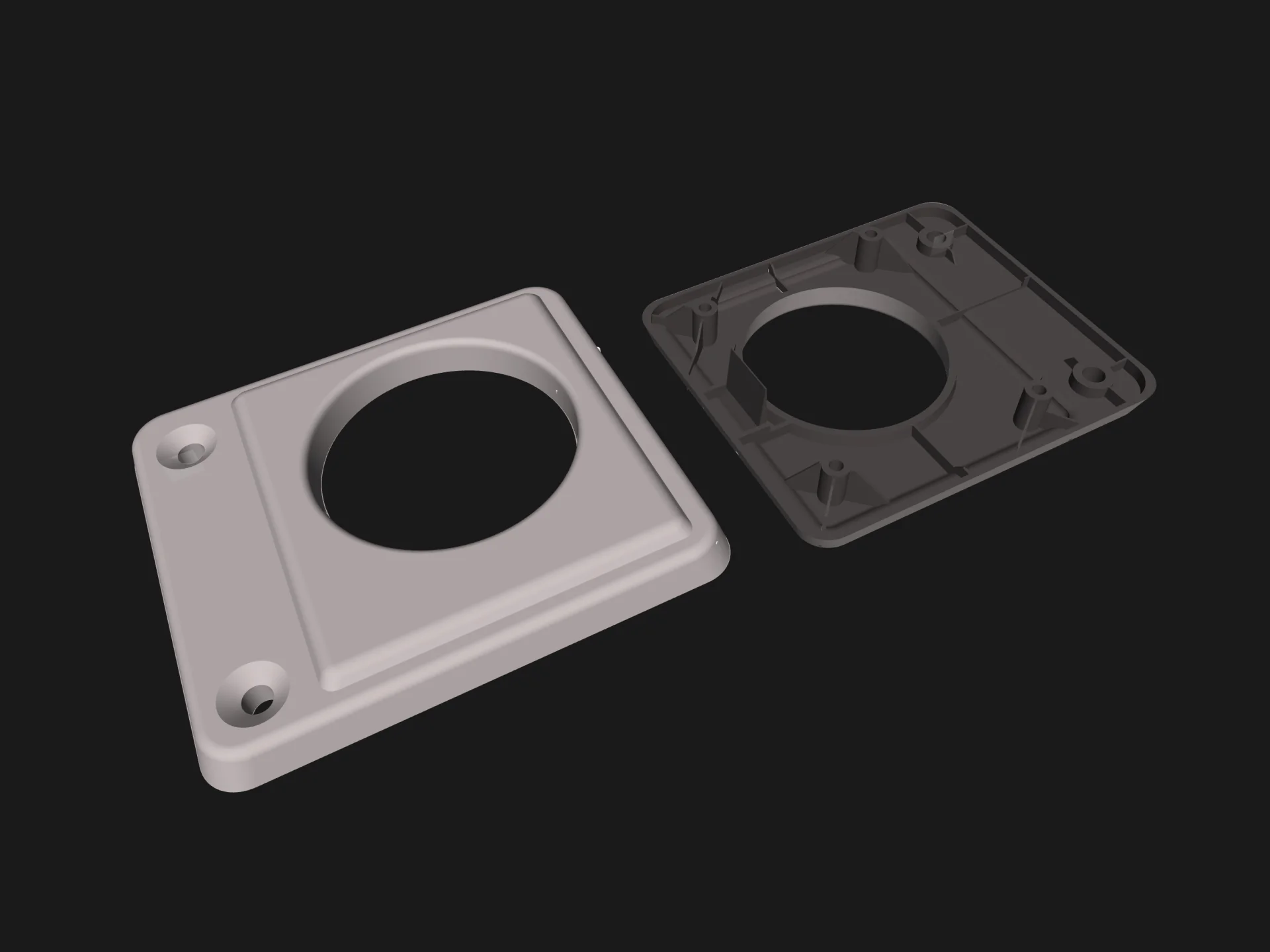

Finally got the OEM TACH face modeled in CAD then flipped it for the left handed peoples…
I was surprised at how non- semetrical it is. Measurements are within.1mm. Now it’s on to the casing itself.
When this is all finished I’m hoping to create an exact factory copy as well as a OEM looking version that holds a modern tach with custom decal face.

Sign me up for at least one, maybe two :-).

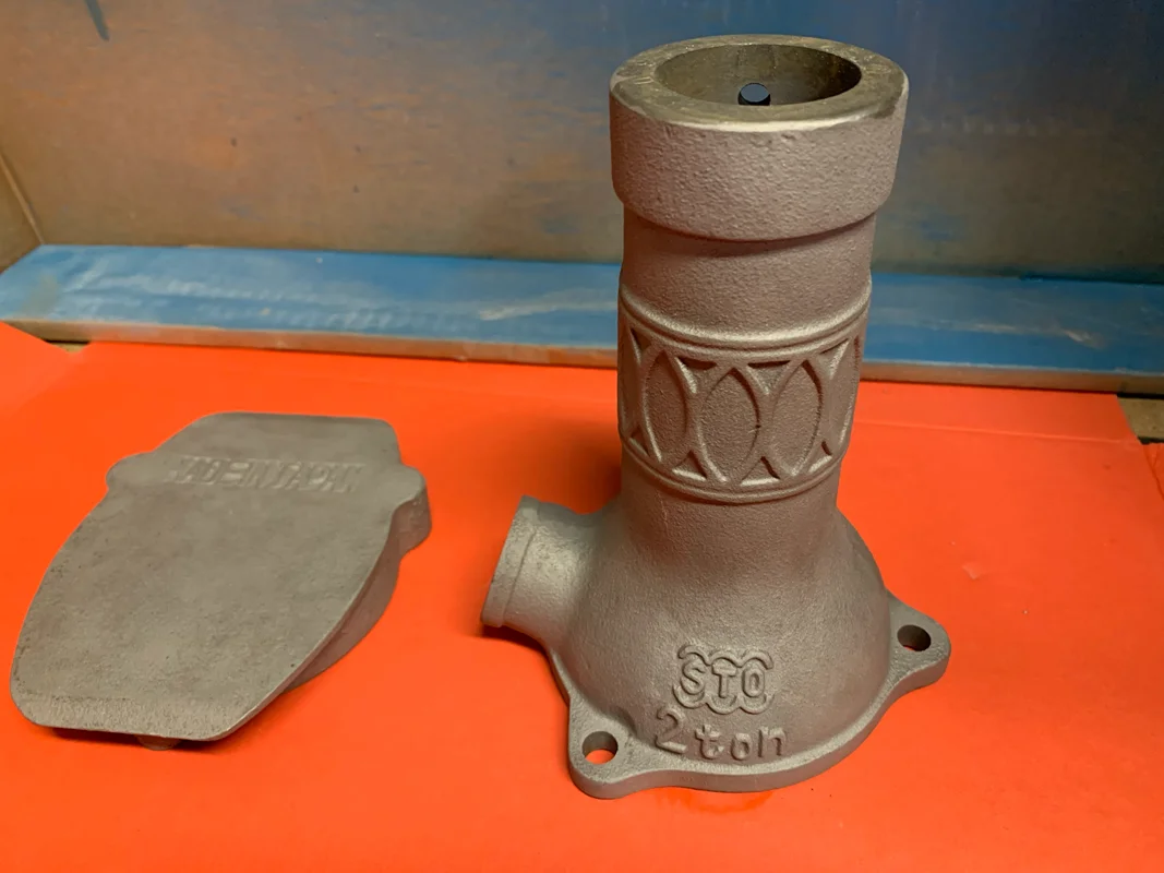

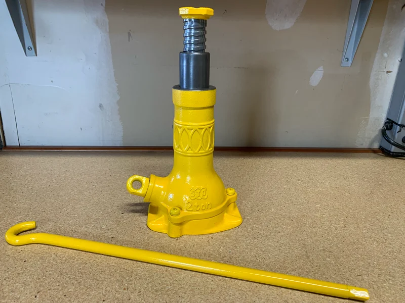

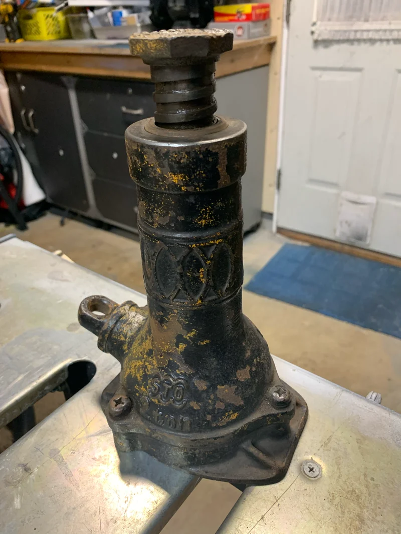

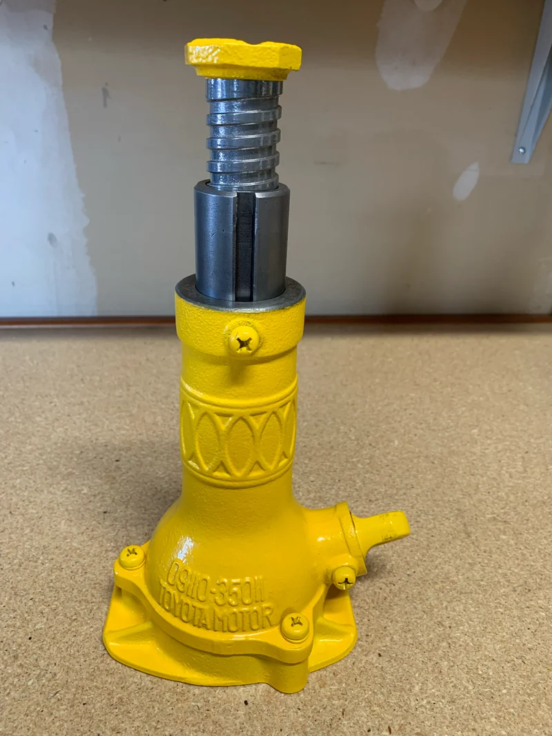

Stripped, blasted, powder coated OEM Jack. Thanks to @kevos37 for supplying the jack.
Powder coat: Prismatic powders Caterpillar Yellow II (PSS-2550) for body, Super Chrome (USS-4482) for threads on top post.
Here's the before and after shots:
Original
Blasted
Coated

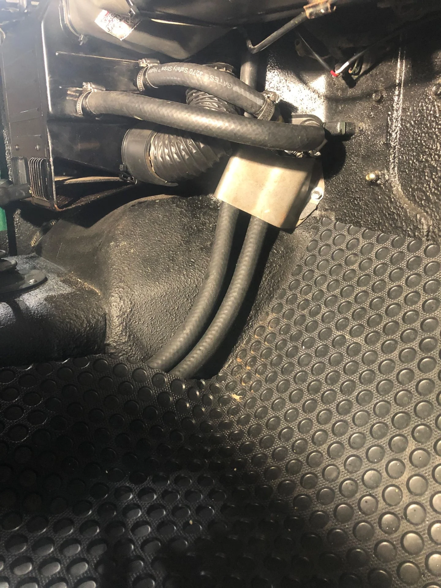

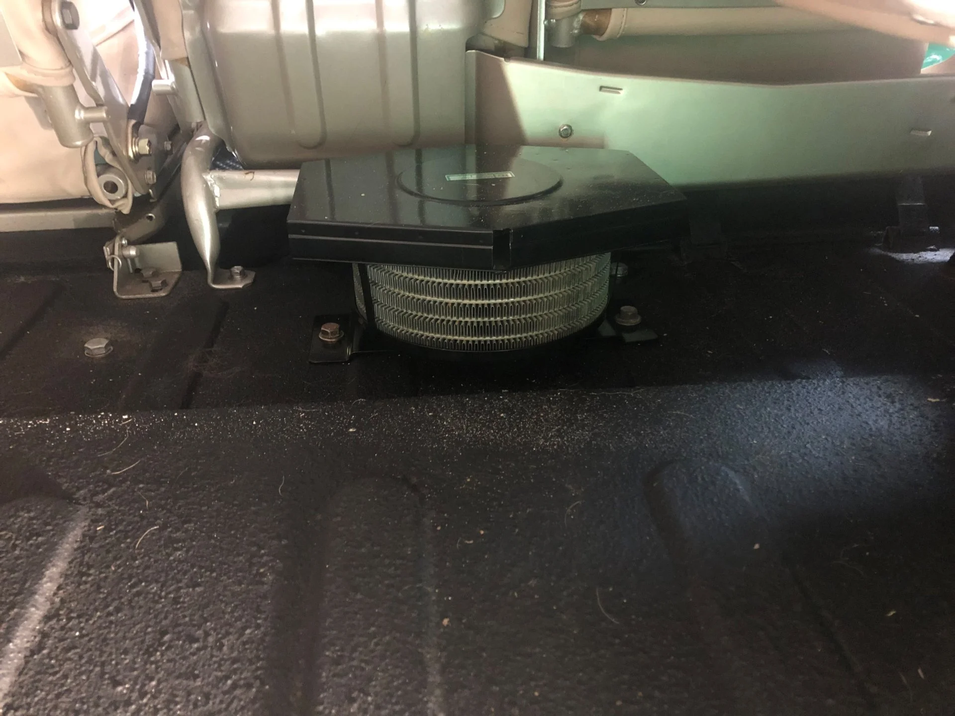

A fair number of TLC 40 series rear heater hard lines have gone the way of the great white Buffalo. I’ve seen some interesting mods done with “soft lines”- . I used a silicon hose as a way around a lack of available hard lines and I’m getting ready to use a MILSPEC soft line on my next plumbing job as well. This time in black (inside funny).😉
Looks nice @Green Bean ....👍👈😎
