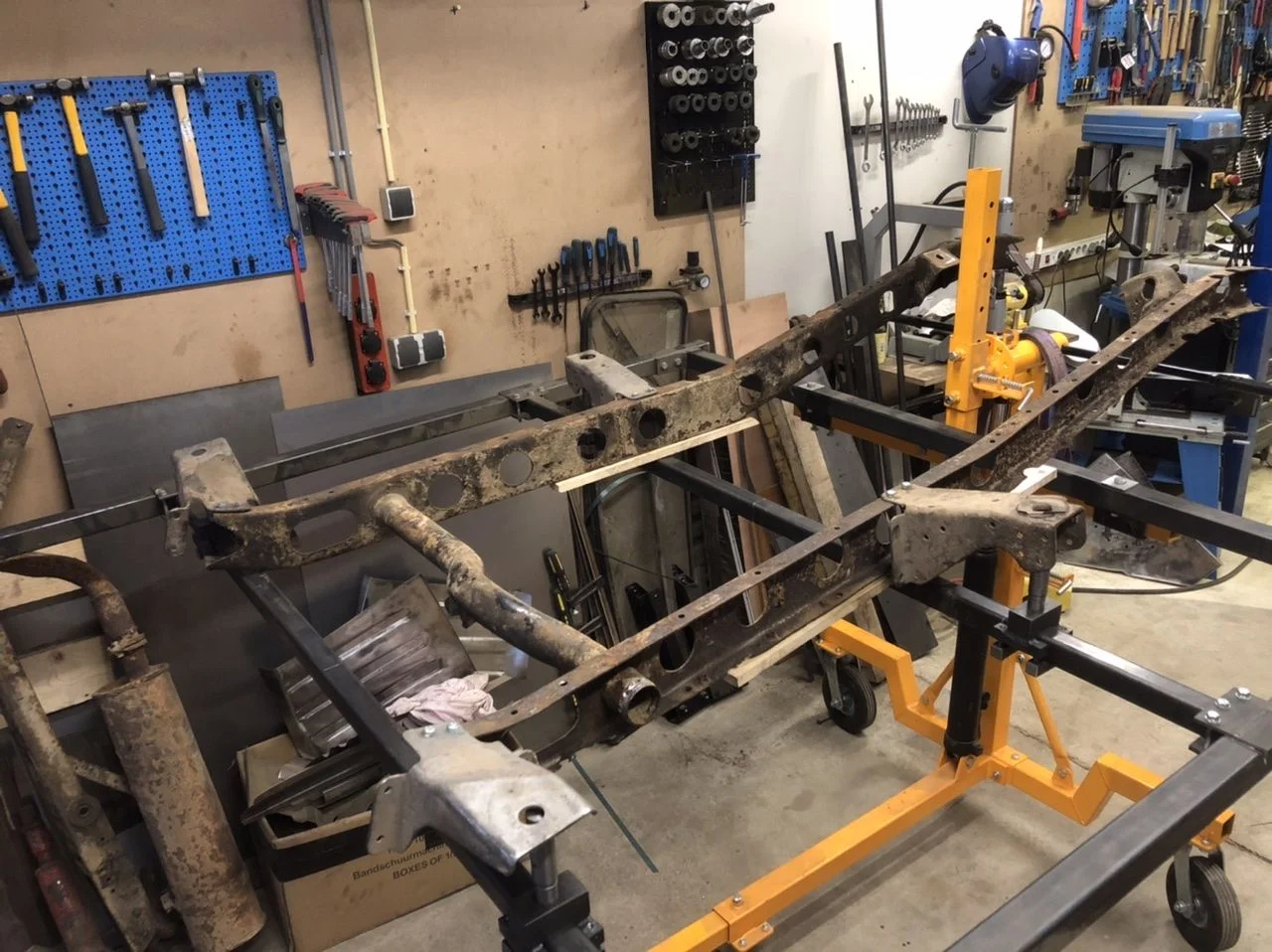

Is there anyone with a 79+ frame with the tub off that can give me the distances, straight line and diagonally, for the body mounting points? Or measured from the bottom of the tub. The FSM only gives the measurements from the pre 79 frames.
My frame is completely disassembled and I don’t want to assemble it just for the measurements.

Thanks Bill that would be nice.
I partially bolted my frame together and got the rough measurements.
If you can confirm the difference between front and middel (A and B pillar), should be 860mm according to FSM.
And the main one is left to right on the front tub mount, FSM says 1118mm but I measure 1192mm Give or take 2mm.

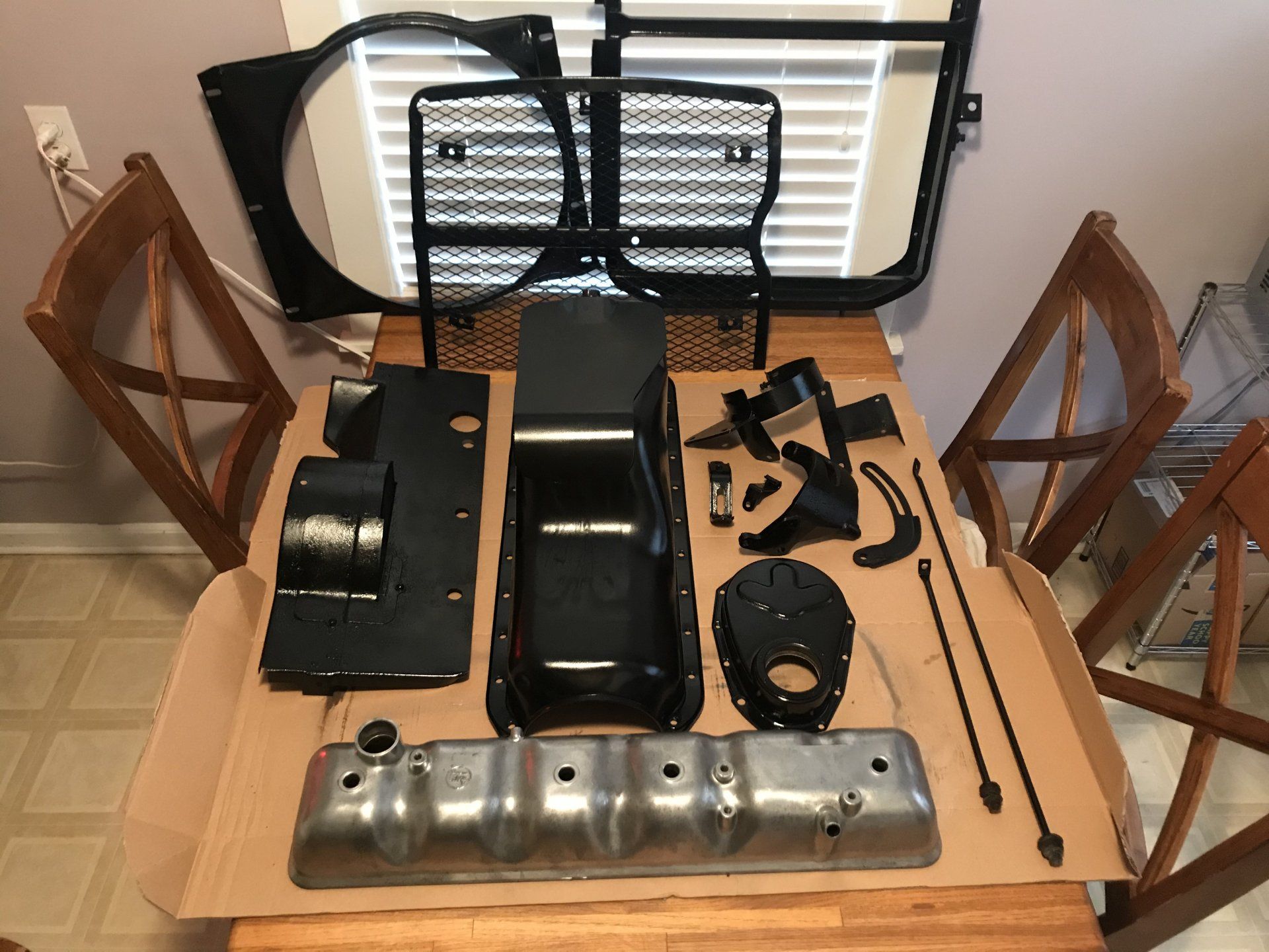

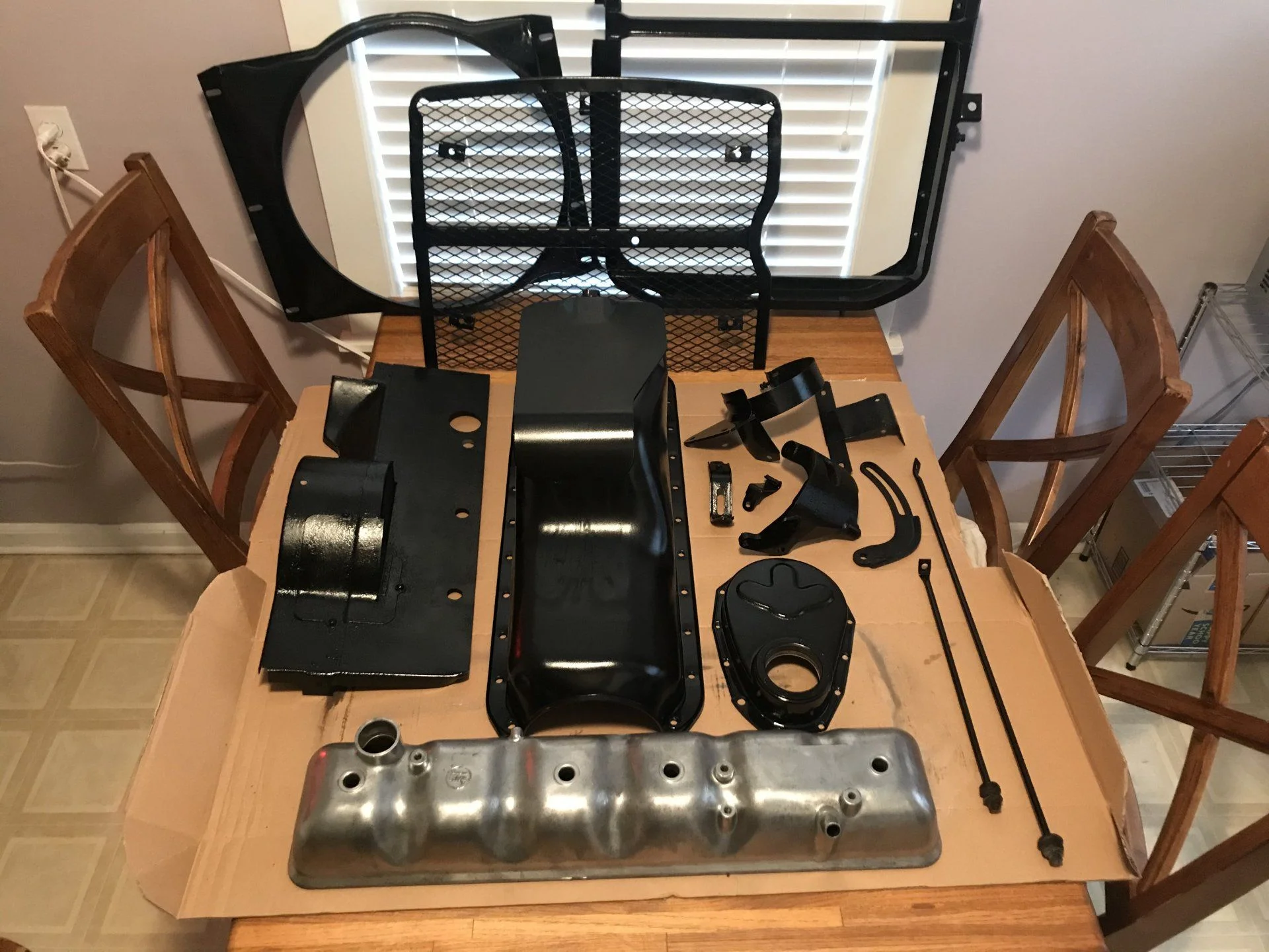

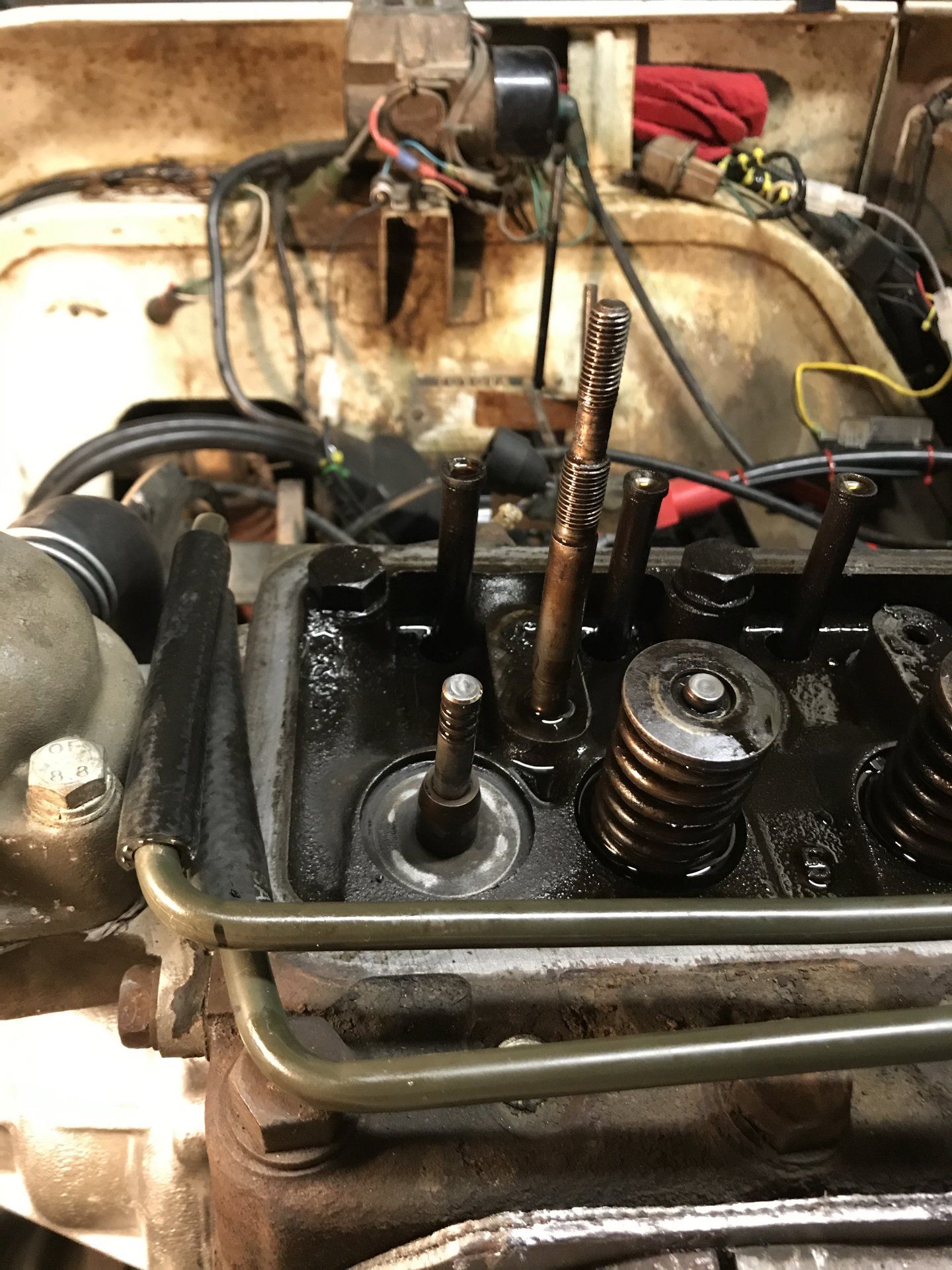

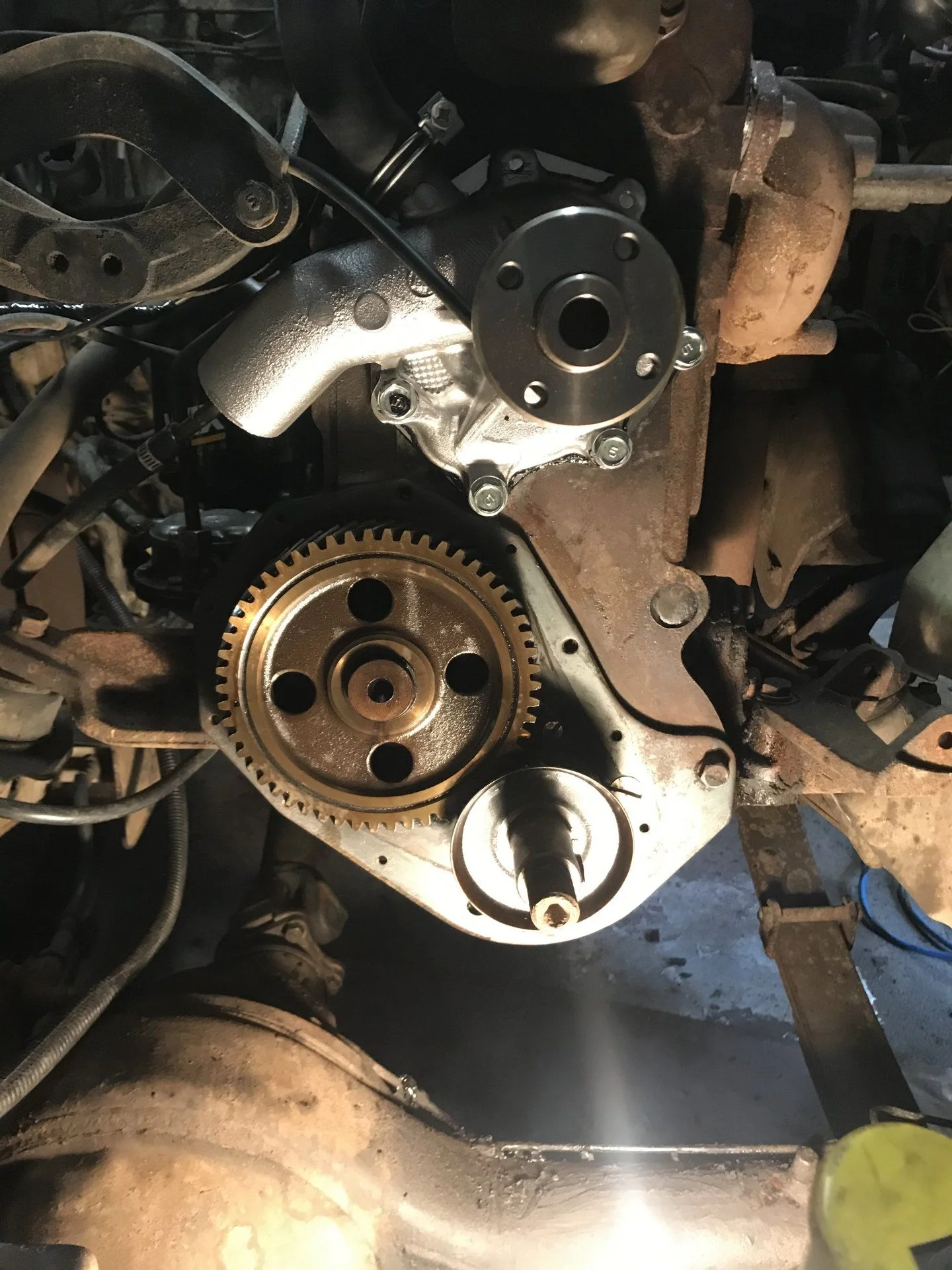

Been after it for a few weeks. What started as a coolant drip that I wanted to address, turned into a let’s address all the engine drips and oil consumption. Replaced the water pump, and valve stem seals(used the rope trick and spring compression tool). Everything removed got a fresh coat of paint. Up next is to replace the oil pan gasket, timing gear cover seal and gasket, and probably the valve cover gasket too. Need to do a valve job. Button up the cooling system and get back on the road. Anyways, I’m at the turn around point so I thought I post a little something.

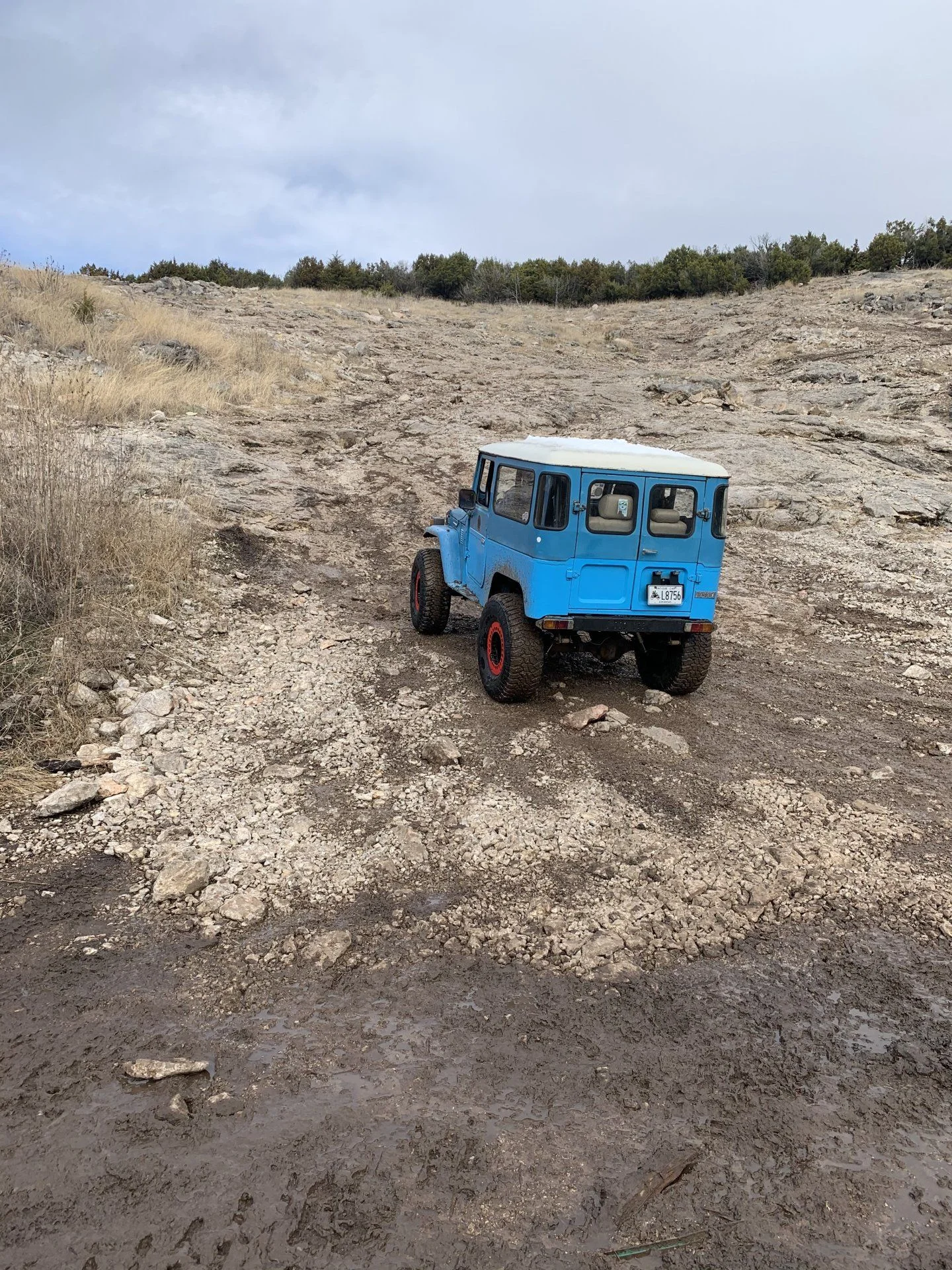

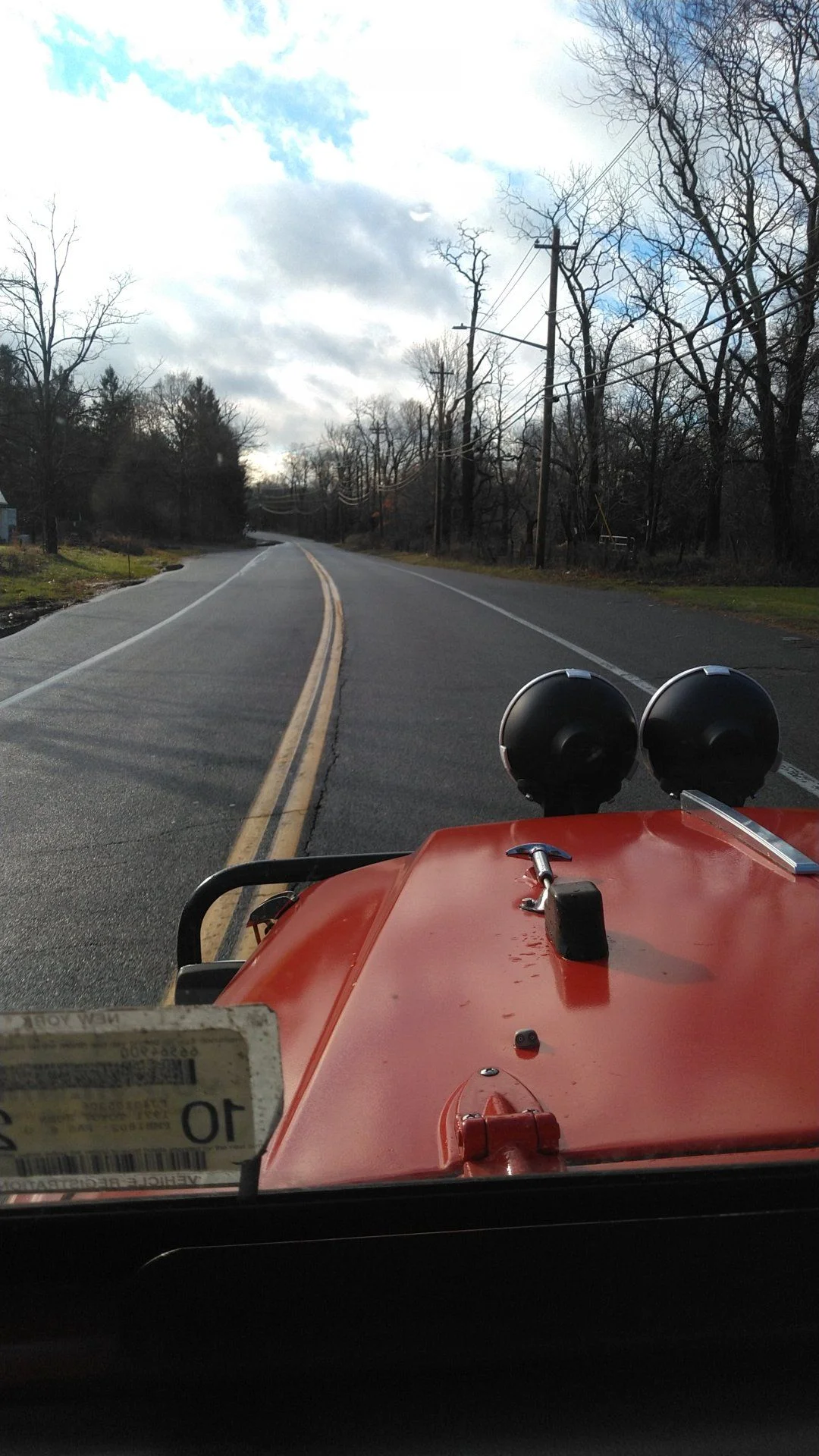

A flock of turkey that were on the edge of the road ran like their asses were on fire as I approached them :steer:
Every once in while, there is SOMETHING on the road, that we can drive faster than!

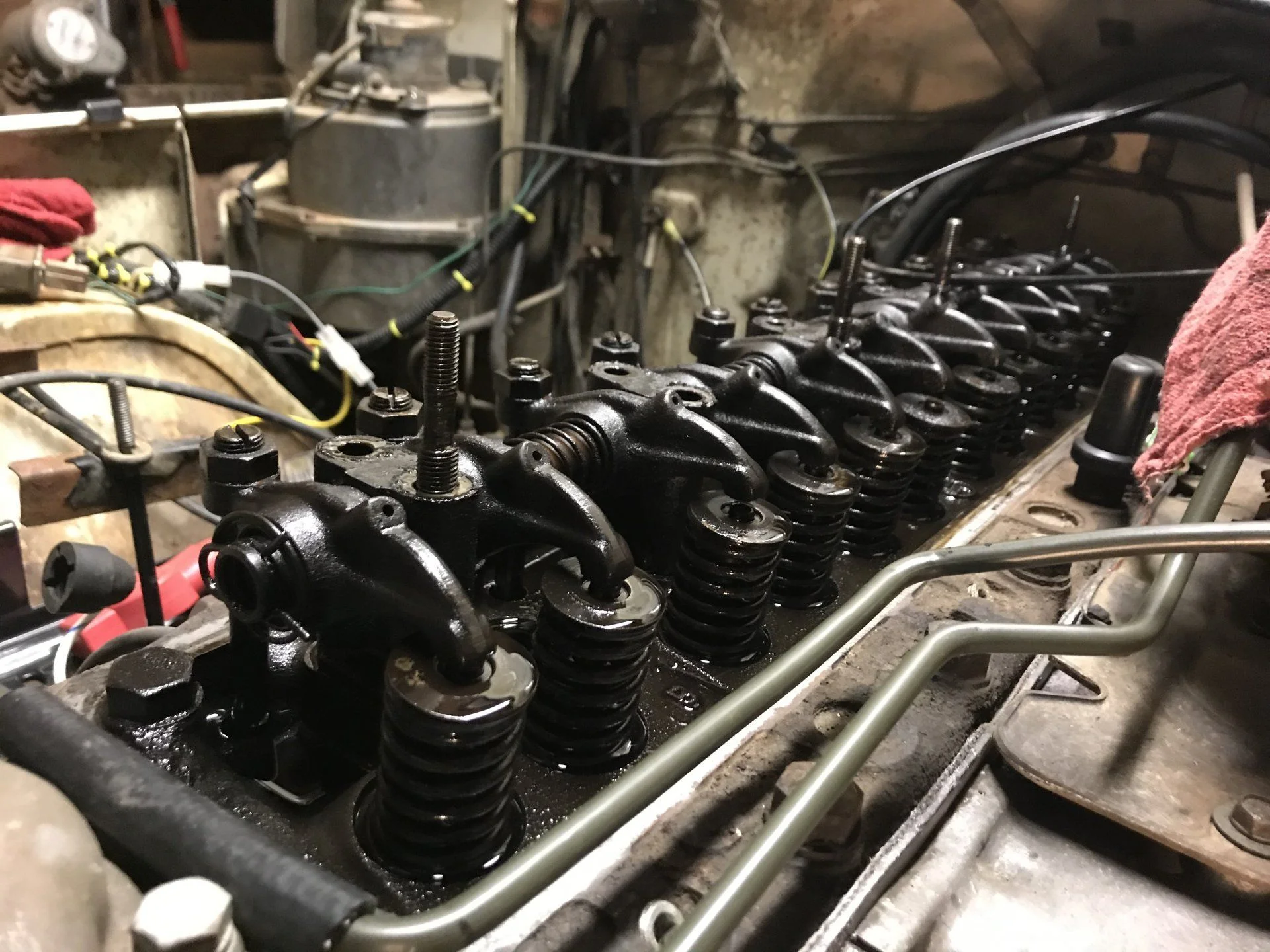

I just finished up a full rebuild on my F engine. To avoid any oil leaks I got a tube of Toyota Seal Packing 103 from @ToyotaMatt.
I highly recommend it. One tube was enough for the oil pan, lifter cover and timing cover. I used some Permatex for the coolant covers.
It is a delight to have a dry, clean engine now.
Be sure to get a good gasket for your oil pan plug. Mine is new but I had to torque it to about 100 ft-lbs to stop it from dripping!
100 ft-lbs? at such torque you don't need any gasket.. :) you are probably mean 100 in-lbs?
Haha, even with a new plug and gasket it kept dripping slowly until I tightened it beyond all reasoning.
Fortunately the pan boss and threads are very beefy and stood up to my 'just a bit tighter should do' system.

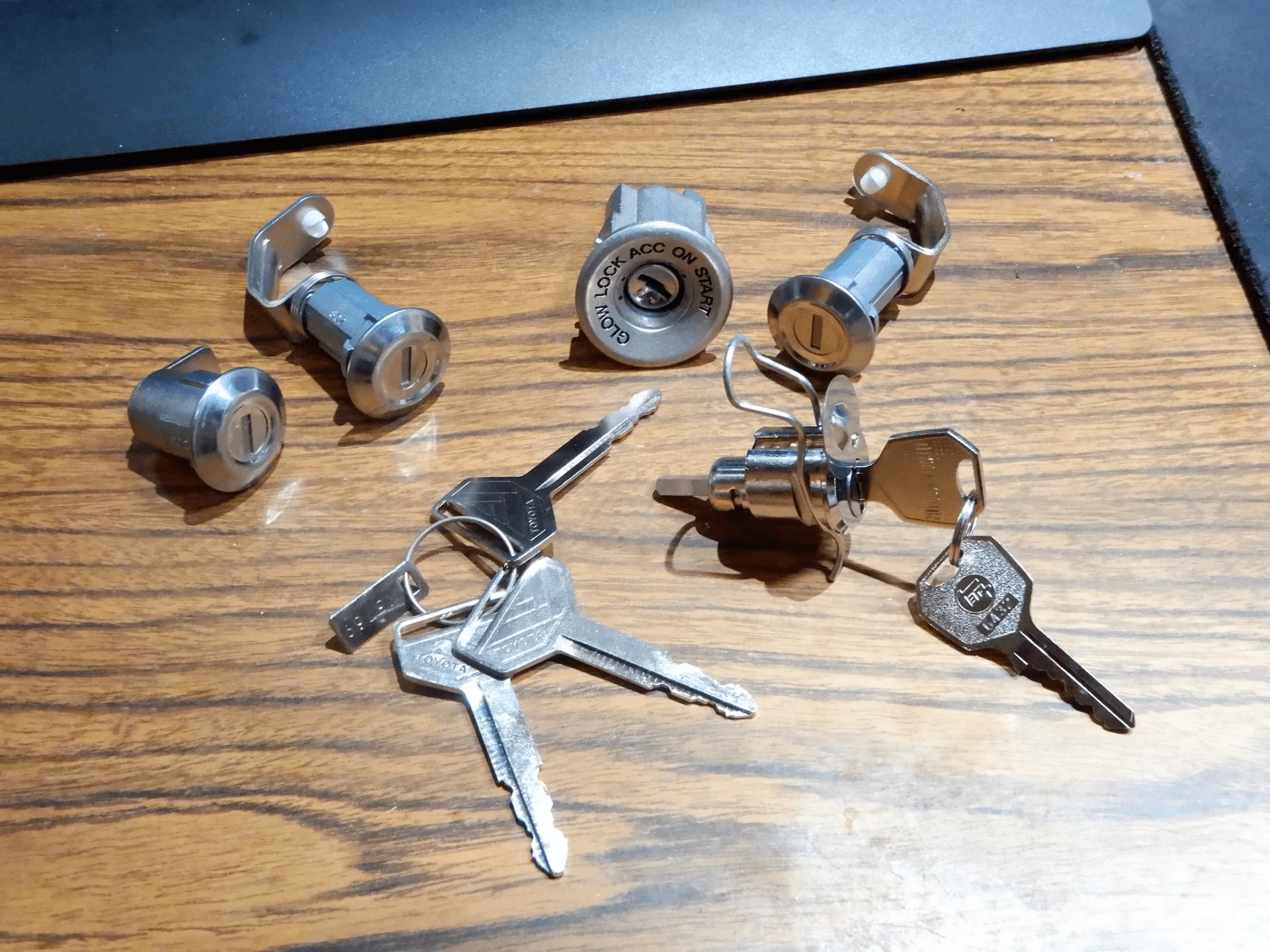

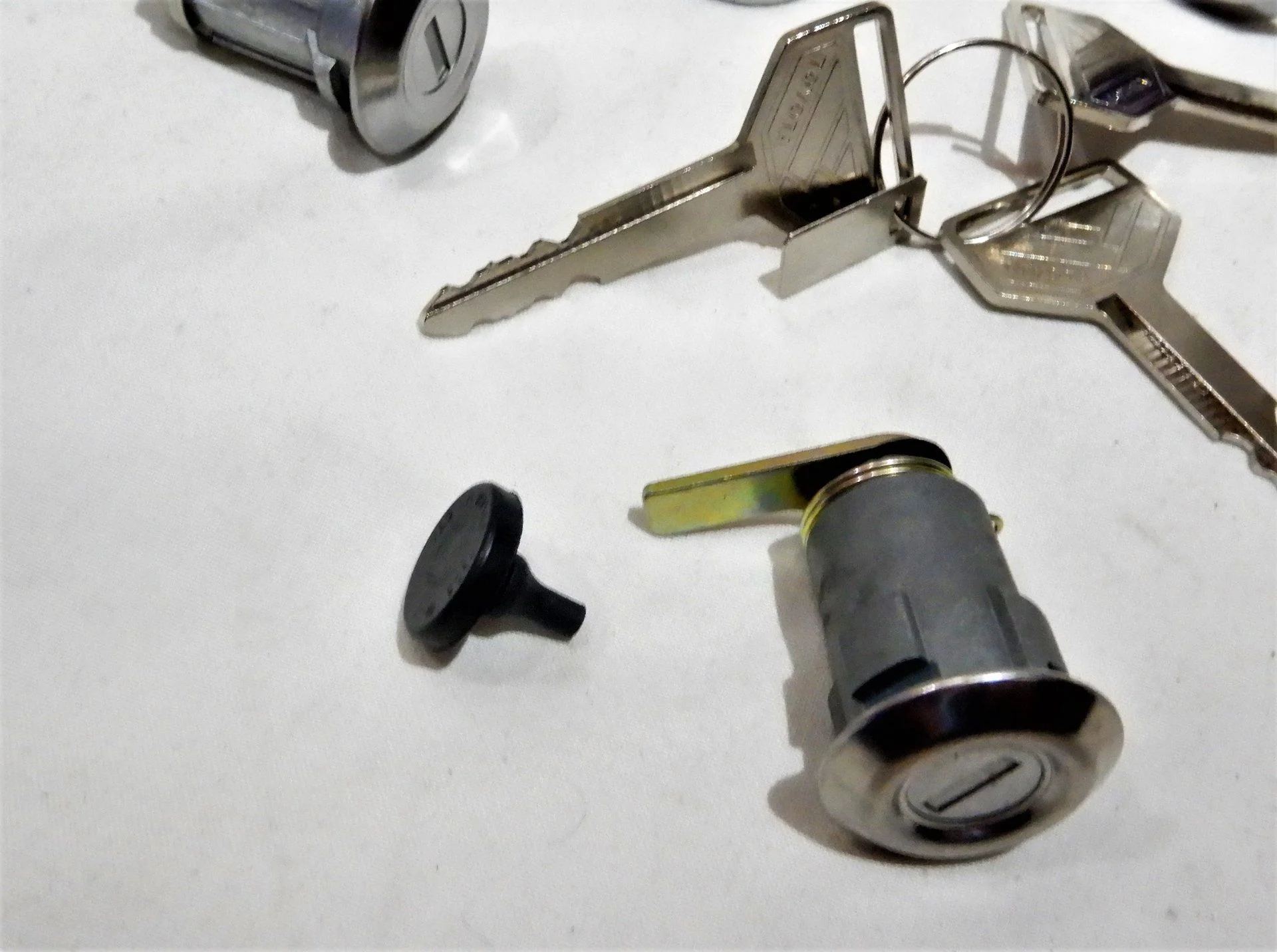

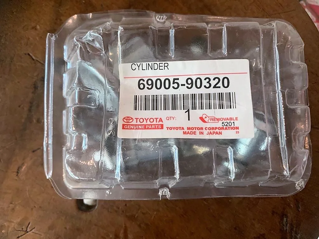

i Revived part # 69005-90320 , and added a NOS cherry on top , instead of a dismal 4 pc TOTAL vehicle Lock set , mine comes with the 5th Lock for the rear Ambulance Door Now standard ...........
this is the 1/79-84 glow plug feature kit
next up is the 5pc set for the 12/78 and older crowd ..........with a flip down fuel door , OEM Lock cylinder matching key included too and a ambulance door lock so 1/75-12/78 .............
why have only 4 locks ? screw that 5 pc set is FLY and Hip ............in 2021

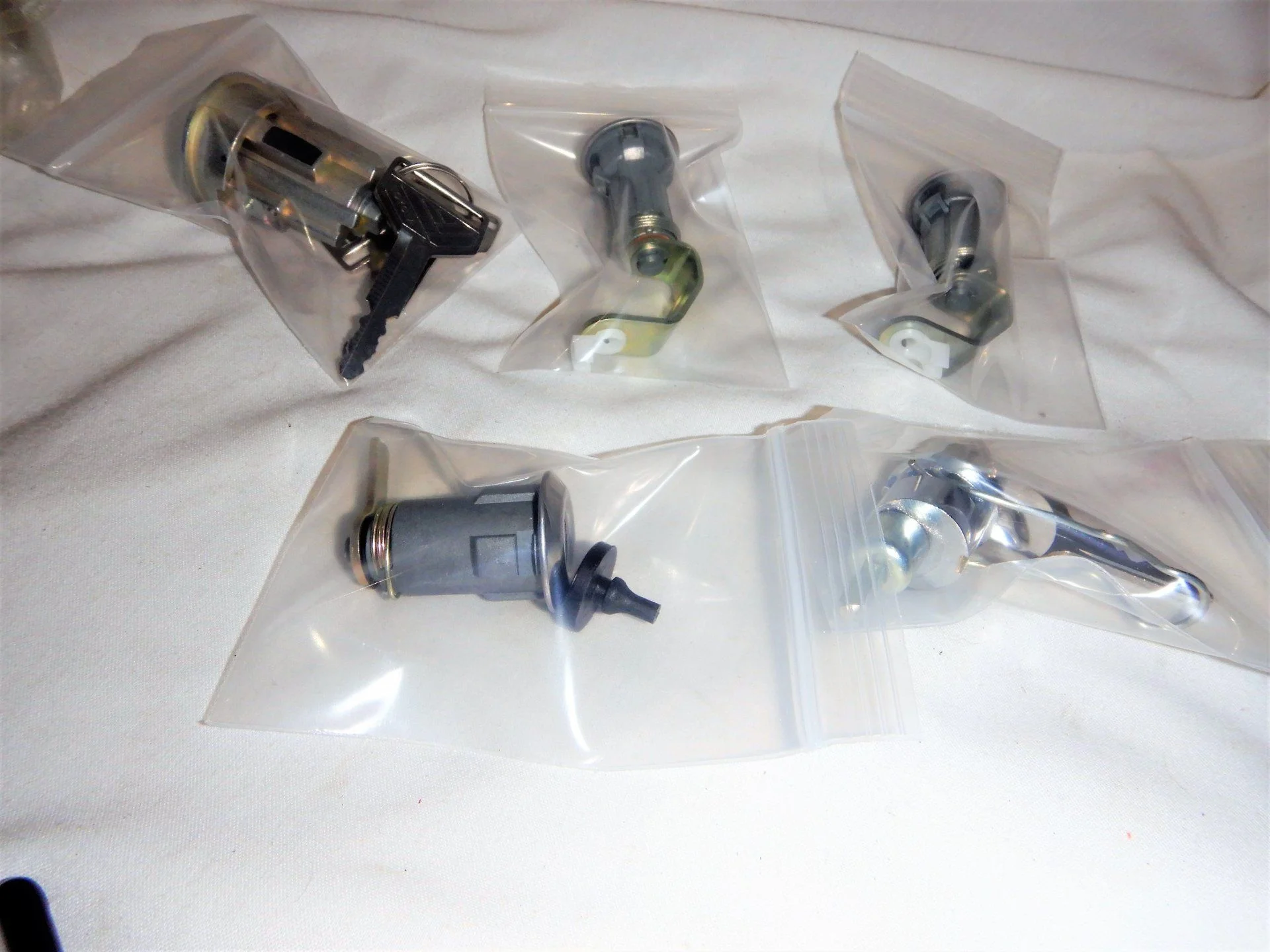

Here is the 1/75-12/78 lomg since DICS. / NLA well .......................till right NOW , i just brought that needed part # back fro the Dead !
for example @samatulich 's rig applies to this 69005-90386

I have a tube from Matt. Plan on using it as you stated. I retorqued the side cover this afternoon. It was replaced 11K miles ago, I got to think its still good. Those bolts all needed a half turn or more to get the 35 inch/pounds. I believe I have a new oil pans drain plug and gasket. I plan on installing it before filling with oil.

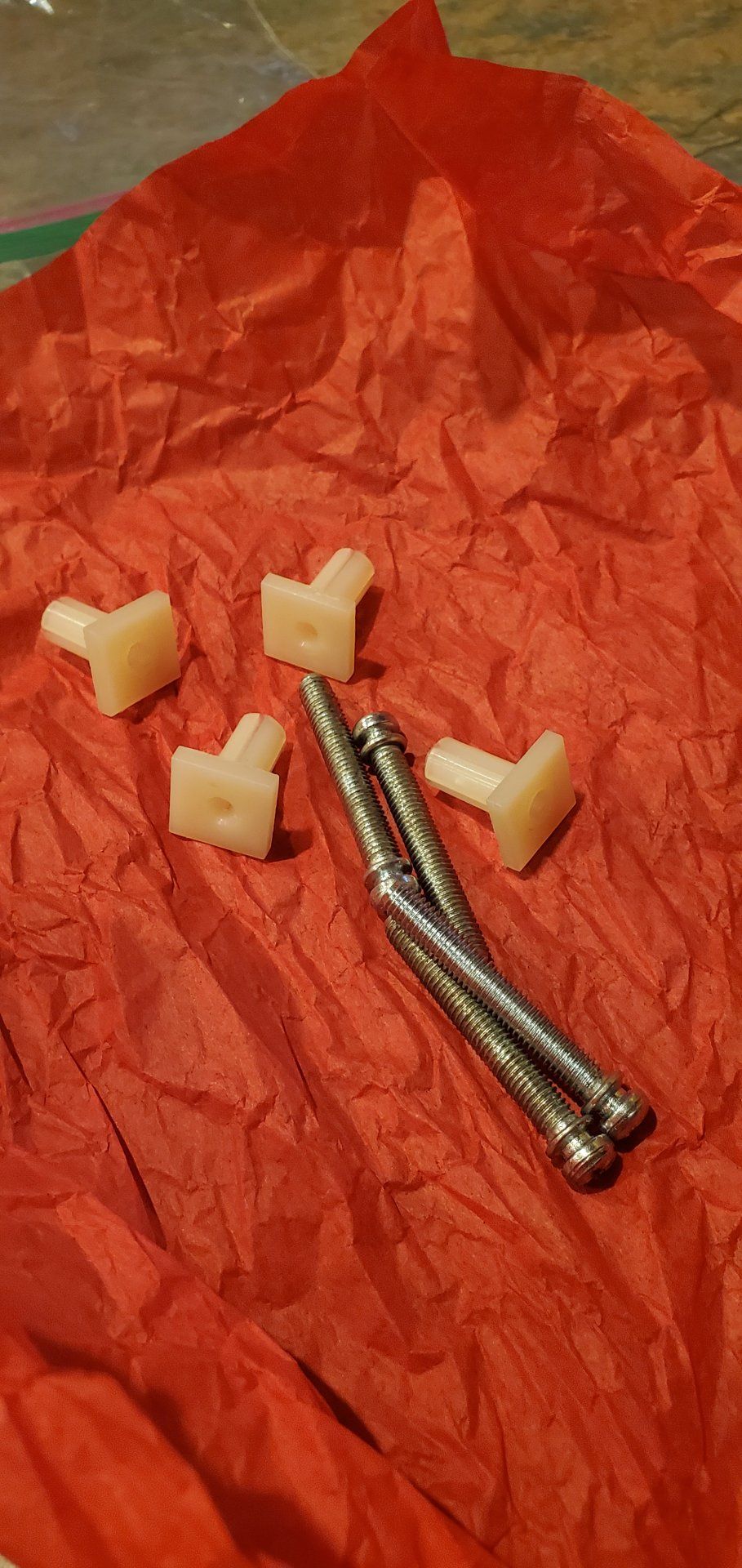

Forgive my ignorance - I do not recognize them. What part are they for?
Headlight adjustment grommets and screws.

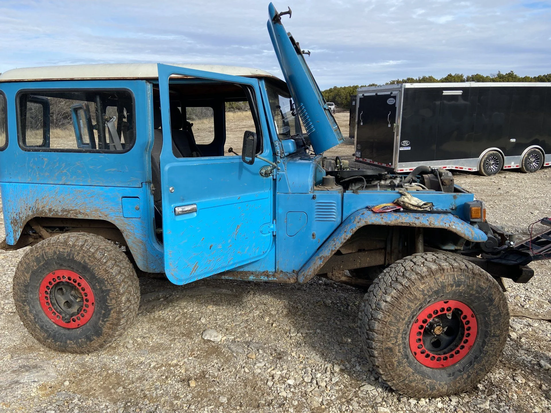

Went for a short off road adventure. I took my neighbor and his kids who had never been off road before. They loved it... until I popped the coil (original FJ60) and ended the fun for the day.
I didn’t know OEM were still available so I filled the holes square and used generic ‘Help replacement’ parts.
