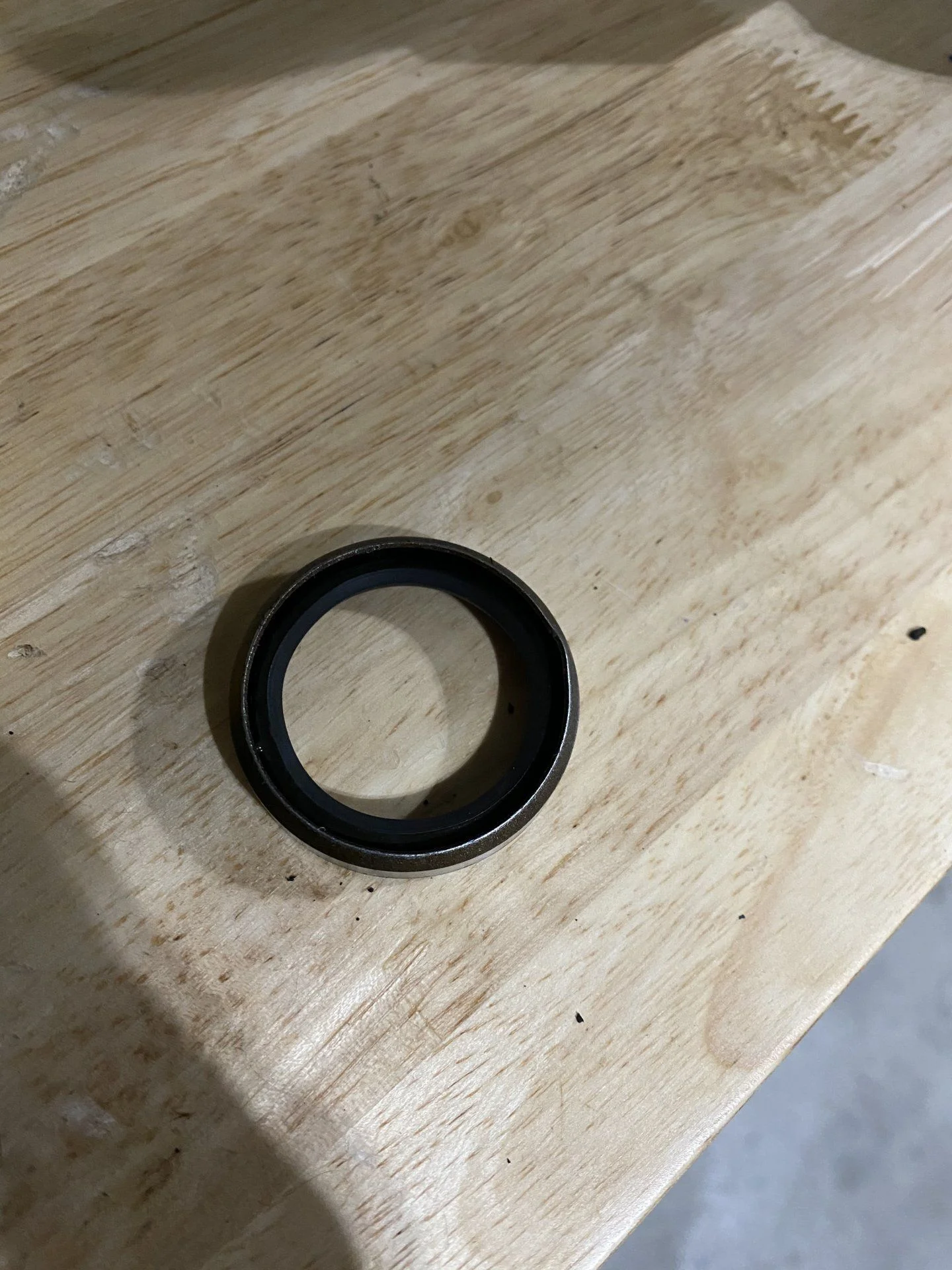

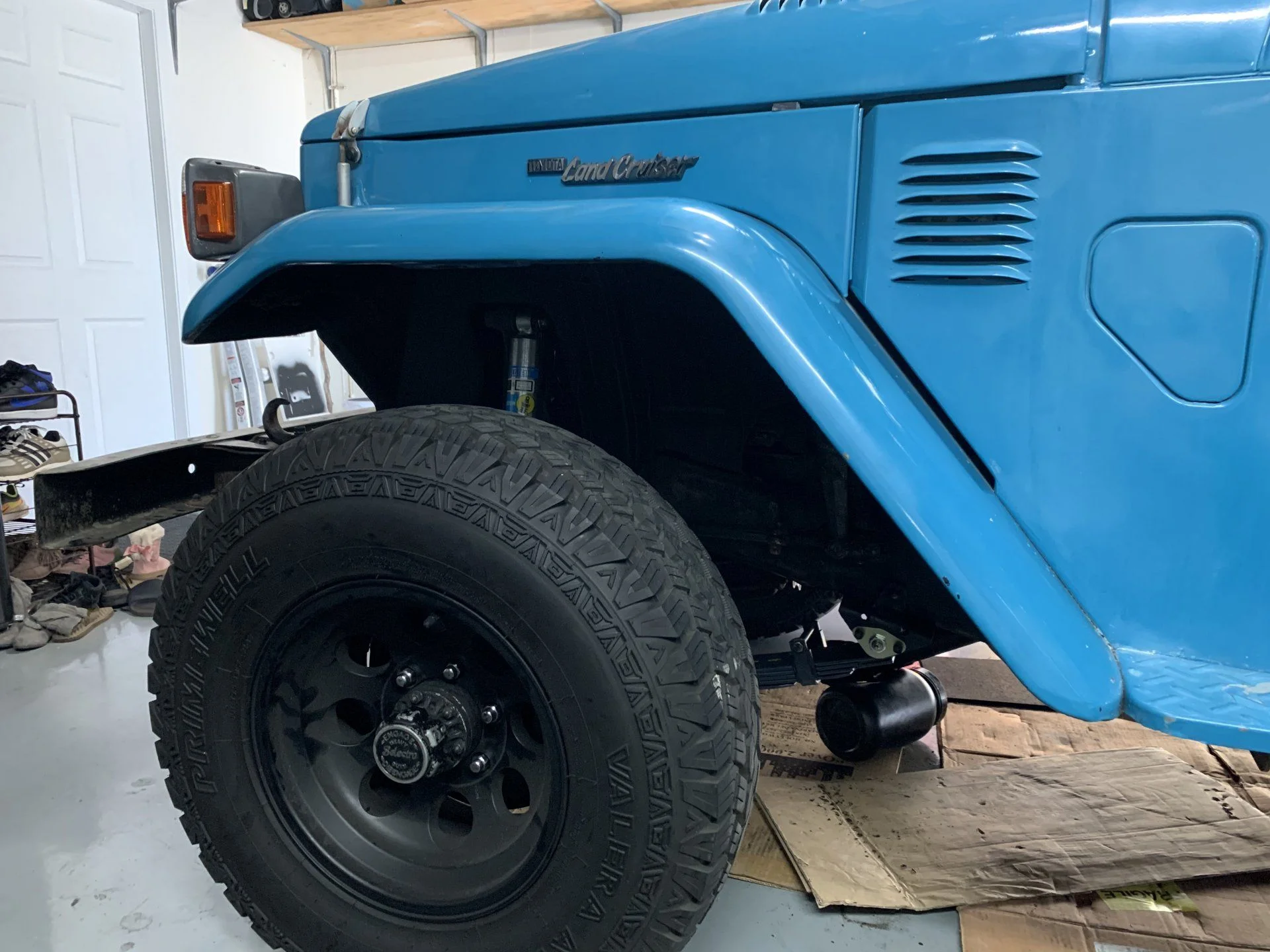

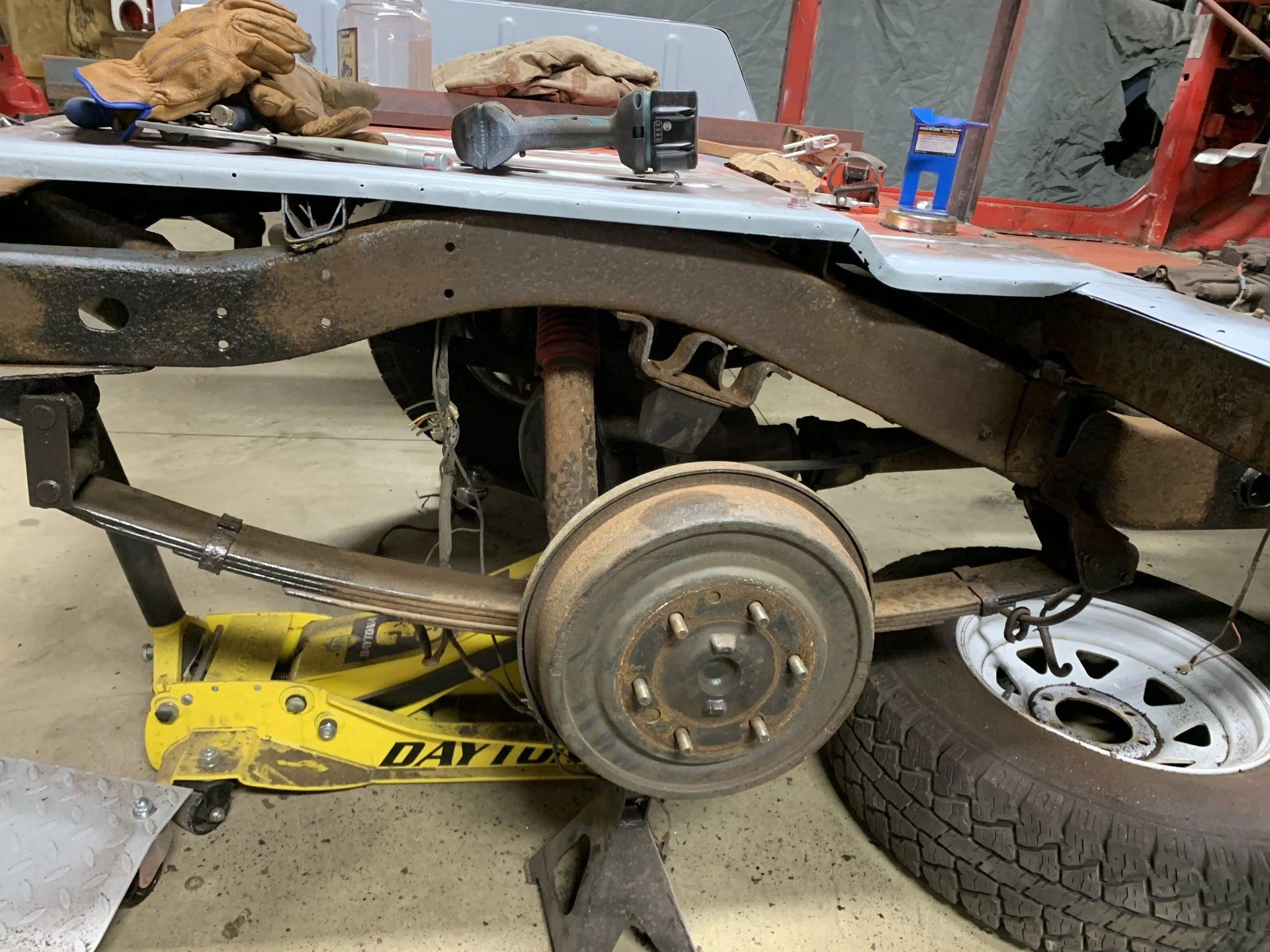

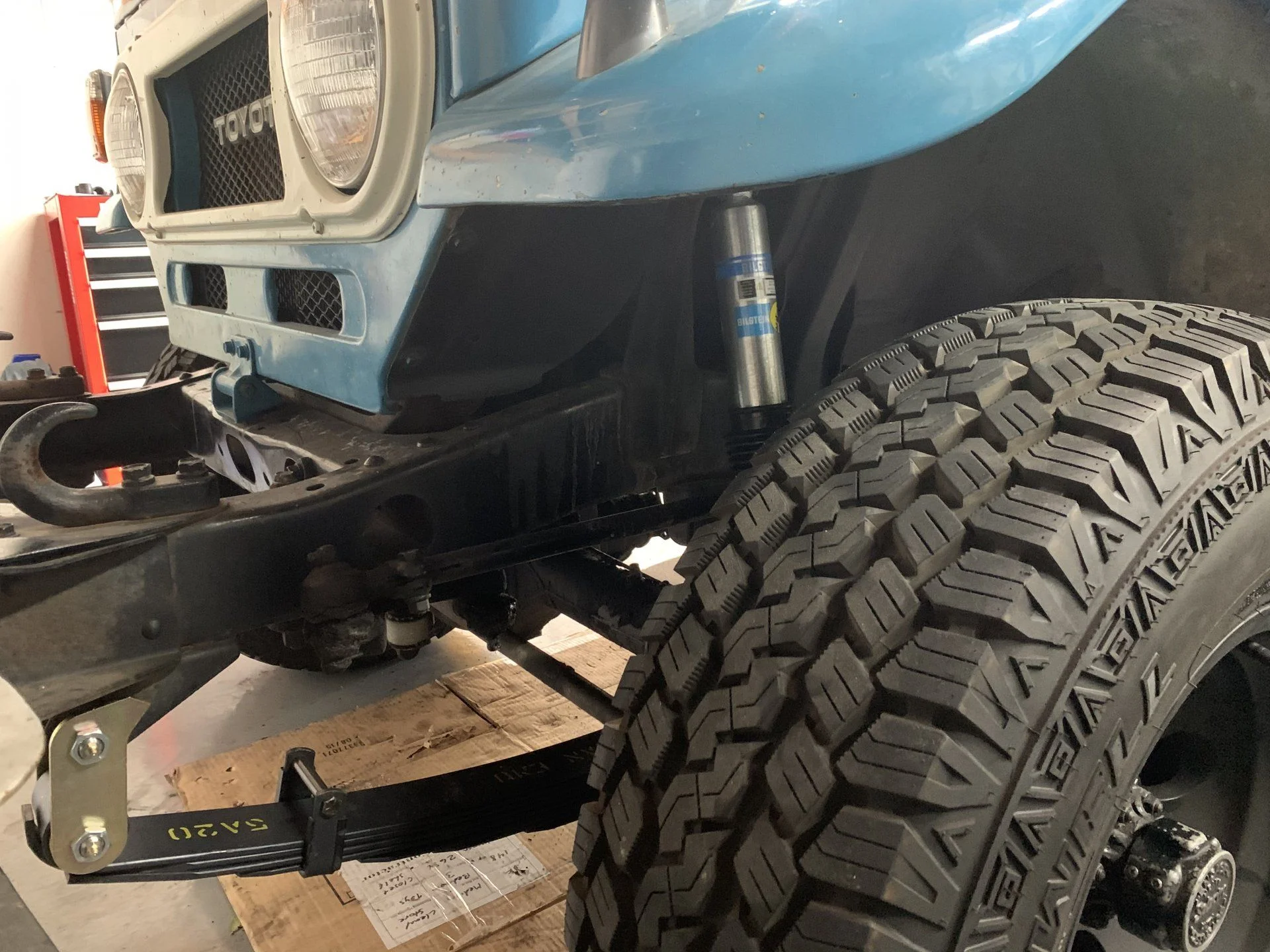

Almost finished the front suspension. This is my first attempt at something like this, so it took me way too long and many F words were said (but I've been learning a ton and it's fun seeing things come together). I still need to reattach the front drive shaft (googling zerk fitting removal next) and I need to find shorter small bolts for the spring pin hangers (the originals are too long and hit the new ome spring/bushing) and then it's on to the back. I'm not out of the woods yet, but a huge thanks to mud and the FB group for all of the knowledge and assistance.

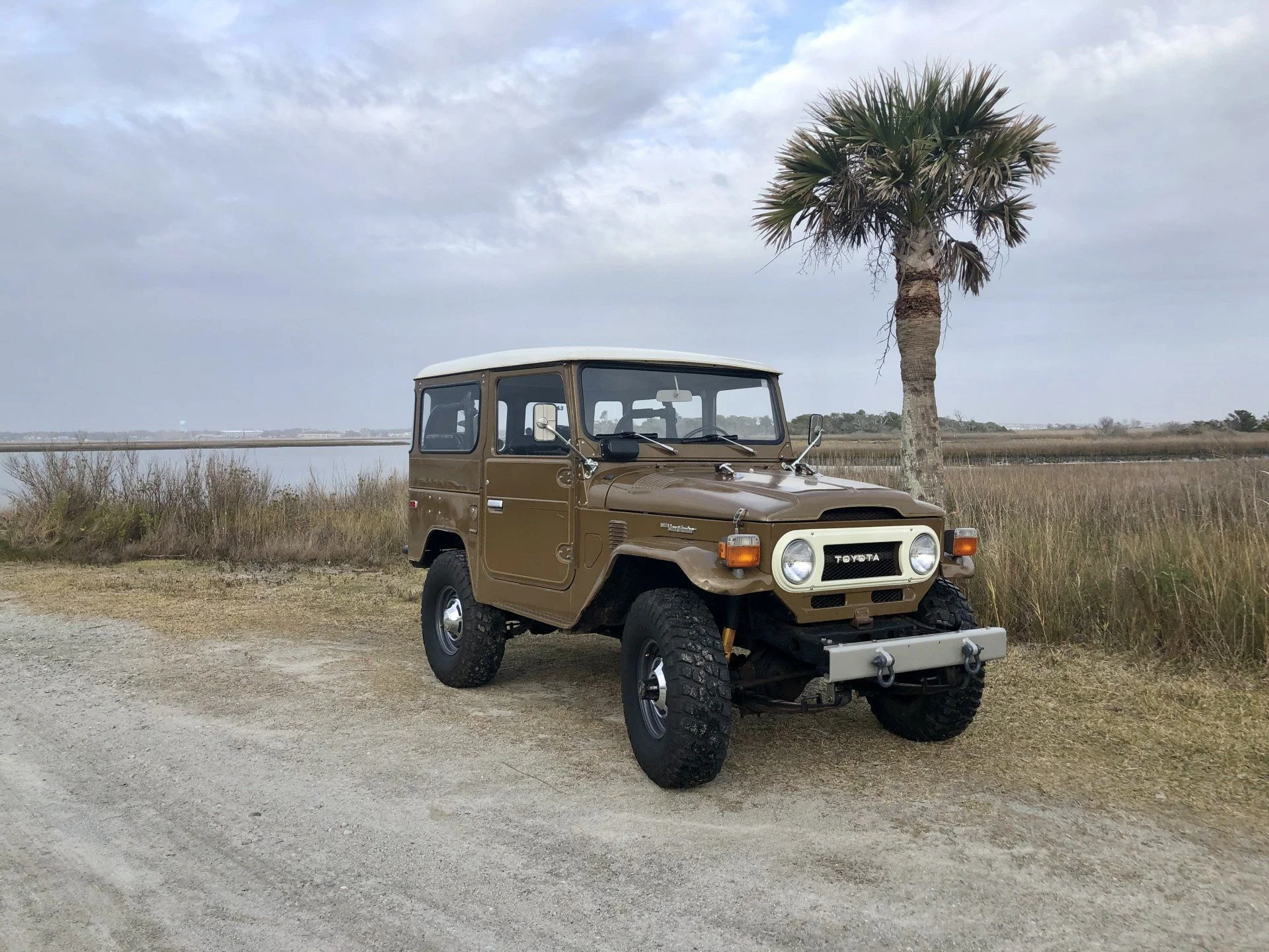

Winding down 2020 at the coast with the fam and the 40, tough to beat - Happy New Year to all!!

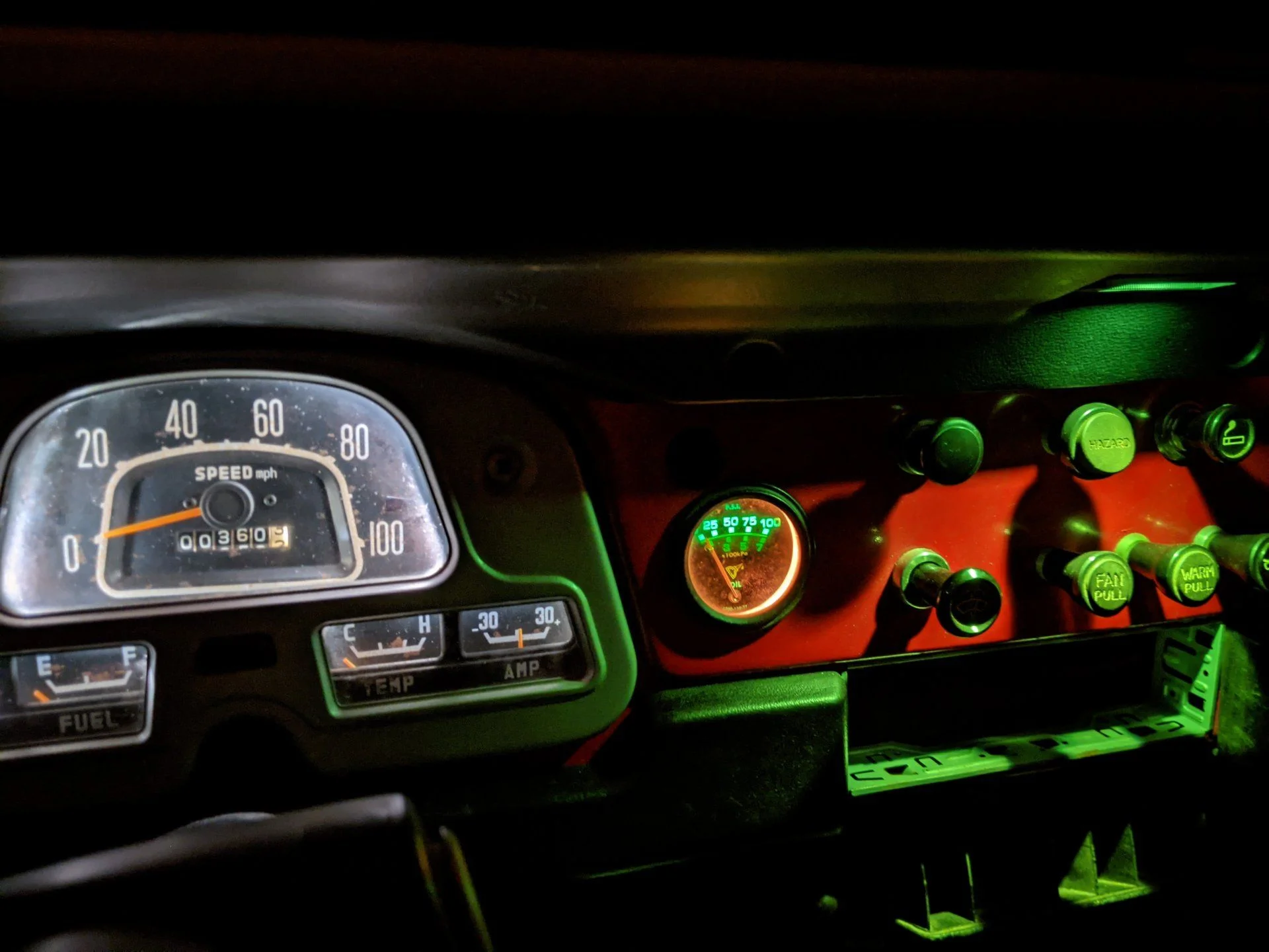

Got new 10" speedometer cable installed from transfer case to speed generator (that I'm told should exist on a 1970 but does) and California "blue & yellow/ correct year" plates registered to our 1970 LC through DMV's "year of manufacture" (YOM) program. No more white plates!!
Shout out to Davesclp.com for the period correct plates.

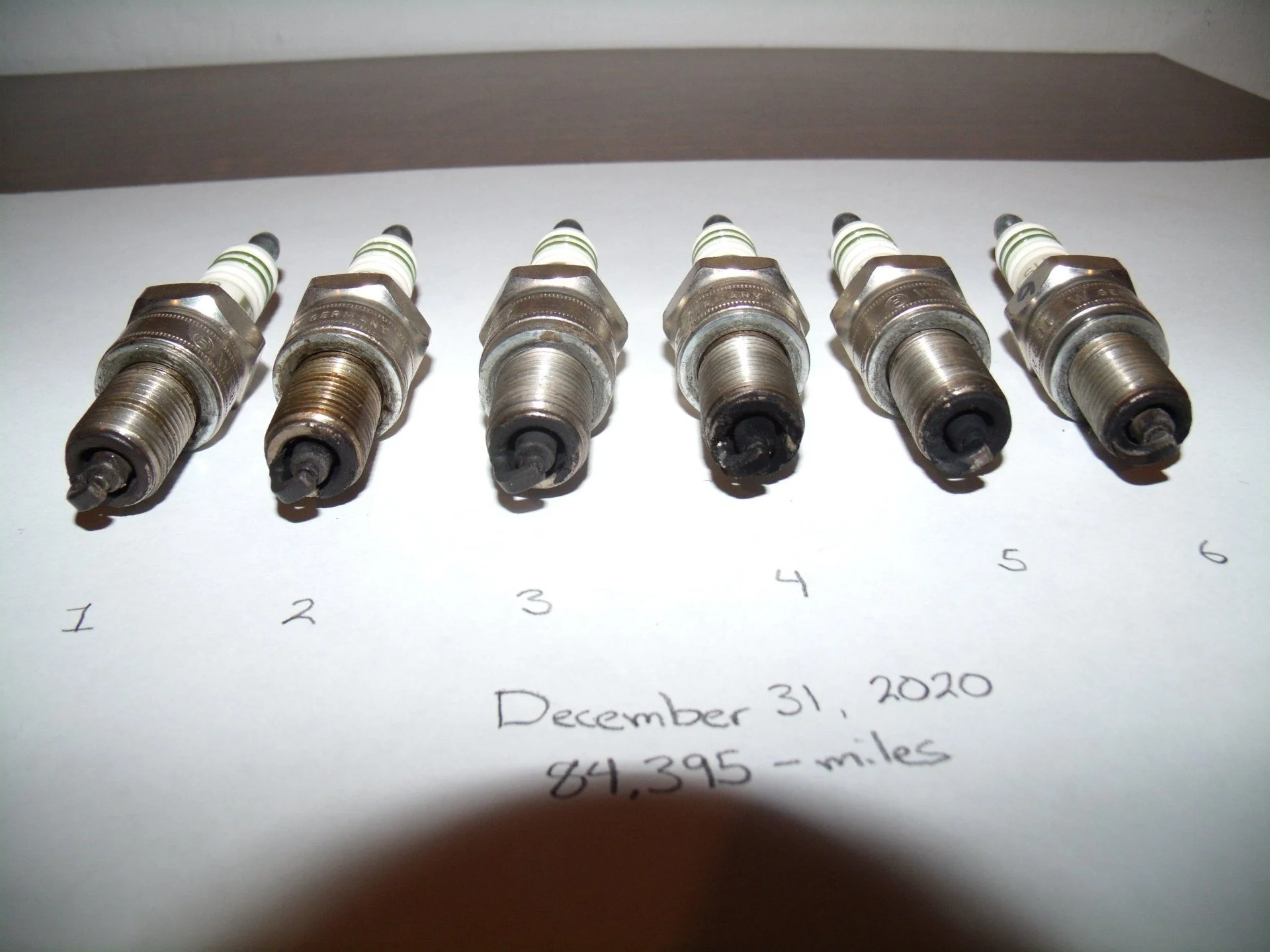

About a year of use, and the rehab 2F is either making carbon, or moving carbon. Number Four fouled. 1 mm plug gap, coil and igniter with points. Dwell was checked when the new distributor was installed.
Following to see what you determine to be the cause and the fix. Thanks
Just swap-in clean plugs when I change the oil.
I believe that the cause is burning a small amount of oil from the rings, or, it is from the valves before I replaced the seals. When I pull plugs, just after cleaning them, I see a bit of oil on their surface, so it suggests rings. Some of the oil contains a bit of sludge (rust), so it is understandable why the deposit doesn't burn away completely.
The fix, rebuilding the engine couldn't hurt. Maybe the plug (Bosch WR8DC) is the wrong heat rating? However, making scrap-yard machines continue their utility is kinda fun. Plus it requires old-school knowledge that is frowned upon, or straight-up hated, in the age of self-driving, self-mending automobiles.

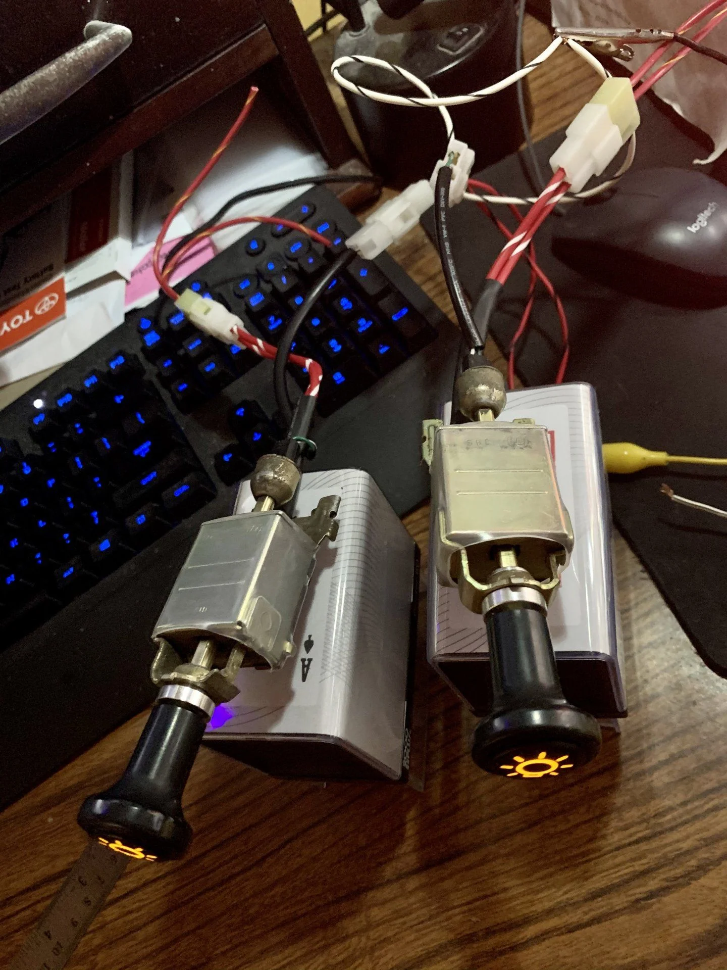

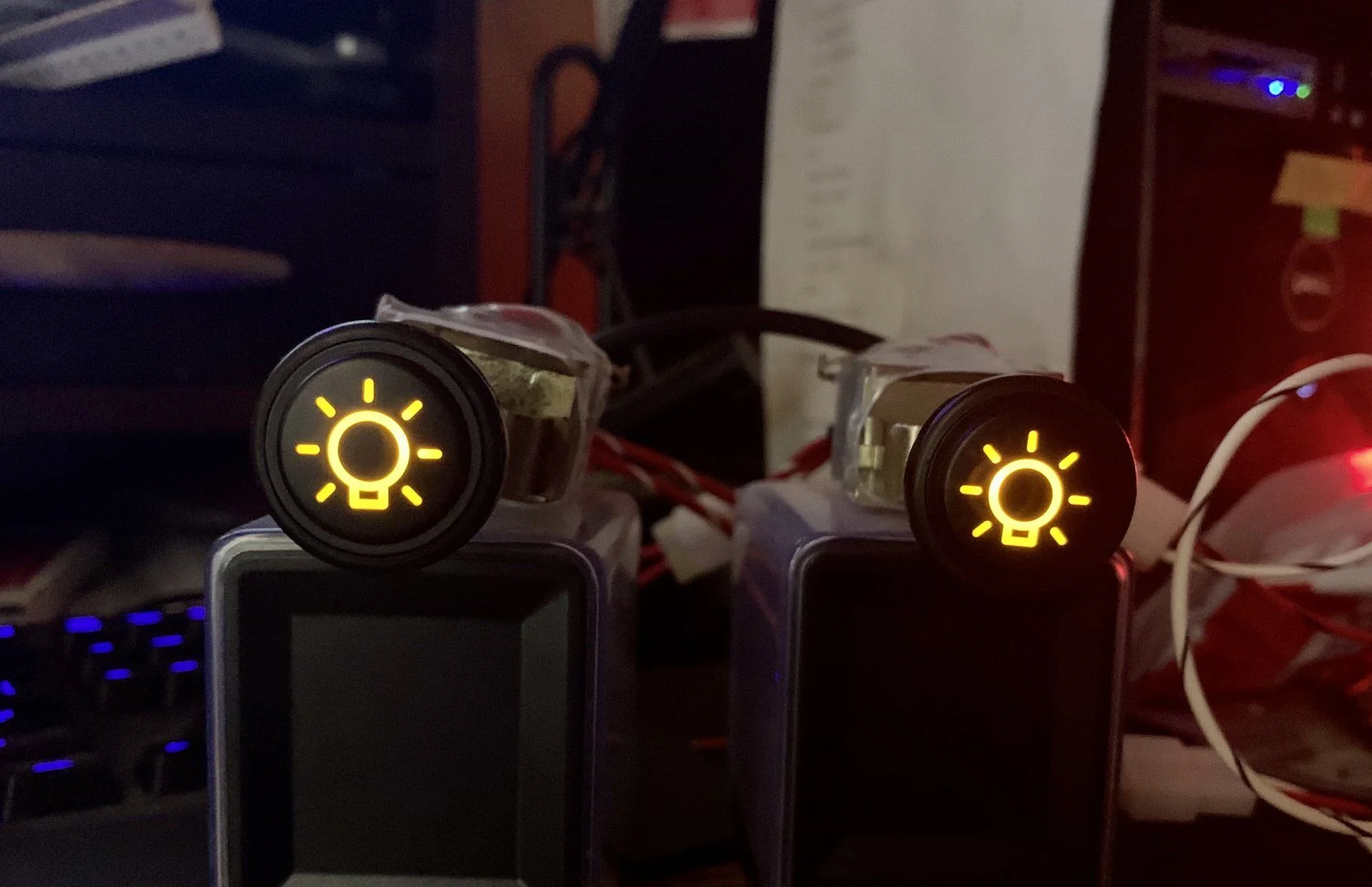

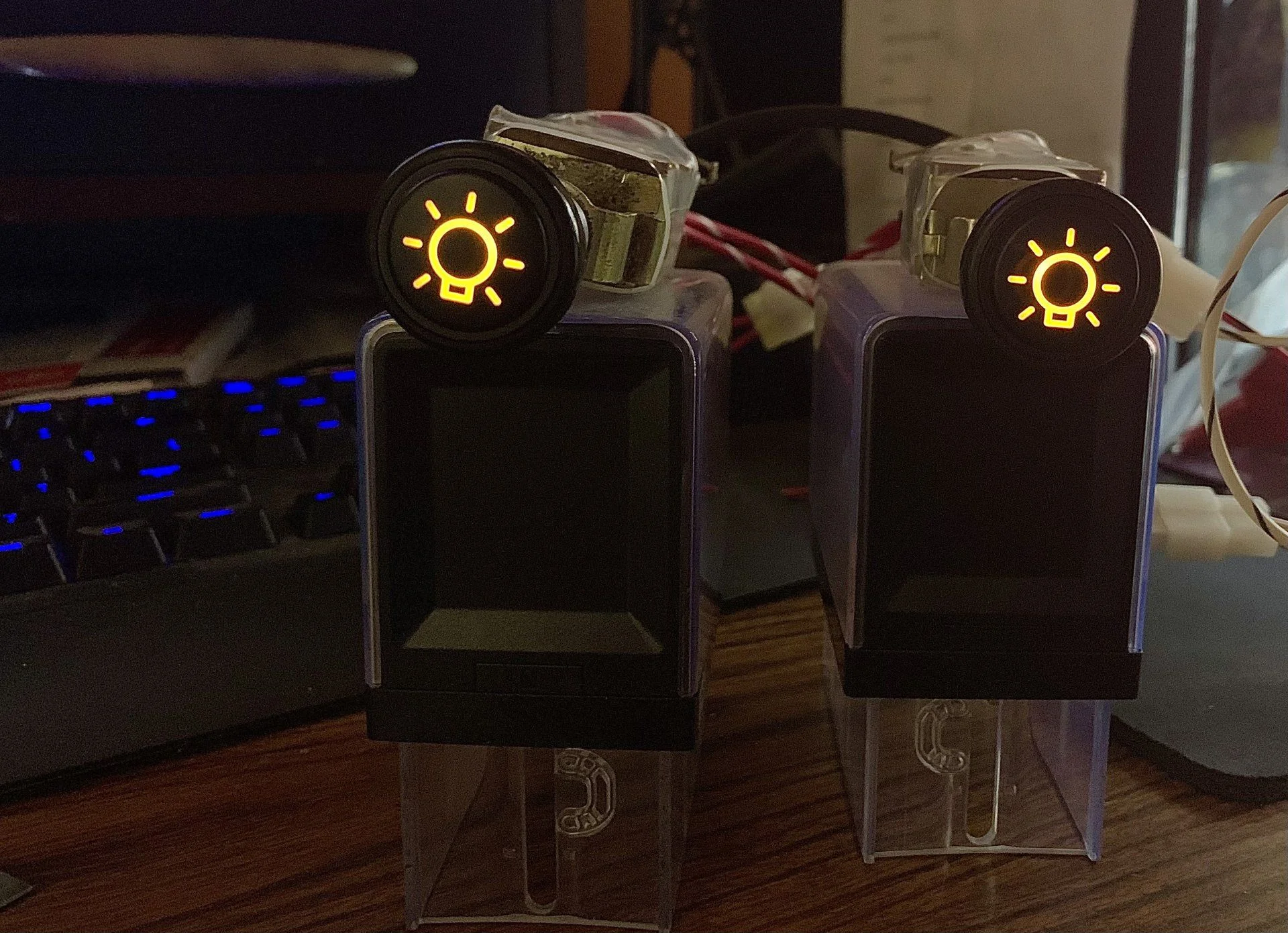

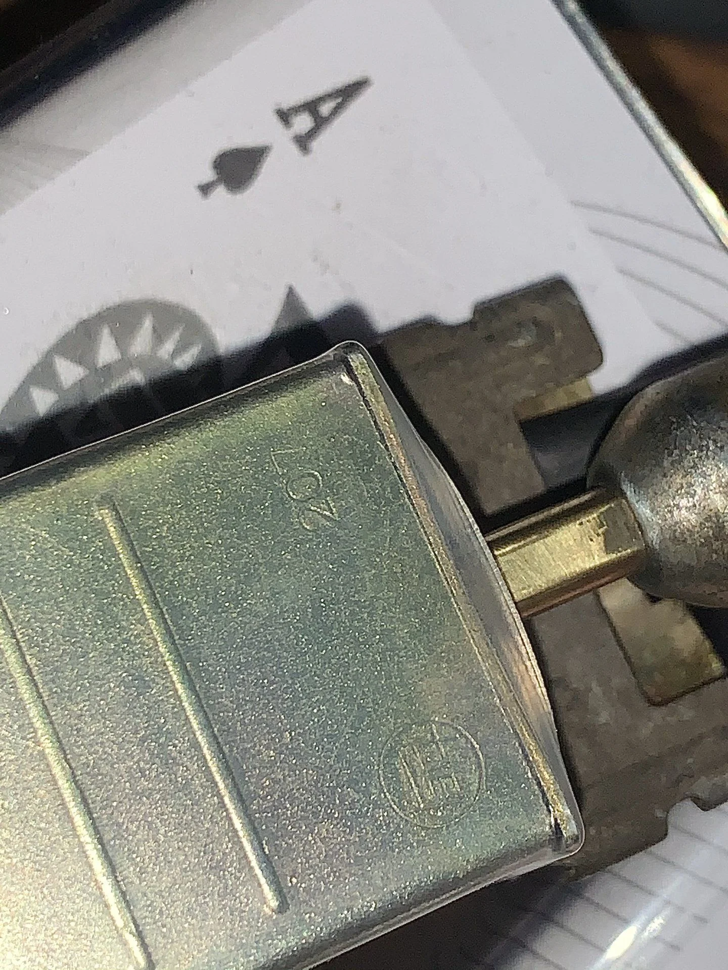

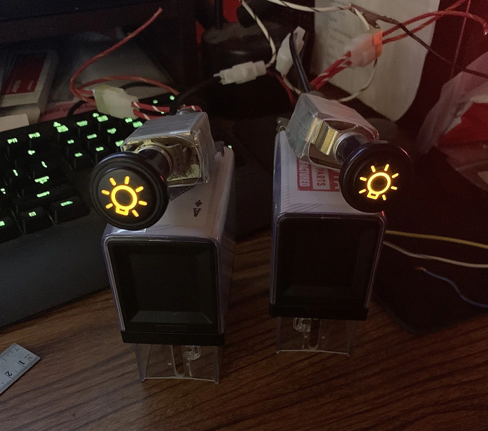

Was Commissioned to restore and assemble a matching mating set of AUX LED Switches ..........
HEAVY DUTY type ..
the is my first use of a new updated Super Max LED Bulb , and i was not disappointed :cool:
