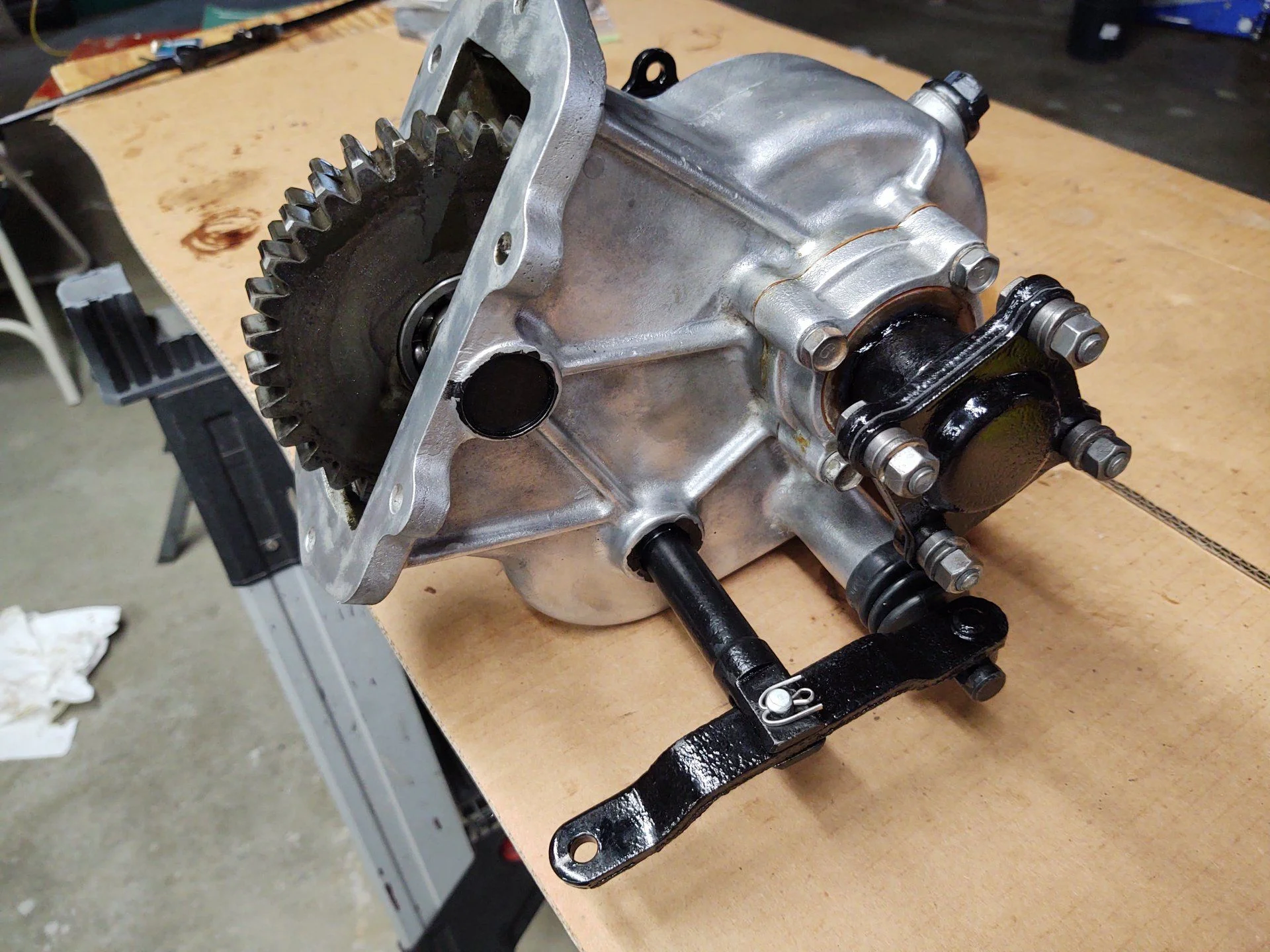

Time to get the PTO gearbox cleaned up. Checked out the bearings (they were fine) replaced the seals (long gone) and the gaskets on the bearing retainers. Buffed out all the steel parts and painted. Cleaned up the aluminum case with mineral spirits and a wire brush on a die grinder.
Next step is to "bench press" it into position...

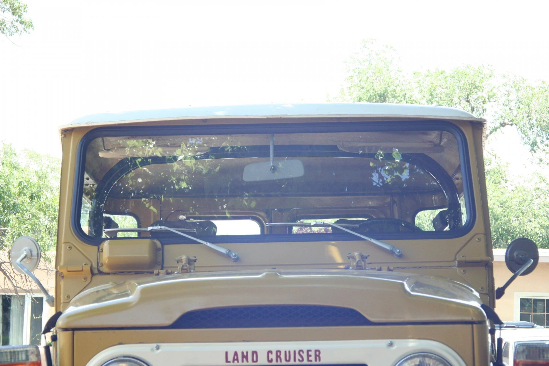

I had my neighborhood Toyota service center install a new Cruiser Corps windshield with OEM weatherstrip. They also replaced some rotted weatherstrip on the old ambulance door glass.
The guy at the service desk couldn't contain himself, and he told me how stoked he was that he got to drive it.
What did they charge you for the install, if you don't mind me asking?
