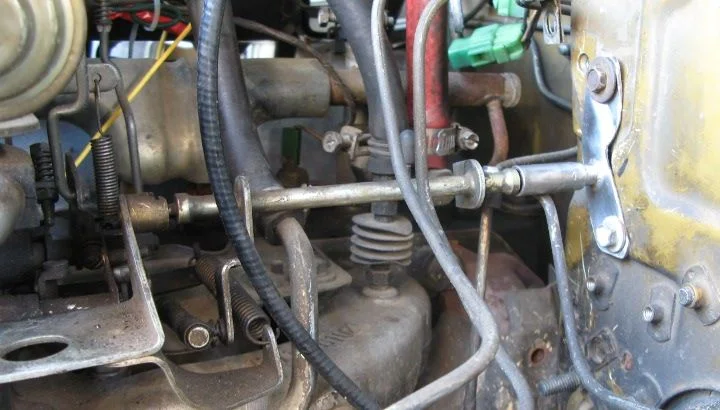

At S&T, we had some trouble with the throttle rod popping out of the firewall socket. This is a later model 2f replacement, and the throttle linkage was not the strong point. It was so ugly I didn't even take a 'before' picture. Image a rusty hunk of scrap metal held to the firewall by one bolt in the top hole. We reused the tube, but pointed it in the right direction and spaced it out to the linkage couldn't pop out. All stainless steel, btw.

At S&T, we had some trouble with the throttle rod popping out of the firewall socket. ...
How odd!
Is that how Toyota did it?
I wouldn't have thought it was advisable to have that mounted to the firewall when the engine must be able to rock on its mounts. :frown:
Wouldn't "dropping the clutch" but strain on that linkage?
:cheers:
A stock '78 has a similar firewall bracket but with a rubber gromet. I'll have to see how much the torque rod can move fore and aft, but I don't think it could move 1/2".
I was thinking the engine would torque only side-to-side. Both ends of the shaft have ball ends, so it can move that way. There's a ball end inside the tip of the stainless tube. It might need to be trimmed so there's a bit more gap for front-to-back movement.
I'm pretty sure the stock linkage (#51) firewall end is just a cut-off rod. Somehow the one I have has been modified. I'll have to look at it more closely.
40 and 55 series torque rod brackets. The end of 51 pokes into 57:
I have a bone stock 78 and 1/2 inch would be about all the movement it could stand.

......A stock '78 has a similar firewall bracket but with a rubber gromet. ..... Both ends of the shaft have ball ends, so it can move that way. There's a ball end inside the tip of the stainless tube. ........
Thanks Eddy.
That allays my fears.
:beer:
(I'm just unfamiliar with the petrol engines ... that's all.)
Eddy's throttle linkage is half FJ60 and half FJ40.
And that's why it doesn't play nicely. :frown:
There is a tork rod for 81-newer FJ40 that has the 60 style front end, and the plain FJ40 tail end that just rides in a rubber grommet at the firewall.
The FJ60 tork rod is suspended from ball&sokt at both ends. There's a fancy swinging bracket on the firewall to allow for movement between body & engine. See part #60 in SOR's linkage illustration below.
BTW Eddy, there should be a hairpin clip to keep the ball end in the carb socket, doesn't seem to be there? That would help keep that end in place.
