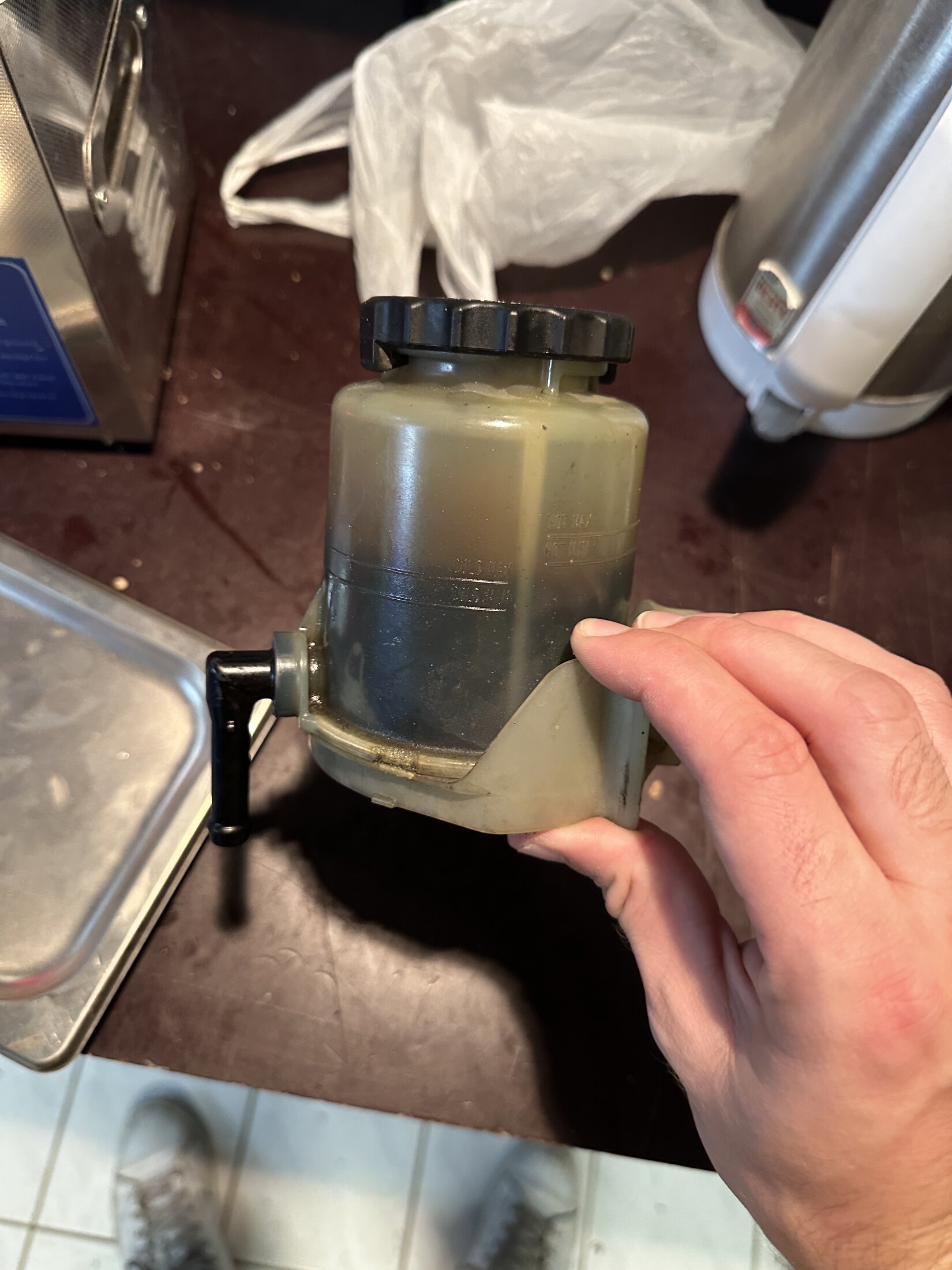

Removed and cleaned my power steering reservoir today.
Steering started like two weeks ago feeling a bit more flimsy, loose and wiggly than usual. So checked all connections at the suspension and stuff like but looked fine and solid.
So I think it was maybe time to change the steering fluid but it wouldn’t make sense without cleaning the reservoir.
Well took me like 30min to remove the returnal line but thennit was a fast process.
Half hour with some cleaner in the ultrasonic cleaner and it looked way better. Gave it a second run and washed it then a longer time with clear water, washed it with Iso and now it is sitting on 60C in my 3D printer to dry over night.
before cleaning
while cleaning
looks „nearly“ as new
I just hope my power steering rack isn’t f***d up….
I think I will do this cleaning in like a month a second time together with a full flush of the fluid like this time.
before cleaning
while cleaning
How much km? Was replacement ever done before?
Around 340.000km right now. Got it from a friend with like 270k a few years ago.
Would guess no or maybe that time when the car got t-boned in 2016 by a semi what caused some broken suspension parts in the front…
Ok, maybe there is some upside to this. When I at 33k mile or around 50k km flushed the factory power steering fluid from Toyota factory to redline ATF4, which is red coloured synthetic ATF oil, I am left with the dark “sheen” you pretty much showed on the little reservoir. In other words, it seems the factory fluid has some additive in there which sticks to the wall. Obviously in my case at low mileage everything else was perfectly fine, so I have some hope for you this is false alarm. I.e. the film you see is nothing out of order and the rest is still in good working shape. Fingers crossed. Keep us posted on any learnings.
I changed my power steering fluid a few months ago. Didn't bother cleaning the reservoir. Didn't see the point if I'm not changing/cleaning all the lines and the rack itself.
The fact that your steering started feeling lose all of the sudden makes me wonder if its something other than the fluid which would degrade over time not all at once. Keep us updated.
So, changed today the fluid. Dry steered/pumped as much as I could and filled then something like liter into the system.
And (to my surprise as well..) it looks like that the steering is working well now. Alot of debris came with the old fluid (like little black stuff) and I guess this has built up a bit here and there and kinda blocked the valves or whatever is around the pistons.
Will run this now a few weeks and give it another flush after I know now how to remove the hoses - that was the longest part of the whole process since they sit super super tight and even with the removed top of the airfilter there isn’t much space.
