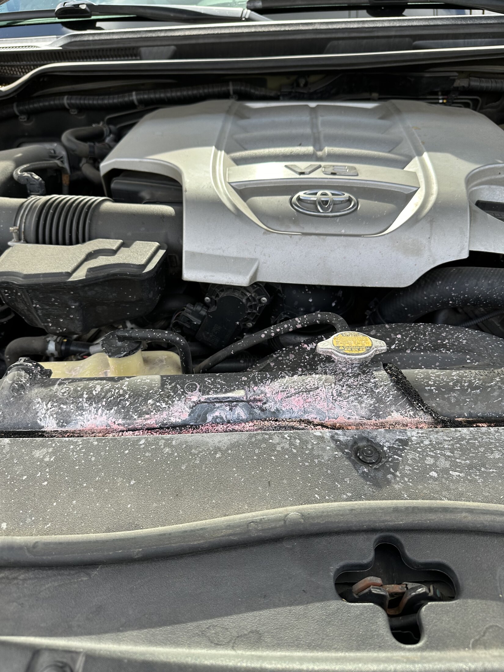

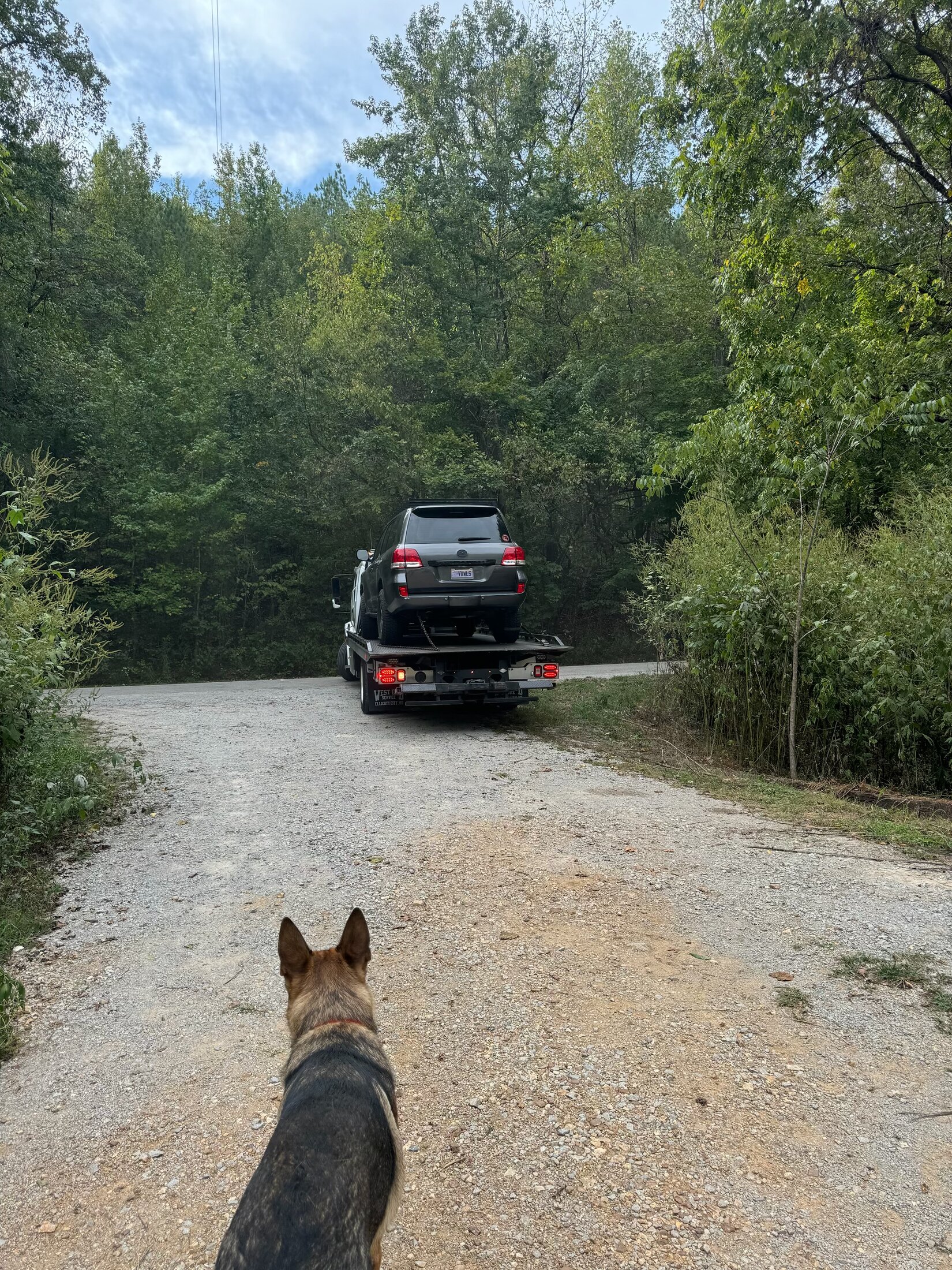

Had a two for one today. My wife, son, and I were traveling home from a conference. We stopped for lunch just over two hours away from home and when we got back in, the battery light was on.
The gauge still read around 12v so I figured we could make it home. Within the next hour the gauge was down to nearly 9v, and VSC, Brakes were indicated.
I took the next exit, as the AC and all power went out. Coasted into a church parking lot, popped the hood, and was surprised to find the radiator was cracked. I never noticed the temp on the dash be higher than normal.
Towed it home to my mechanic to check the battery, alternator, and replace the radiator.
always sad to see it on the flatbed :( Hopefully a quick and simple fix then back in action.

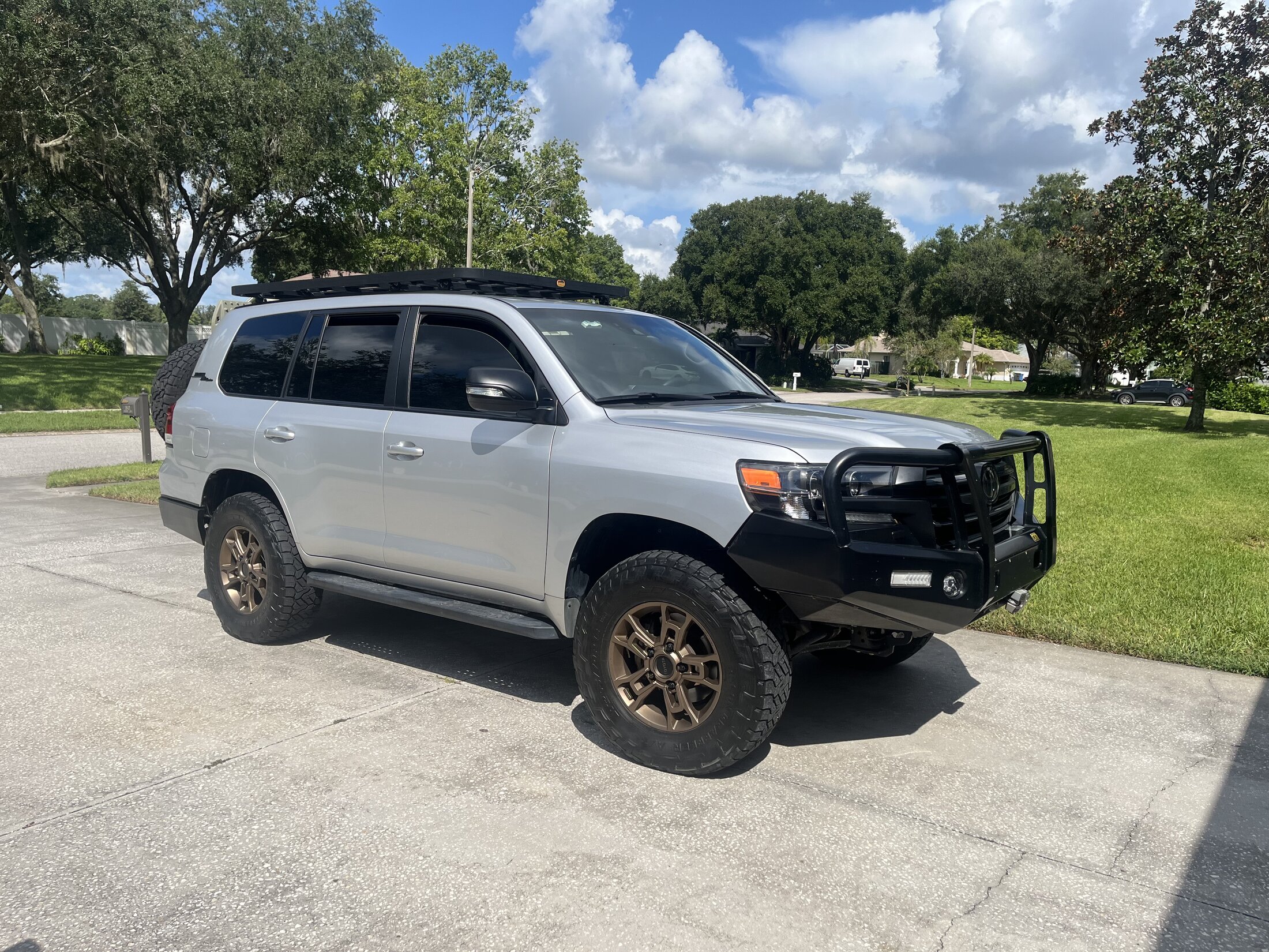

Well I said goodbye to her today. Found a Raptor R for 2500 over msrp and pulled the trigger. Part of me misses her already.
good luck man. i actually came from a back halfed SVC-4 linked gen 2 on 39s. great desert truck out here in So cal but that's about it. not really much i miss, and if i do want the woo woo noises i'll call magnuson.

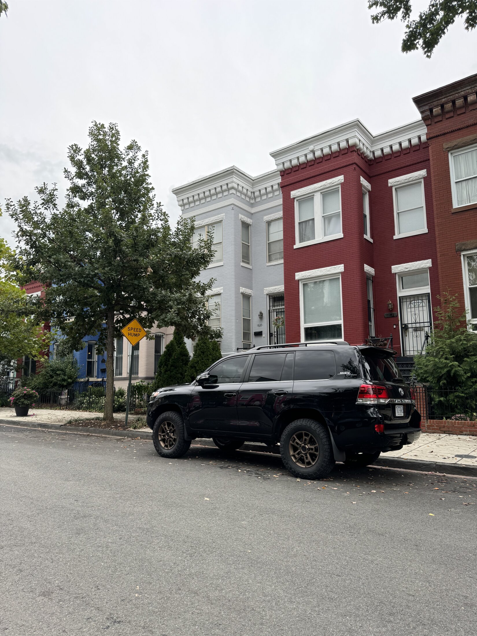

my impulse would be towards violence, even though I know it’s only a property crime.
It’s not just property. They stole his time when they stole that vehicle. The time it took to earn the money to pay for it, the time and headaches it will take to deal with the insurance company, the time without the vehicle, and on and on. Thieves have taken something he will not be able to recoup. They aggressed first, violence would not be an escalation.
