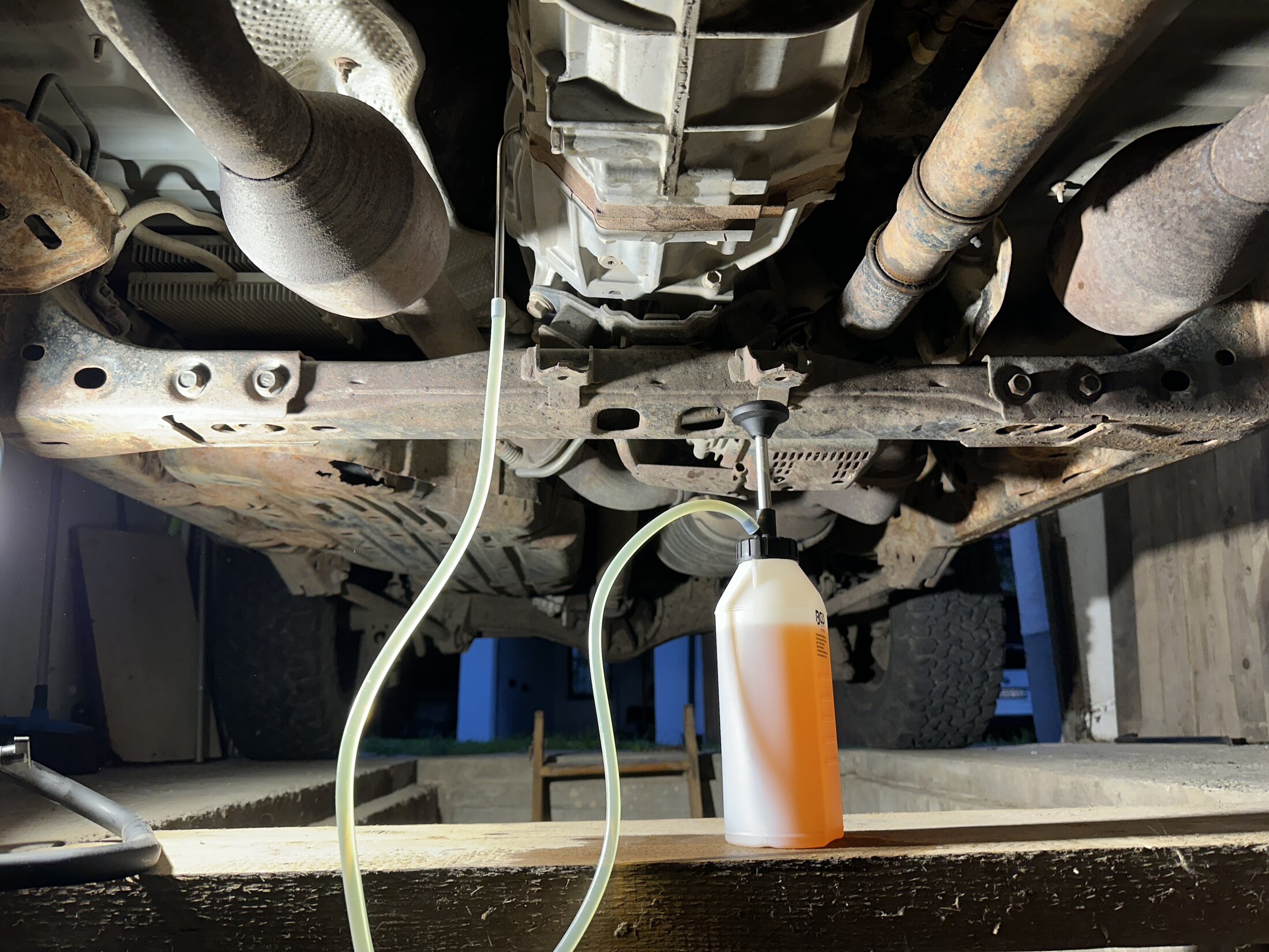

My H150F gearbox got today some fresh oil. Last change was like a 130k miles ago.
But it looked pretty decent. Still no big darkening, no debris or metal.
Was reading online that it normally takes 3l of gear oil but in the end I filled something like 3.1-3.2l till it started to flow from the fill plug.
(At least I guess that was the fill plug since it was on the same side and had the same head for the screw. On the other side there is also a plug that is a little bit lower but has a big torx to open………)

ooooo, I like that gear oil pump bottle.
Can you share where you purchased that?

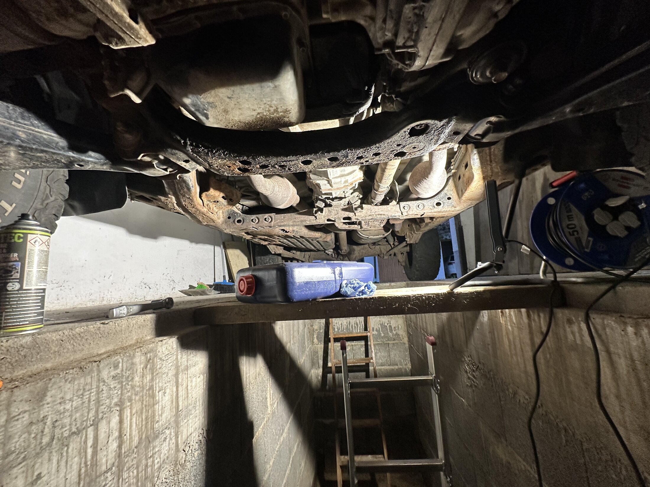

I'm jealous of that service pit. I wouldn't sweat much over an extra .1L.
Yeah I am happy to have it in the garage. Like a year after I moved in this was the next garage that was aviable. Three cars deep (so its with 60sqm 5sqm bigger than my apartment hehe) and my landlord was digging it by hand 25 years ago when he was 18…
A bit too deep with 2m by I don’t want complain.
But still depending on the source (now a few hours later I have a wide range of 2.5-3l for the H150f gearbox) it could be up to a half liter more and that can maybe cause foaming what leads to bad oil performance. - and I want to know.
/update
So yeah also in the 80s section they say it should be the plug on the LH side. Looks like the PO didn’t care much about and switched them. Drained now to the lower level of that screw with the 55 torx.

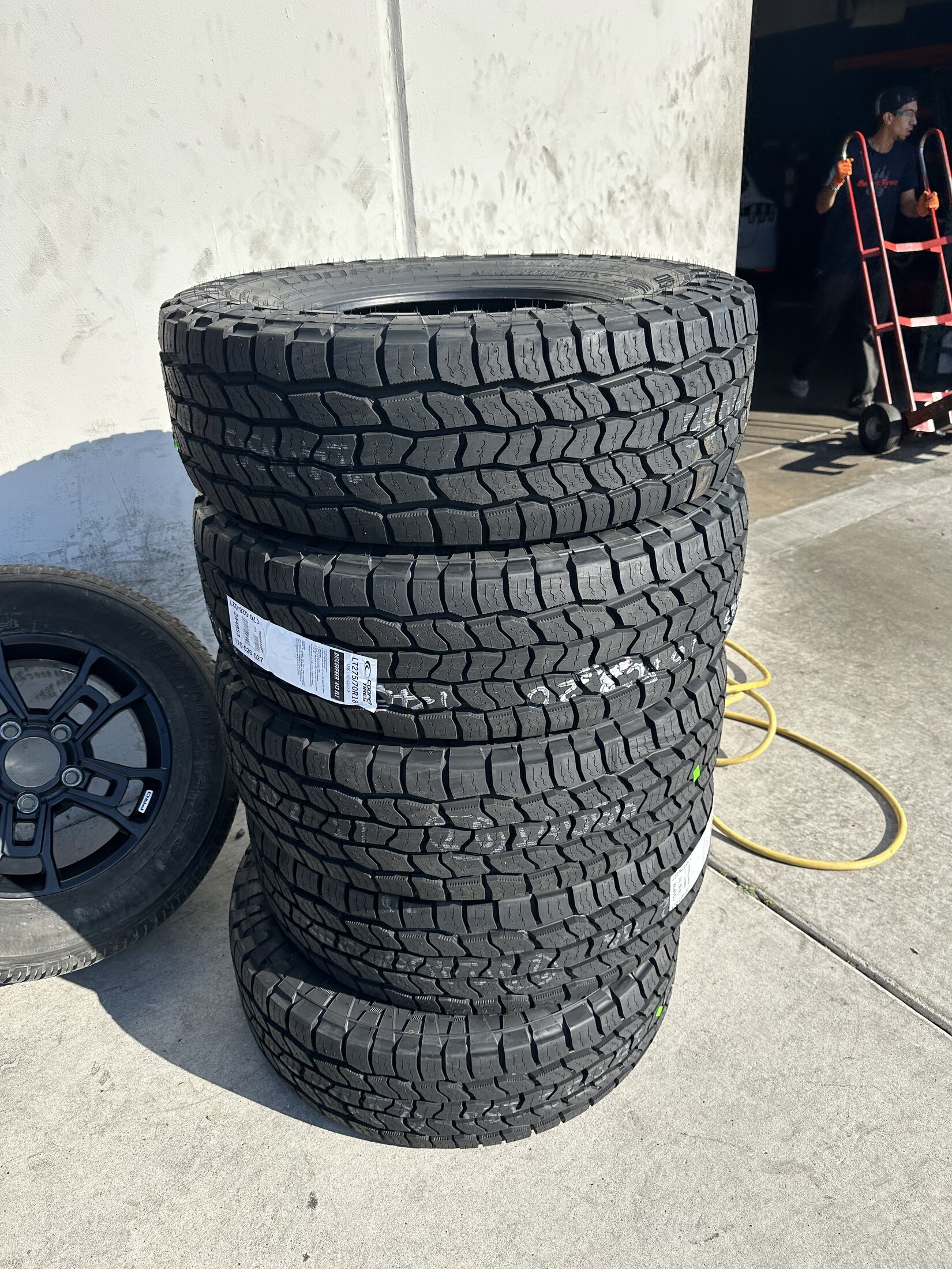

Got my closeout coopers mounted yesterday afternoon. Shoutout to Bears Tires (I’ve been going there so long it used to be Bears Used Tires). They got me in and out in 30 minutes including the spare.
Initial impressions are great ride, love the clearance, no rubbing on any fender plastics, and just an ever so slightly kiss of the drivers side front tire on the Kdss bar at full full lock. Oh and I saw this drive by me at the stop sign this morning…
