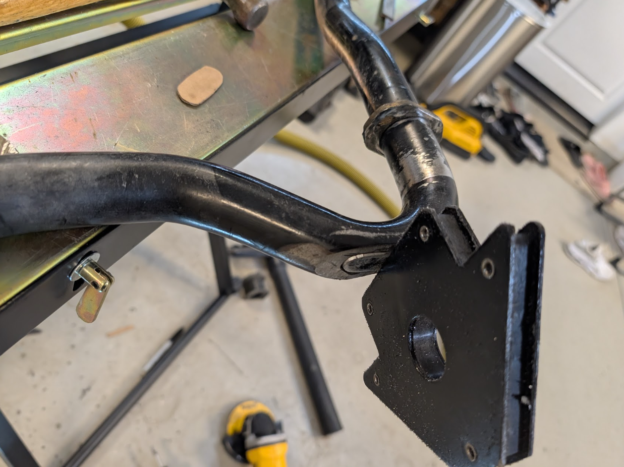

What the sacrilege is going on here? Not very confident in this but I'm doing it. Results TBD.
You’re a bold man, but aren’t swaybars spring steel?
Totally and what I'm doing is not really kosher. Trying not to put much heat into it with pulse TIG, and avoiding stress risers. This is experimental and we'll see how it goes. I'm hoping most of the torsion happens in the long section in between. I already would do it differently now that I see how thick the wall is (8mm), but if it breaks, it's not a big deal and I'll do it in another way.
I would be more comfortable doing this on a KDSS bracket if I had an LC, as that is distinct from the spring steel sway bar.
I’ve never heard of a spring steel tube, if that is what you are working on. If you have ground down a part of any kind of hardened steel tube, it is likely annealed. Stress will be in that location. Count on it failing, so test it accordingly. Good luck.
