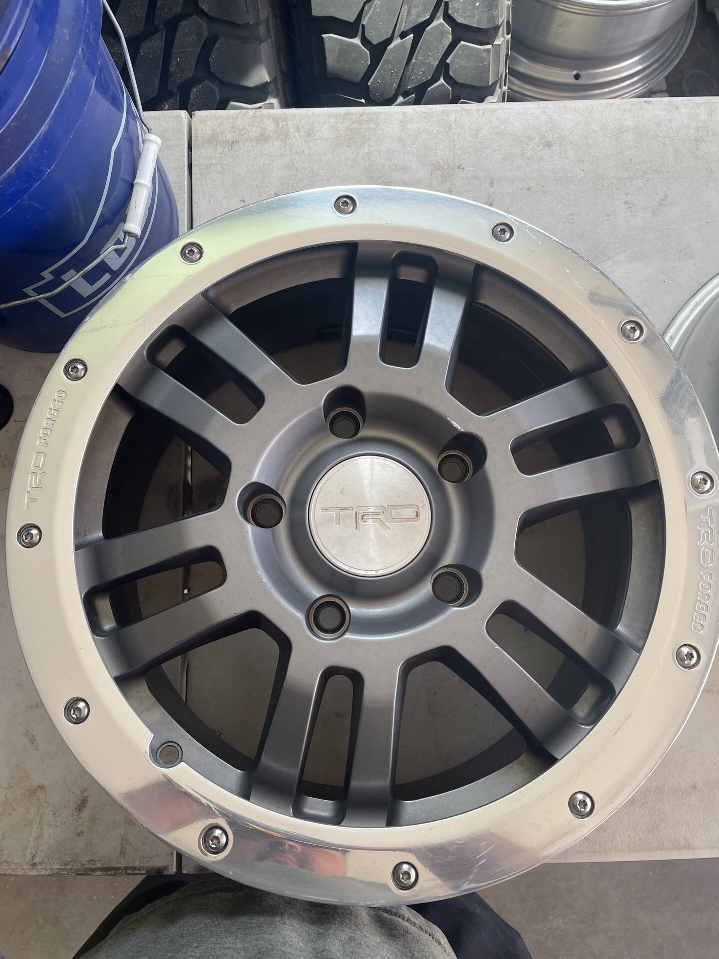

Made some new rings for the TRD Rock Warrior wheels.
I'm going to paint them, then add them to the LX.
What’s your day job? You have impressive machining skills.
Well, I designed them, then had a cnc machine make them. Thanks though :)
Shut up and take my money!
Seriously, how much for a set of 4? The rock warriors I have need new rings.
I have a set for you.
I don't have the hardware yet, but I'll just tell you where to buy it, or you can use the existing RW hardware. Hardware is pretty cheap compared to the RW HW ~$10-$15 from fastenal.
It will be around $700 for a set of 4, including shipping.
These are beautiful. Wow.
Another reason to find some rock warriors

Added some paint, too bad it takes away from the machine marks.

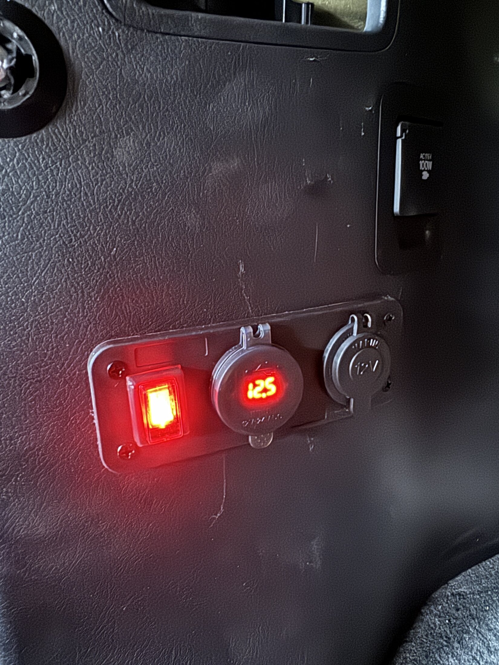

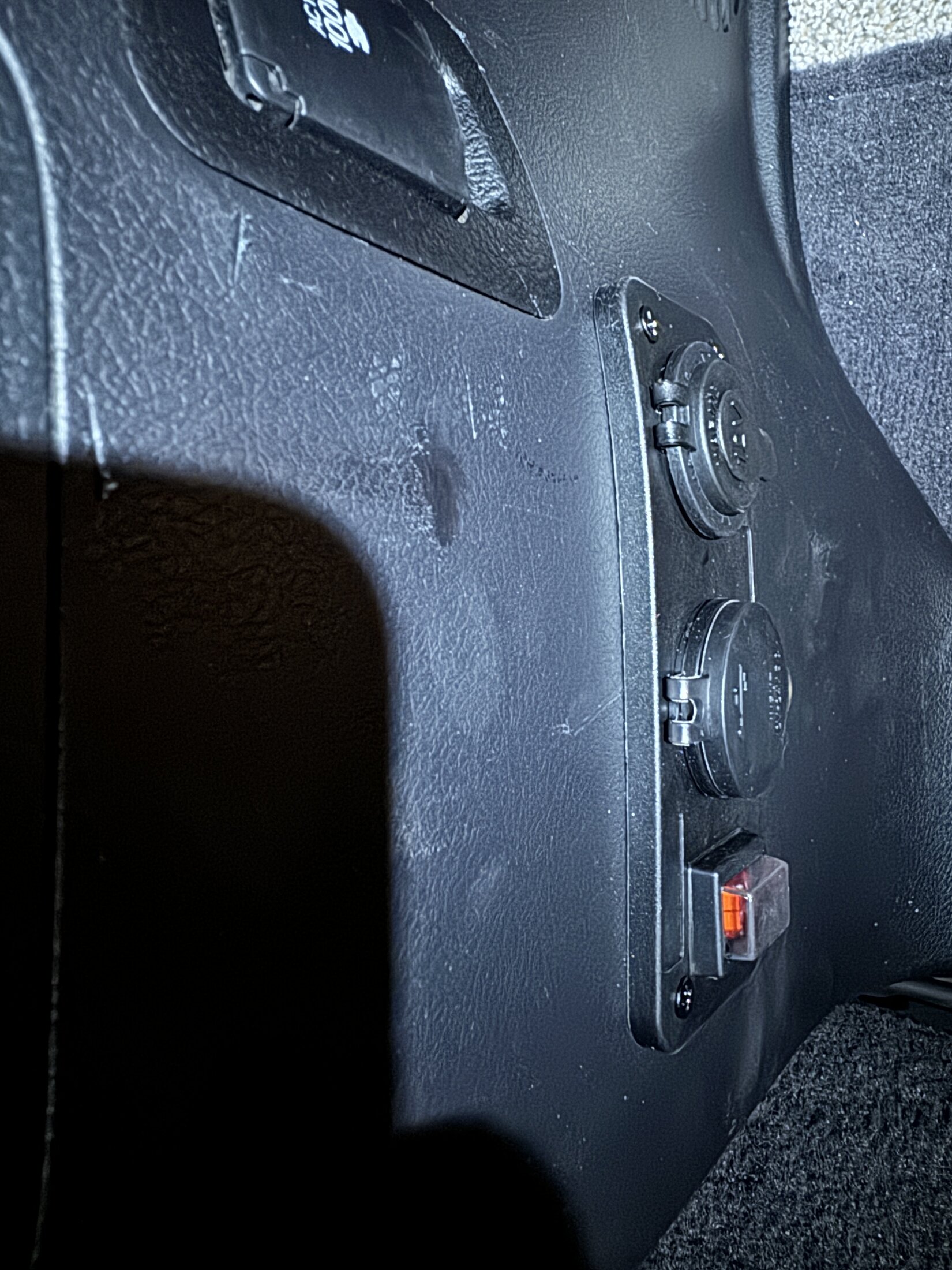

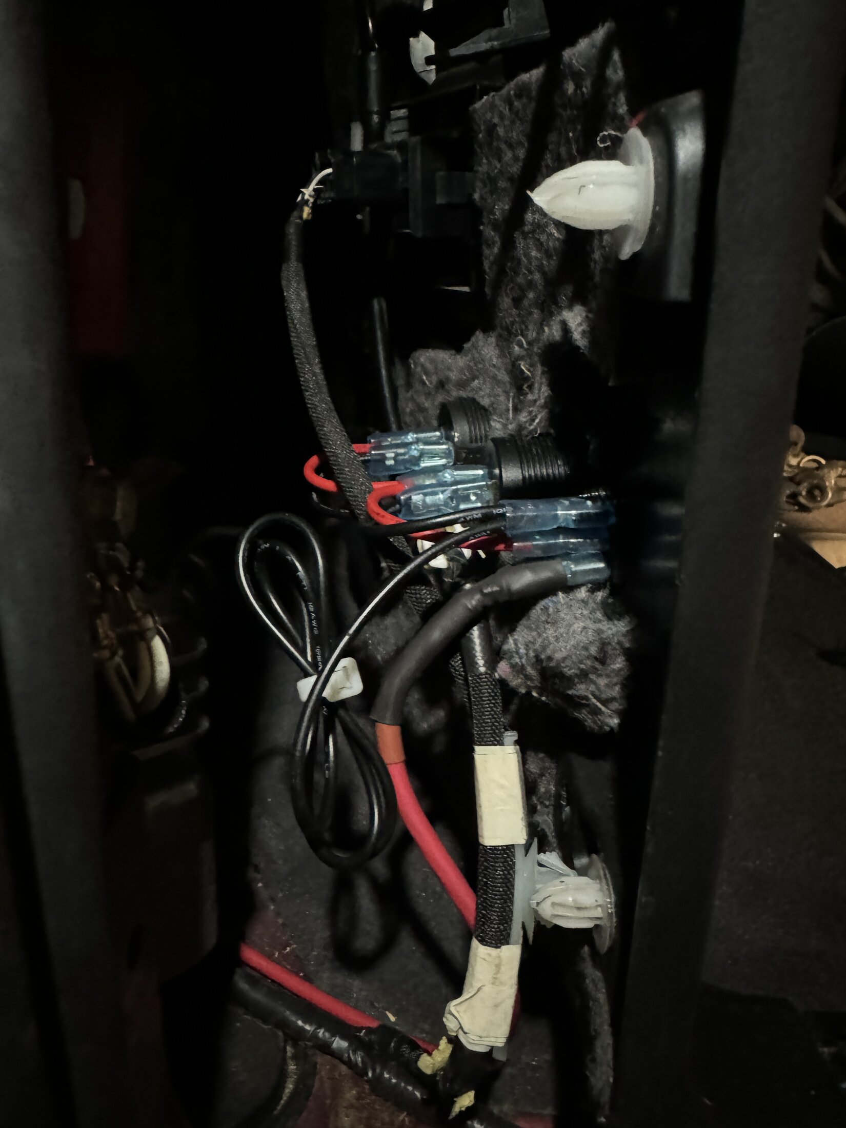

Converted the 2nd cigarette lighter to a USB power port in the front and power port for the fridge/ accessories added in the rear cargo area!
Even heat gunned the plate to match the contour of the back trim. No one will ever notice, but I’ll know ;)

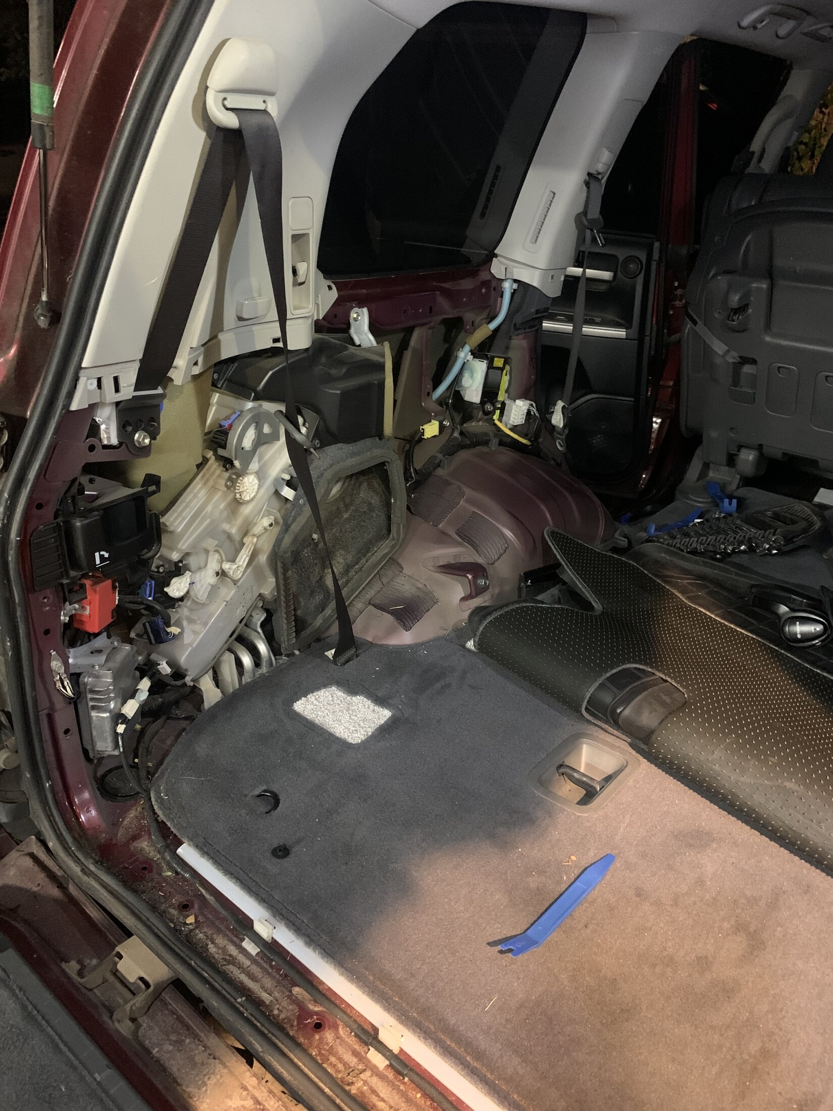

Cleaned up the ac intake a bit as it was dusty. There’s No filter for the rear ac
I gotta know how to do these. This perfect upgrade. And yes that rear ac is a beast at pulling in dirt.
