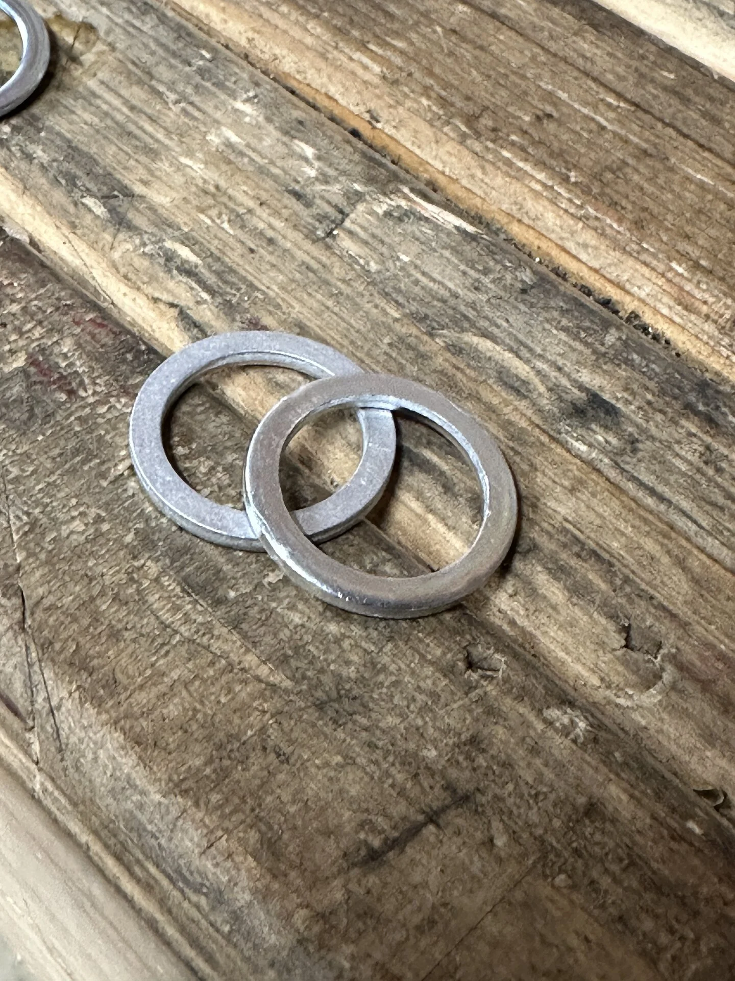

Oil drain gasket. 90430-12031
Super cheap.
Transfer case drain/fill gasket. 90430-18008
Rear axle drain/fill gasket, also front diff fill. 12157-10010
Front diff drain gasket. 90430-24003

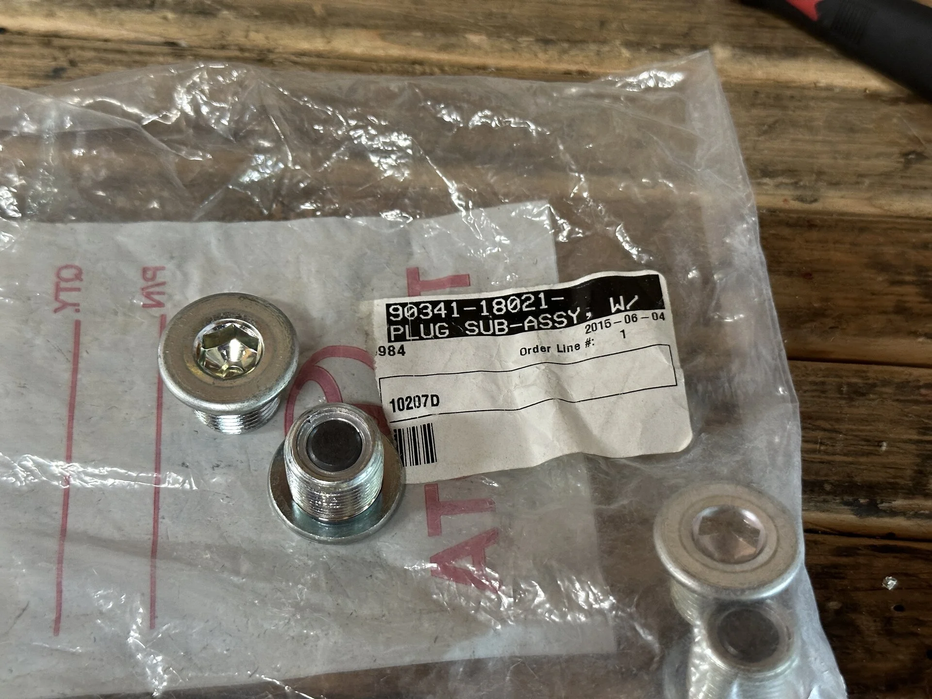

Mini truck guys change their rear axle drain plugs with these low-profile models, including magnets. 90341-18021
Same thread but I'm not sure whether there's clearance inside the transfer case for these.

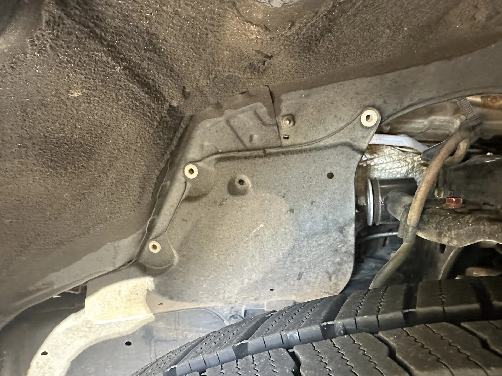

Stock splash guard bolts. One of each. See the thread here:

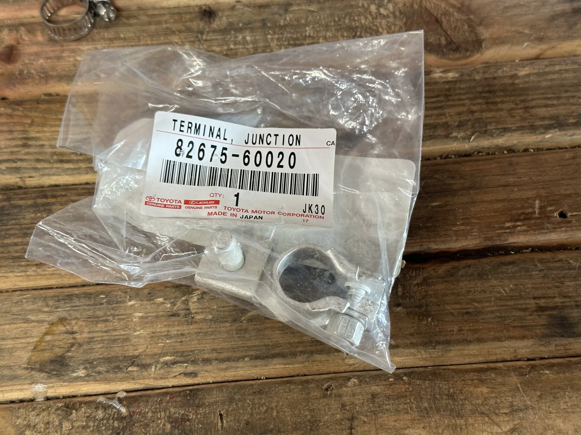

Stock positive battery terminal. 82675-60020
These do stretch and wear out, not to mention corrosion.

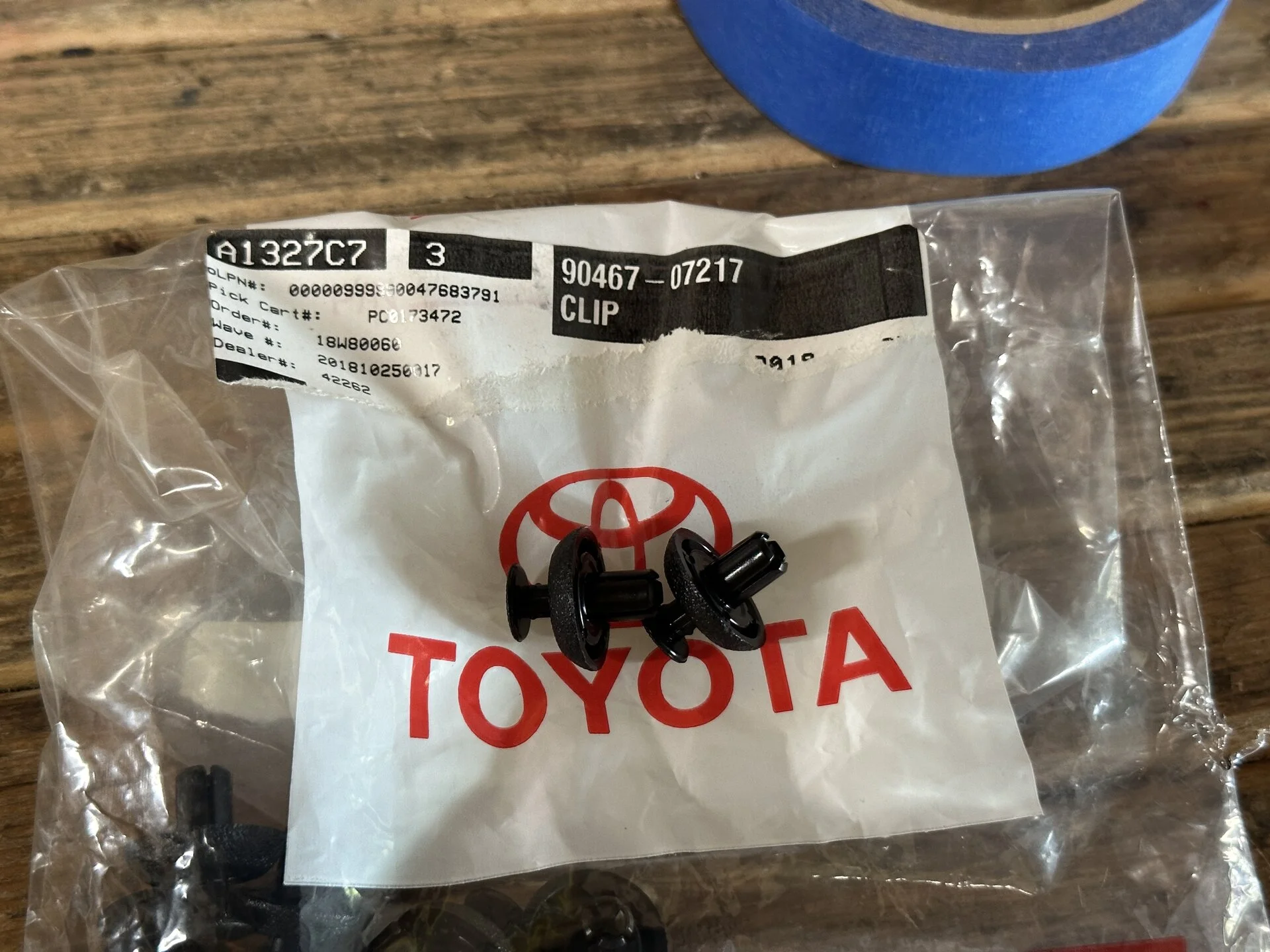

Core support cover push rivets. 90467-07217
These do age and become brittle. Have a few on hand.

90467-07217
This. I break these every time I even look at the truck.

Are these the same thread/size across 80, 100 and 200 series? I have some from either my previous 80 or 100…not sure and wondering if they’d work in the 200.

Yep, same thread/size. They may work in the transfer case too but as I said I’d want to make sure they aren’t too long before telling anyone they will for sure.

Thread 'Transfer case drainplug musings' Transfer case drainplug musings - https://forum.ih8mud.com/threads/transfer-case-drainplug-musings.278323/
If I read this thread correctly then bjowett says they will work in the transfer case. I've got some waiting on the shelf for next fluid change interval. Read it yourself though to see what he says goes where for magnet plugs.

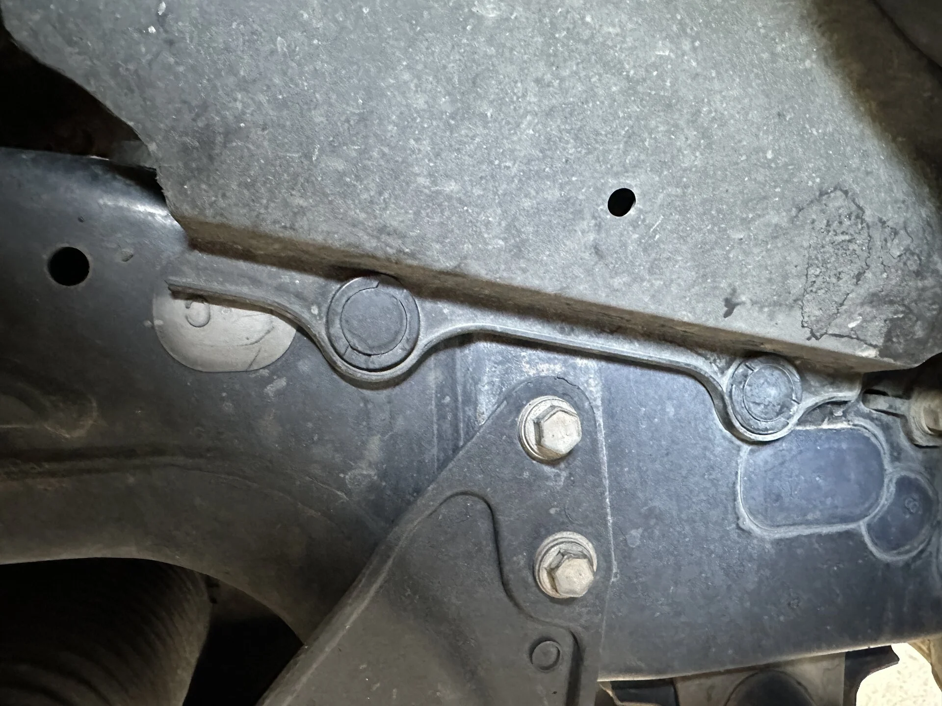

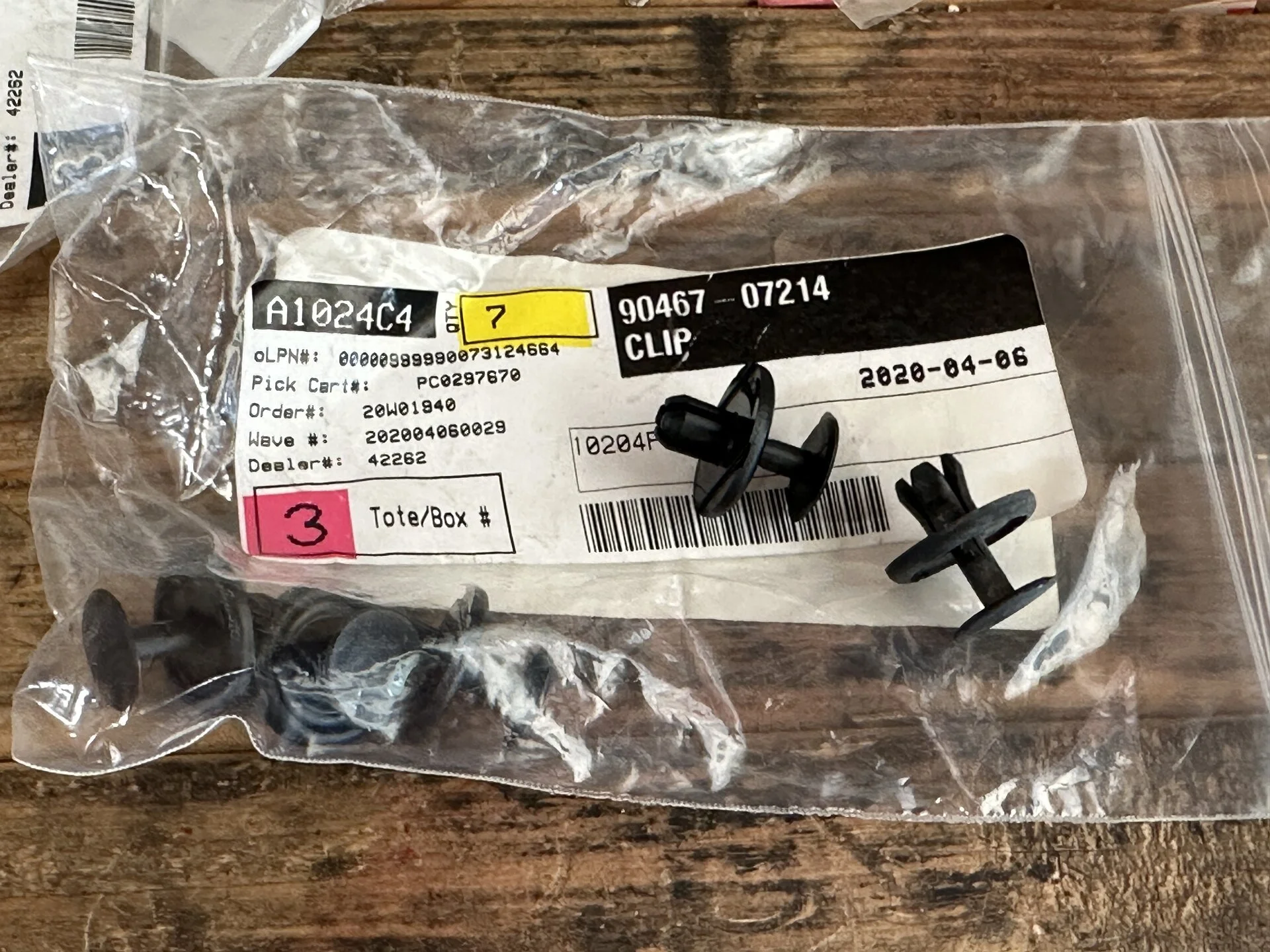

Fender liner clips for rear of front wheel well. 90467-07214
Like many of the other plastic push clips these get brittle and fouled with dirt

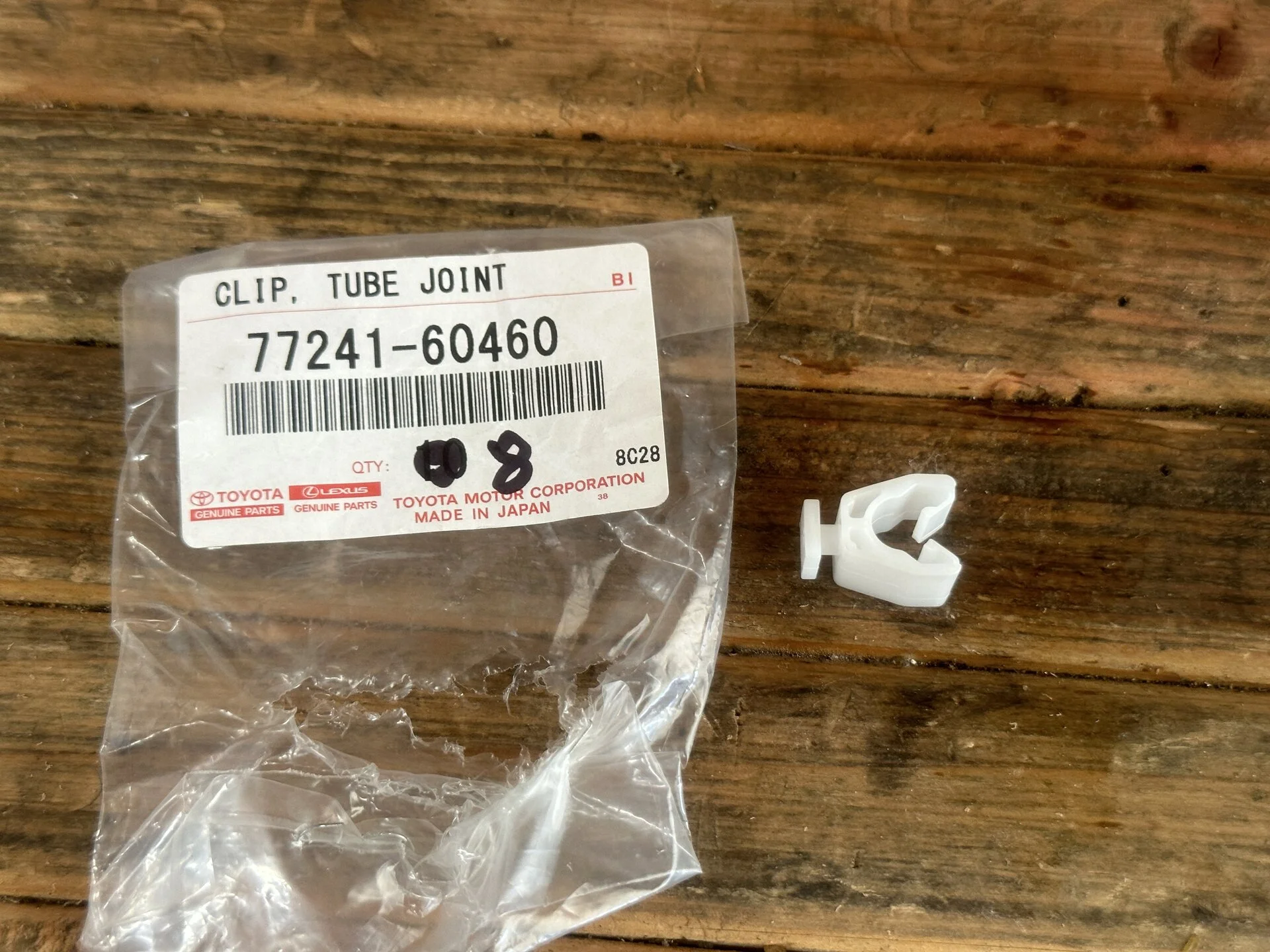

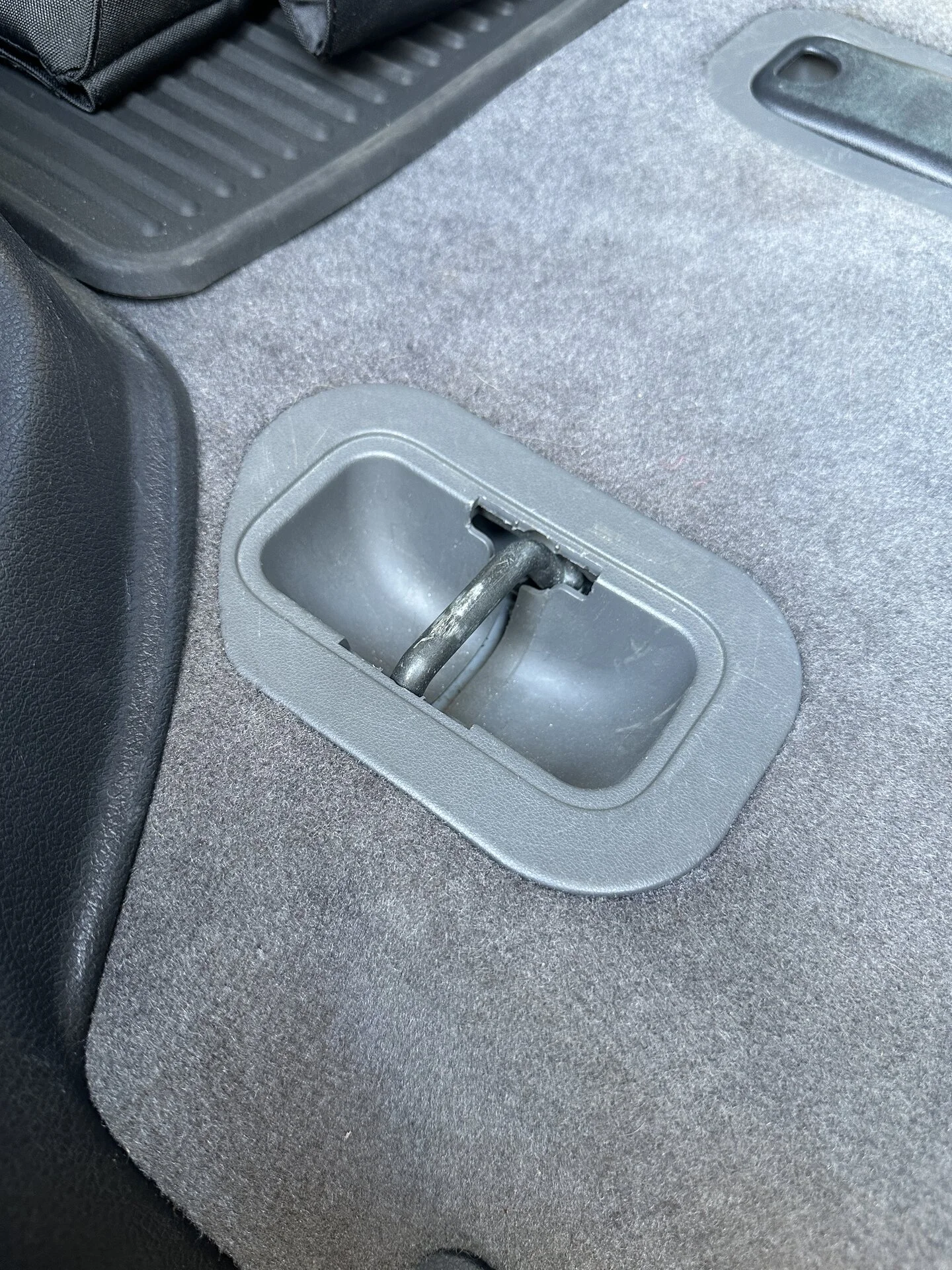

Seat anchor loop trim clip. 77241-60460
If you ever lift the carpet you'll need to pull the anchor trim, and these often don't let go without a fight.
