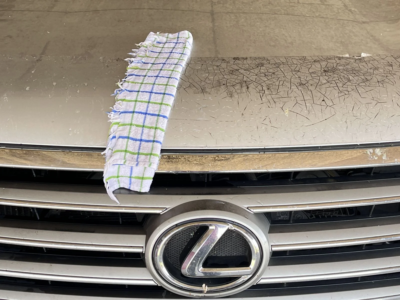

1. Lay double or triple folded soft dish towel on working area and pour boiling water (from an electric kettle) over the towel.
2. Leave towel for 10-20 seconds and pour water on it a few times. This forces the PPF to loosen up.

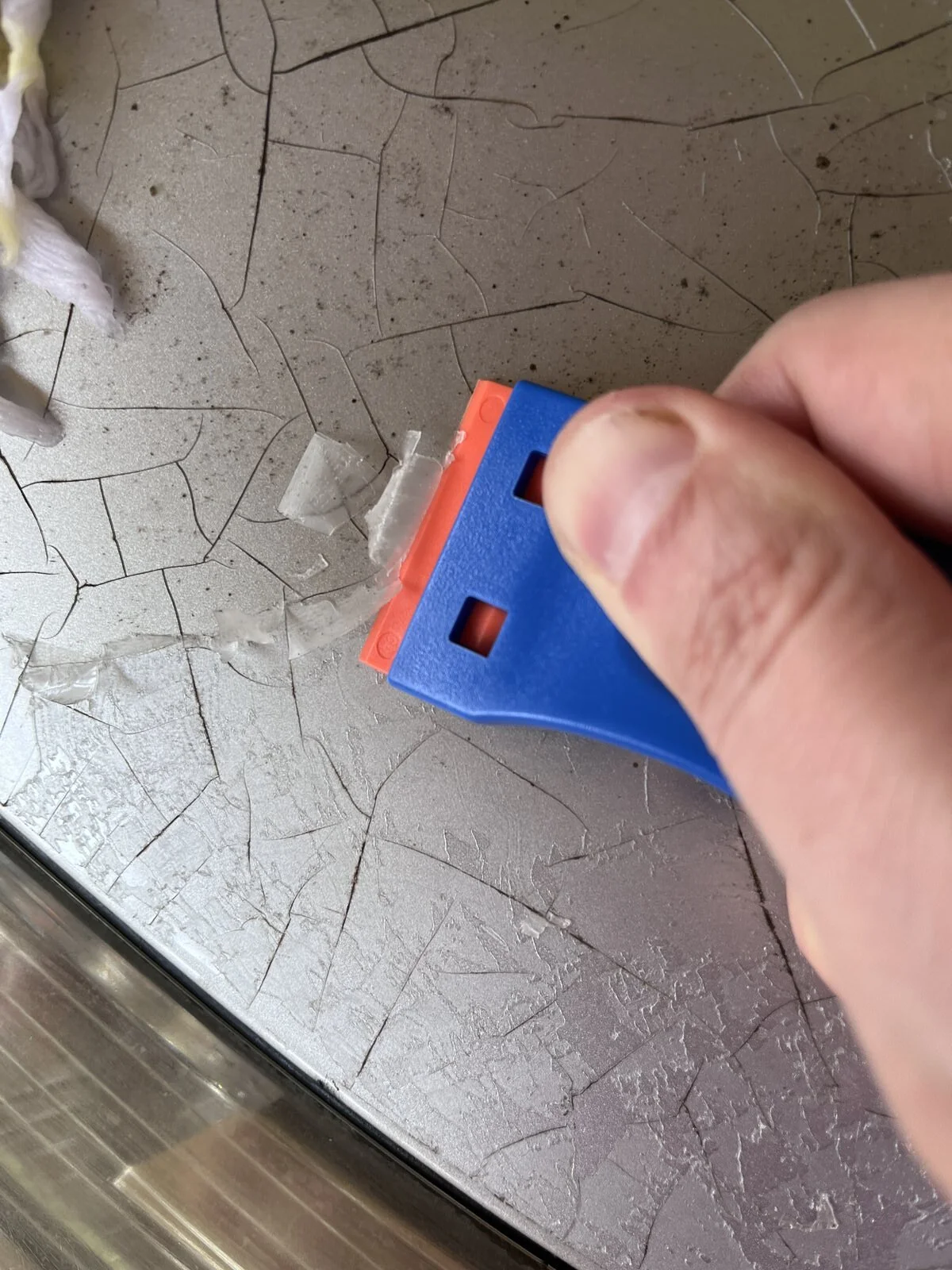

3. Use a plastic razor blade to lift the PPF. The key here was to use a 45 deg or greater angle and work from bottom to top in a straight line using full body weight. That was the most efficient movement / technique that really helped it go faster. This will leave residue in some areas - it's unavoidable.

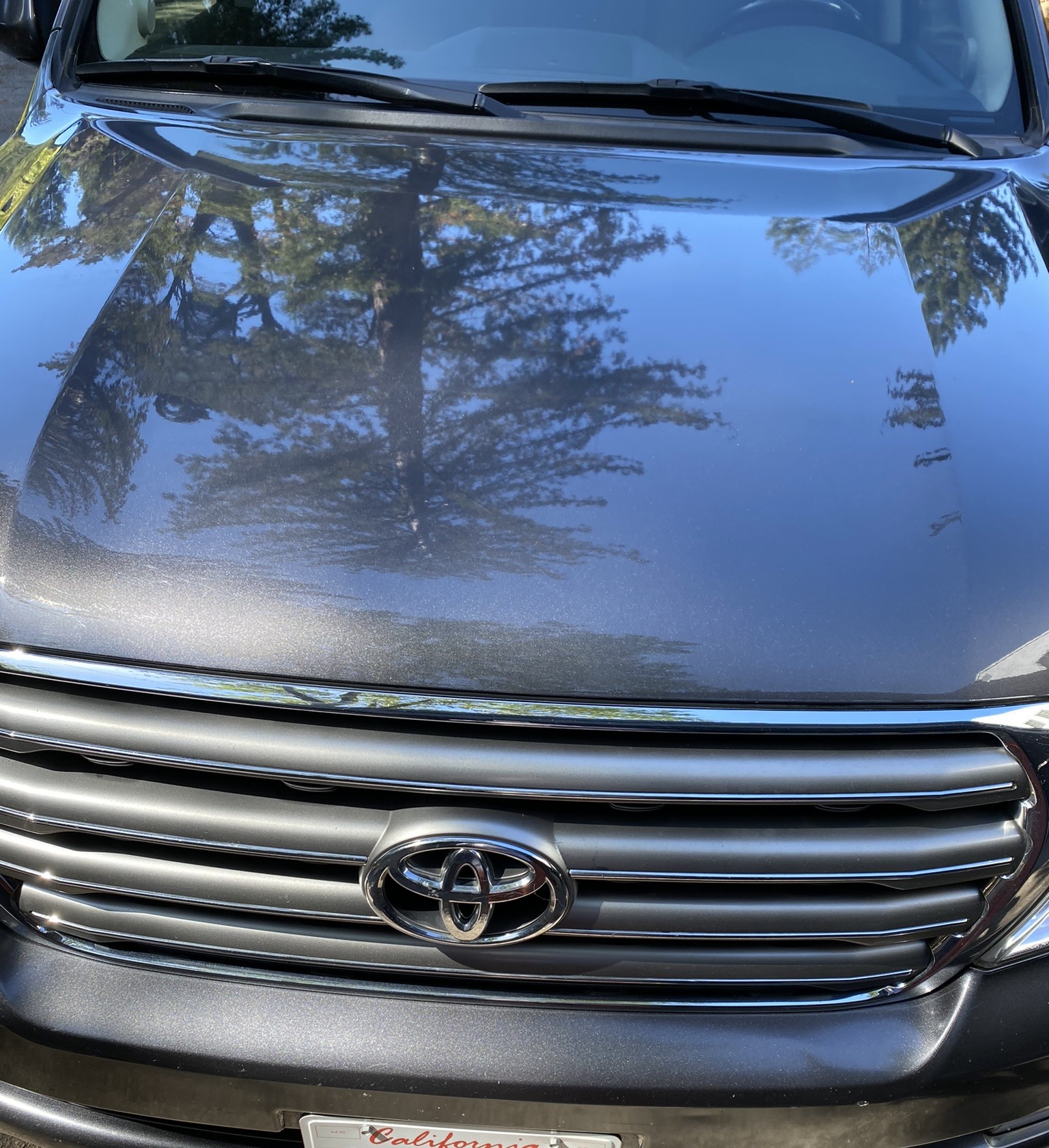

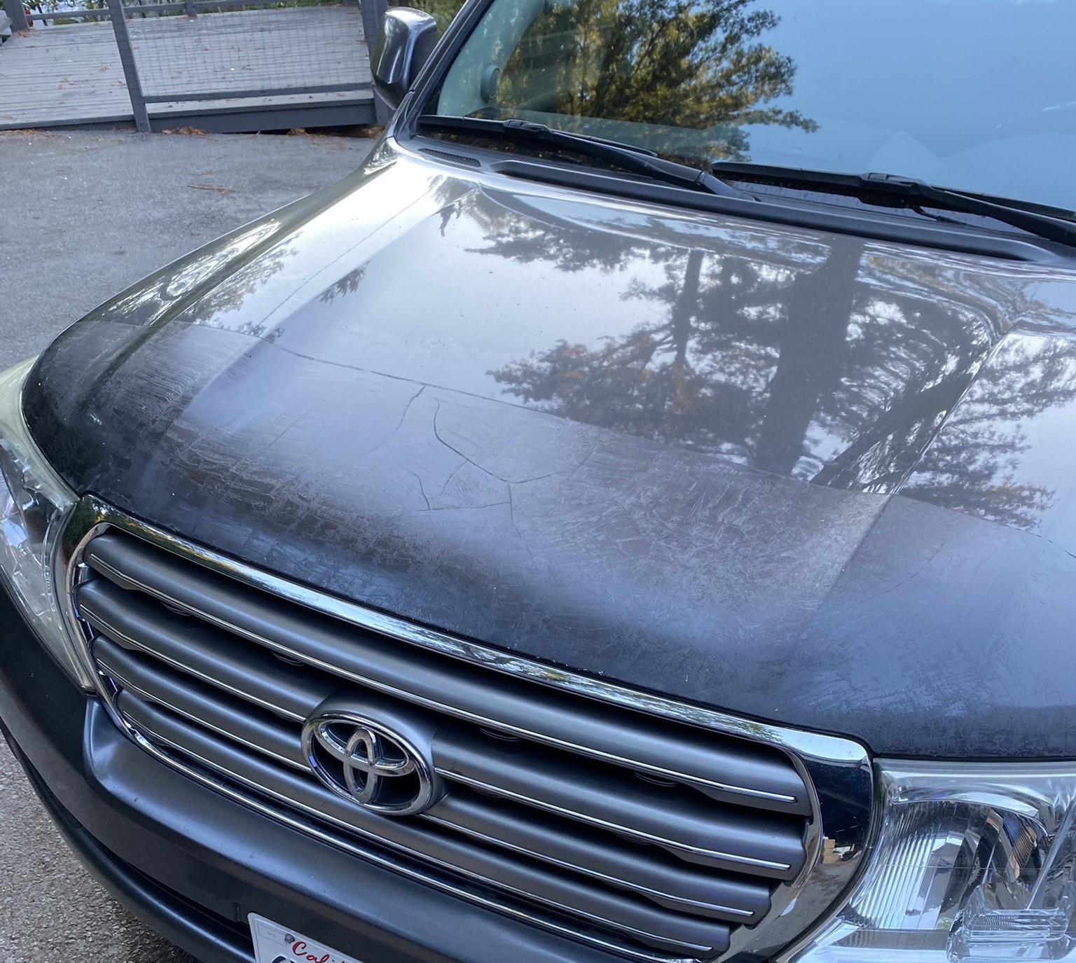

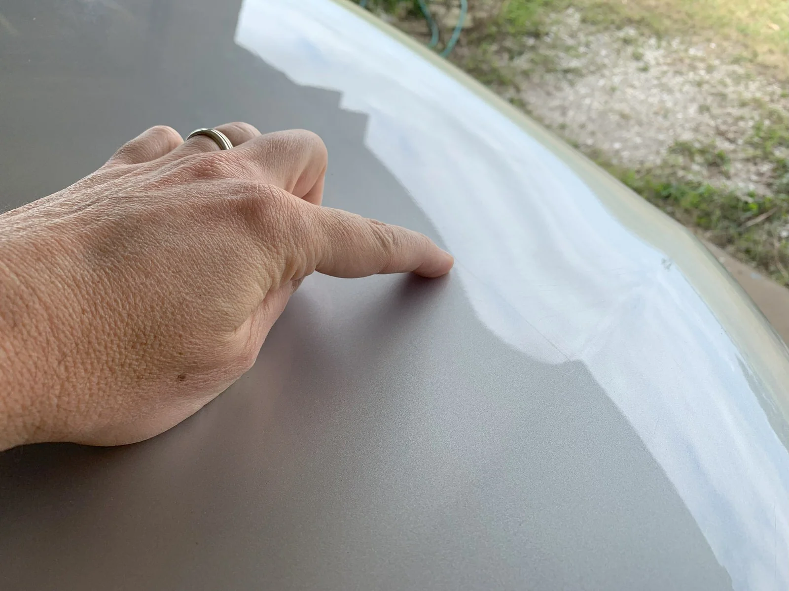

This left no marks, swirls, scrapes, etc. There is a very very faint line from the PPF edge which I attribute to fading of the paint/clear coat beyond the PPF. I am planning to buff the entire car and am curious if the rest will match the PPF area at that point. As you can see from the photos, it is back to factory. I got a heavy discount on this car because of the PPF and I have to say, I was very surprised it only took a day of solid work to restore. I was expecting days and worst case, damage from the process.
From start to finish:

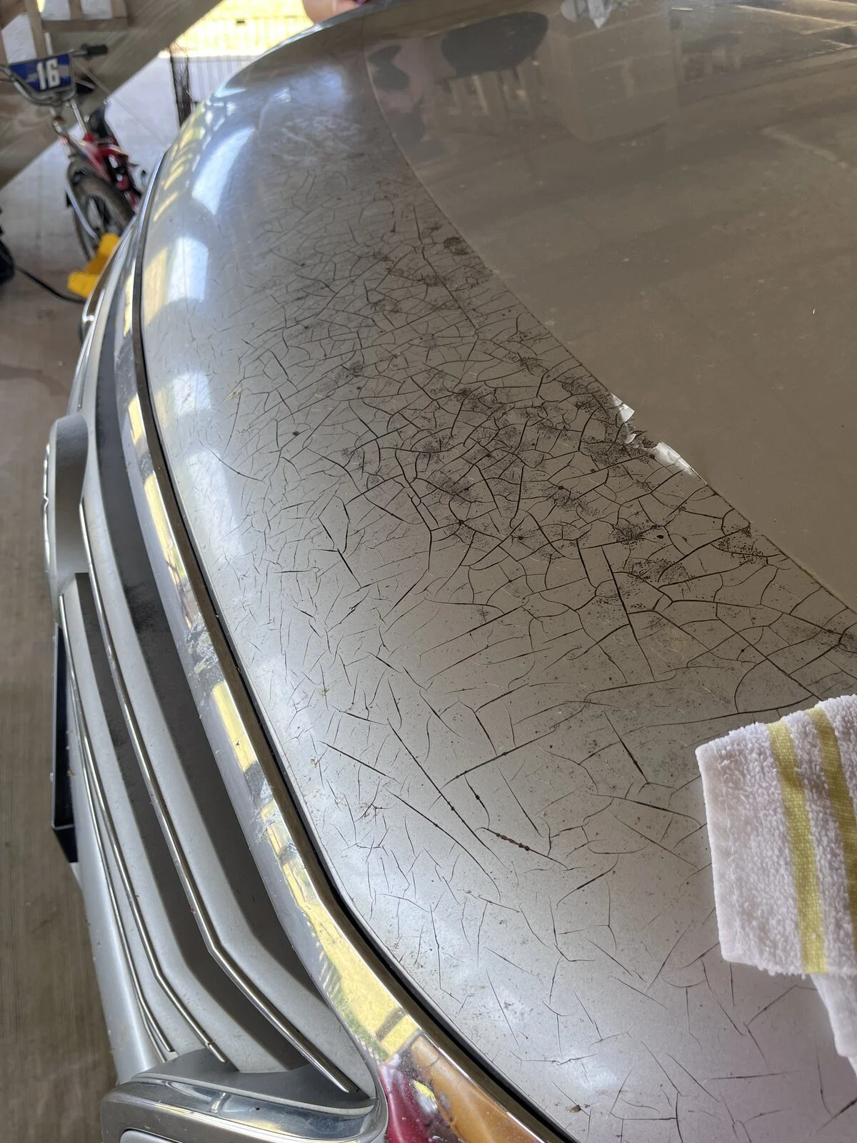

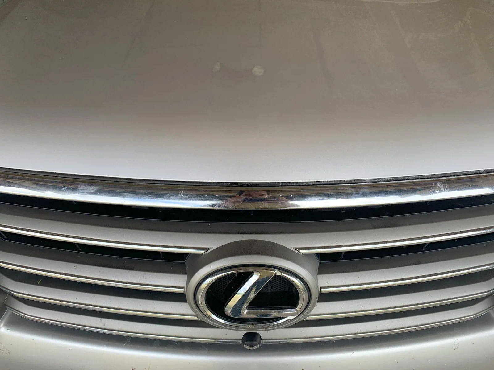

With PPF. This was the worst condition area. We had tested a bit without any preparation, hence the peeled up bits.

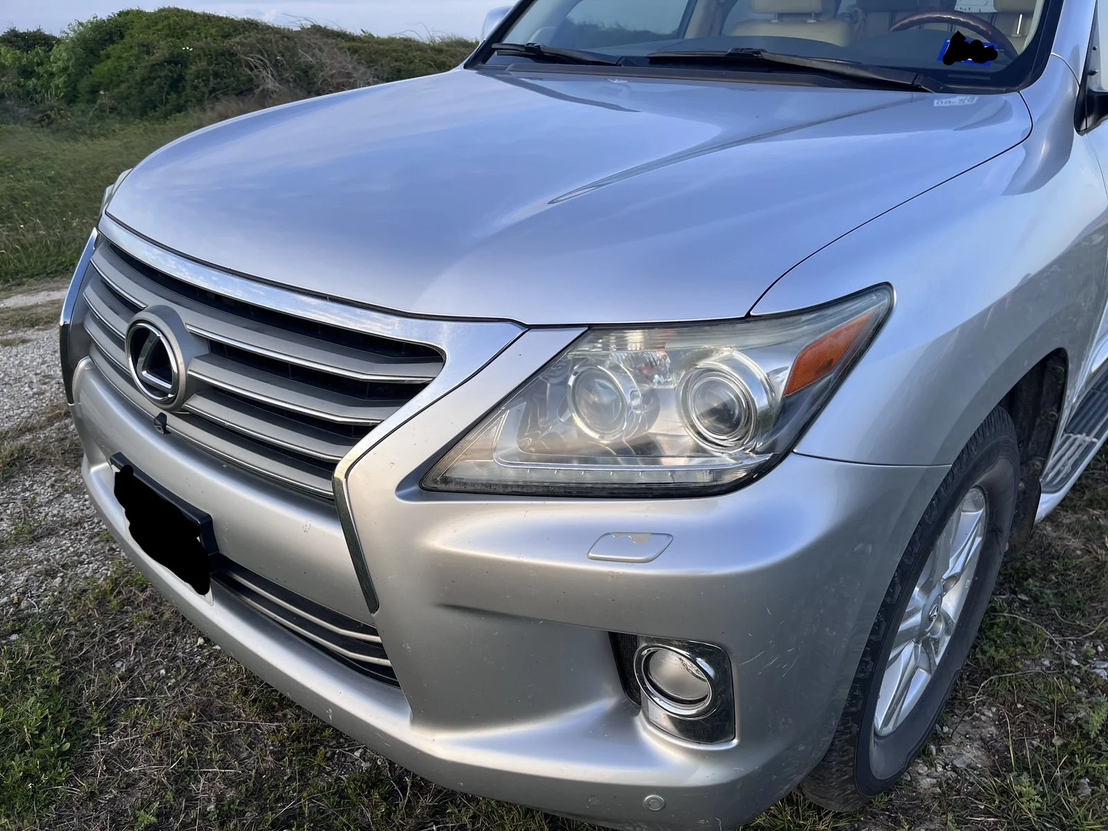

Side view

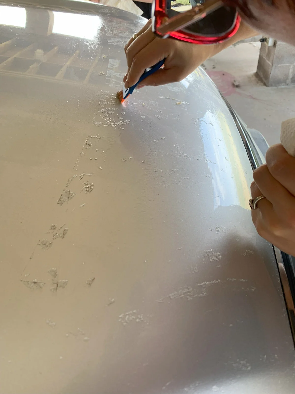

Working the PPF prior to my wife discovering the method/technique of holding it more upright > 45 deg and moving up in a line. Here I was just going at it but splitting the PPF in half, leaving a ton of residue. If you can get under the PPF, a lot more of it will come up clean. Not easy but doable.

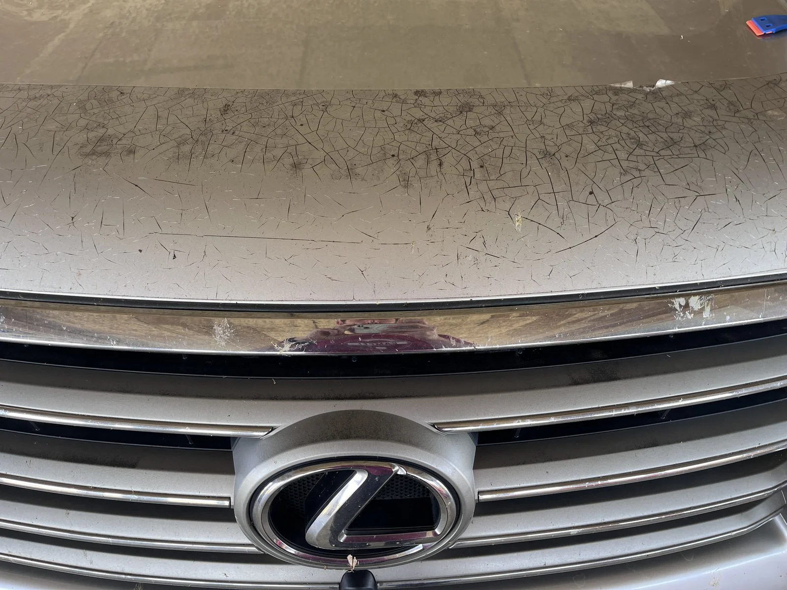

Left side shows PPF mostly removed with residue (the hood is not all pitted/marred - it's just a reflection of the ceiling)
Mostly all removed with residue (weird white blob in center is a reflection of flood lights...)

Finished product! This is a silver hood but the color is a bit warm...
yes, it is the same vehicle..... incredible.
a very very faint paint fade line visible at certain angles in certain light. not a concern at all and due to the PPF preserving the paint.
