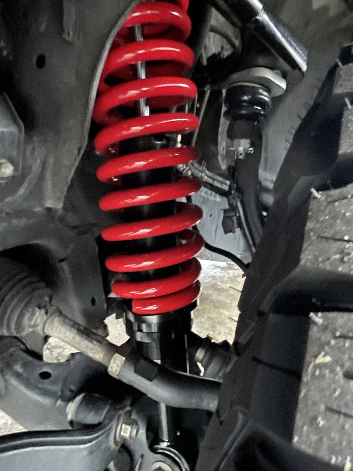

Got the Dobinson’s lift installed on my son’s 200!

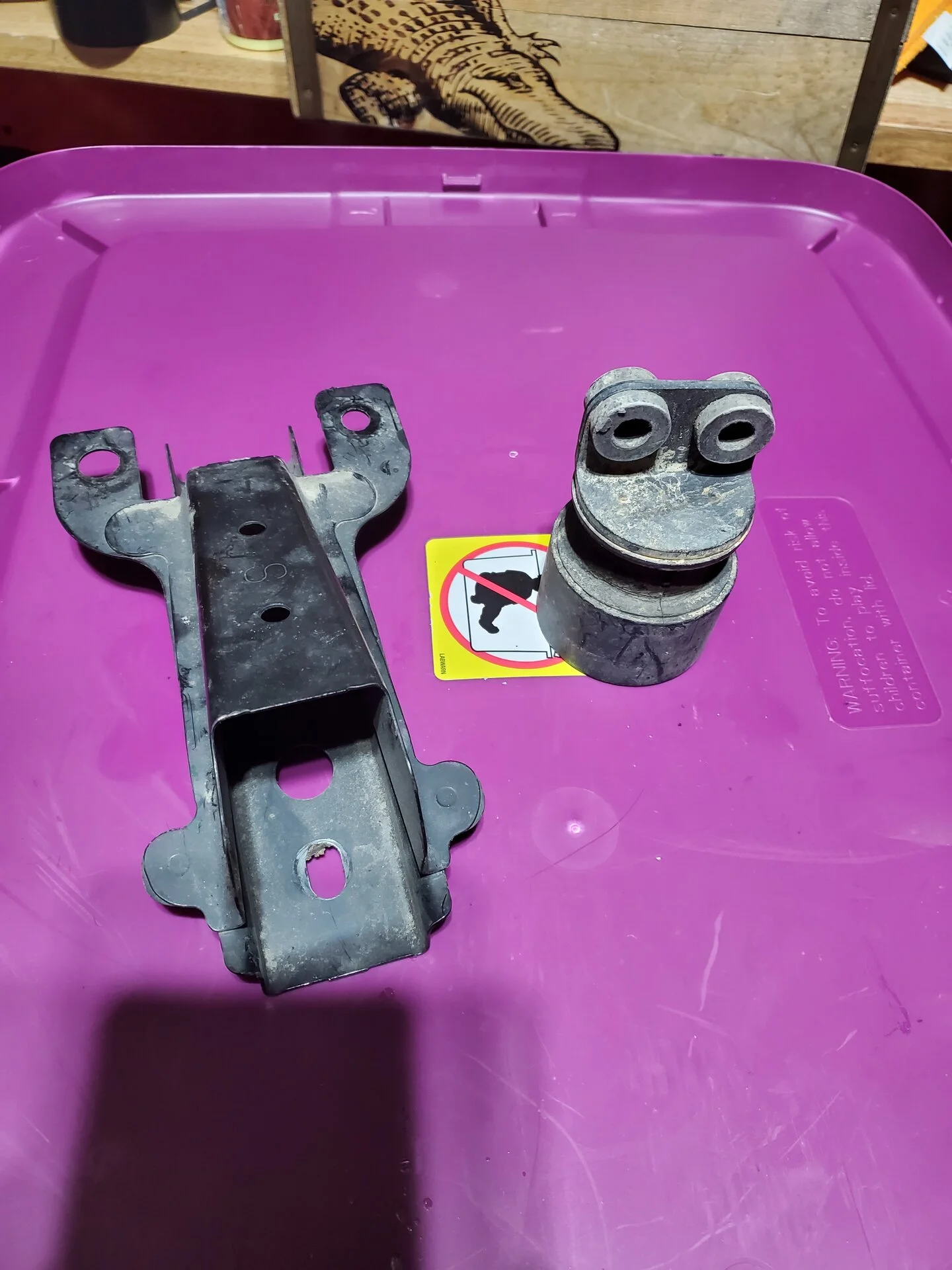

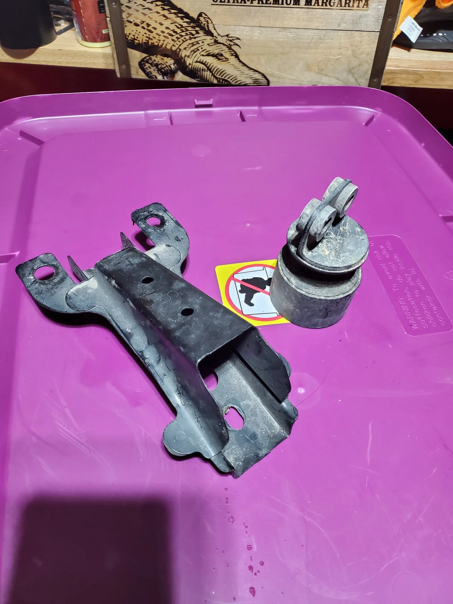

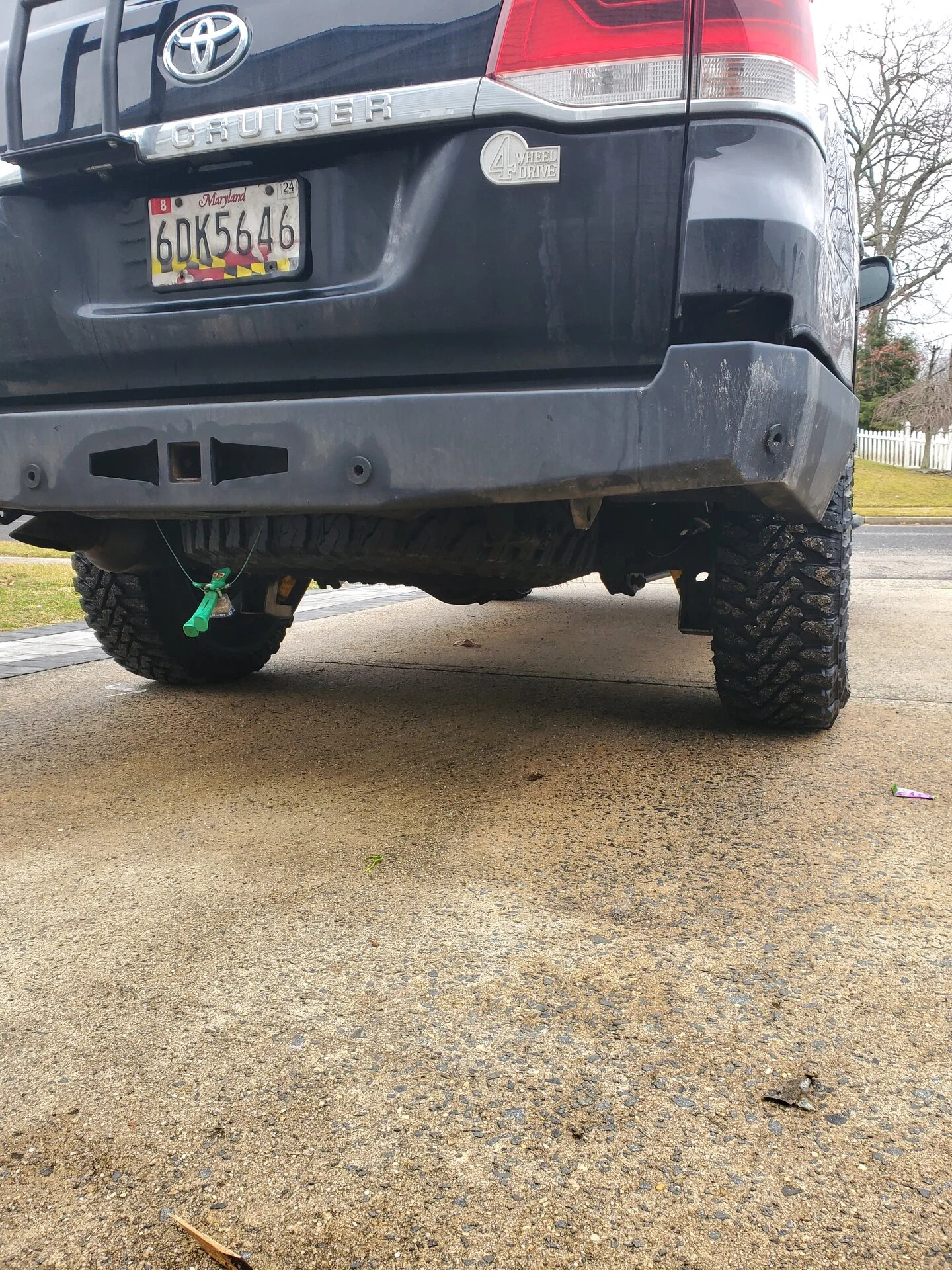

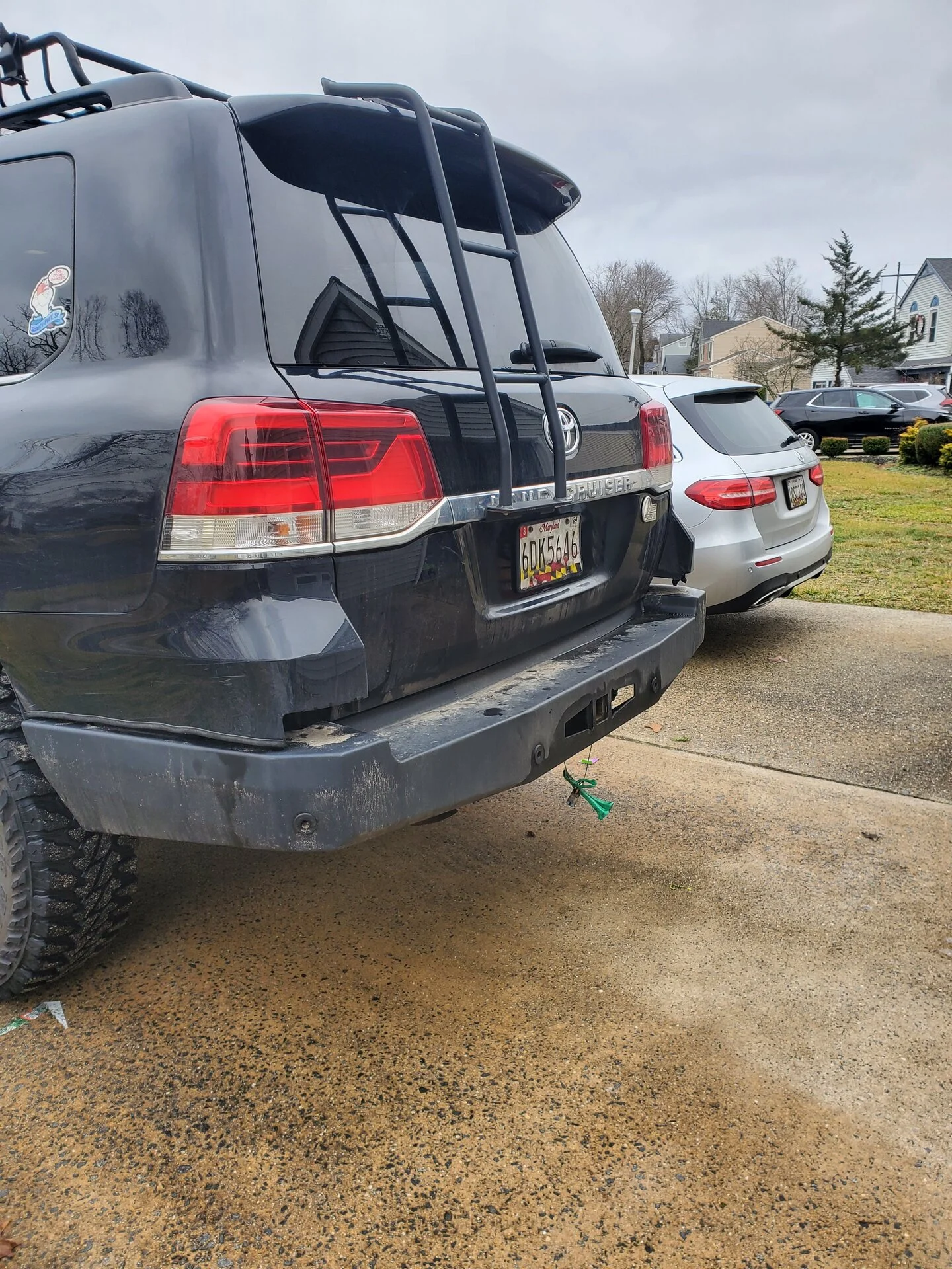

Moved the spare back to the stock location. The Wilco was good to me, but reality is I don't need it right now. Method 314 17x7.5 with Yokohama geolander mt 285 75 17 fit back with no problems. Had a few pieces left over, 99% that one is a guide for the mechanism for lowering the tire....the other one im not sure. I'm guessing these weight savings will improve the MPG phenomenally. Many thanks to @achris44 for taking the time to get me everything.

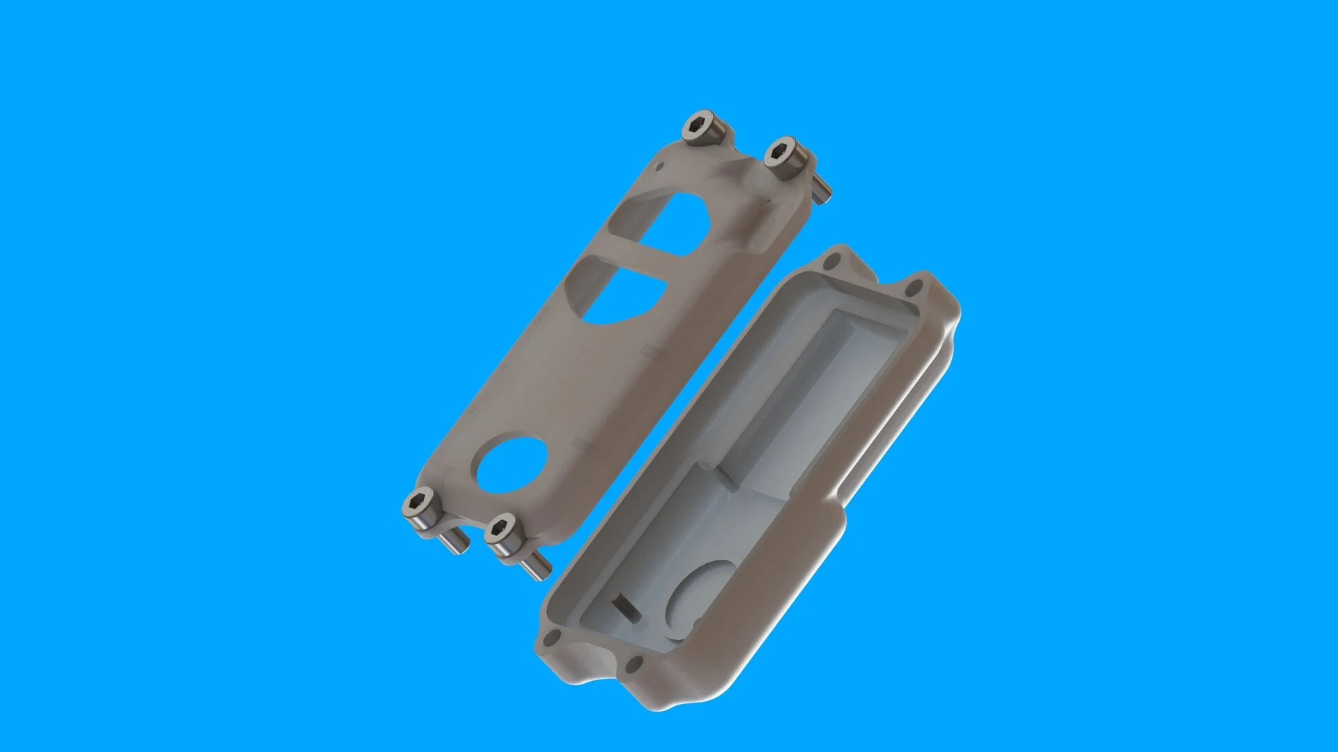

Project of the morning.
I wanted to find out if I could design a slimmer cover for my smart key and then print it.
I deliberately left out the key and a flap to keep it as slim as possible.
The first test in PLA went well and next it will be printed in PET-CF.
Bit of measuring, CAD two test prints and I had two hours later some kinda final design.
Still some small details to fix but so far I am happy with.
View attachment 3513787View attachment 3513788
Any update on this project? Also mind sharing the CAD files to adjust the key fob for the LX

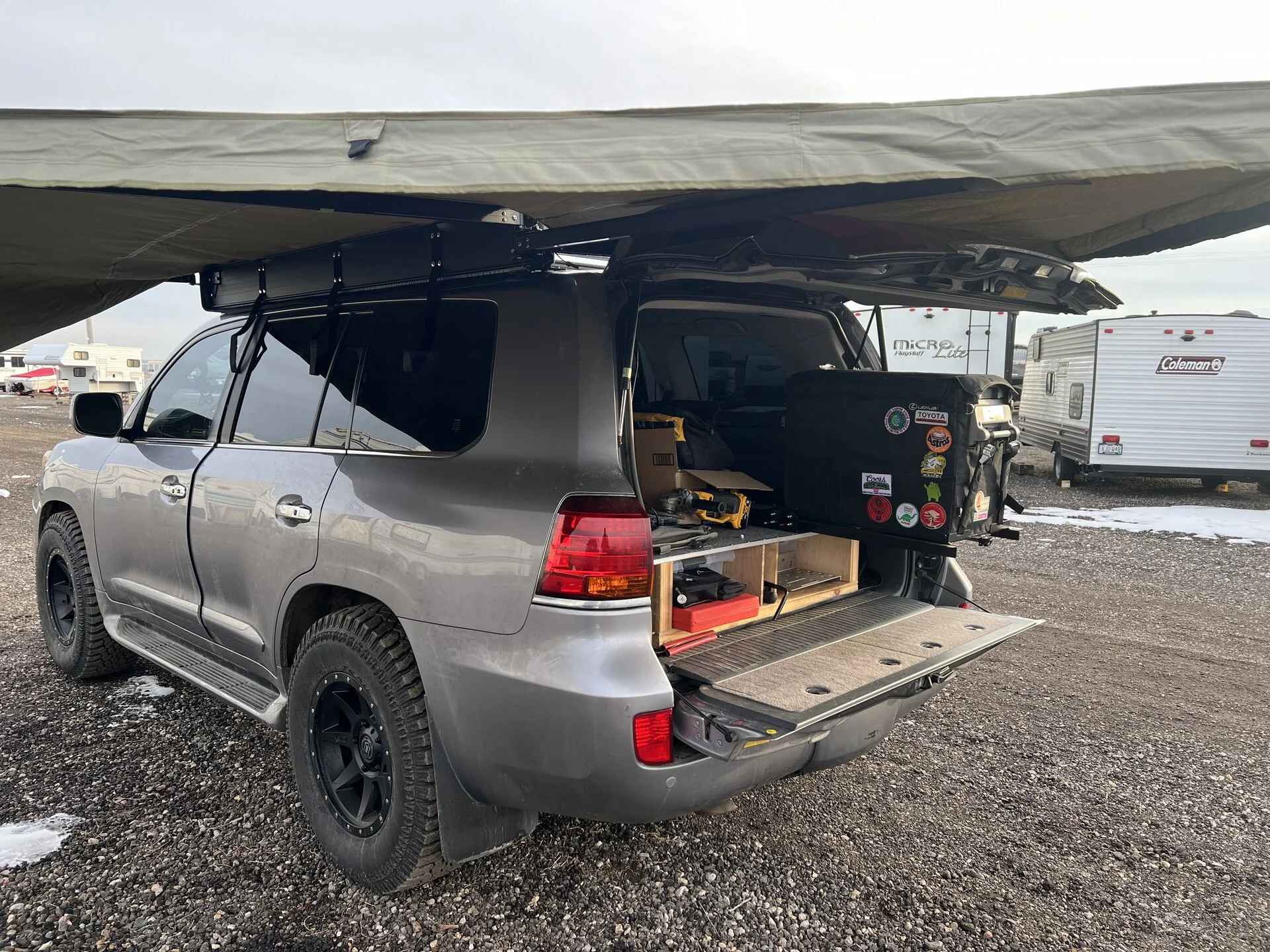

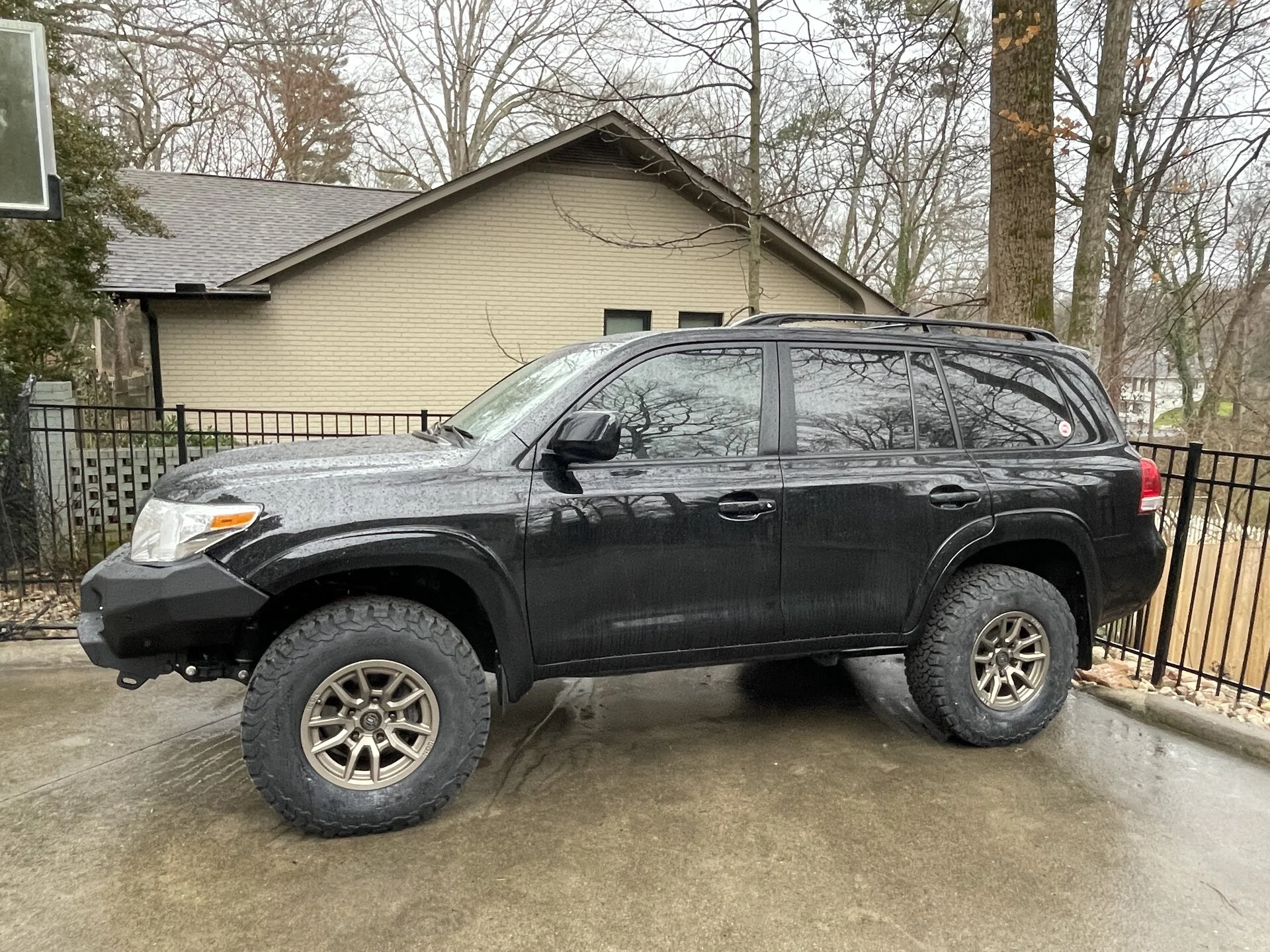

Seen a lot of “Prinsu and Ironman 270’s don’t play nice” but when I could pick one up for less than a normal awning, had to take a shot. Fits like a glove with the rear tab on the Prinsu chopped off, trunk spoiler impinges a little on the fabric but not a deal breaker. Never had a bad time with beers and an angle grinder.

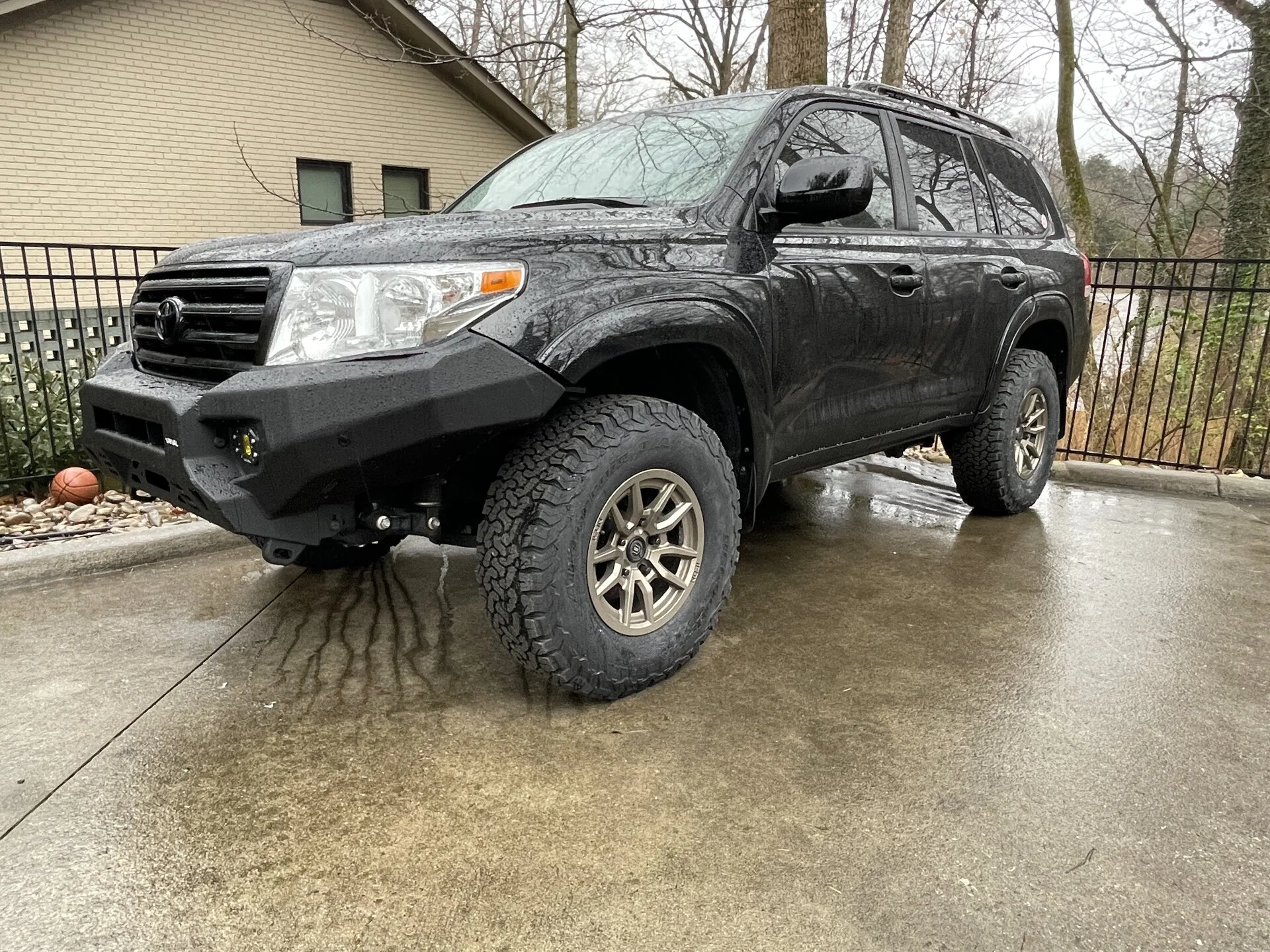

Nice rig! What size tires are you running?
Ha! Yeah man, I’ve been all through that thread and have that size in mind for some Yoko G003s. Can’t tell from your pic but were you able to stuff that size in as a spare? That’s been my biggest concern as the G003 are 34.3”.
I was, though it's close, to be transparent. Haven't measured yet, but mine probably measure 34.5+, where some folks have seen it get tight. As a result, I deflated mine to ~15psi (run 36 on road) as I'd anticipate a higher likelihood of needing the spare offroad. Plus, my compressor is always onboard so inflating on road wouldn't be an issue. That slight inconvenience is well worth the additional function over my old 32/33's.
Sweet! Thanks man! That’s all the confidence I need to pull the trigger!

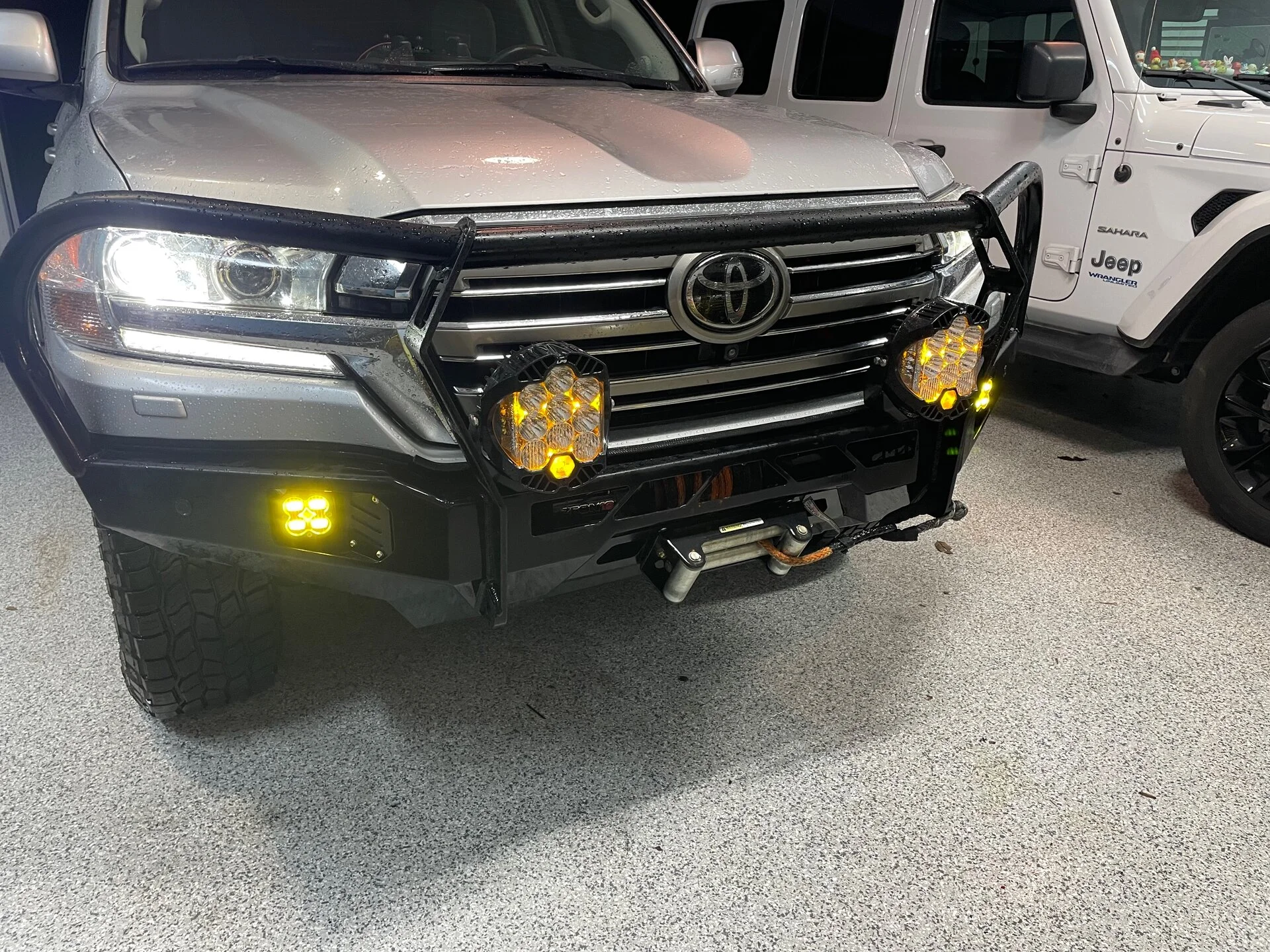

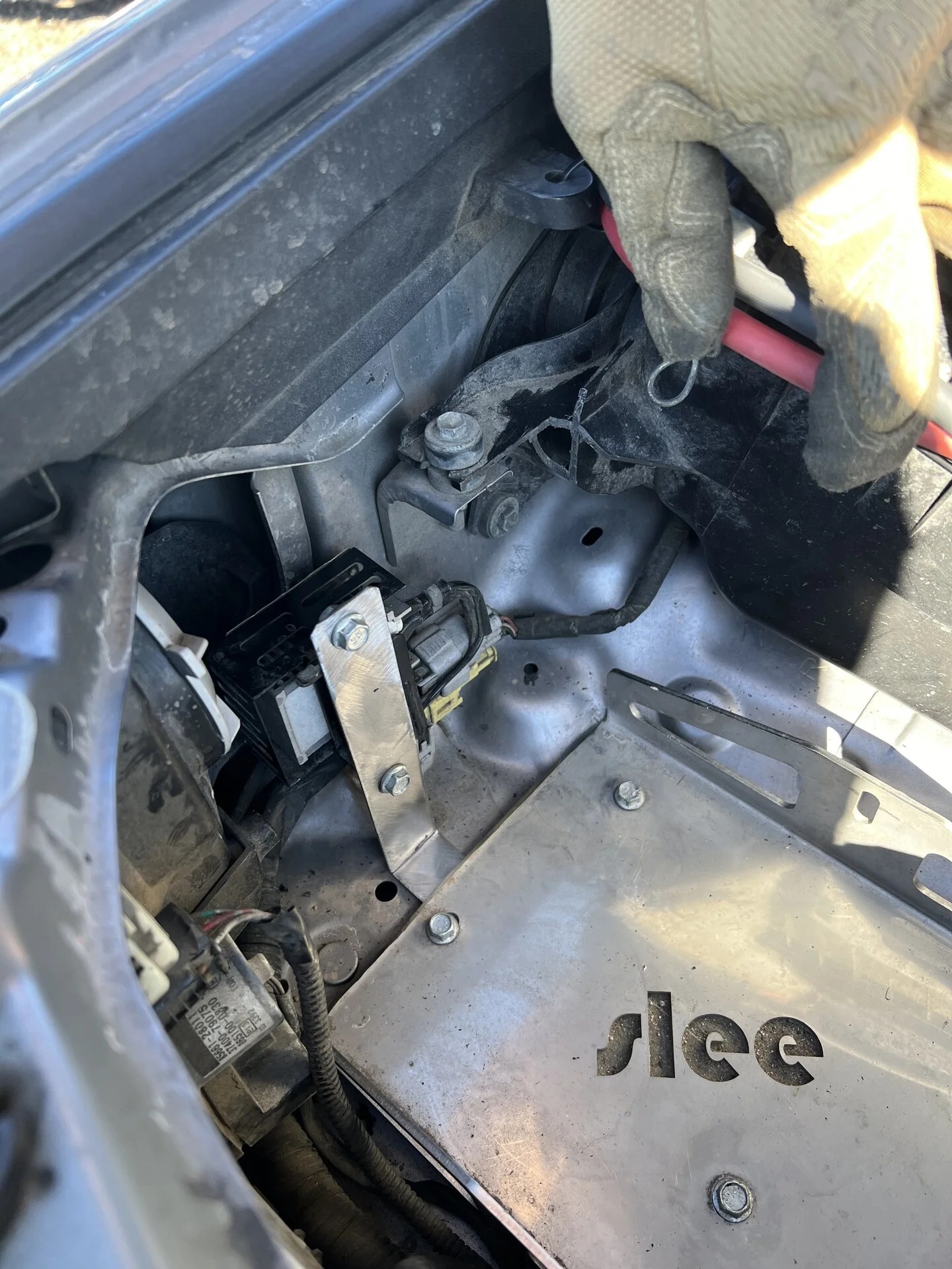

Moved my Baja LP9's over to the 200..
this bumper is super tight, so I reversed the brackets to push them out a bit for clearance.
Finishing up switch wiring for these and the rear Baja's
Couple of projects left to do and it's done for now... (Kaon shelf with large molle (?) and Bud Built rock Sliders).

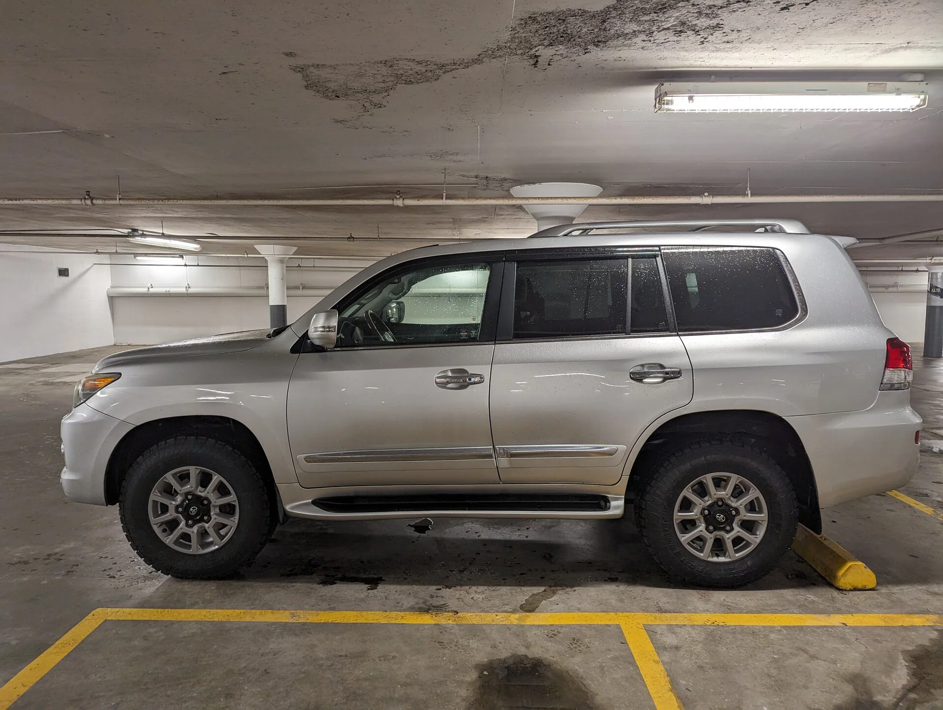

Long time lurker, howdy everyone.
Finally got my new tires...Toyo AT3's 275/70/18. Tundra Off-Road 18'' rims (powder coated), everything stock for now.
Will be doing front sensor lift soon, got the front spacers already.
First pic is in H, second pic is in Regular/comfort mode.
Really wish I did some more research and got wider tire. The stock LX 20'' rims were 8.5'' width, these Tundras are 8'', I personally like a more flush look. Will be riding on these for awhie before I ''upgrade'' to a 9'' rim.
Eventually get my tire width back to 285's as well but for , it'll do for me.

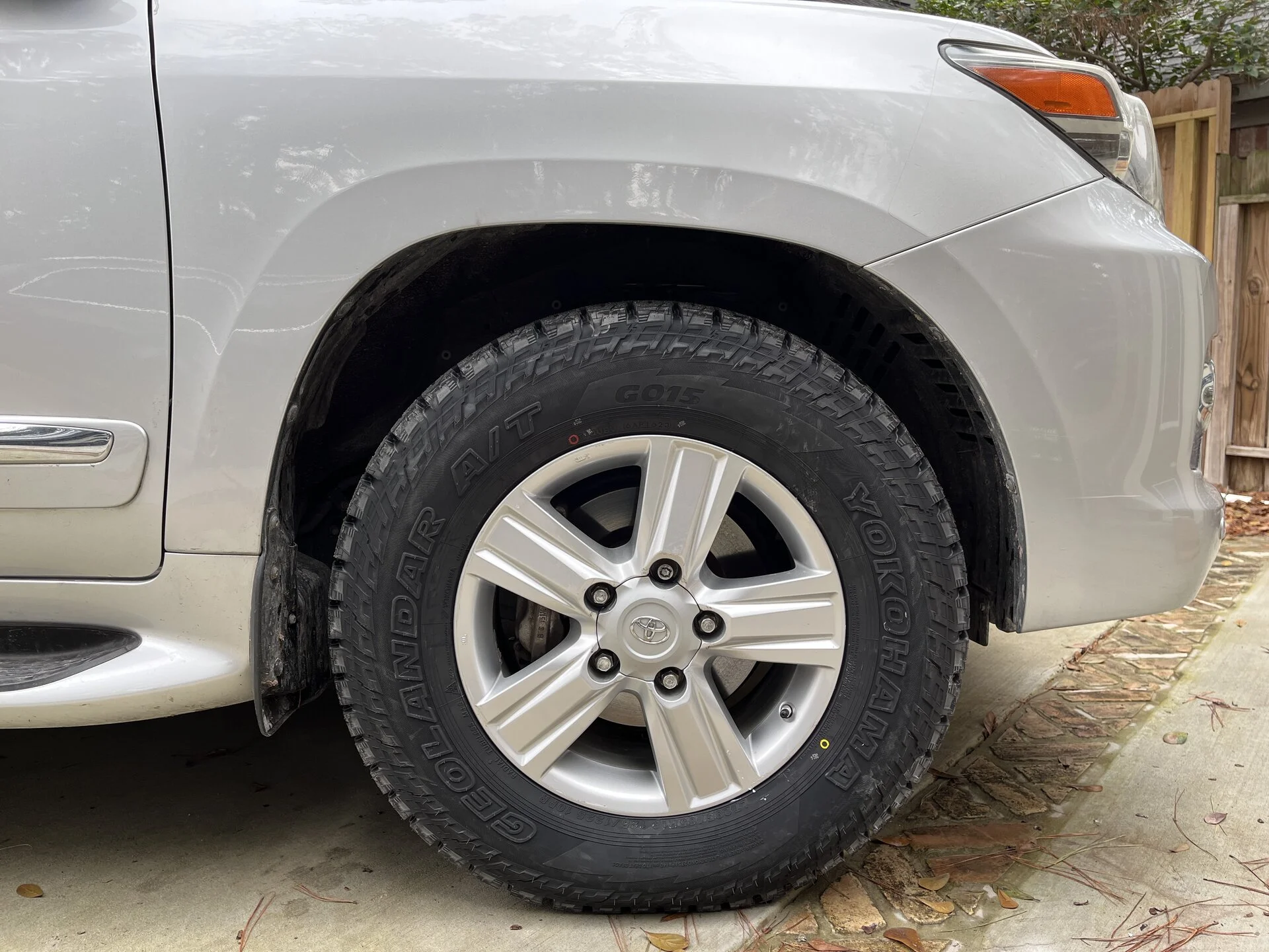

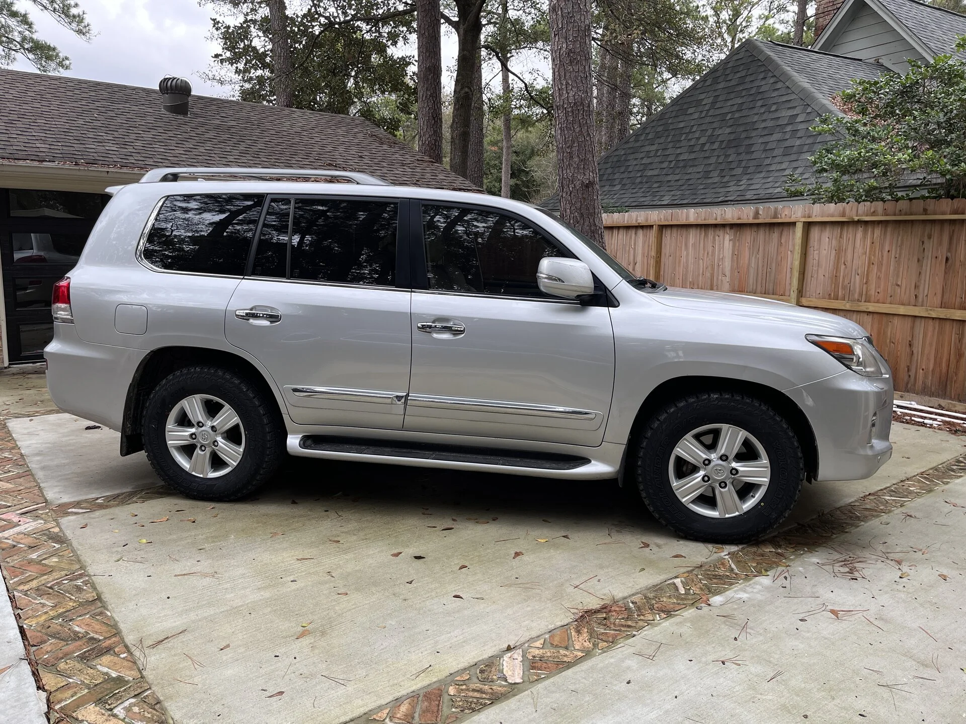

Swapped stock 20" wheels with LC OEM wheels and Yokohama Geolandar A/T G015 LT 285/65 R18 for a perfect fit (note mechanic adjusted camber a bit in anticipation but I'm unsure if it was necessary). More info and pics here. Guess I'm a minority in that I like the LC OEM wheels.

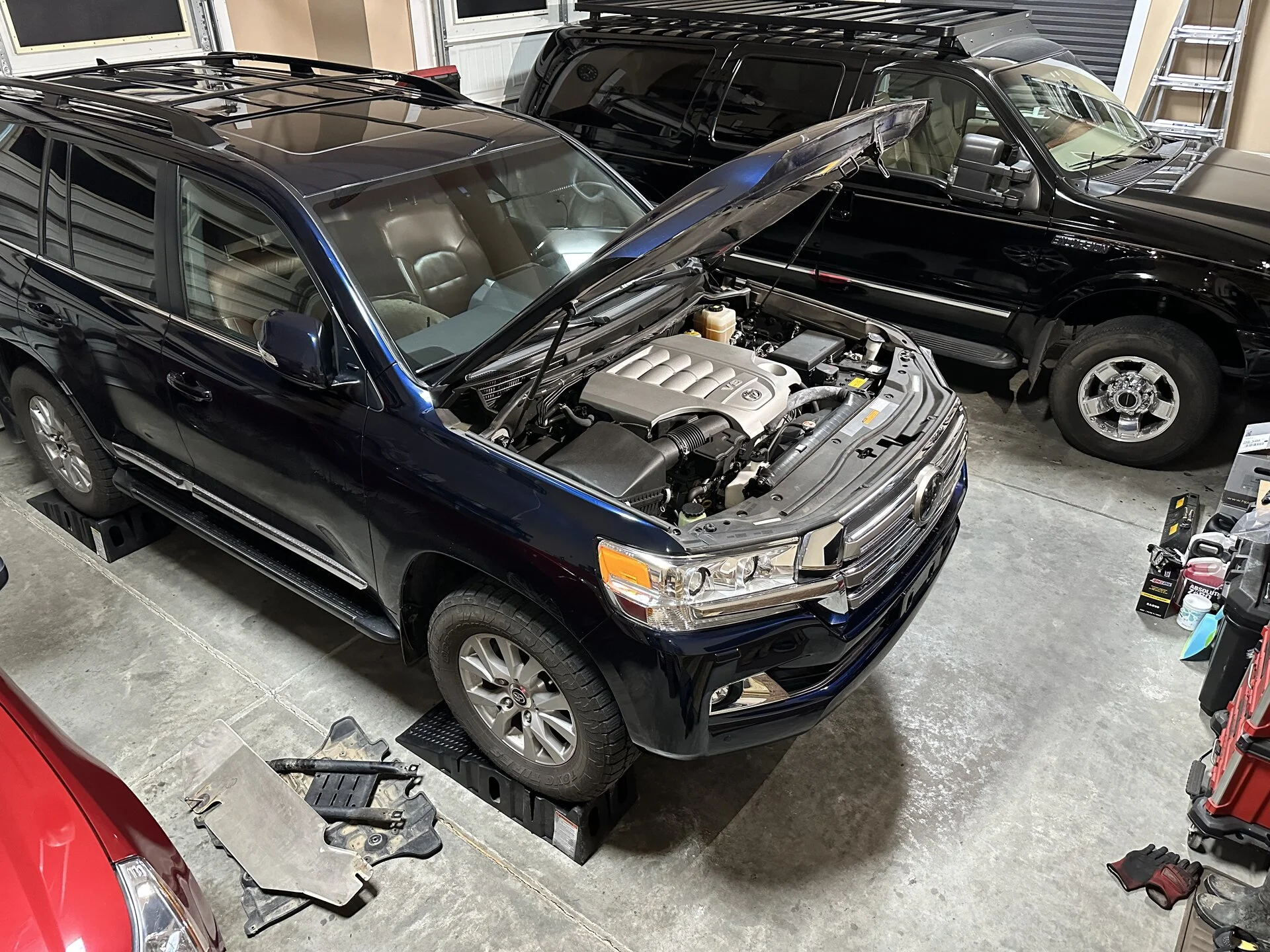

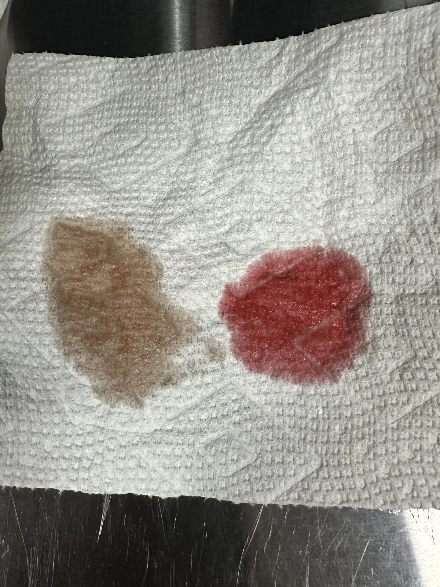

Did full ATF exchange on the ‘18. Cruiser had 80,000 miles. Looked normal for that mileage. I did an ‘06 100 series with 195,000 miles on original fluid yesterday… what a difference a full exchange made to that one. But the ‘18, well that’s just routine maintenance.
