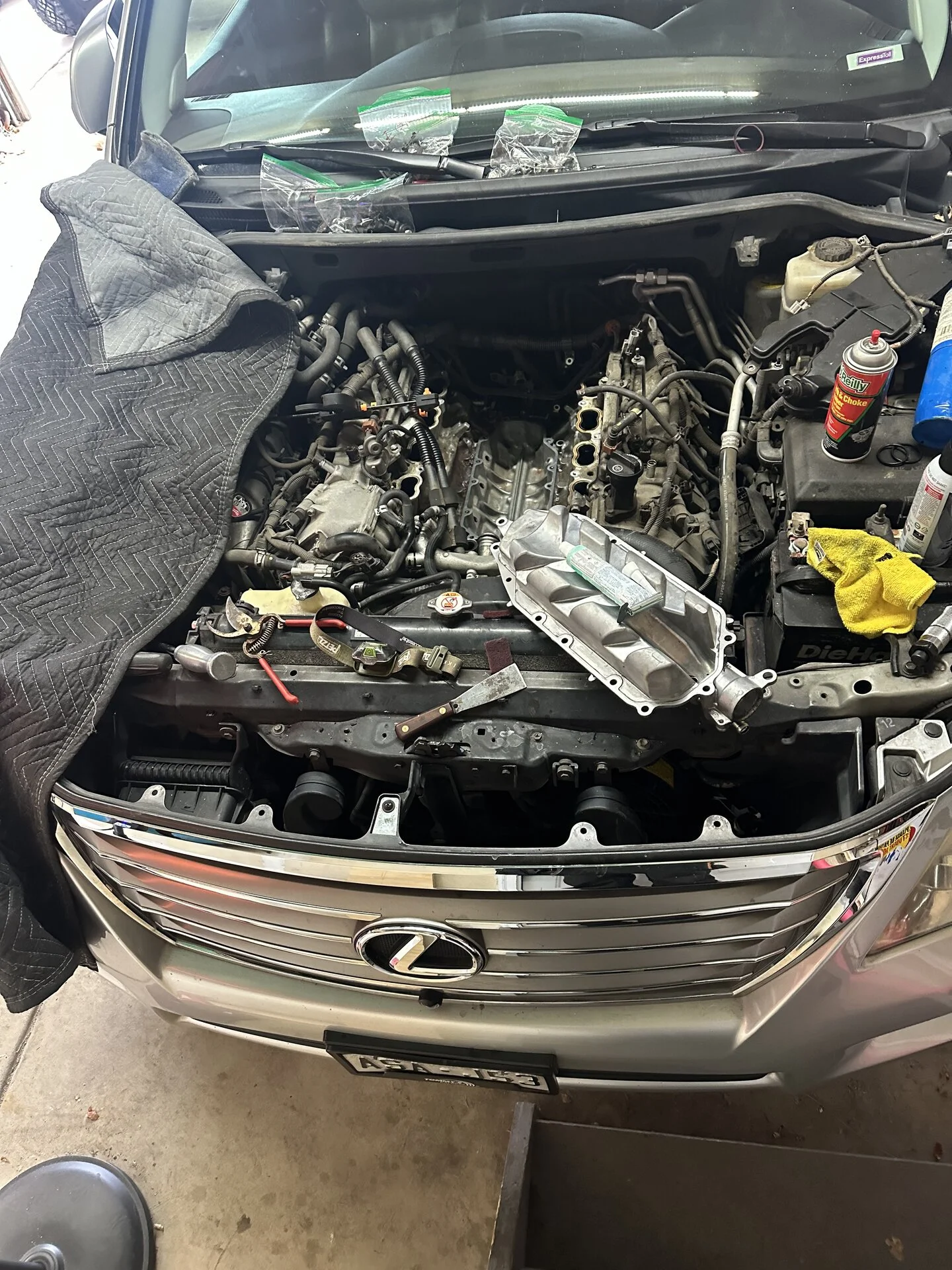

I tackled the valley plate seal this weekend. 177k

I have 2 vehicles that need this remedy. How bad did it suck?
Wasn’t too bad, the egr pipes on the firewall were tough to get to. I loosened the driver side first and pushed the pipe out of the way. Then moved air pump to that side enough to loosen the pass side. I used an S wrench for a couple of them.

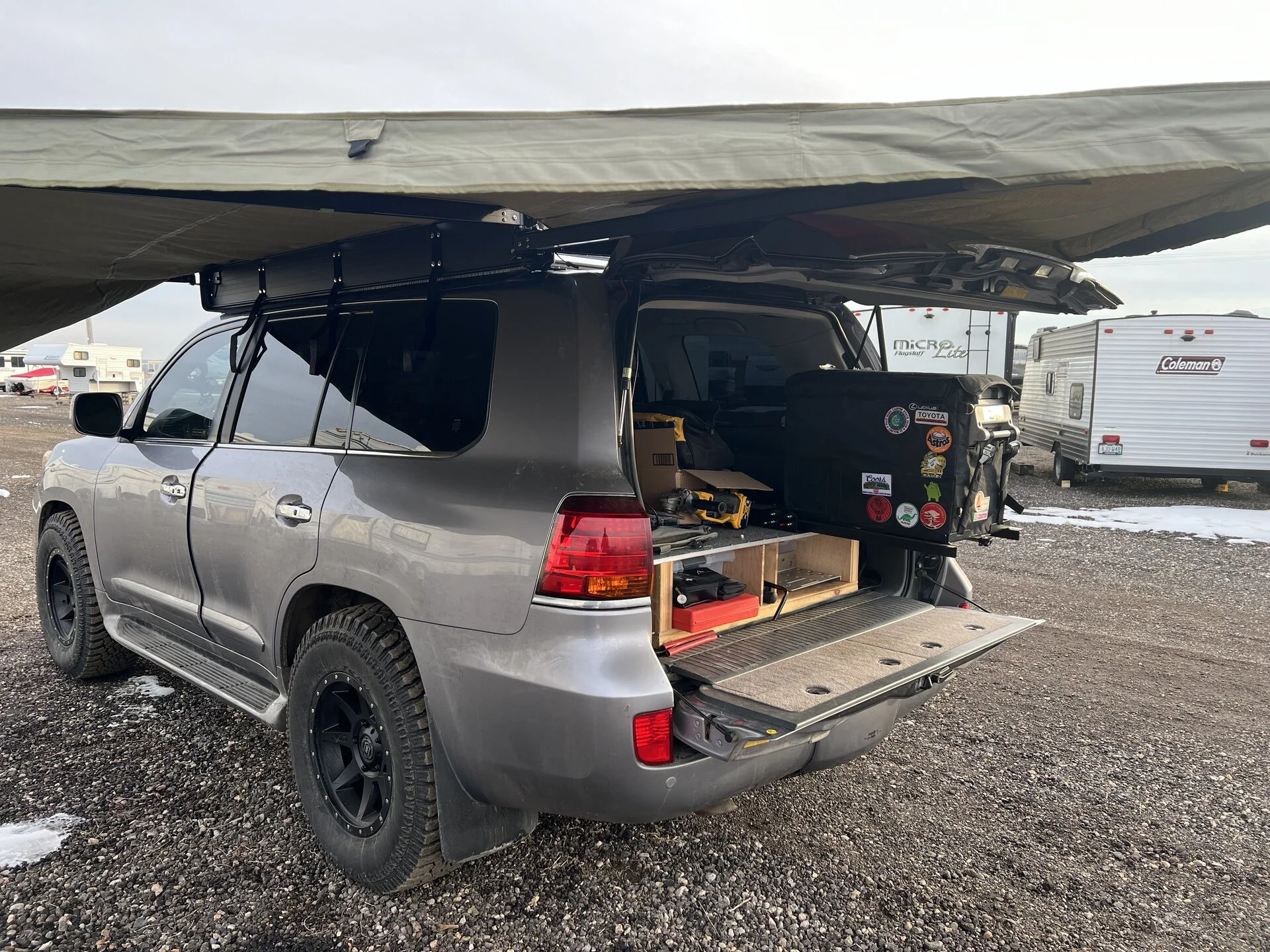

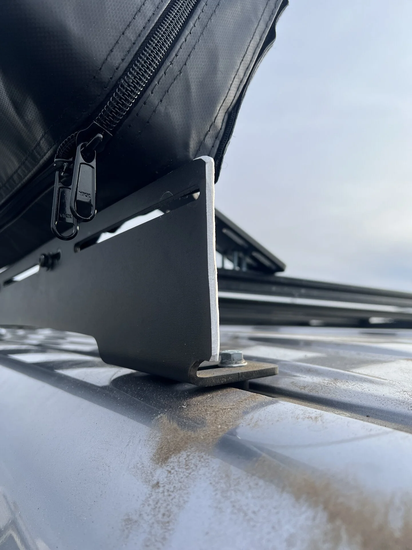

Seen a lot of “Prinsu and Ironman 270’s don’t play nice” but when I could pick one up for less than a normal awning, had to take a shot. Fits like a glove with the rear tab on the Prinsu chopped off, trunk spoiler impinges a little on the fabric but not a deal breaker. Never had a bad time with beers and an angle grinder.
