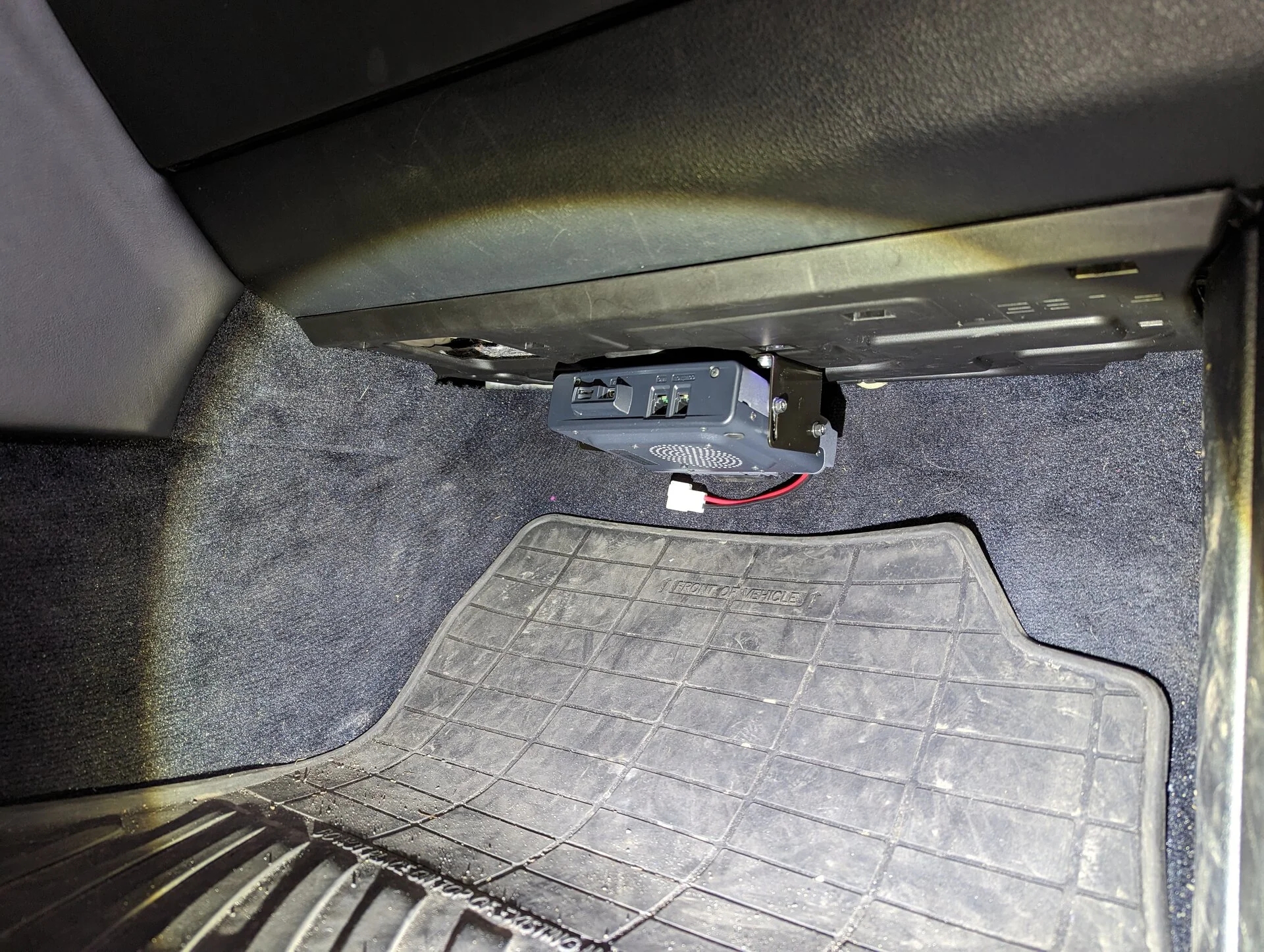

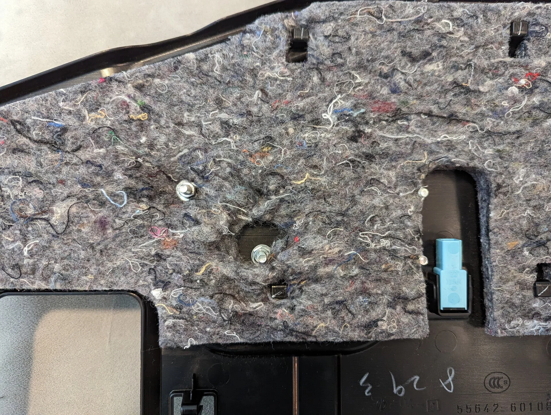

Started radio installation -- Yaesu FTM-400XDR in a 2018 LX570.
The location options for the radio body seem a bit limited (unless you want to go full remote install). I couldn't find many examples of what others had done, so I thought I'd document my attempt to put it on the passenger footwell access panel. It's nicely out of the way, but it remains to be seen if the location is a good idea or not (I think the panel may be okay holding the weight, but that remains to be proven out).
Probably won't get to finish connecting everything until later this week.

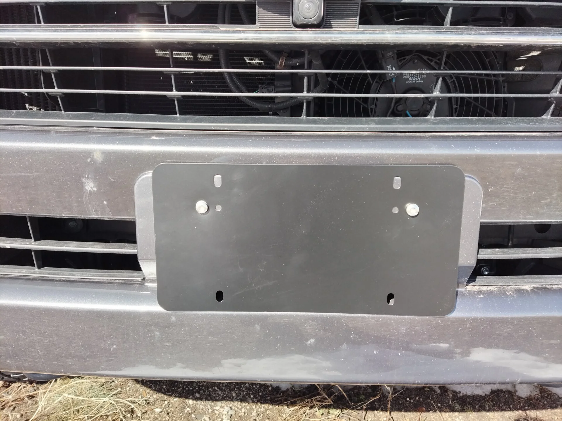

Mounted my front license plate without drilling holes in the bumper using this plate I found at the local Subaru dealership parts counter.
Subaru part number SOA342L171.

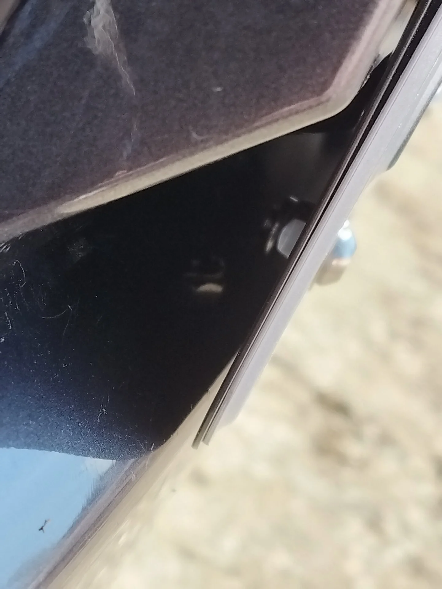

I used low profile Torx machine screws with blue locktite to mount the plate, then mounted the license plate using the bottom holes with allen head button head screws, backed with nyloc nuts. All hardware used is stainless steel. I was worried about clearing the plastic behind the plate, but ended up with enough clearance without anything touching.

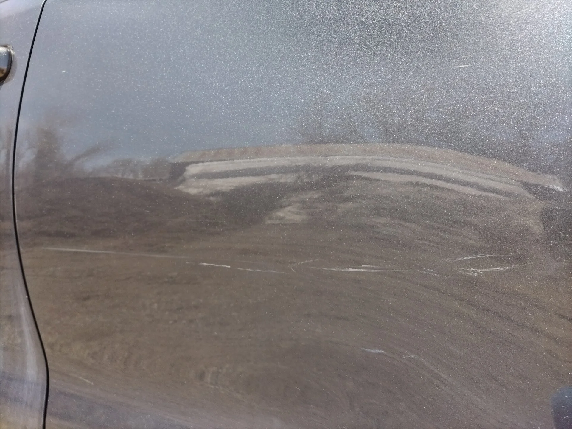

And I discovered this just the other day. Wish I could have caught the idiot who caused it.
This why we can't have nice things.
Mounted my front license plate without drilling holes in the bumper using this plate I found at the local Chevy/Subaru dealership parts counter.
I'll follow up with a part number.
Used low profile Torx machine screws with blue locktite to mount the plate, then mounted the license plate using the bottom holes with hex head button head screws, backed with nyloc nuts. All hardware used is stainless steel. I was worried about clearing the plastic behind the plate, but ended up with enough clearance without anything touching.

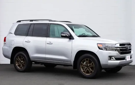

Silver heritages came with the bronze wheels. I'd say to put them on and see what you think. Might look better than you think.

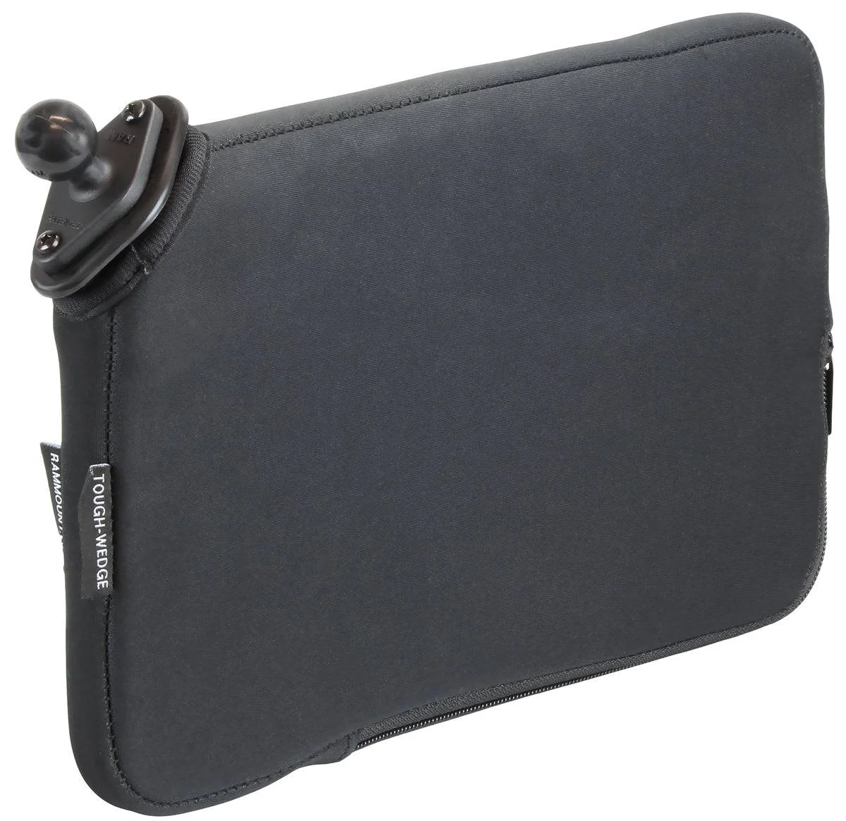

I'm going with a RAM seat wedge mount/remote head with base mounted to the back of my drawers. I'm not buying yet another radio and will be moving my old FTM-350 back and forth between trucks.
