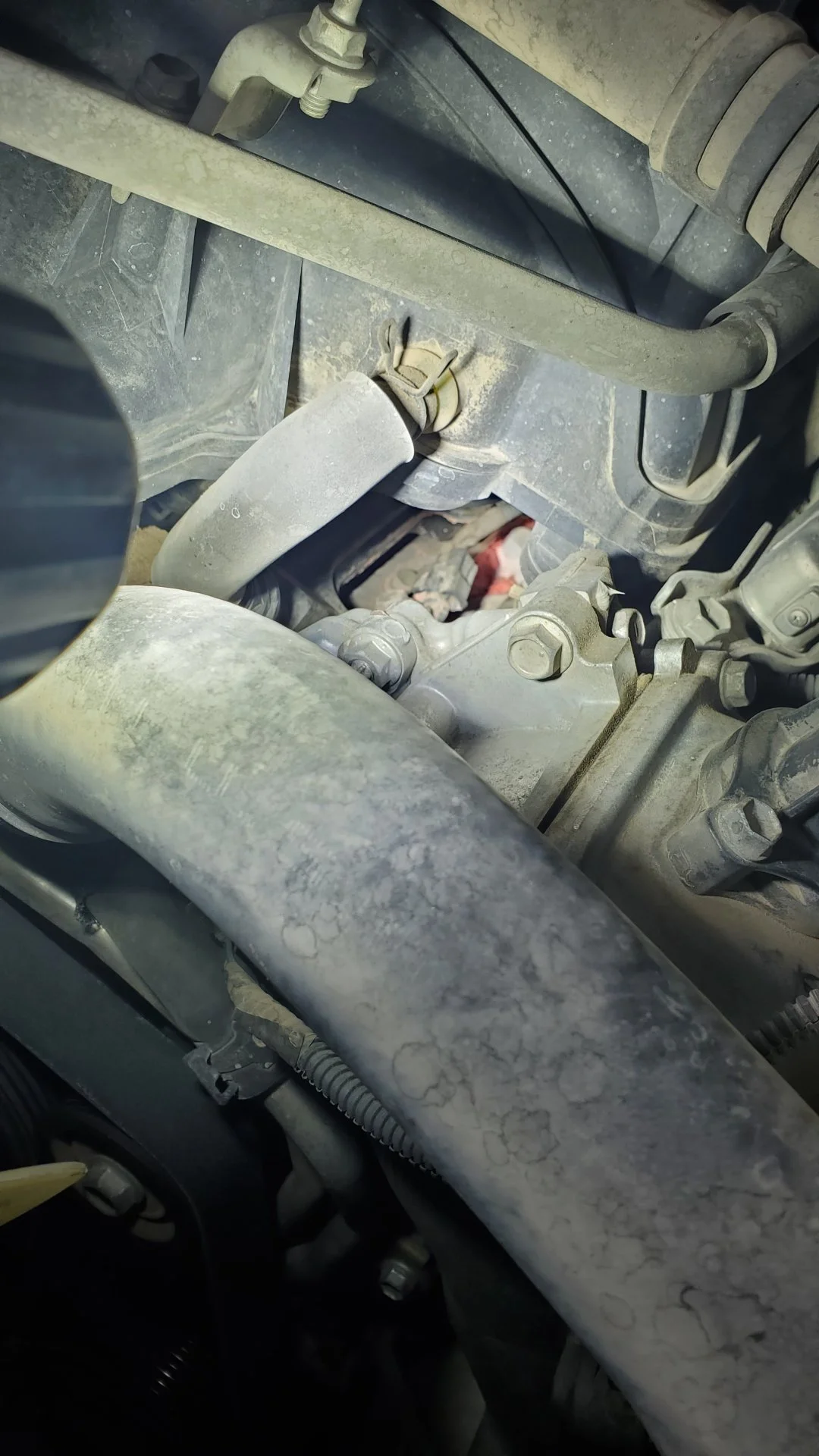

Not necessarily. Is it dripping down the back and running down the front of the transmission? Mine was a front inlet hose o ring. That's what the dealer said when I dropped it off. They changed out and no more leak. Hopefully yours is also a minor nuisance. Good luck
It is a really slow leak. When I get a chance I'll inspect further. Regardless, I have everything to fix it. Thanks for the encouragement!
