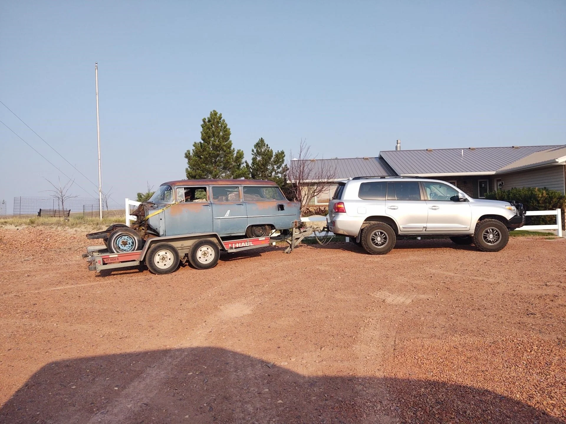

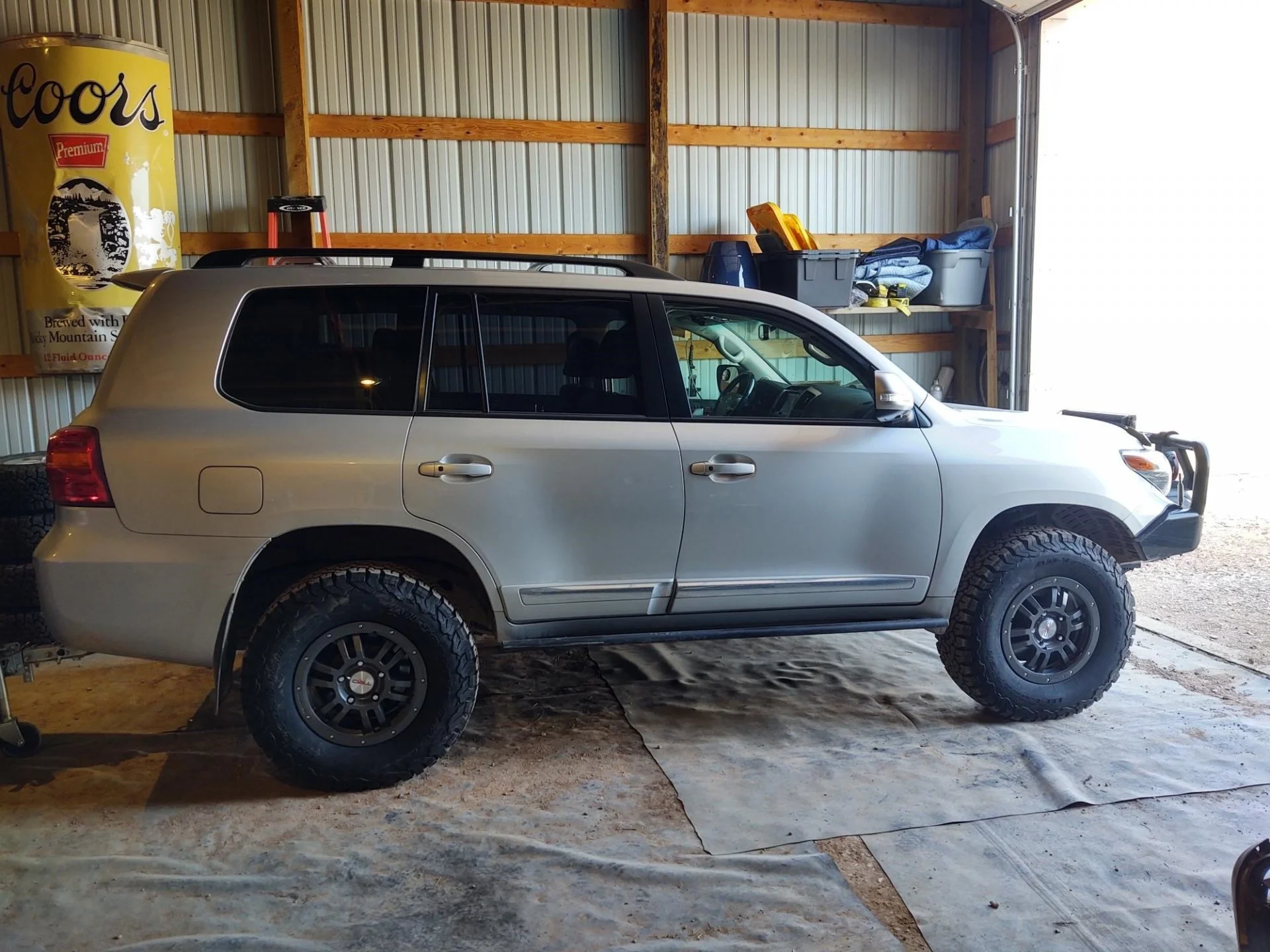

Ok, so it was last week but put new wheels & tires on (along with some evil Spidertrax spacers), then proceeded to drag a parts car home from a field near Butte, MT.

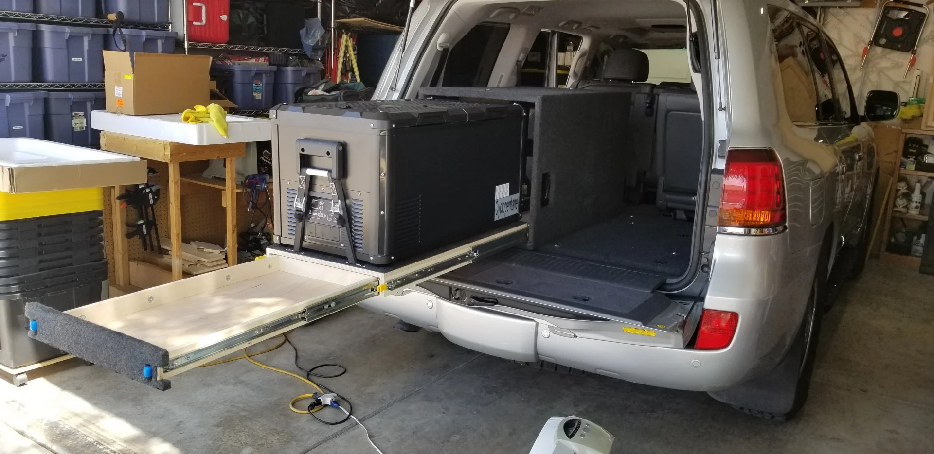

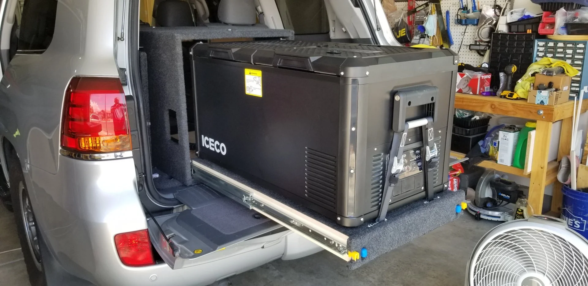

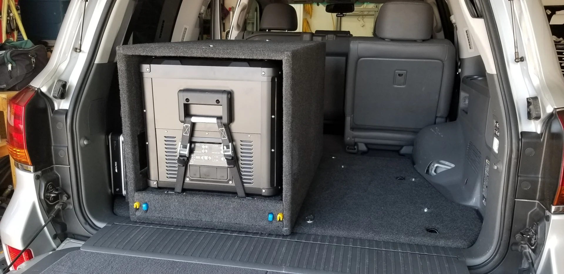

How did you anchor/attach that to the rear?
Looks like he has a false floor that is probably anchored down. I'd be interested to know where the carpet is sourced. Looks nicer than the average indoor/outdoor auto carpet covering.

I like how this turned out. Any pics of how you mounted to the floor?
I just made a base platform out of 5/8th Baltic Birch. Then bolted it in 4 places where the 3rd row seats mounted and two more in the middle area where the third row latched. The 3 circles are matched on the left side.

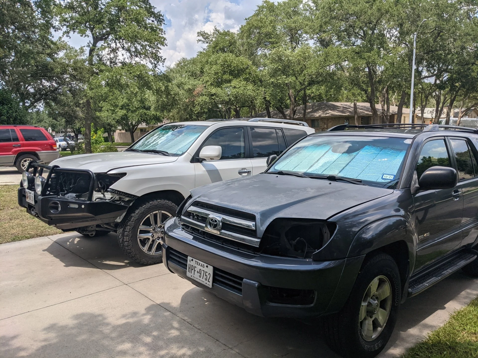

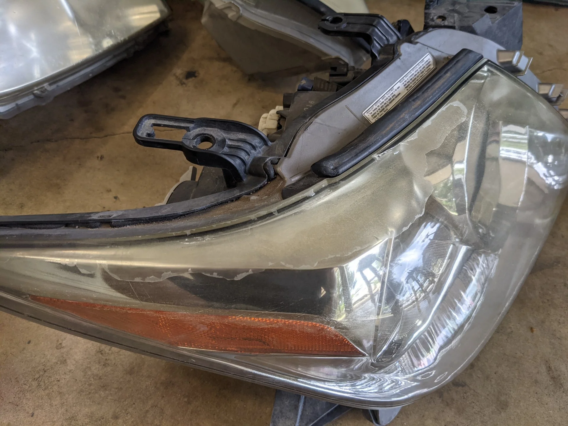

Hail a while back caused the clear on my headlights to chip off; think I went with too high of a grit for it to stick properly. Reshooting it a lil lower this time.
Cool, this is what i was considering doing to get a similar setup. Unfortunately mine is a heritage with no third row - probably will have to find different mounting points.
I would be surprised if you didn’t have the mount points under your carpet.
