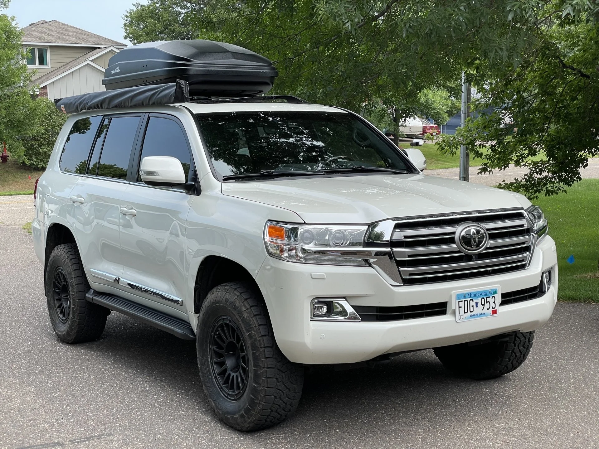

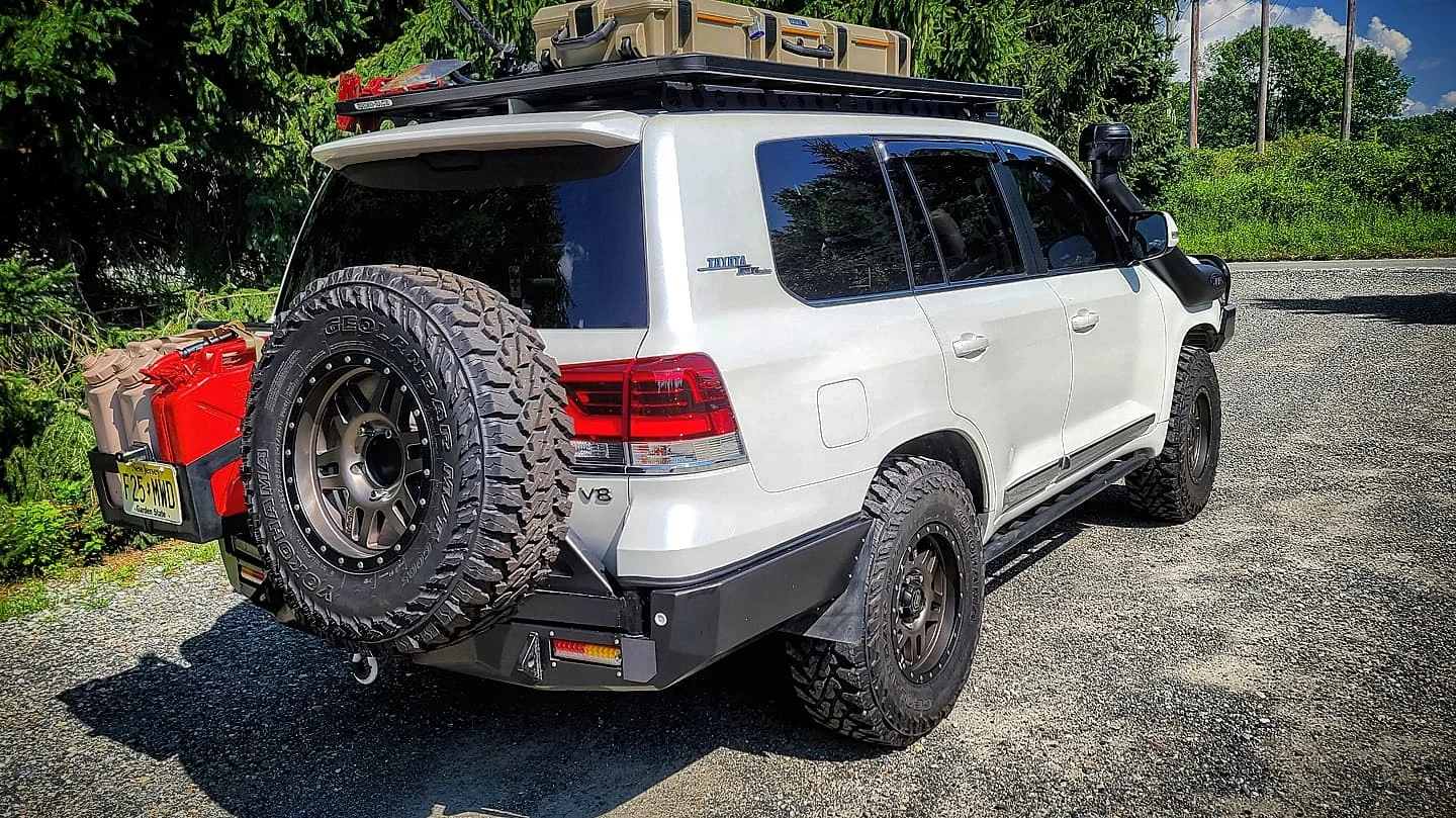

What have you done to your 200 Series this week?
- All fluids changed (oil, drivetrain, coolant, trans fluid, power steering fluid)
- All filters changed
- Wiper inserts
- Tire rotation, road force balance, and alignment
- New accessory belt
- Polished windshield
- Applied another coat of cquartz UK ceramic coating
Leaving NJ and headed to CO for LCDC !

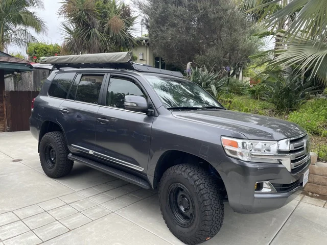

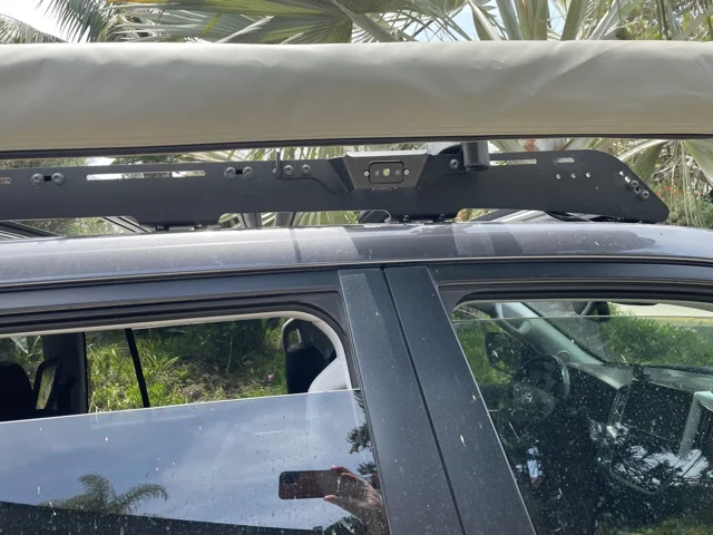

Finally got around to mounting my Ironman 8ft awning on my Prinsu with the Ironman quick release brackets. Works great! Awning sits a tiny bit high & out however it allows for full use of the Prinsu grab handles as well as the rock lights. It would be possible to flip the stock Ironman L brackets upside down then drill & custom mount the quick release brackets/awning lower however you will lose function of the grab handles & lights. I don't plan on running my awning all the time so no biggie for me. I used some 1/4 20 carriage bolts to attach the Ironman L brackets to the Prinsu then attached the Ironman quick release brackets to those.
