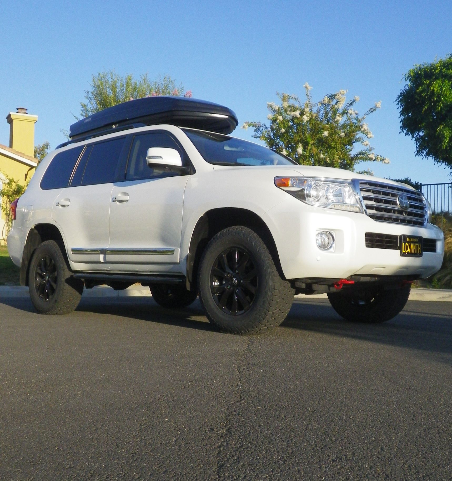

the factory wheels look old and out dated imo. And even if on factory wheels I They would rub with out lift , my lift will be in next week son-not really worried now just wanted to give heads up on people who might try to run them without lift .
The tire shop did mount a 285-70-18 on my factory wheel first just to see the look for me. And it rubbed on front and back plastic . So and the tire price was 350 more so ratered the look of the method wheels and saved few bucks going down to a 17 inch tire .
Lift doesn't help tires clear on IFS, so if it doesn't work stock without adjustment (cutting, trimming, alignment, etc.) then it won't work with a lift unless you make adjustments. I don't understand how buying 4 or 5 new wheels saved you money over tires that were $350 more for a set either. I guess I'm biased and like the stock wheels, and they worked fine for me when I was totally stock and mounted 285/70/18 RGs. They rubbed a little before trimming, but the rubbing would have been the same lifted or not. The alignment after the lift helped more than the lift itself FWIW.

Love the look of your truck, and was thinking 285/70 18 Ridge Grapplers on stock wheels might be my next tire. Curious if you’re running any spacers? Thanks,
Tommy

1.idk if our tire size is the same with that brand, 2. when I do the lift I will have the adjustment with the UCAs . 3, I was talking about the price difference from 17-18 inch tires the had a big difference . once I lift it the spot where it is rubbing should be located a little higher up and should fix it if not I will bust the heat gun out , its not rubbing by much ,
