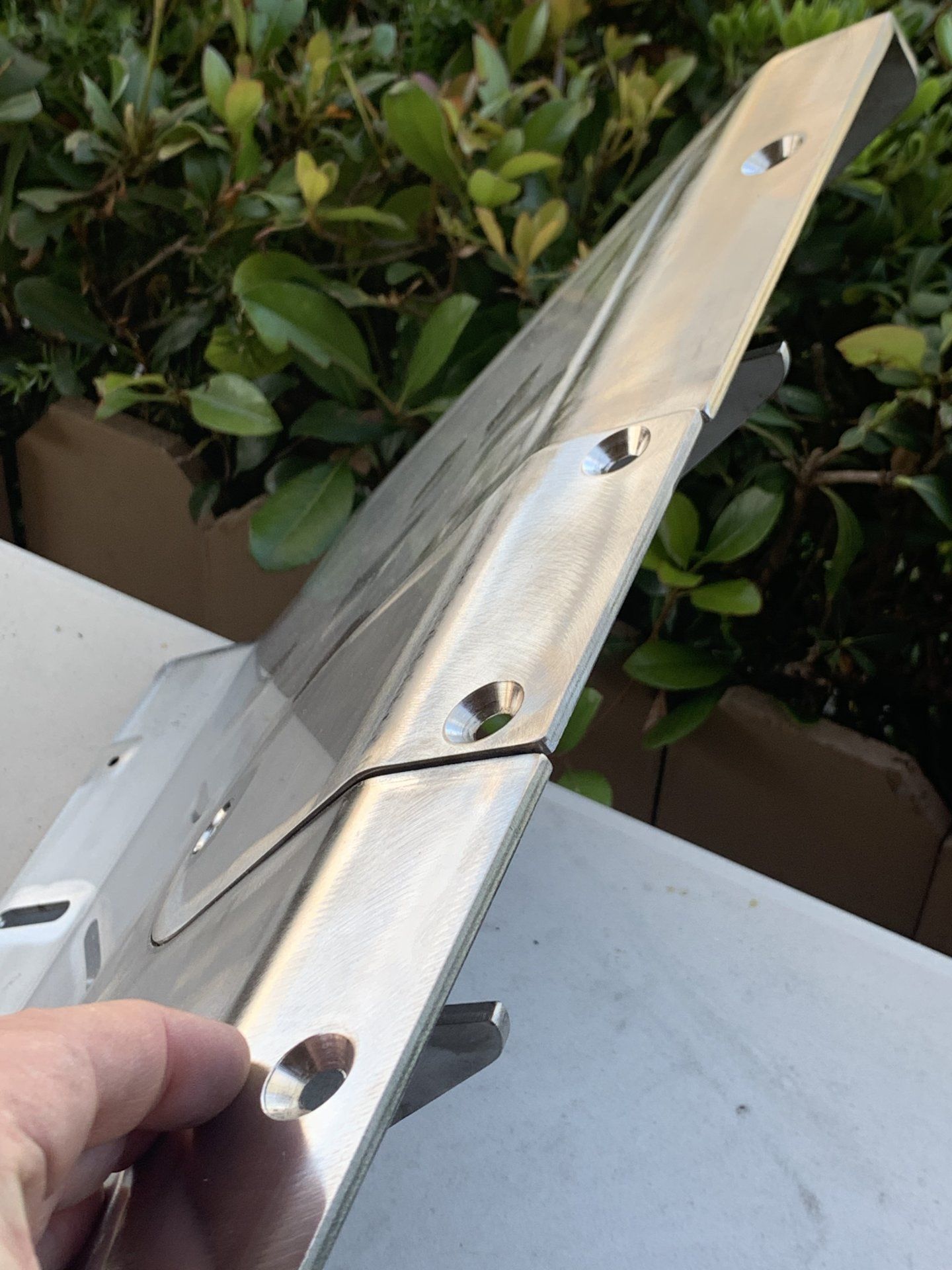

Holy smokes... Just took these BudBuilt, stainless steel works of art out of their boxes and I am seriously stunned.
Never seen something like this on a street legal truck. Lots of **cool looking** skids out there, but These things are just.... wow. Real deal is an understatement. I’m talking about strength...not looks.
Photos really don’t adequately convey...
Really need to pick them up and personally inspect.
This is just one of 5 pieces:
Edit: This photo makes it appear mirror-polished. It is not. But it’s a good partial angle to let you see the quality.
Thanks BudBuilt and @Taco2Cruiser for all your help!

Ya, in all honestly, most 200 wheelers don't need this stout a build.
BB makes much lighter versions of these that are still stronger than just about anything out there other than custom monstrosities. For me, though, It's just that I am bending stuff under my truck and pretty rough in general...so it makes sense in my case.
Can you weigh them before install and share the #s with us please?
The website lists the various weights of different options. If you run the entire skid group in thick steel it's 228 lbs, light steel 167 lbs, aluminum 115 lbs.

Not sure I have a good way to weigh them, but I can look up the UPS shipping weights of the 5 boxes they came in, and you’ll have a pretty good idea...minus about 10 or 12 ponds of cardboard, huge staples, etc.
Holy smokes... Just took these “skids” out of their boxes and I am seriously stunned.
Only once have I seen anything more stout, and that was seeing the crazy armor on an IED-sweep roller (for lack of knowing what they’re called) and it’s accompanying MRAP beasts rolling down a busy street in Jalalabad. Never seen something like this on a street legal truck. These things are just.... wow.
Really need to pick them up and personally inspect.View attachment 1948161
Nice purchase. Congrats. Youll feel the weight of those once installed. Just like the weight of sliders itll fade from thought. I did the stage 3 which is everything but the gas tank skid. They are extremely robust. On my front skid theres threaded holes in the truck frame that the skid attaches to. One of the threads nuts was missing on my truck for some reason so had to run a longer bolt and nut to secure it. No worries but if you run into that, theres your work around tip.
Enjoy those skids. I also placed some double sided foam tape between the over laps on the skids to kill any chatter. Didnt figure that out until after i ran HITR trail.
Ya, no doubt about weight, and thank you for the tips, @Willy beamin . You always seem to think of details. Appreciate it.
Weight wise, probably one more reason it's good I'm about to downsize to 285/75/17 tires... Should help with the added load under acceleration, etc.
Will also likely end up adding preload to my coil-overs and likely swapping rear springs yet again.
Will think about foam between layers as a precaution against chatter, if any. It's a lot of steel to keep motionless.

I went it’s the Stage 4 which is listed at 228 pounds. Thanks for the tips @Willy beamin . I hope to be installing mine later this month.
