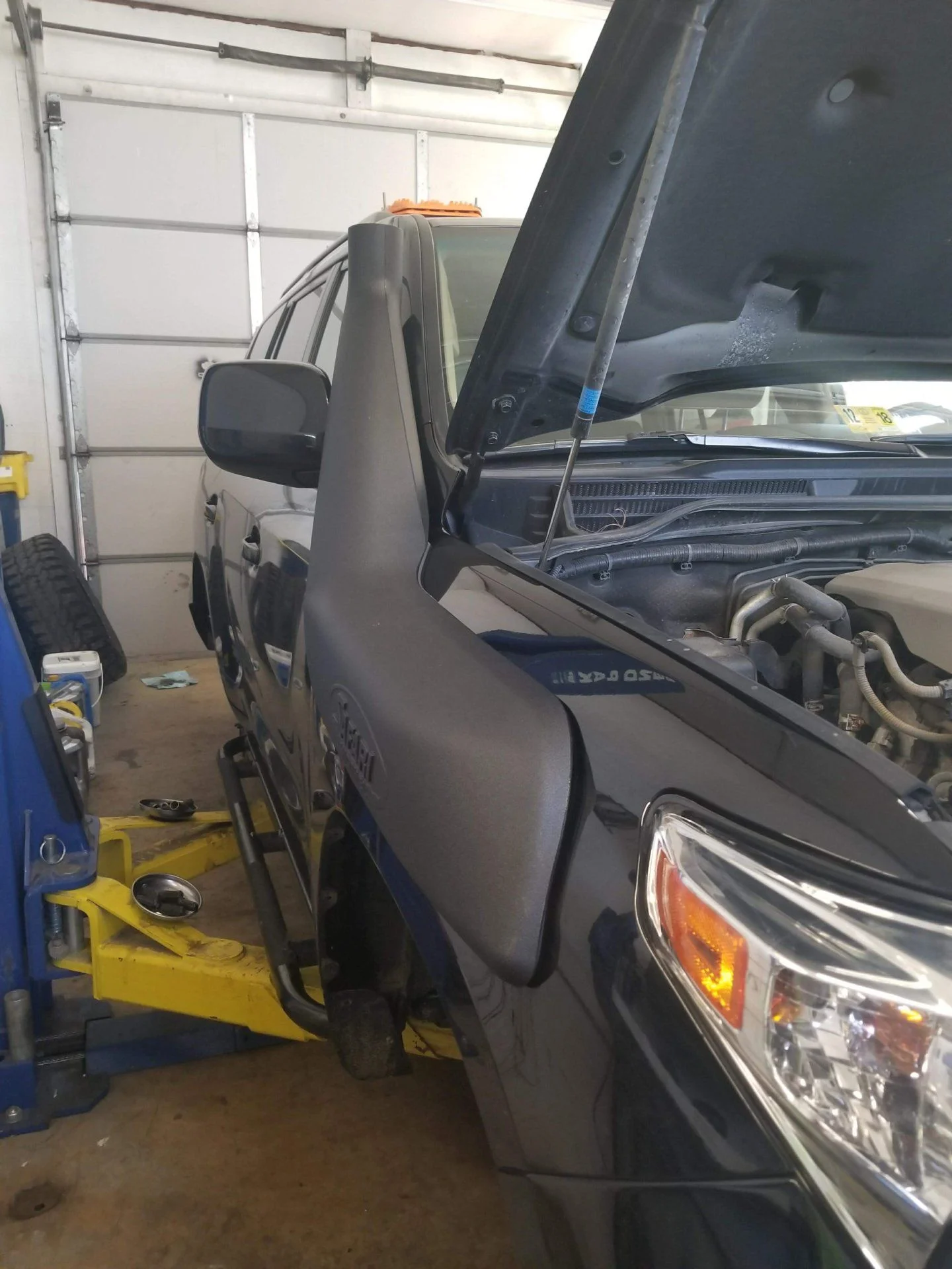

locker switches in .. front locker and snorkel going in this week

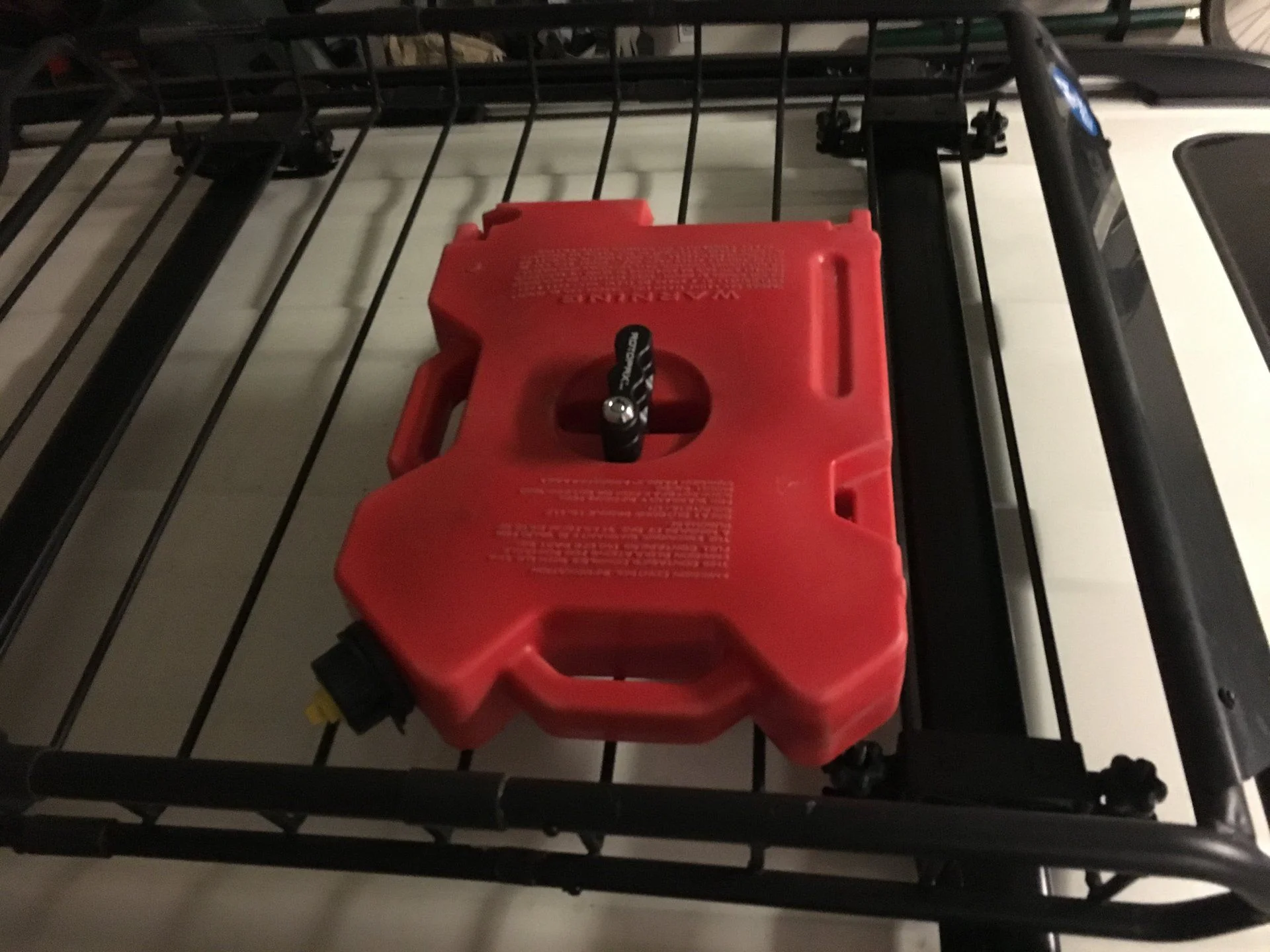

Finally bought and installed the Rotopax universal mount and lock. Stable and secure!

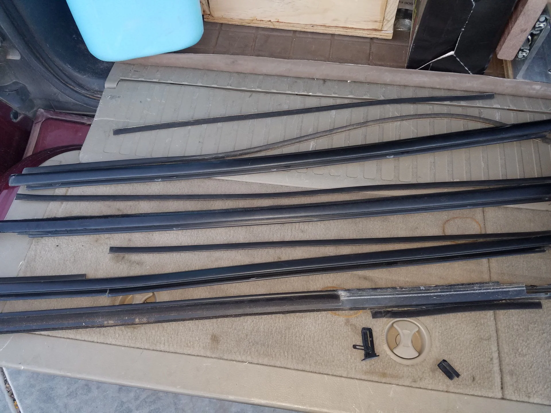

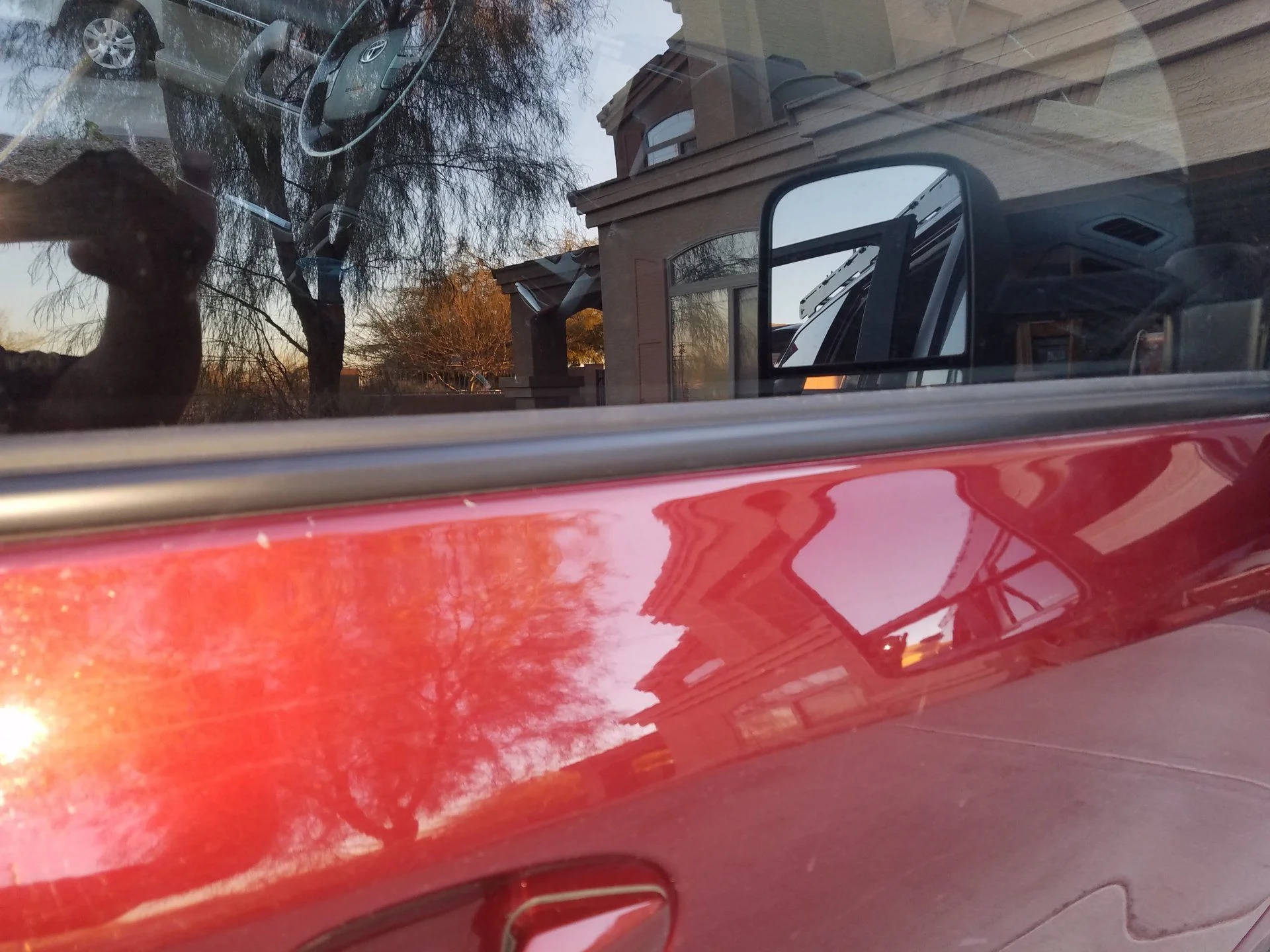

Replaced the window seals, where the window slides down into the door.
10 years in the Arizona sun eats up the rubber. Had to do the same thing to my tundra.
New seal, soft and pliable
New seal, soft and pliable View attachment 1648292
I really need to do this too. I've had to put some silicon in a few areas just to keep it all together. Easy enough to do I suppose? Where did you order from and find part numbers?
Toyota calls the part of the window seal "door belt w/strip"
front left 7572060070
front right 7571060070
rear left 7574060050
rear right 7573060050
