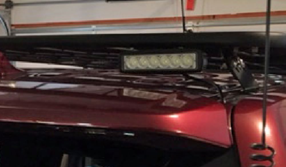

I also installed rear lights on my Gamiviti rack. Now I am in a Quandary. Do I wire them up to the reverse light or run it to the dash with a switch? Hmmm something to ponder in my garage with a glass of Crown and a stoogie :D

Nice!! I installed some Rigid reverse lights in my rear bumper and tapped the hitch harness to flick them on when I reverse, but this weekend I'm adding roof mounted reverse lights and running them off a switch for times when it could pose a problem like parallel parking downtown. The Rigids are low enough I'm not too worried about blinding anyone.

My buddy wired his to come on both ways.
I'd do a switch. Lighting up a McDonald's parking lot when pulling out of your spot seems a bit brash
That is where I came to after I was done with my Stogie as well :D

Switch. You'll find that the spoiler blocks the downward light, so these will really shoot way far behind the truck at head height. You probably won't want to use them under normal circumstances (I only use mine when setting up camp at night).
If they were in the bumper I might have a different opinion.

No need to limit yourself. You can do a switch that gives you everything. Well, if everything's what you really want...
I frequently set up ground illumination/reverse lights like that with an ON/OFF/REVERSE (ON-OFF-ON) switch. This one is for a dome light but you get the idea.
Good call. A three position switch would be ideal.
I wonder if there's a way to wire up/program a SwitchPro panel to do this since I plan on using one of their kits.
Based on their website, it sounds like a good possibility "All systems now include external trigger option". I don't think they've posted an updated installation manual yet to confirm. Edit: after thinking about it, there's a good possibility that even if it will be able to use an external trigger, there probably won't be a way to override that trigger in its software, allowing it to function like an ON-OFF-ON switch.
