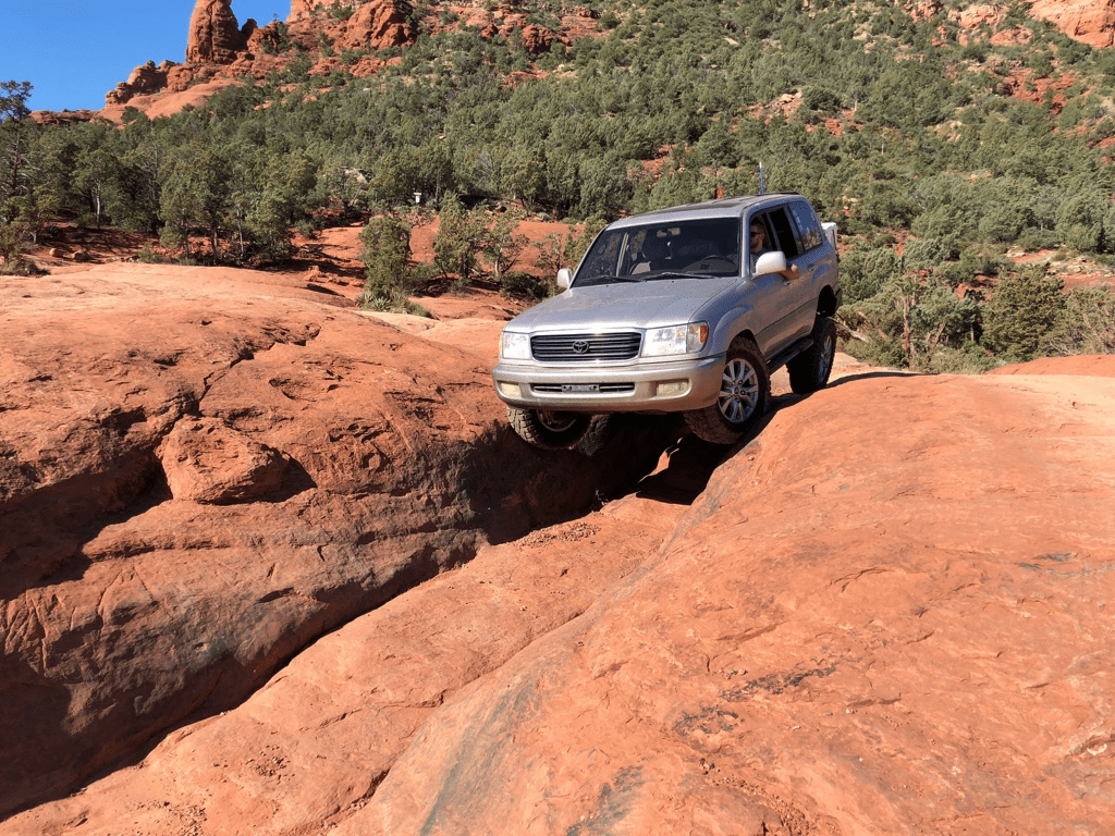

Awesome, I hope you enjoy it! If you guys mountain bike at all, that's also an awesome trailhead to ride from.
There are a lot of bonus lines to play around on, the traction on the sandstone is pretty incredible.
here's some shots from our last run:

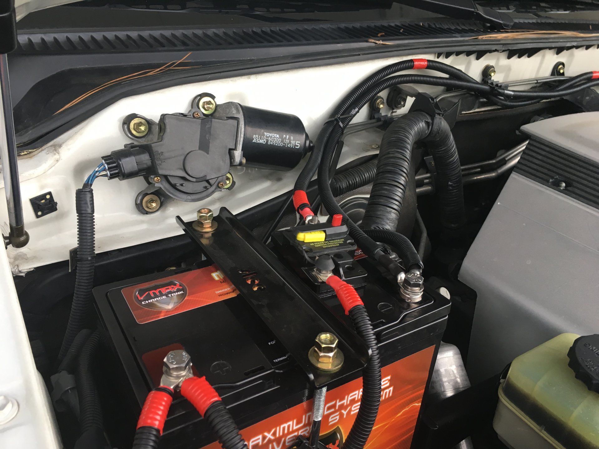

Got my second battery and Redarc charger and circuit breakers all wired up. Works great!
The Redarc charger is super impressive—monitors both primary battery and second battery voltage and intelligently charges the auxiliary battery to properly top it off and maintain it. Light years ahead of some other systems that are just a relay—I gather those are ok for a second starting battery or a hybrid but not so great for a true deep cycle. Or at least that’s what my electrical genius friend told me and I pretty much just do what he says....
