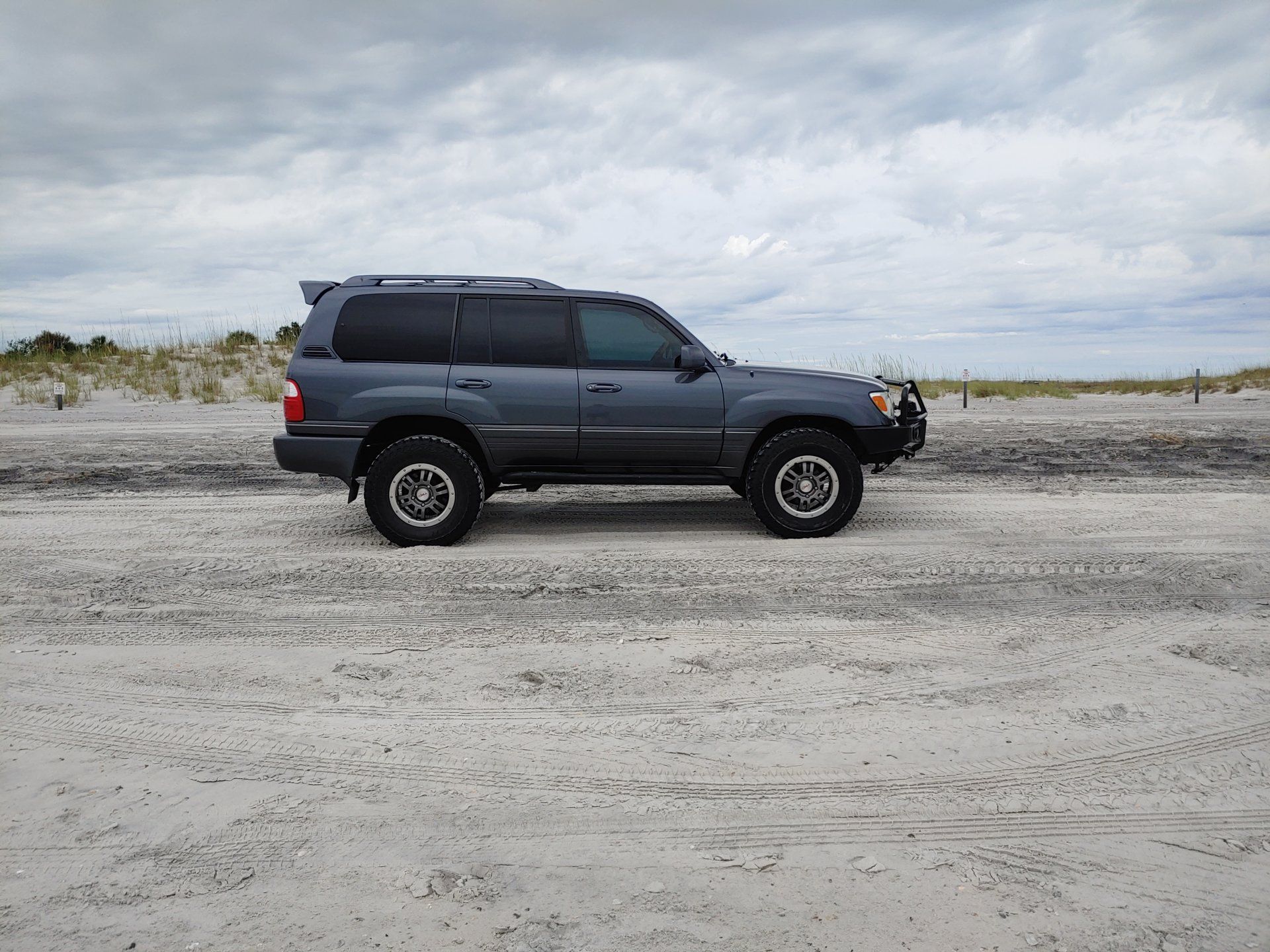

Took her down to Florida for the weekend and took a trip to Amelia island yesterday. She did fricken awesome in the sand. To the extent that the first three hours there were spent pulling out three other trucks who got stuck. I've now earned the Ford, Dodge, and Chevy recovery crew stickers. Couldn't help the Jeep that blew out his rear end though.

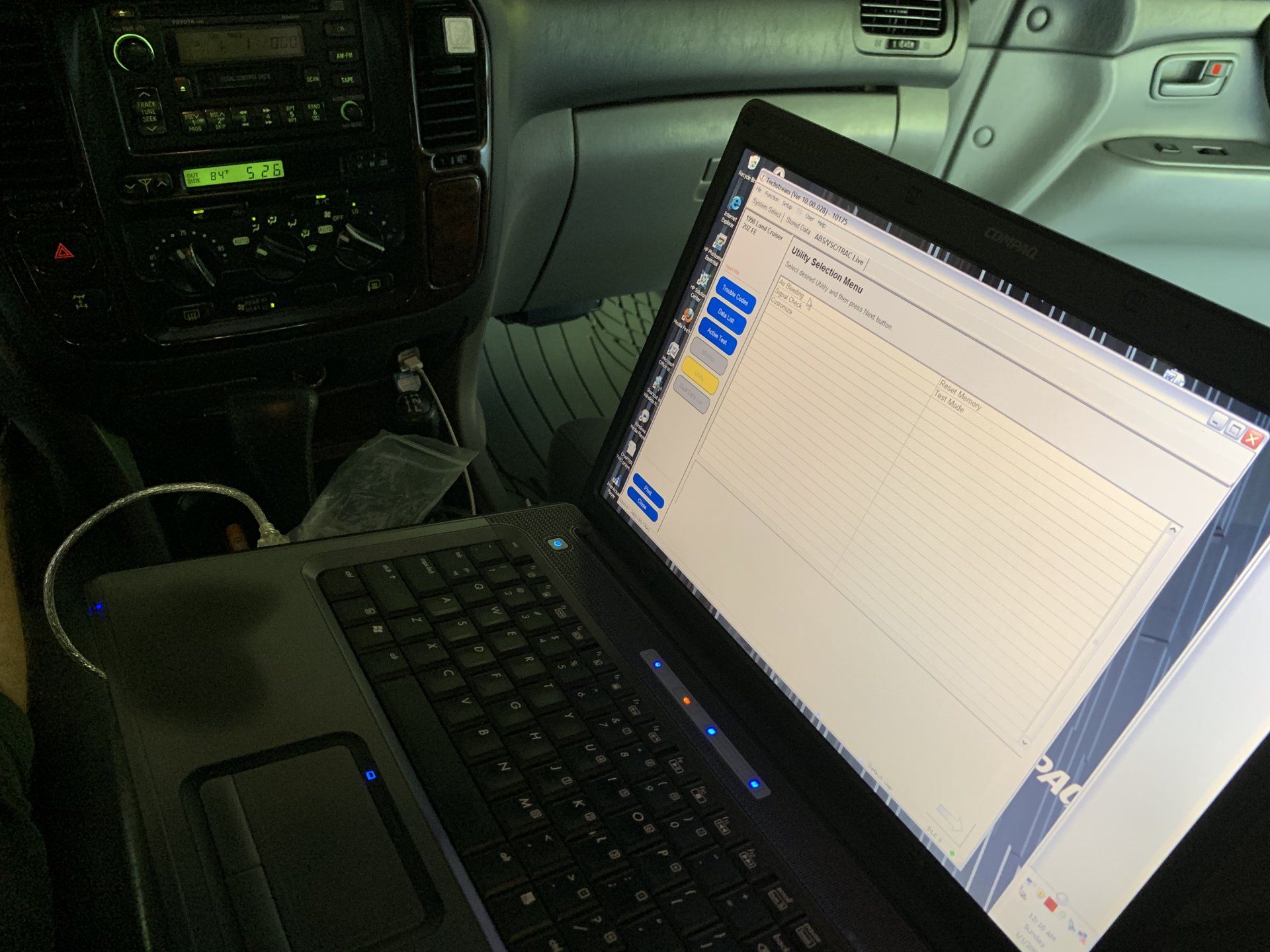

I plan to tackle some brake system items soon so I broke out the old Windows XP laptop and the Toyota Techstream app to see the bleeding program. Seems fairly simple. I hope to troubleshoot my spongy brake pedal and flush the old fluid. Sitting at 342k.

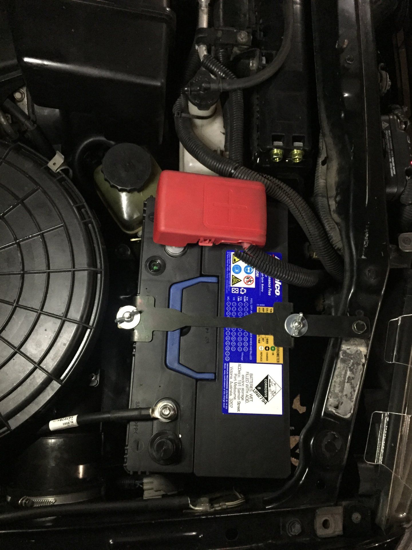

Got my dual battery system fitted. I used a Piranha offroad tray/kit and projecta VSR. The piranha kit is designed to relocate the power steering reservoir, but honestly the bracket on the side of the tray could be designed with a much better angle. When you mount it up as designed it positions the reservoir in/outlets on a far greater angle than it really needs to be - simply making it harder than it needs to be to refit the lines. I adjusted it a little so it sat on a slightly better angle to refit the power steer lines, and also gave better clearance from the battery, but only using 1 mounting bolt instead of 2. So I’ll just need to keep a close eye on it to start with and make sure it doesn’t go anywhere.
Next stage is to run some permanent power to the back for some lights, fridge and a few 12v outlets.
