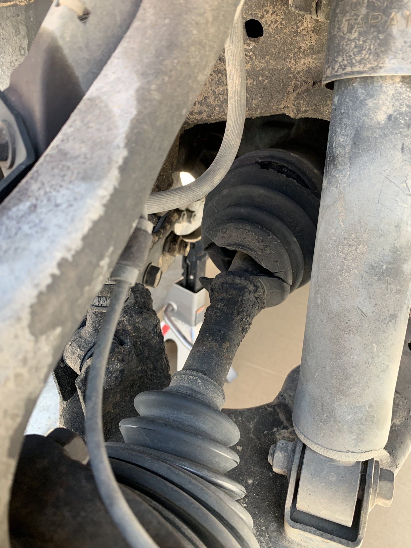

Spent about a month gathering parts since ripping my passenger side CV Boot on some trails at Hidden Falls in Marble Falls, TX.
Gathering the parts quickly turned into a “well, since I’m in there...” research.
I replaced not only the torn passenger side CV axle, but the driver side as well as all of the diff oil seals, snap rings, gaskets, nuts, washers, axle nut flanges, inner and outer wheel bearings, wheel seals, brake rotors, pads and added 1.5” spacers.

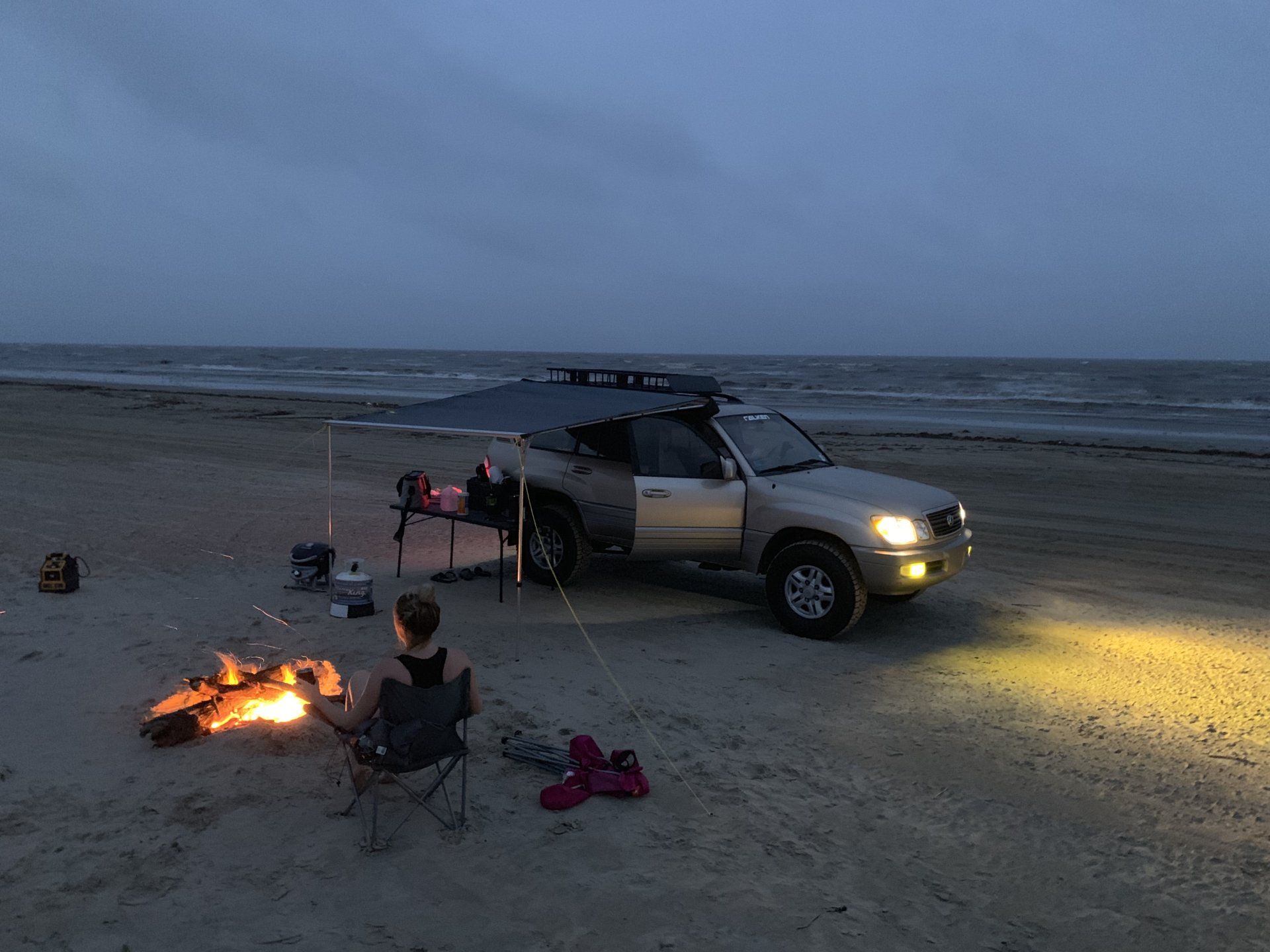

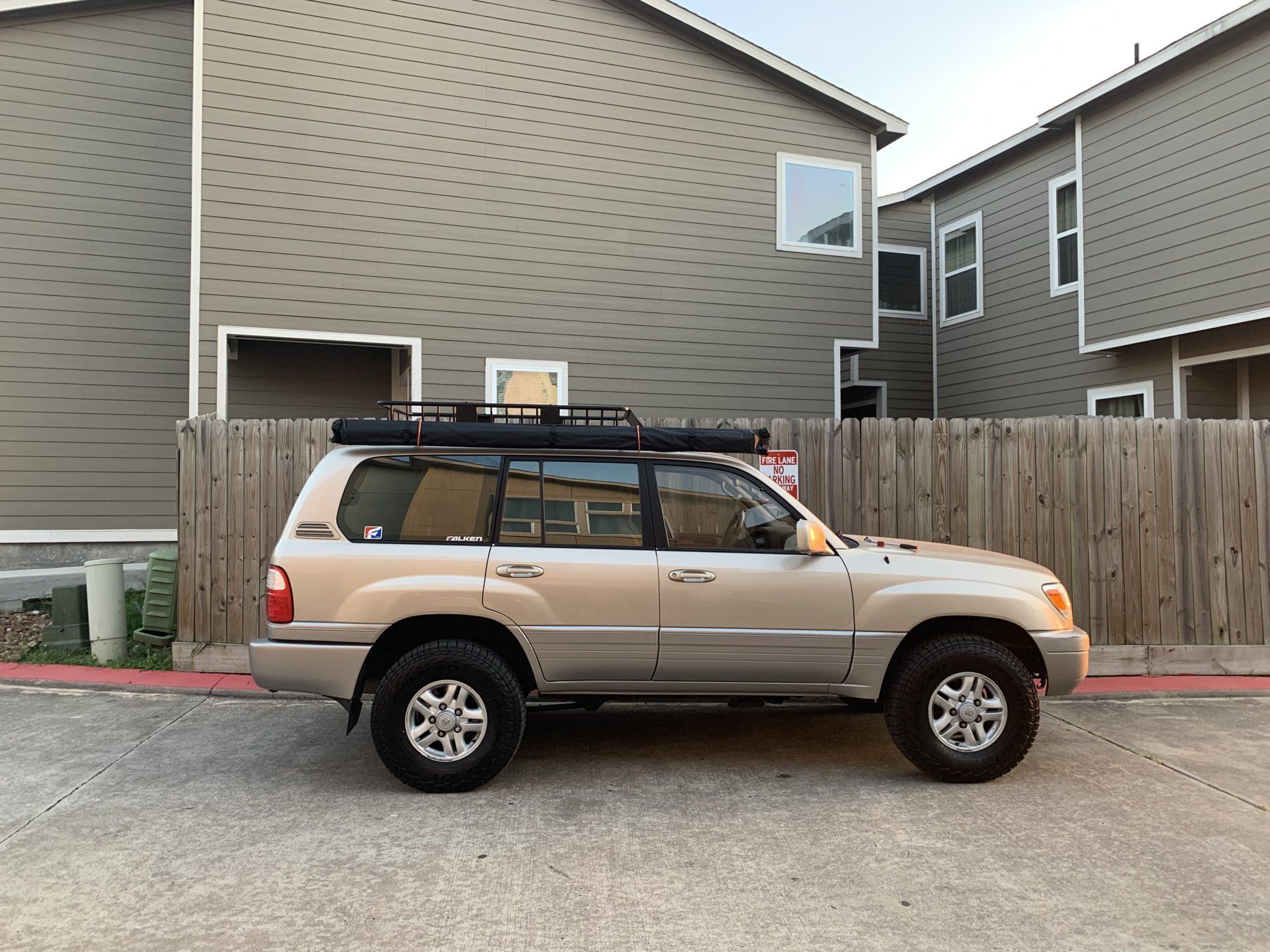

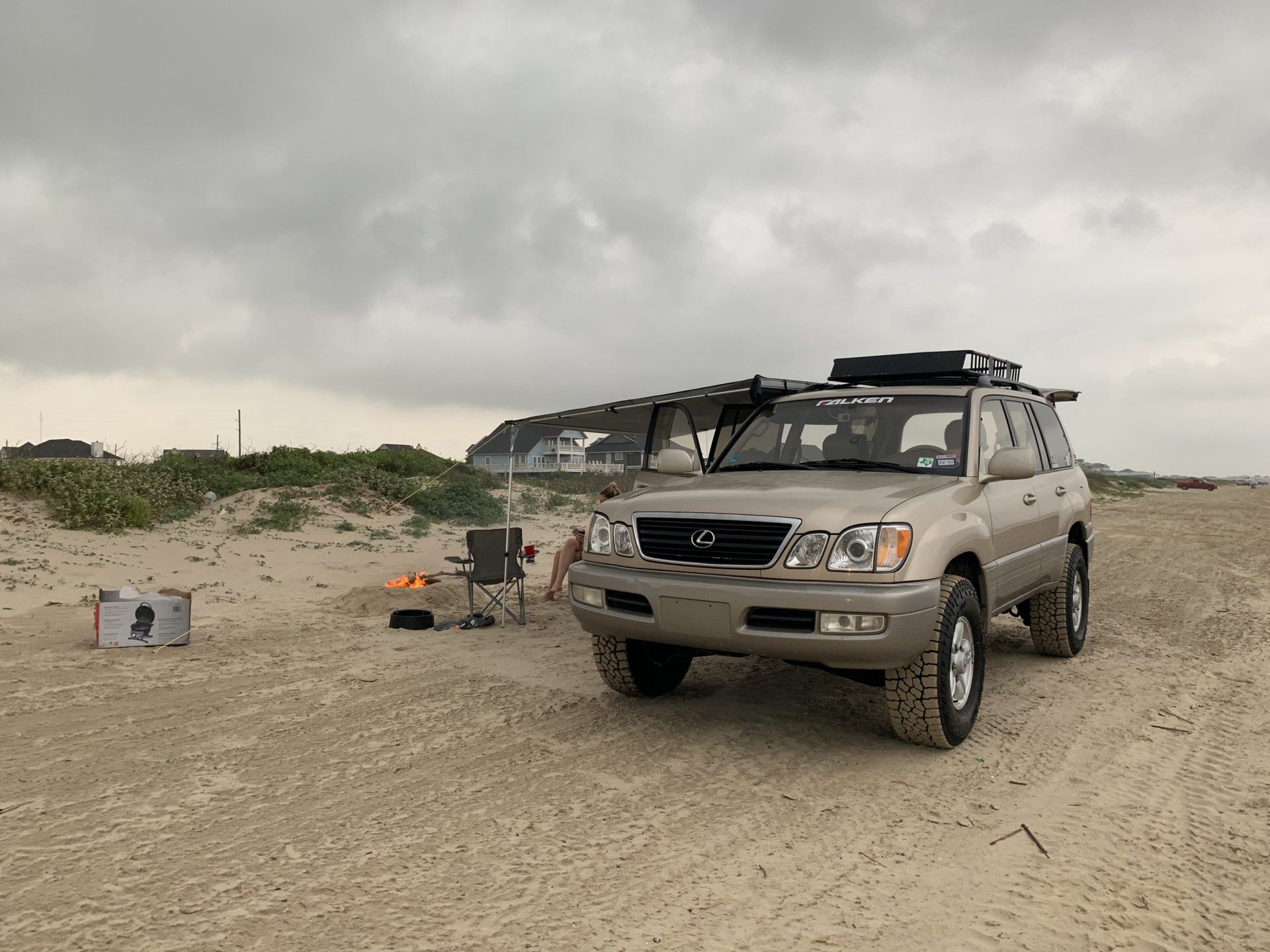

Almost forgot it took me about 20 total hours to do that, change the rear brake pads and rotors, install an awning and also added a roof basket to get ready for our trip to the beach this past weekend!

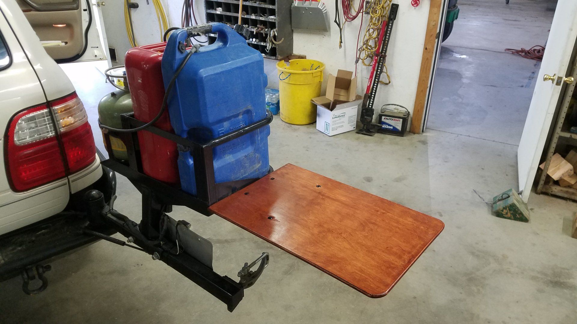

Cherry wood finish on 7/16 Baltic birch. 4 coats of poly. Flipped it over to show my bracket. I can set a marine battery on the end.

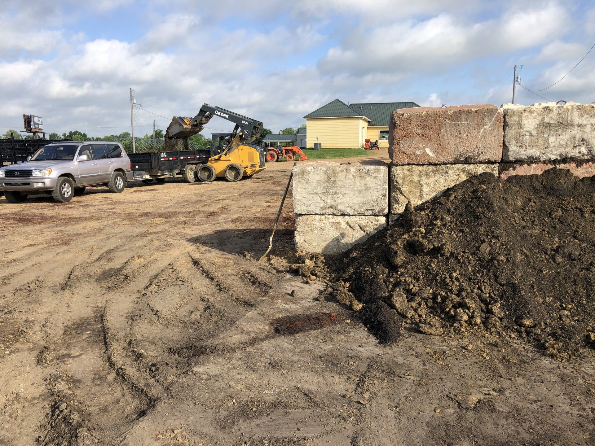

Added a set of Airlift 1000s to my son’s stocker yesterday. I’ve been using it as a tow rig since my daughter got my 98
I don’t go far with these loads but I did one a couple weeks ago and I was so squat.
25# in the bags made a huge difference
