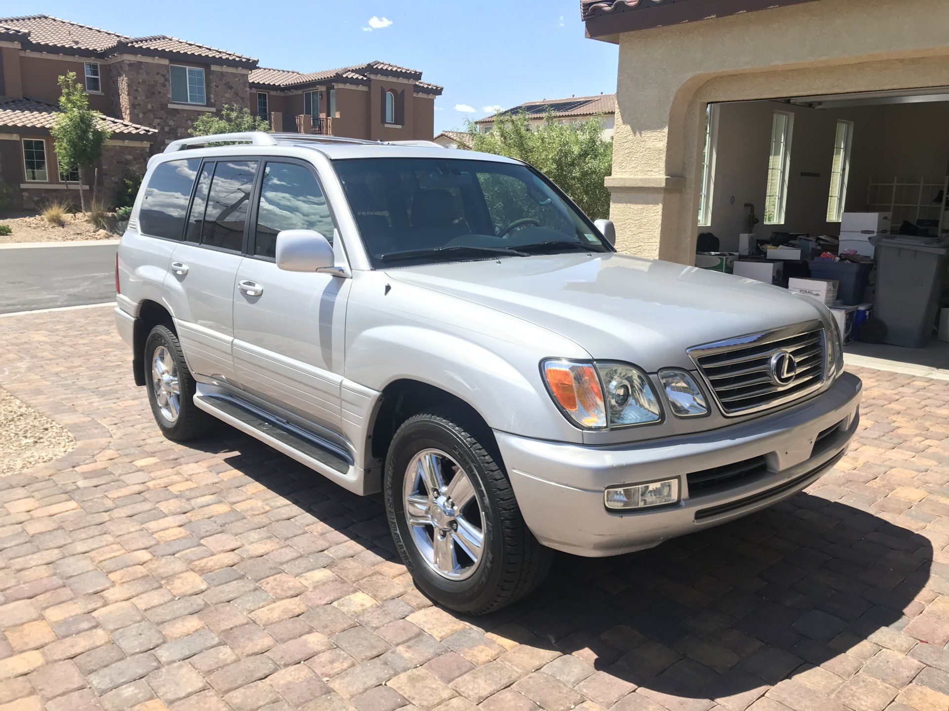

Got the front driver and passenger window and front windshield filmed with 70% VLT rating Ceramic Film 99% heat rejection (almost clear with a bluish green hue on it guess).
Here’s how it is on the glass panels now. The heat rejection is really functional it’s even hotter outside than behind the windshield when the sun is up. Since I’m not a fan of tinted glasses I really like the clear glass panels up front we get to appreciate nice sceneries and take pictures without rolling the windows down.

Got the front driver and passenger window and front windshield filmed with 70% VLT rating Ceramic Film 99% heat rejection (almost clear with a bluish green hue on it guess). View attachment 1983603
The ceramic tints and windshield coverage were the first 'mod' I did to my truck the day I picked it up. Imperative if you're in a hot or sunny area. I had to go with dark tint though, I don't like other people watching me pick my nose.
I think all 100s should have front tint to assist with our AC systems. Makes quite the difference.
