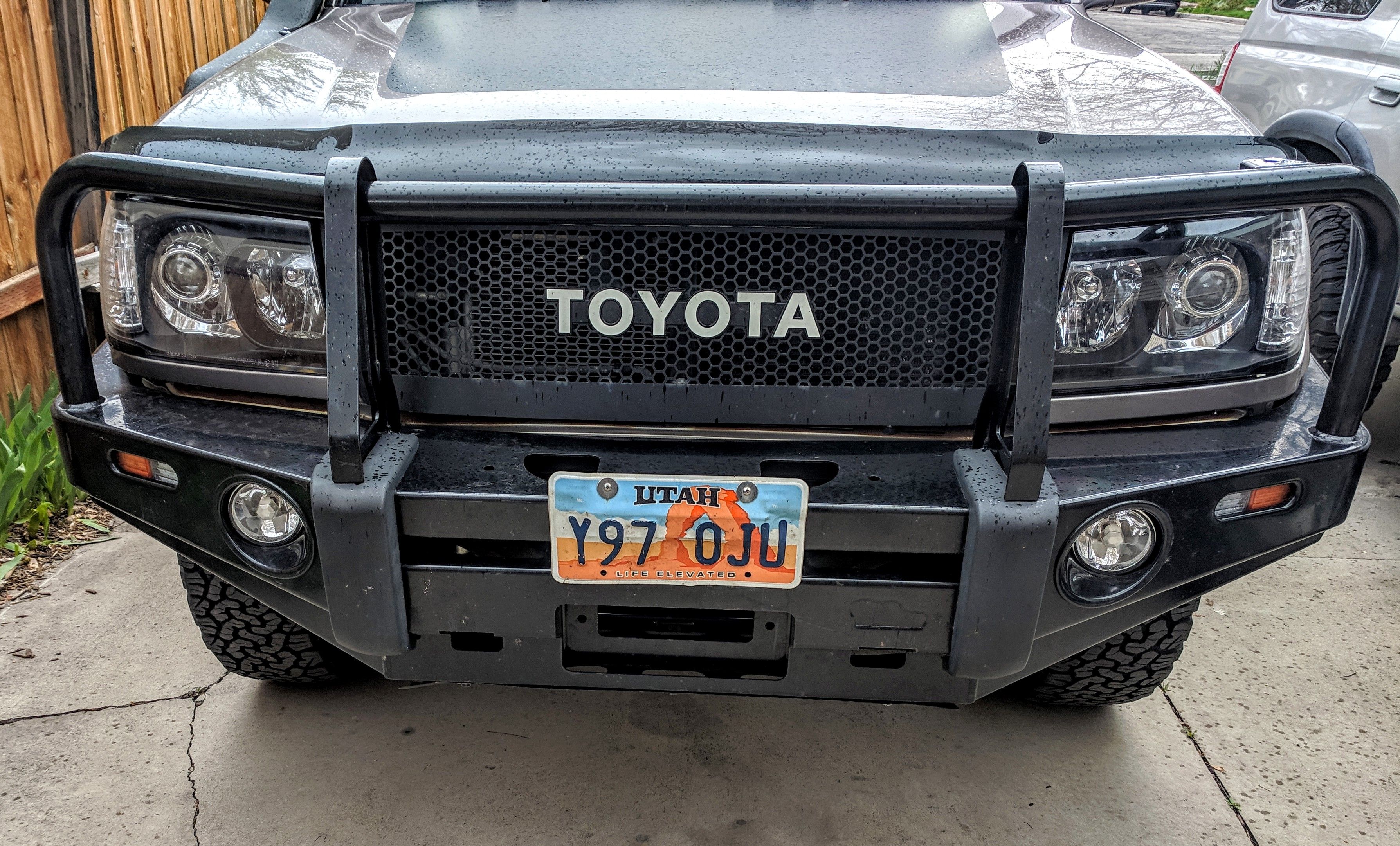

Completed the HID retrofit and install (MiniH1 and morimoto 2 stroke in depos), very pleased with the increased output:

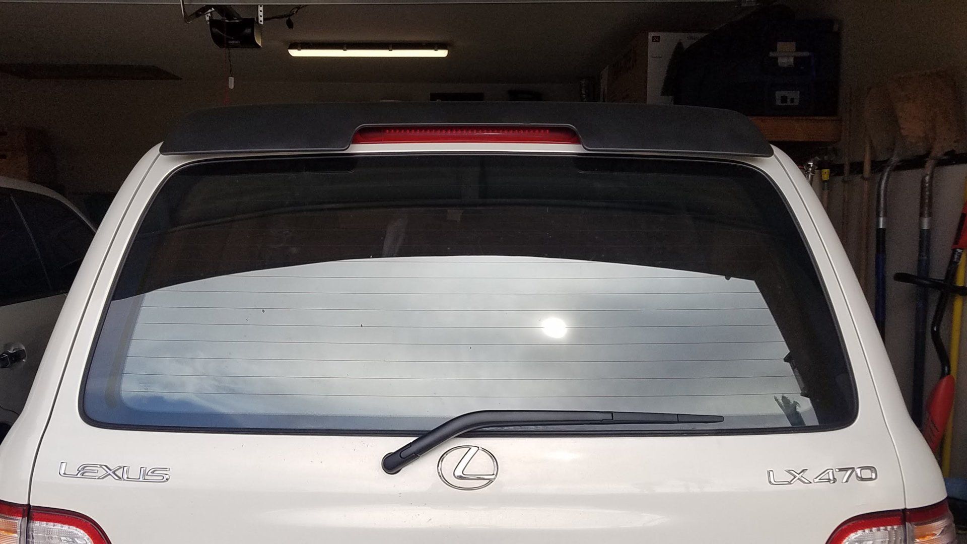

Upgraded rear wiper last week. Fronts next.
