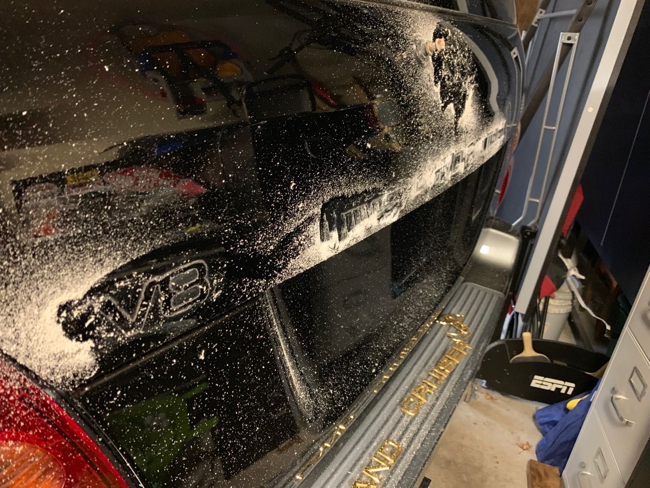

I first used fishing line to cut through the adhesive on the back of the emblems, then I used a 3M Stripe Off Wheel to get just about all of the old adhesive off. This stuff is seriously baked on. I then used polishing compound and even wet sanded it to try and get it all off. I could not get it all off without damaging the paint. I was planning on putting new emblems on so it wasn't that big of deal to me.
This is after much effort to remove the adhesive.
Final result. You can see the little amount of residue left.
