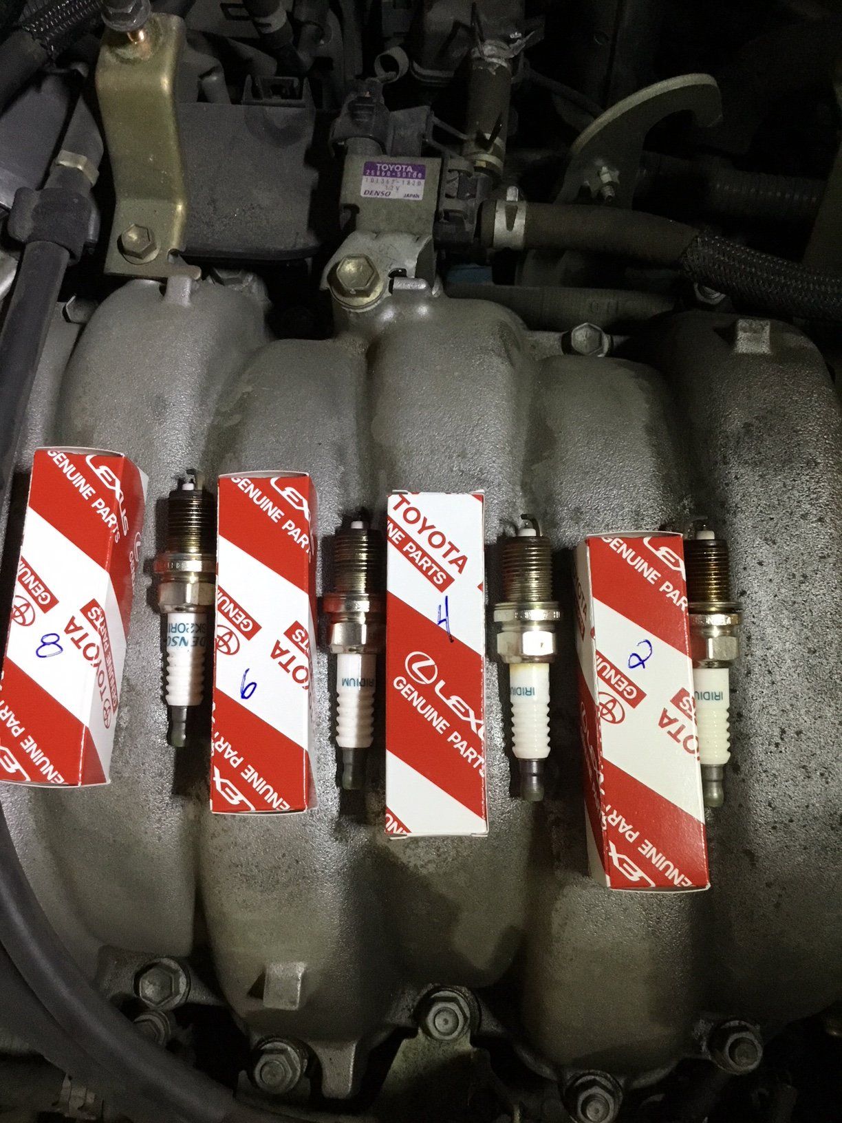

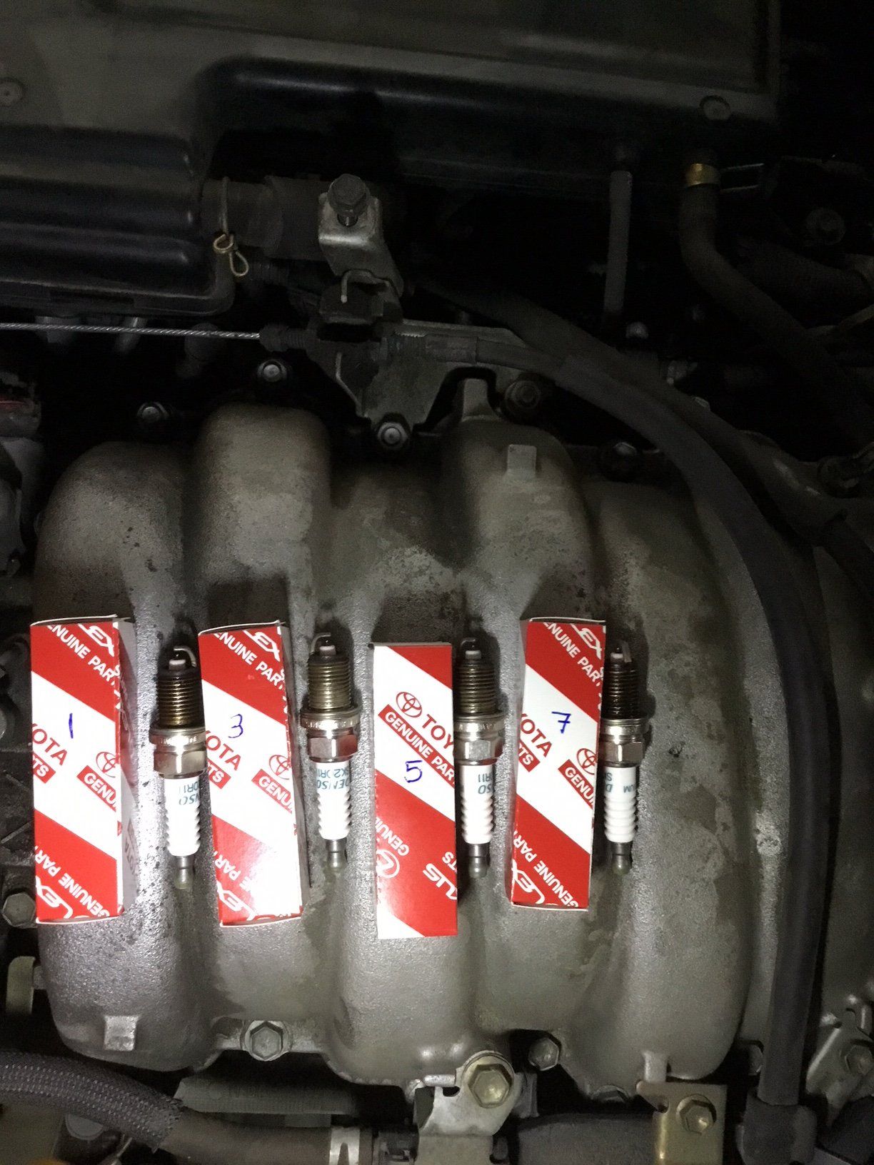

Changed out the serpentine belt, idler pulleys, AHC fluid flush, new spark plugs, and mounted my fire extinguisher.
Plugs didn't look too bad, but cylinder number #4 showed signs of blowby around the ceramic. I could hear a mild ticking noise when it was under load backing up the driveway, after swapping the plugs, it's gone now. The rubber boot didn't look too bad, but it'll be getting replaced when I get back in country again.

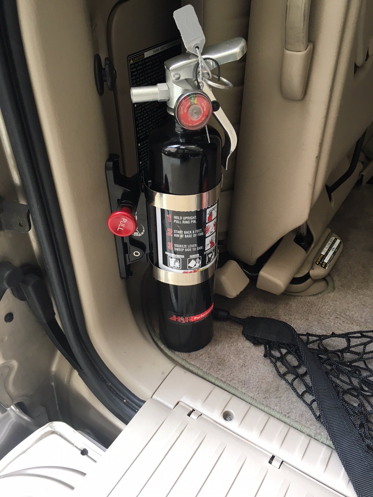

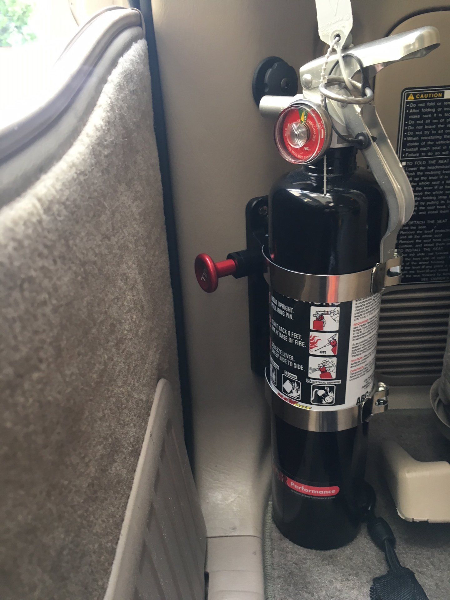

After seeing a few discussions and after all of the wiring I've been doing installing my 8" sub and amp bypass, it felt like the right thing to do. Mounted it in the rear cargo area where it'll be easy to reach in and grab it if I have it full of gear.
What fire extinguisher mounting bracket is that, and where can I get one? Looks good!
It is a Drake Extinguisher mount. I'm still anxiously waiting @NLXTACY to start selling the seat mount brackets for the 100's like he has for the 80's. I'd like to have another one at an easy reach when its needed. So, until then, this is what I've got.
