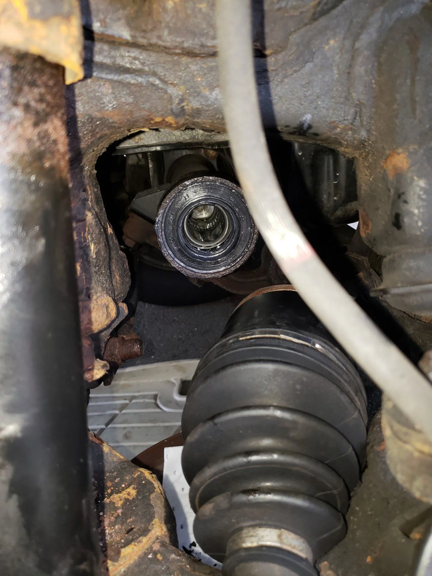

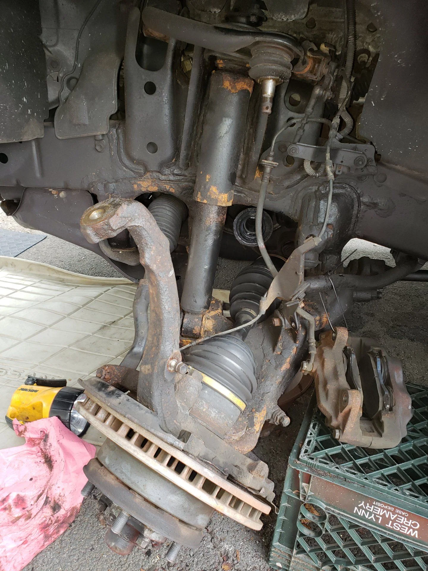

Rebuilt the passenger side inner cv axle after my buddy and I slightly tore the boot using the 'wood' method when we installed the reman's the first time. It was our fault as we misaligned the wood, but even with it setup correctly that method never worked for us. The first time we just pryed the crap out of it with pry bars.
A tip from me is buy a brass punch and use that on the lip of the axle. This time around the passenger side installed incredibly easy using that, with no damage to the lip.

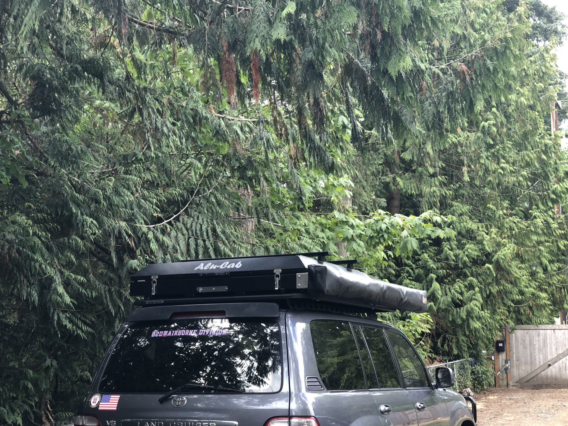

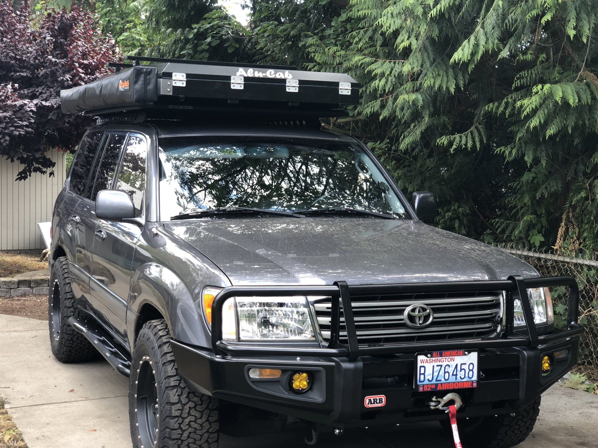

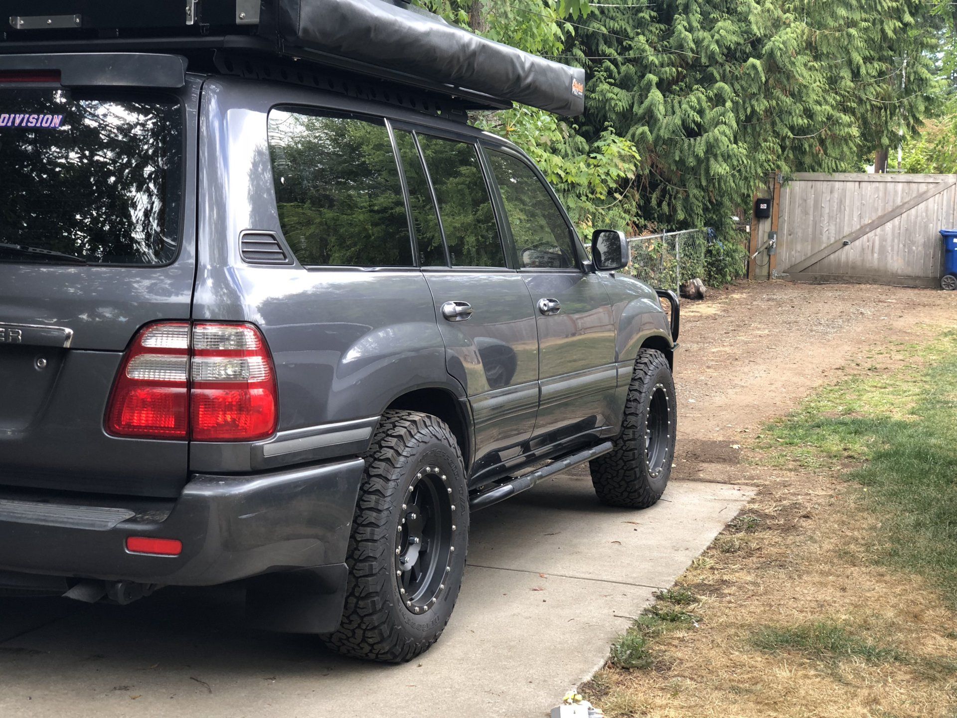

New additions to my LC:
Electronics gear:
Kicker Hideaway 8" SUB
Garmin gpsmap 276cx with CITI and West Coast TOPO
Hardware:
White Knuckle Sliders
ARB Deluxe Bull Bar Front Bumper with Warn Zeon 12-S Winch
Baja Designs Squadron Sport Amber WC, w/ Bezel Kit used as fog lights on bull bar
Rhino Rack Pioneer Platform
Alu-Cab Expedition Series 3 Rooftop Tent with load bars and cold weather kit
Alu-Cab Shadow 270 awning
All hardware was bought and installed by Adventure Ready in Seattle. Highly recommend them!!
Cheers

Solid looking rig!

Nice who were you with in Division?

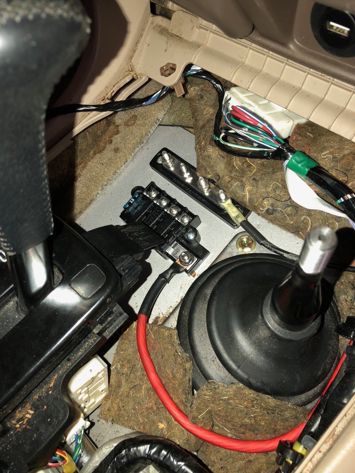

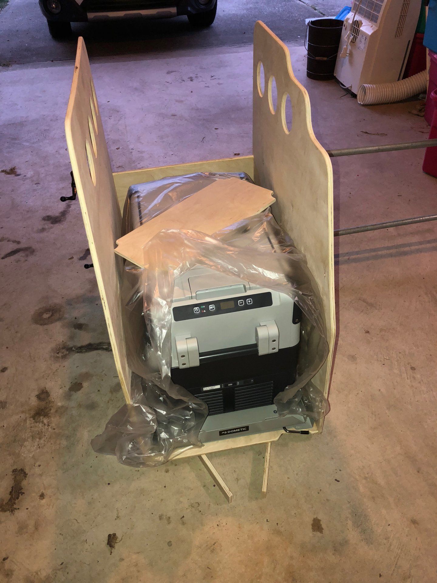

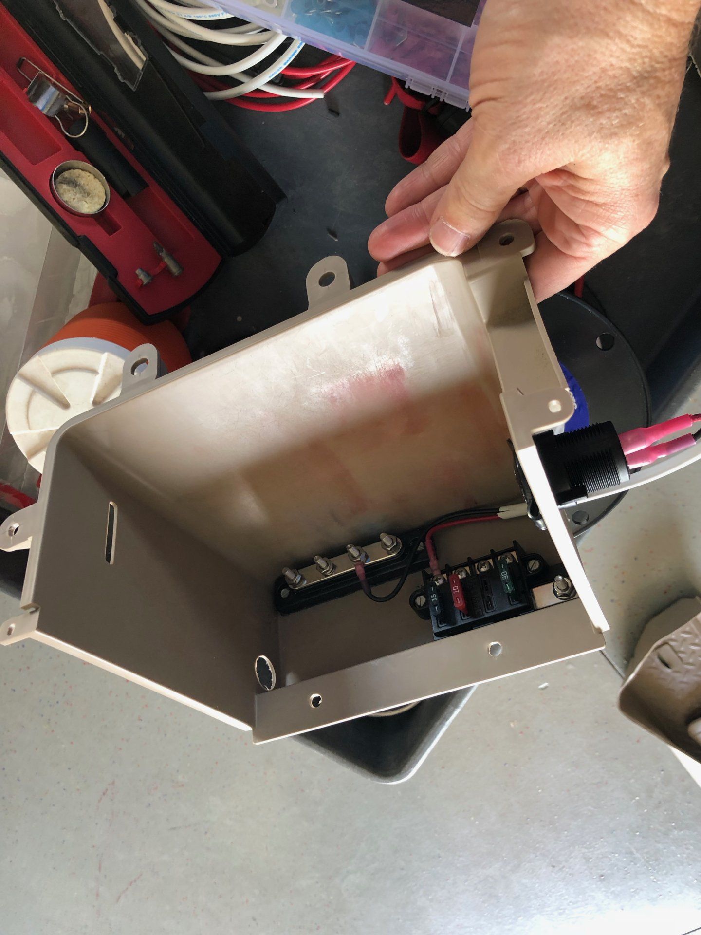

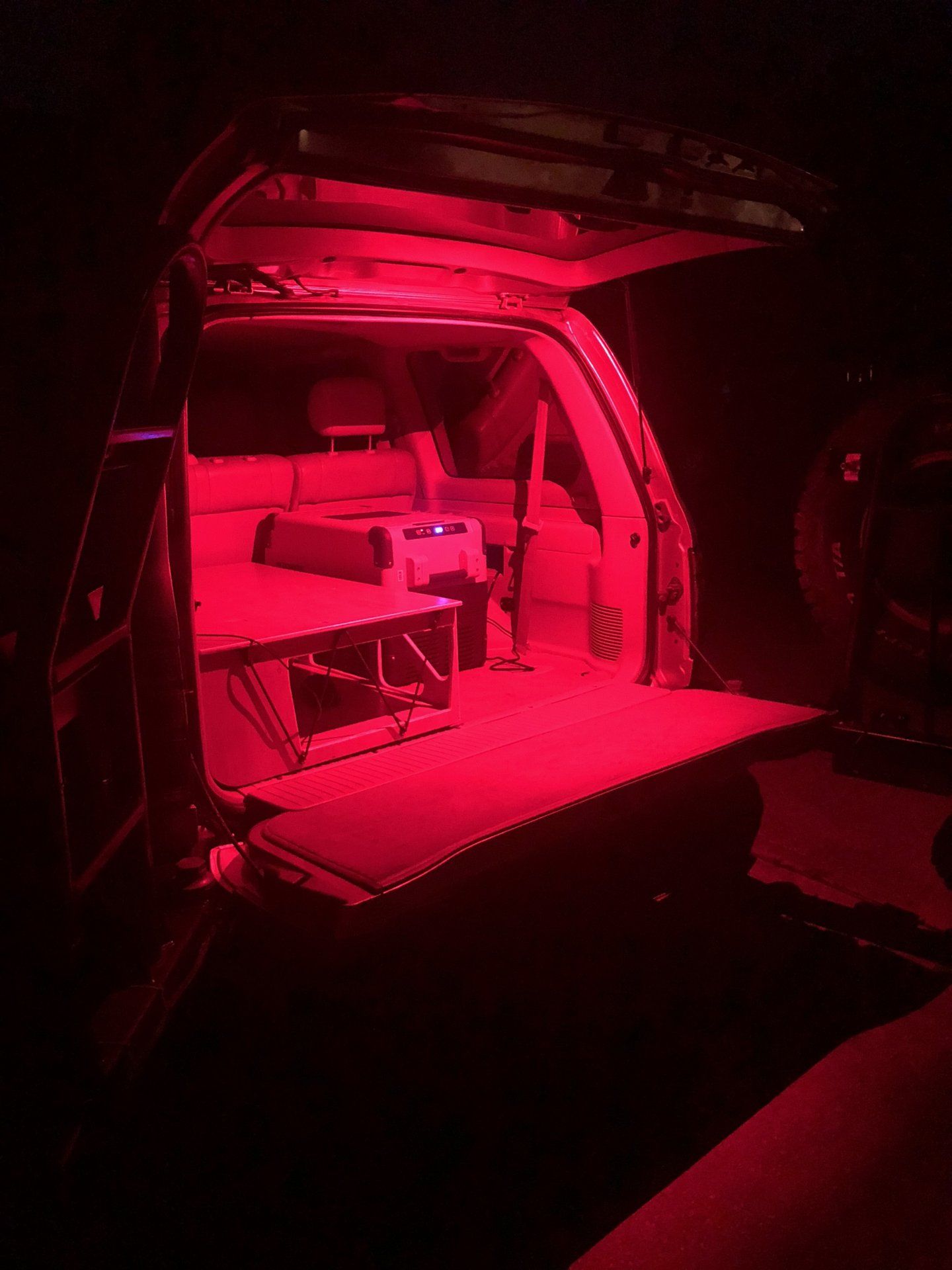

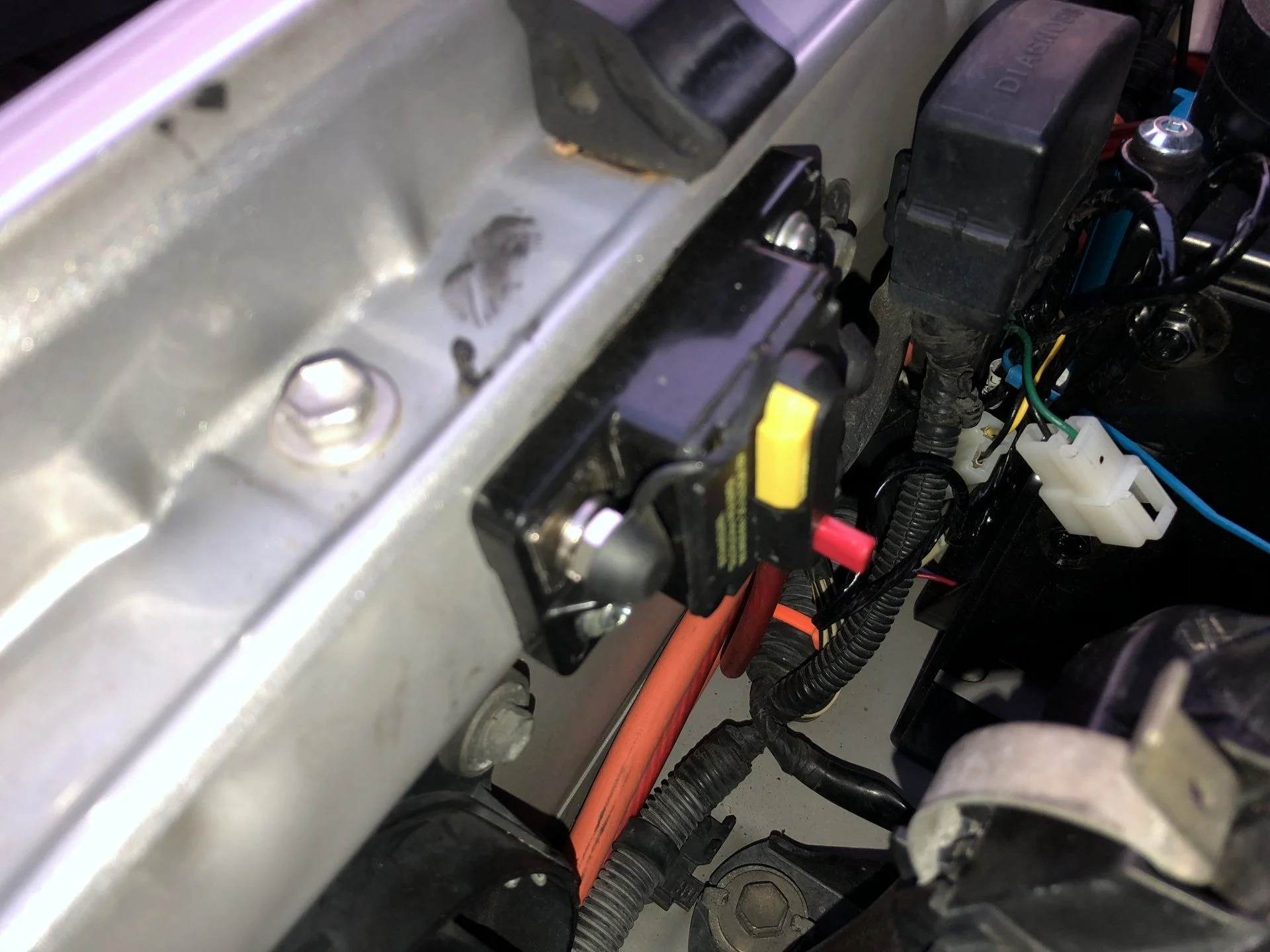

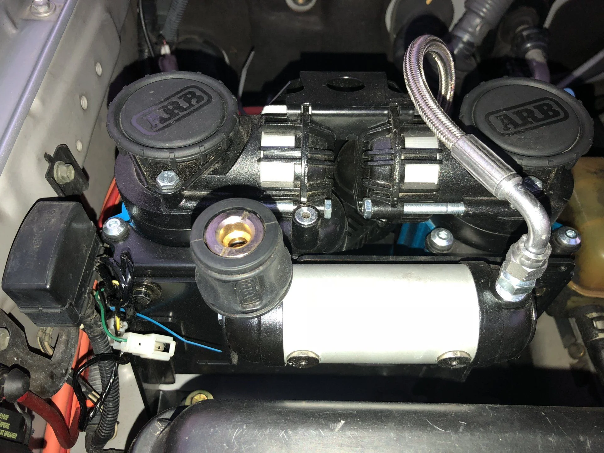

Finished up an electrical upgrade for my next trip.
Added a second battery and compressor on a Sled tray. Used a Victron charging relay to charge/seperate the batteries. Added a Blue Sea circuit breaker under the hood. Ran power to a fuse block under the shifter panel. Added 4 Blue Sea high amp usb chargers running full time (even with the truck off). One in the front dash, two in the second row seats, and replaced the 12volt outlet in the rear driver side by the tailgate. Added a second fuse panel that will power a small removable cabinet with the fridge, fan, charging outlet and two led lights (red and white) in the tailgate. There is also a Blue Sea battery switch 1/both/2. I can bypass the charging relay and combine the batteries if I need to jump start or use the winch.
