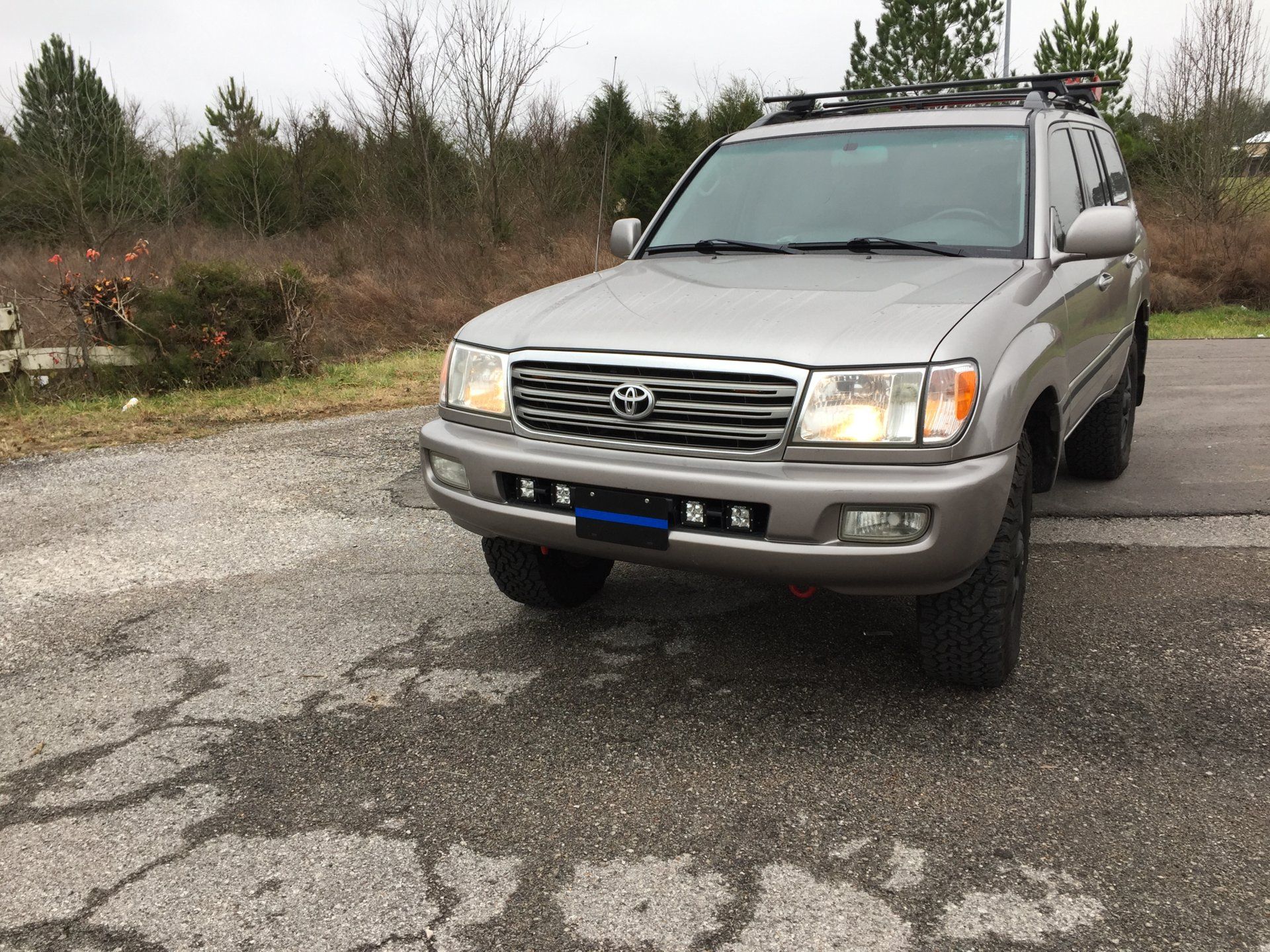

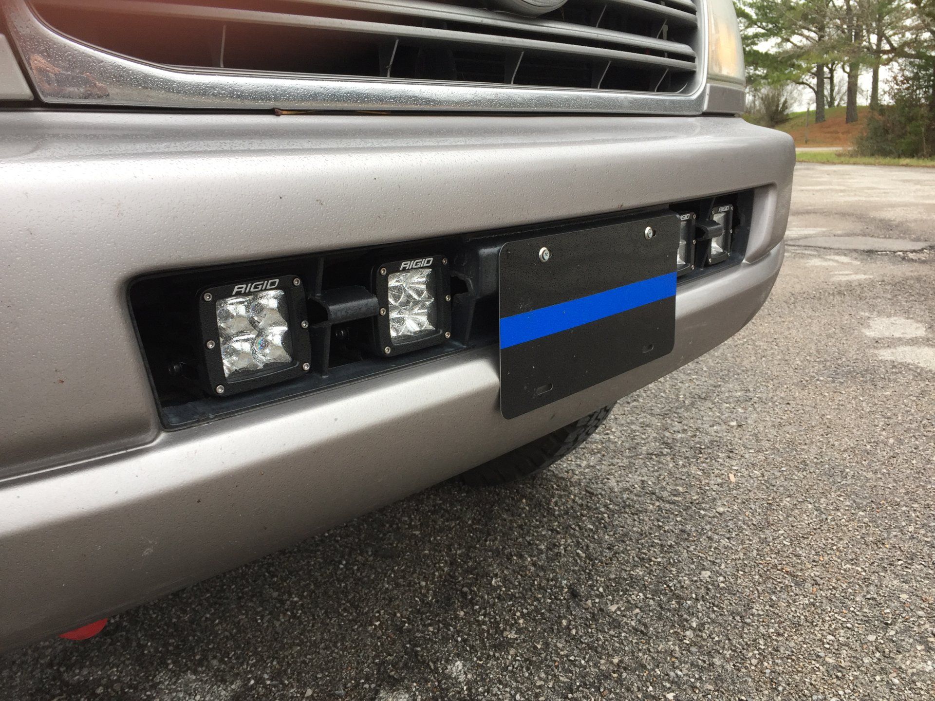

New plates and new tundra wheels powder coated Bronze wheels with 35” ko2’s . I need to find a better color match for the center caps, but not bad for now. Ps. My Cooper STT Pro are for sale in the classifieds. Only 6k miles on them.
Looks killer!
I've been interested in running a 35" BFG but have been worried that 12.5" is too wide a tire to fit without rubbing in the front with articulation. Interested to see how much if any rubbing you get on the upper control arms and frame rails with the offset of those tundra wheels and if you can mitigate some or all of it by adjusting the turn stops.
