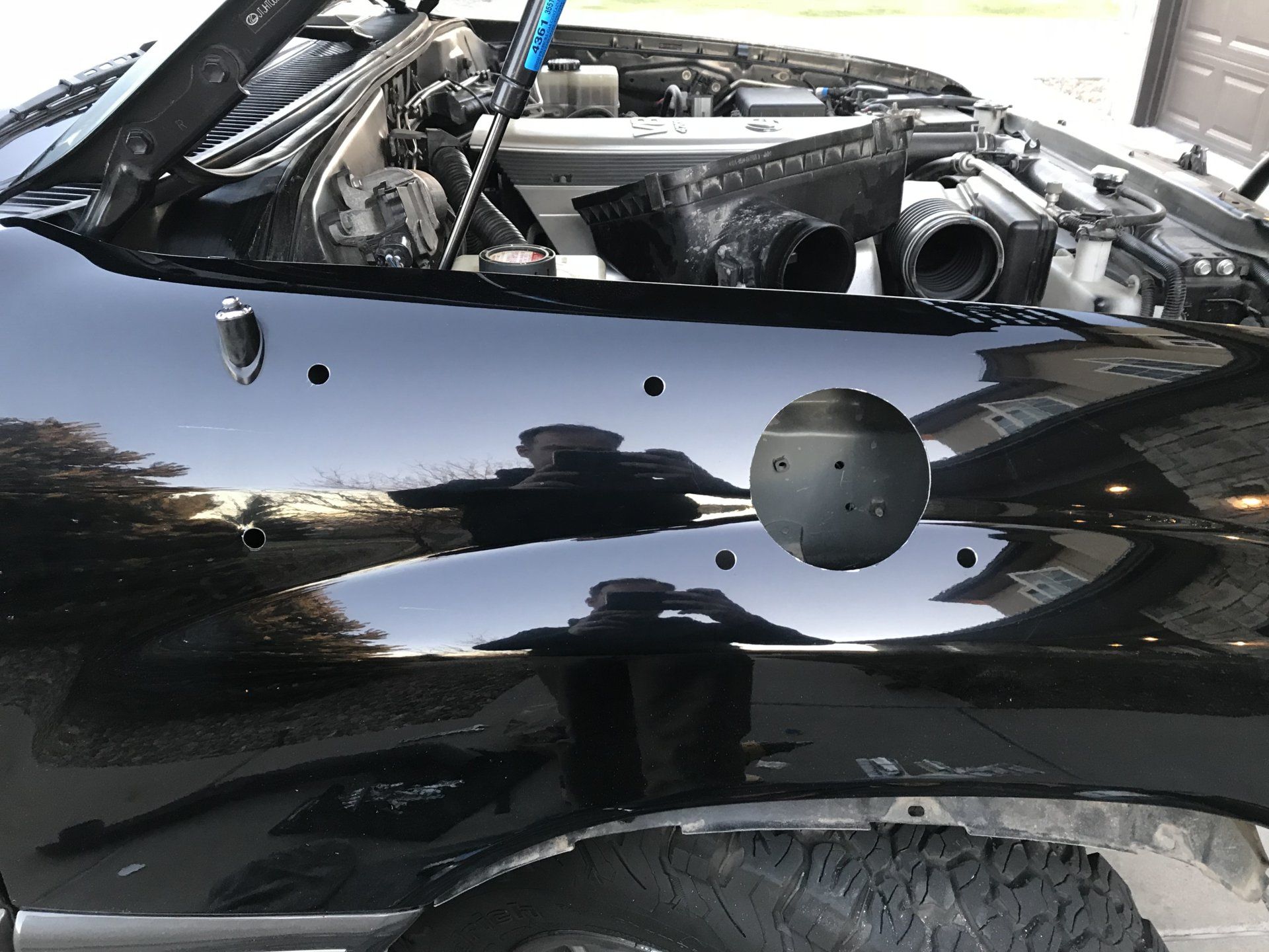

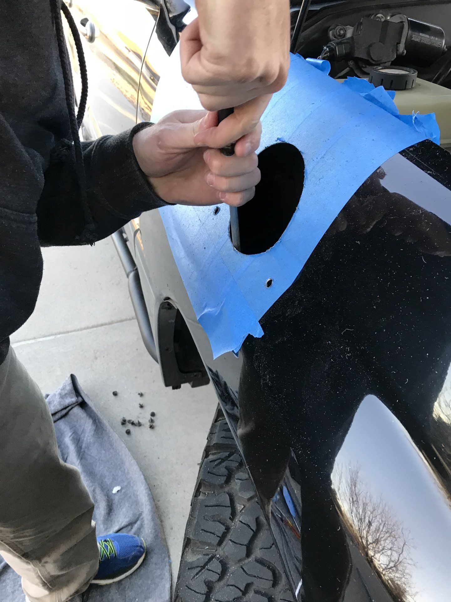

Feels scary as hell hacking that hole, doesn't it? Did one on my 80, had that experience.
Looks great! Get ready for people to ask you if you can go under water!
Thanks! Yep - thus the beer first :beer: .... equally scary drilling multiple holes in my A pillar.
Well sorted rig you got there, and this was very clearly not today based on those pictures. Want to help me cut a hole in mine sometime?
Of course! I have the 4 1/4” hole saw - don’t spend the $30 - you can borrow mine. I also did rivnuts (aka nursert) for the A pillar mount and have that tool too. You bring beer - we make Swiss cheese of your truck ;)

Is this the ebay snorkel or a nicer/more expensive one.
Amazon Chinese special
Spec-D Tuning SNK-LCR98N-PW Air Snorkel System https://www.amazon.com/dp/B01DMSV2QC/?tag=ihco-20
I couldn’t bring myself to spending $500 on the Safari (although I’m sure it’s high quality, good instructions and template).
